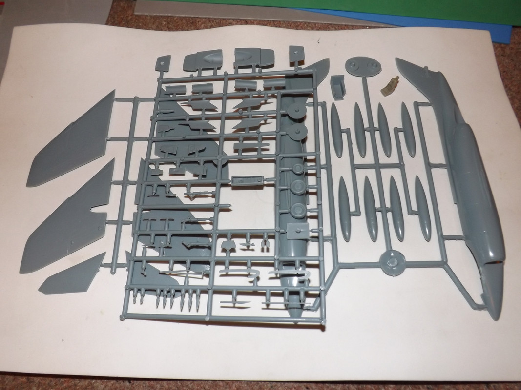

theplasticsurgeon Posted September 19, 2023 Posted September 19, 2023 Rejoining you with this Xtrakit Scimitar. Bought at RIAT Fairford 2022 for £20. Decals, I'm building this option with the scimitar. Parts. 8

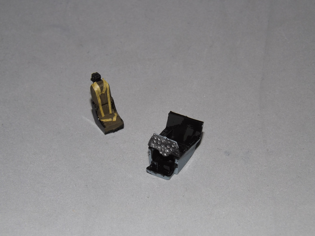

theplasticsurgeon Posted September 23, 2023 Author Posted September 23, 2023 Slow start, but pulling the cockpit together. 5

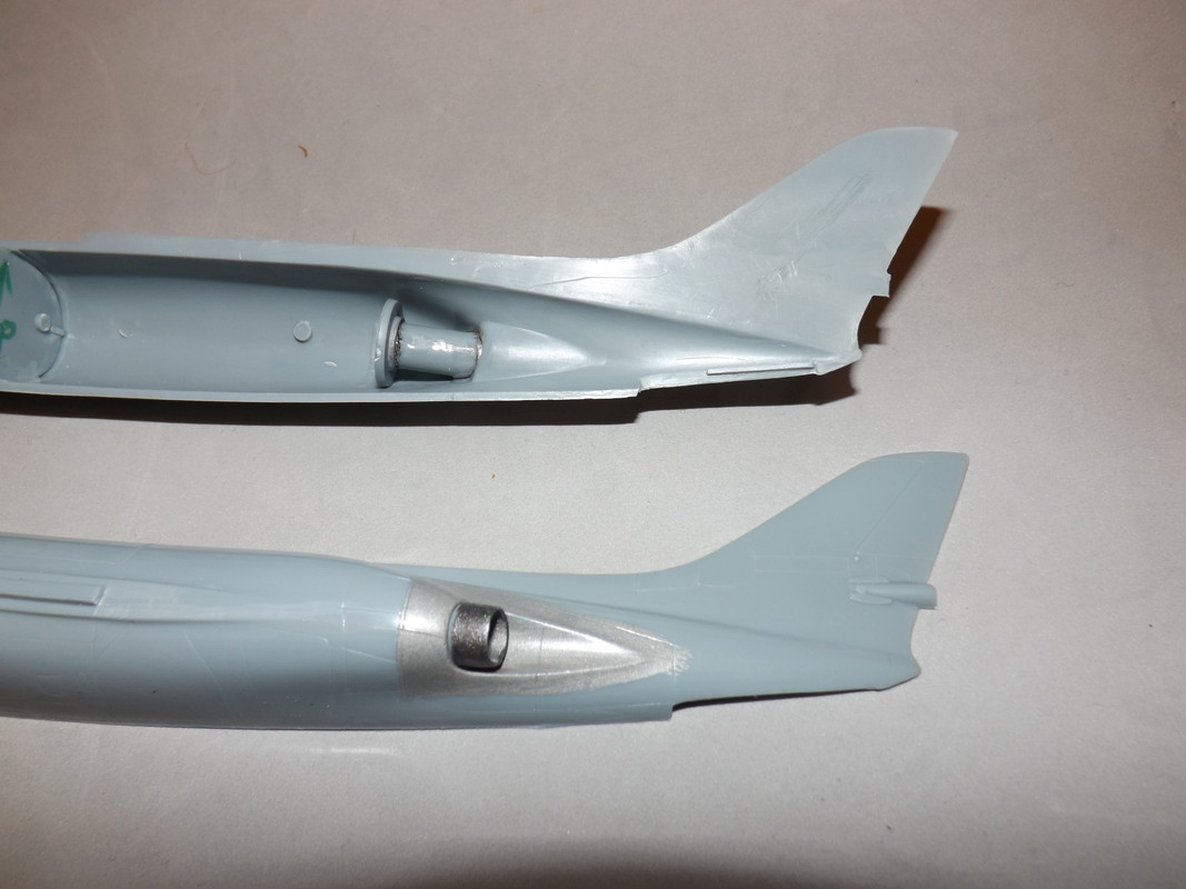

theplasticsurgeon Posted September 23, 2023 Author Posted September 23, 2023 Moving forwards, here are the insides of the intakes. The outer edges of spliter-plates needing lots of trimming to fit properly. I've trimmed the rear port plate, I just can't see the parts of this jigsaw ever fitting properly. And the exhausts, all pre-painted. Those massive circular blocking plates - another mystery of this kit. 6

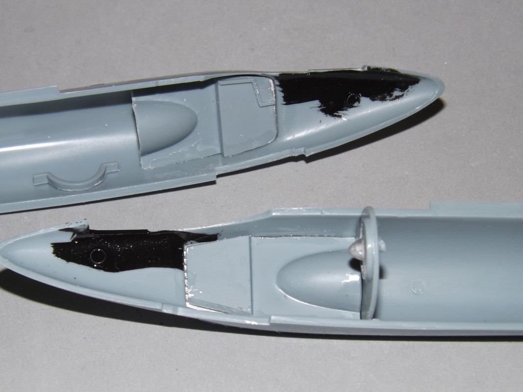

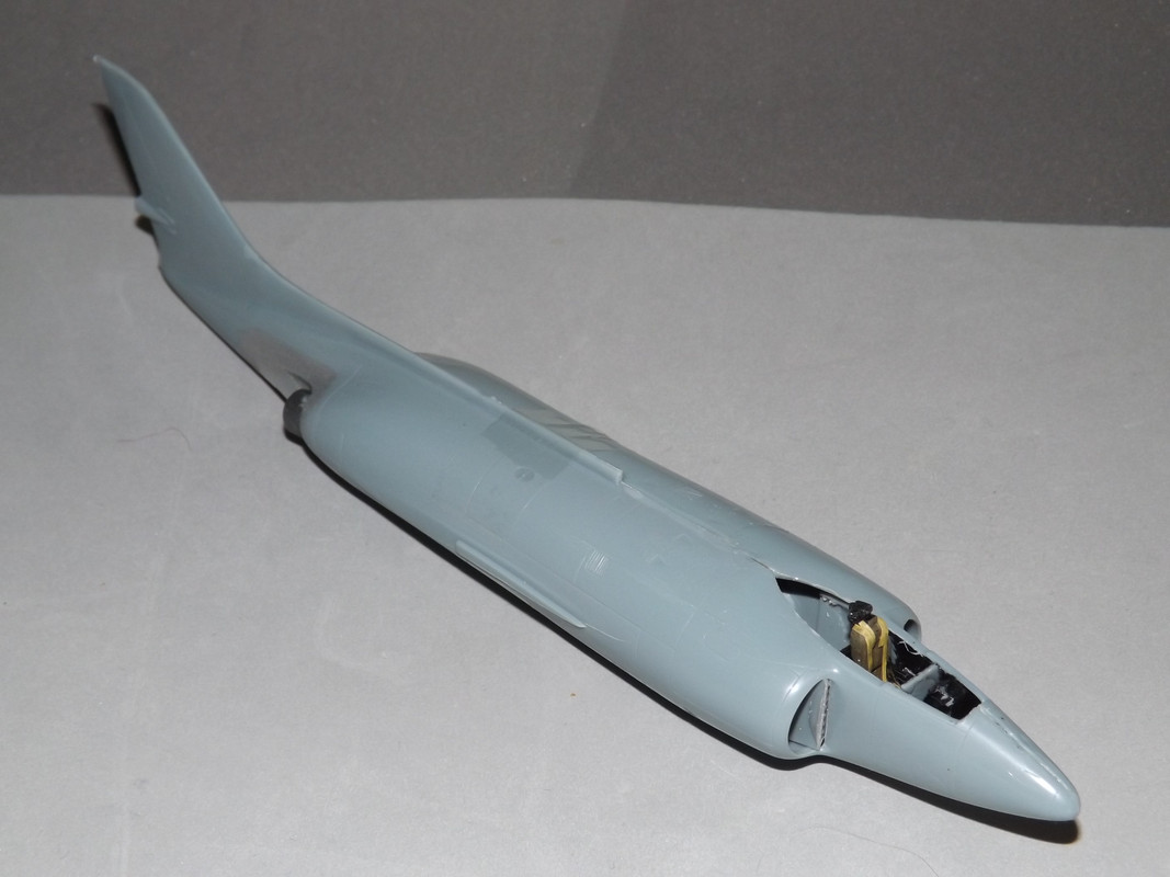

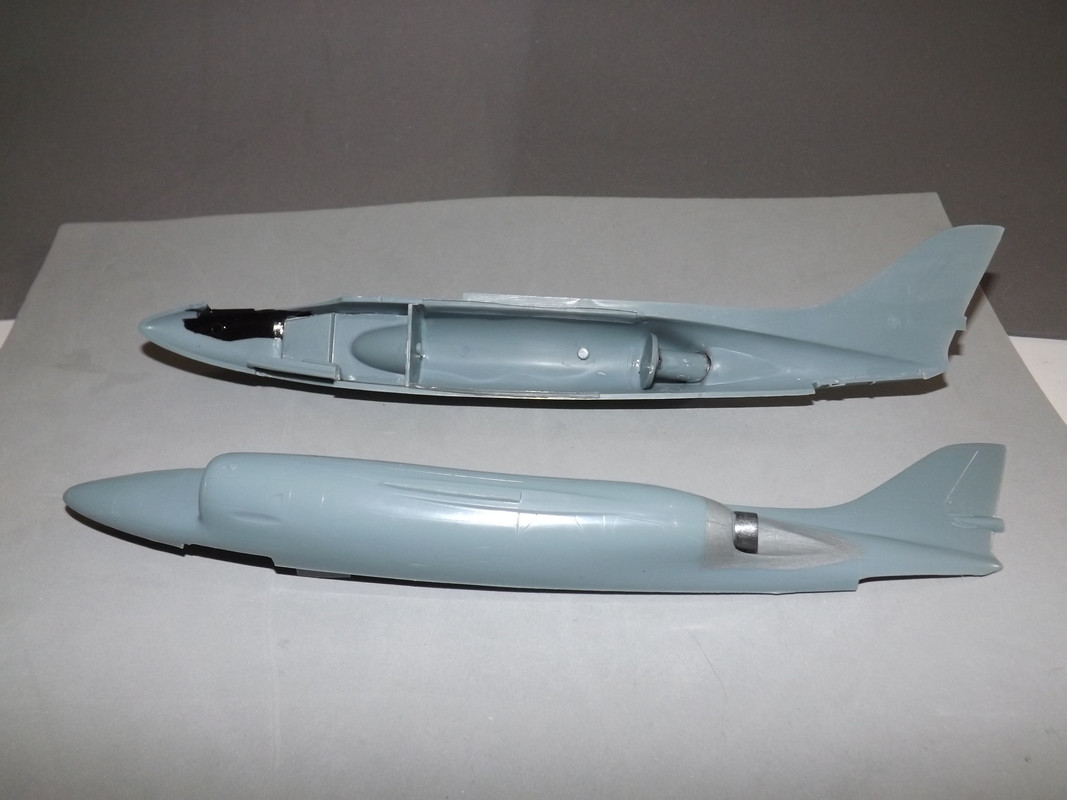

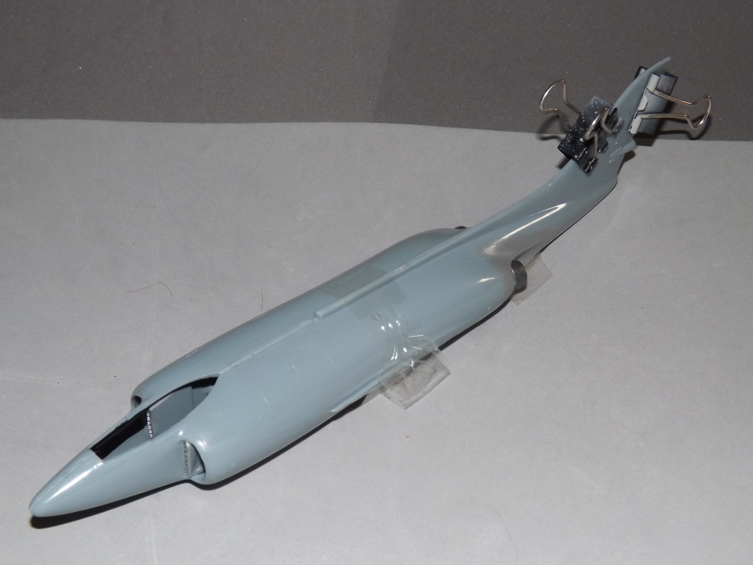

theplasticsurgeon Posted September 24, 2023 Author Posted September 24, 2023 Fuselage sides, just before joining. I've added some sheet plastic to aid alignment. Then clamped it all together. Thinking the cockpit would slot in afterwards. No such luck! But able to be crammed in with very localised spitting and spreading. At's all very vague and unmeasured, but the seat look right under dryfitted canopy. 7

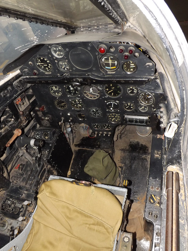

theplasticsurgeon Posted October 1, 2023 Author Posted October 1, 2023 On Wednesday Jet Age ran a coach tour to Boscombe Down Aircraft Collection, where they have the nose section of a Scimitar, which I was able to climb into, To photograph the cockpit interior. All black. No control column. 4 2

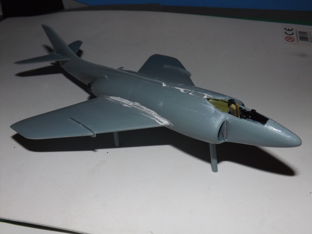

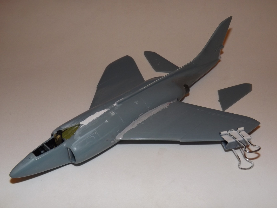

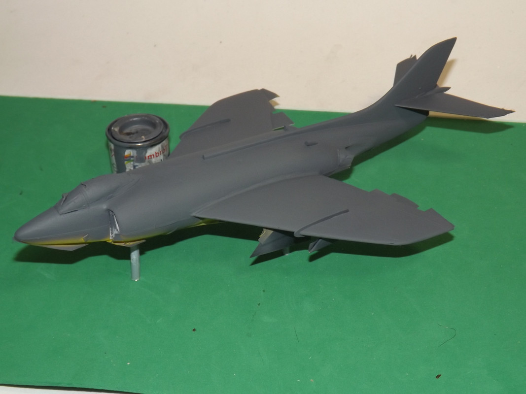

theplasticsurgeon Posted October 19, 2023 Author Posted October 19, 2023 Last meaningful update almost a month ago. As you may have guessed, I've fallen out of love with this project. However, 3 Thunderbolts later, it's time to crack on Wings fitted, with a dreadful joint to dress on port side. Tailplanes have been reduced in size, and that trailing edge under the rudder is now vertical. 4

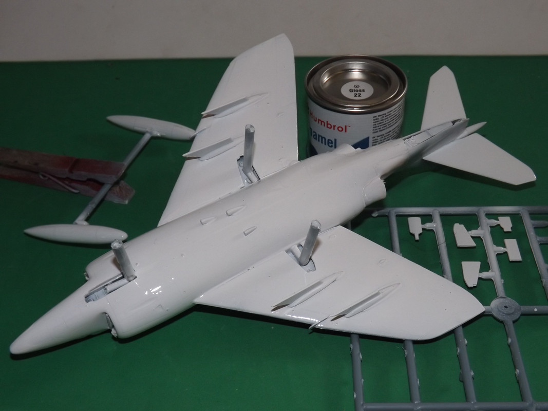

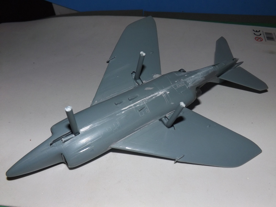

theplasticsurgeon Posted October 20, 2023 Author Posted October 20, 2023 My holding and balance rig - hoping to paint tomorrow. Lead ballast inserted into the nose, before adding the coaming area. Lengths of sprue, added close - but not compromising the undercarriage locations. 6

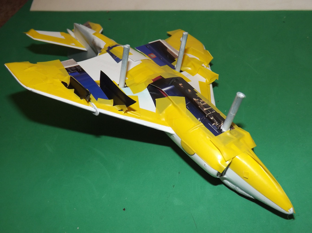

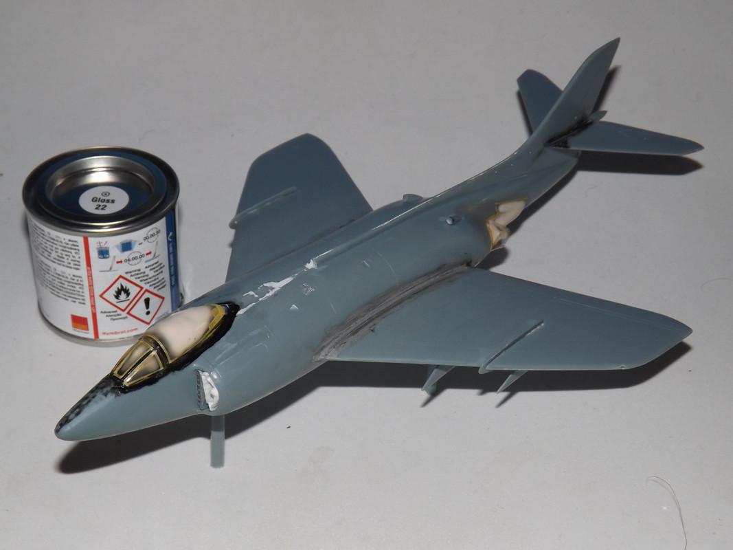

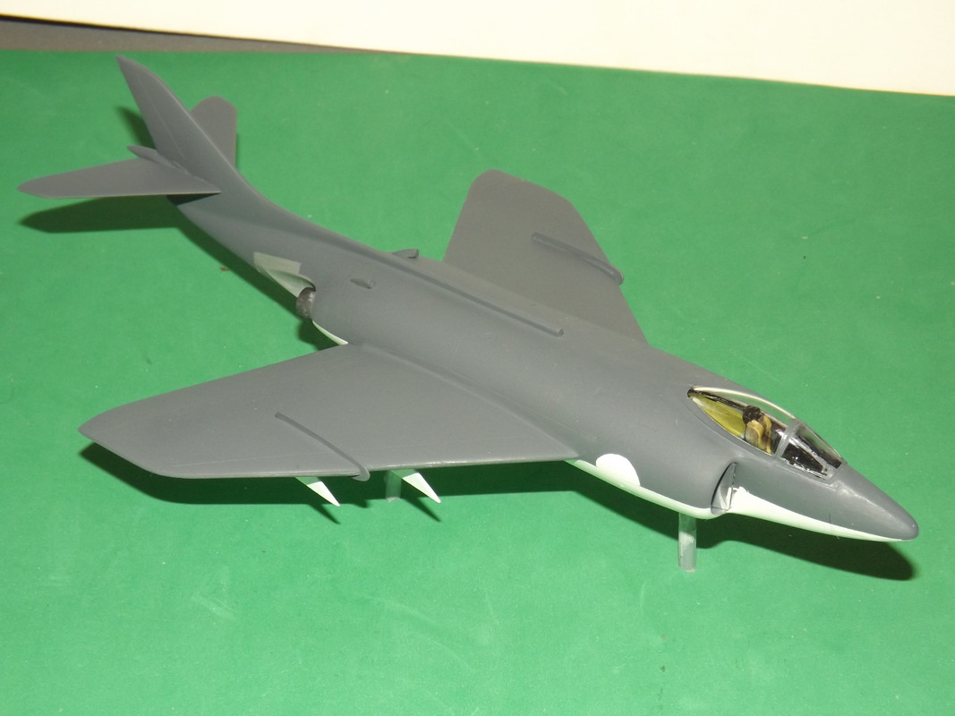

theplasticsurgeon Posted October 21, 2023 Author Posted October 21, 2023 Canopy fitted, and masked up ready to airbrush the lowers with Humbrol 22 gloss white. 6

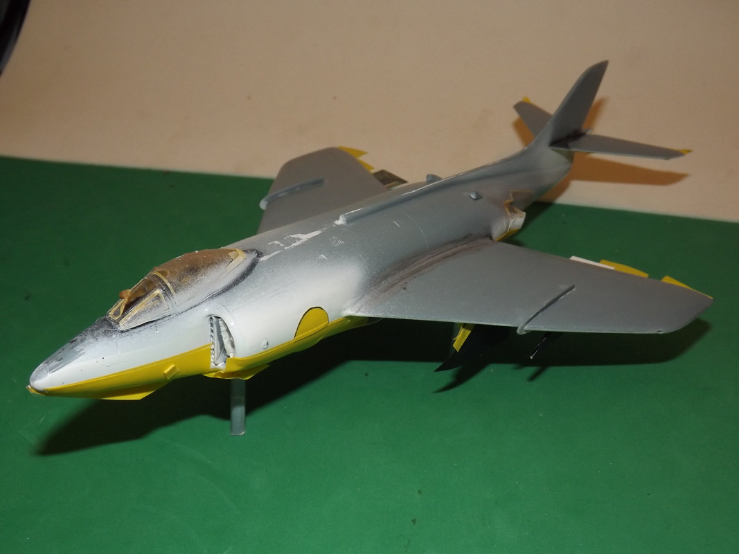

theplasticsurgeon Posted October 22, 2023 Author Posted October 22, 2023 Masked, ready to airbrush upper colour. Which extends around the leading edges. Airbrushed Humbrol 123 extra dark sea grey. Then demasked. 5

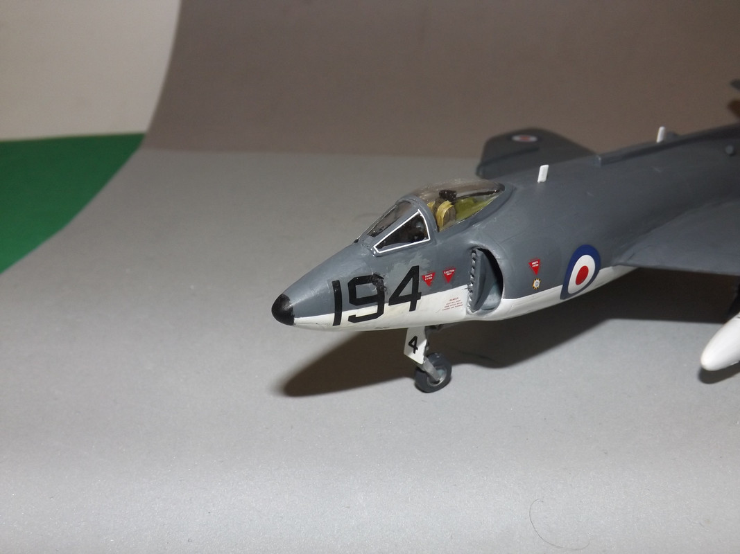

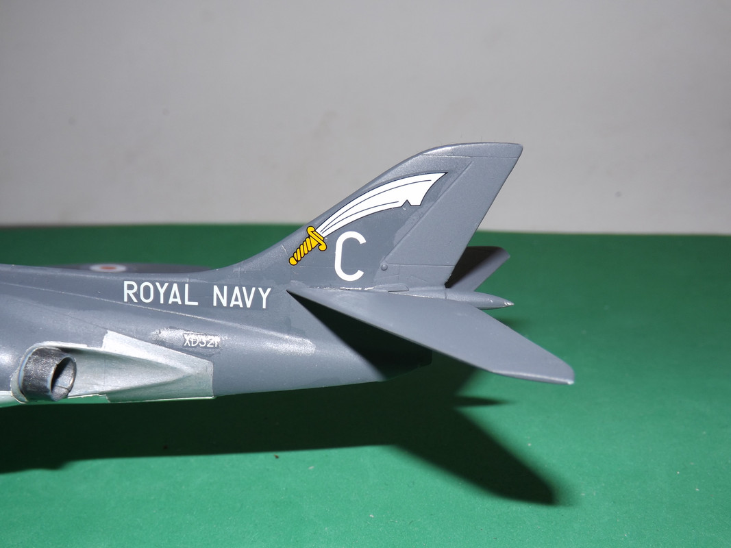

theplasticsurgeon Posted October 23, 2023 Author Posted October 23, 2023 Decals This is XD321 of 807 NAS, HMS Centaur, 1961, according to a profile on Thunder&Lightnings website. But disaster stuck, and I wrecked the nose number on this side. 2 3
stevehnz Posted October 24, 2023 Posted October 24, 2023 Bummer, maybe worth a shout out in wanted to see if anyone has these decals spare, looks really good otherwise. Steve.
PeterB Posted October 24, 2023 Posted October 24, 2023 (edited) Hi Tim, Unfortunately I built mine as the same version so any spare decs I have will be no help, but I do have a jpeg file of the scan I took of the decal sheet as a precaution, knowing what Xtrakit decs could be like. If you fancy trying to print replacements drop me a PM with your email address. Pete Edited October 24, 2023 by PeterB
theplasticsurgeon Posted October 24, 2023 Author Posted October 24, 2023 1 hour ago, PeterB said: Hi Tim, Unfortunately I built mine as the same version so any spare decs I have will be no help, but I do have a jpeg file of the scan I took of the decal sheet as a precaution, knowing what Xtrakit decs could be like. If you fancy trying to print replacements drop me a PM with your email address. Pete Thanks for that offer Pete, but I don't have facilities (or know anyone who does) for decals manufacturing. I'll ask on Wanted section.
PeterB Posted October 24, 2023 Posted October 24, 2023 (edited) These are tricky to print - in the absence of an ALPS printer ( I recent read a post from one of our European fellow modellers who mentioned he had one but I can't remember who it was) the best bet might be to use masks but then you would need a cutter like @Heather Kay has. The white outline is indistinct on the backing paper in my jpeg and my basic printer is not very good at blues but if you get desperate I could perhaps have a try. Pete Edited October 24, 2023 by PeterB

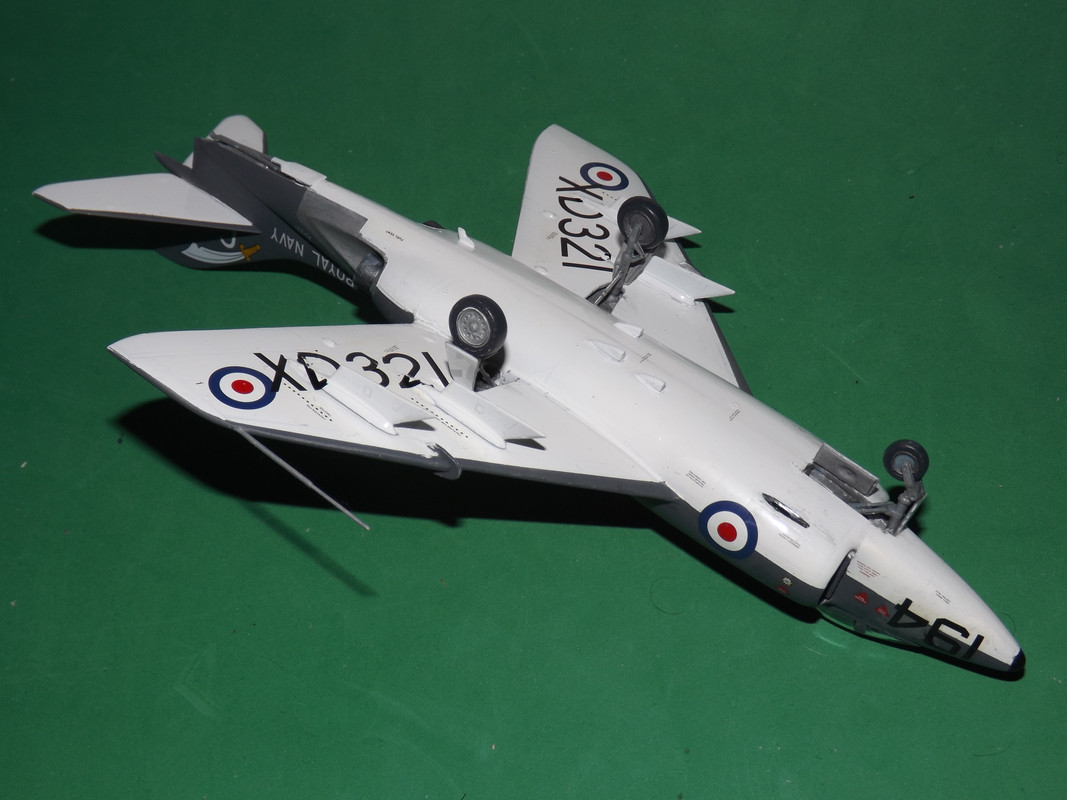

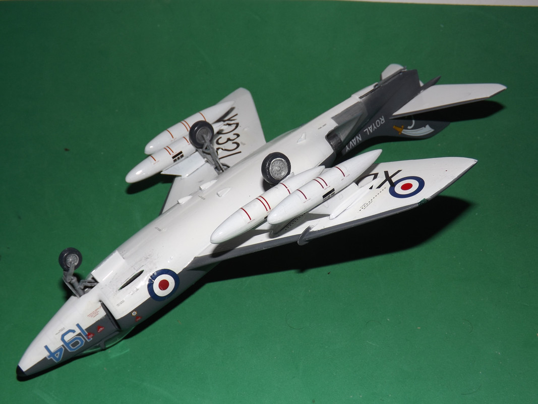

theplasticsurgeon Posted October 25, 2023 Author Posted October 25, 2023 Undercarriage and payload. 6

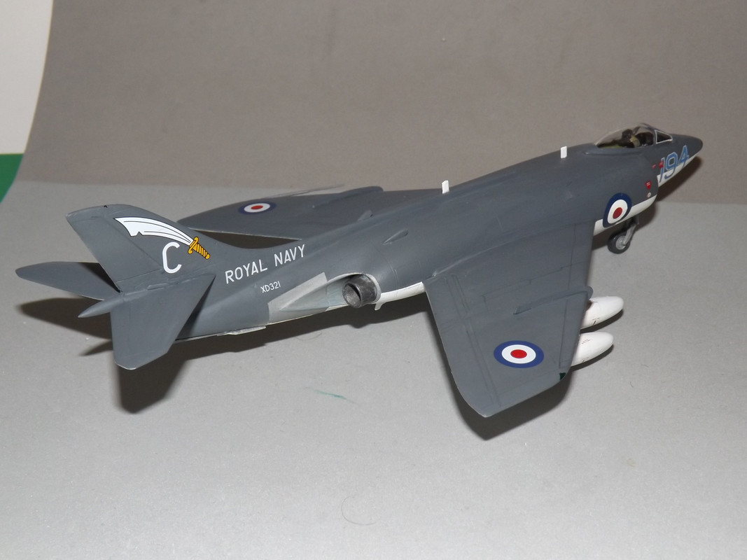

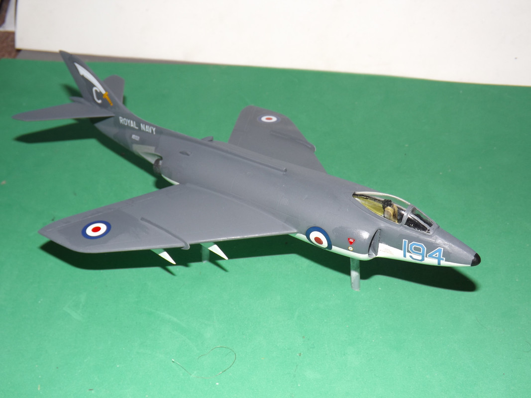

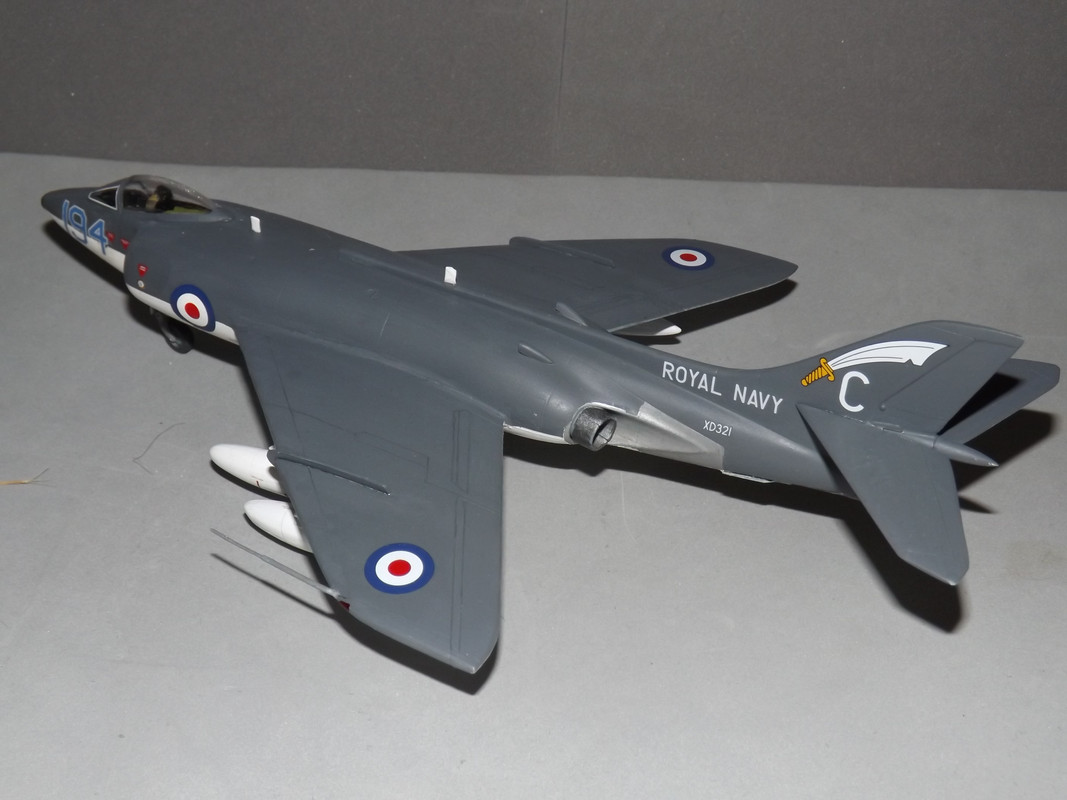

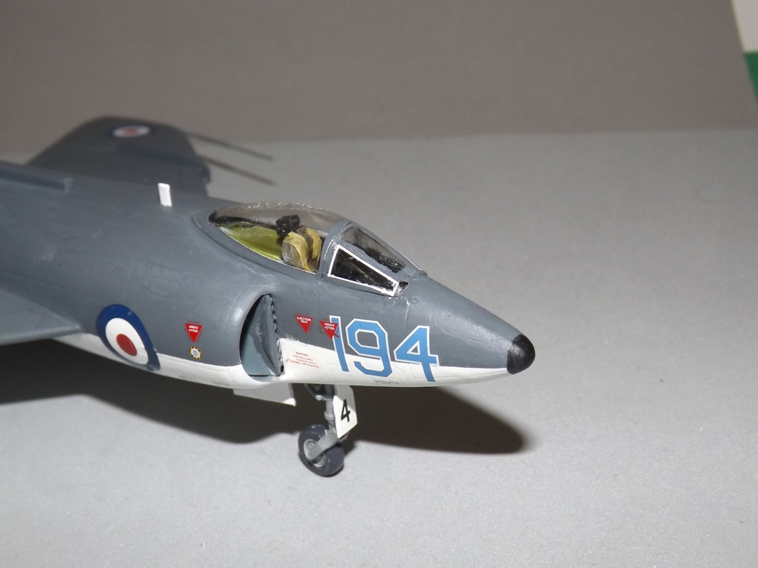

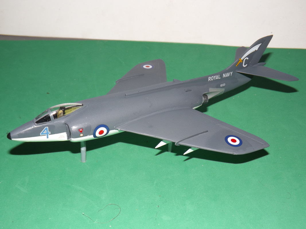

theplasticsurgeon Posted October 26, 2023 Author Posted October 26, 2023 Final addition today, the seals around those sidescreens. and, as you can see, I've replaced this side number with black digits from spares. Which draws this build to completion. 3
theplasticsurgeon Posted October 26, 2023 Author Posted October 26, 2023 Completed photos, 807 NAS, HMS Centaur, 1961 9 1
LorenSharp Posted October 26, 2023 Posted October 26, 2023 In spite of the issues along the way, you managed to sort everything out and finished up with an outstanding Scimitar. Thanks for letting us tag along. 1
