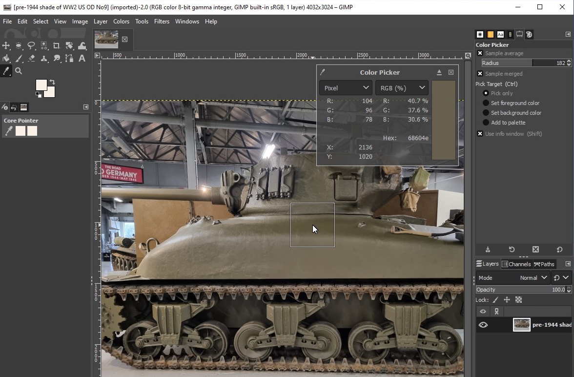

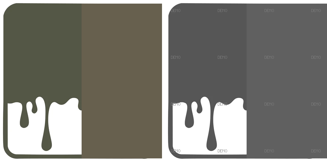

JackG Posted September 18, 2023 Posted September 18, 2023 Probably an exercise in futility, but took the photo of this Sherman from @Kingsman and created a colour swatch to compare with Sovereign Hobbies Colourcoats digital sample of their SCC15. In a grey scale perceptual luminance form, the British version of olive drab is a bit bit darker by maybe four percent? I think the difference would be barely noticeable if at all with an overall accumulation of dust and dirt. 1
