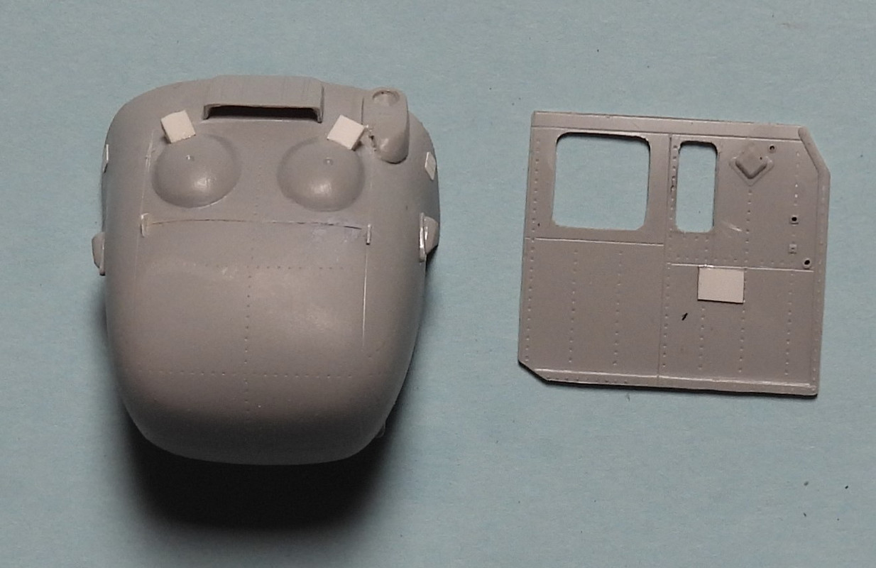

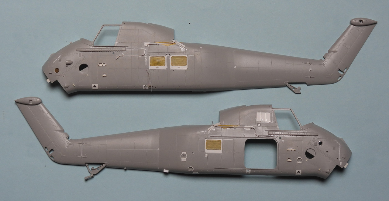

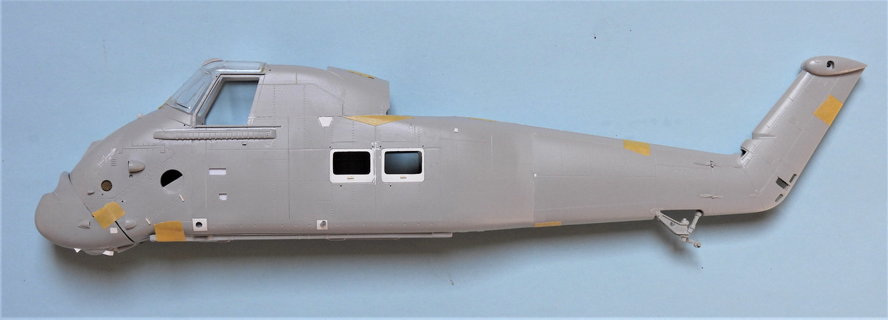

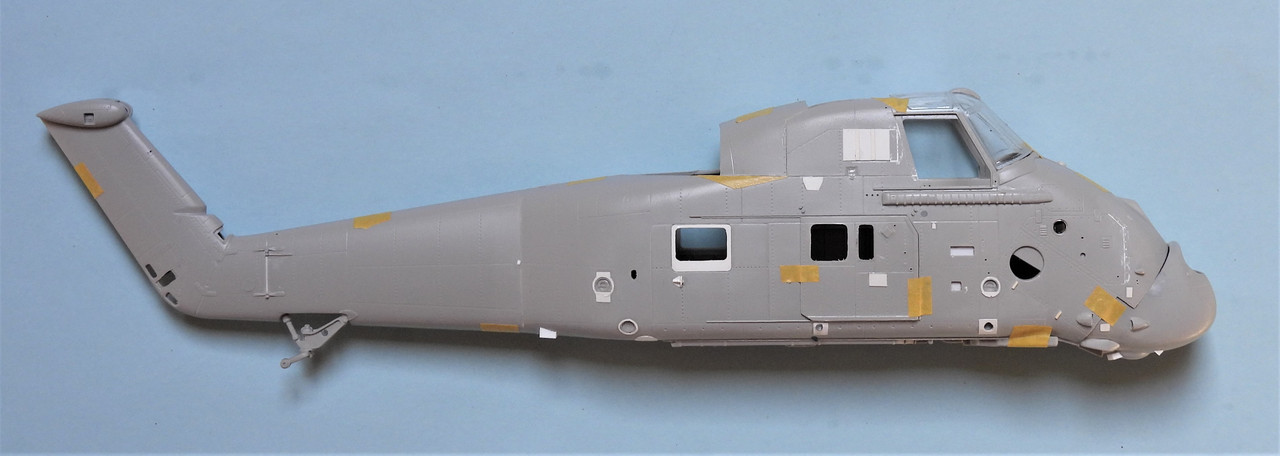

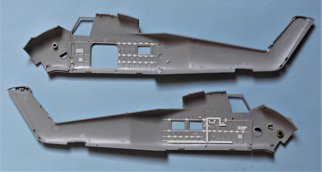

heloman1 Posted August 2, 2023 Author Posted August 2, 2023 Hi guys, above, Loren requested images of my work on another Hu Mk5 build I had underway. Here are the images of the exterior and cabin work so for. As mentioned above, I thought it wouldn't meet the 25% rule, it may have but there are other parts I've worked on including the nose, where I've corrected and added missing detail. I've filled the kit panel lines with Tip-ex and will move and re-scribe as required, I added the escape window surrounds as they are laid over on the real a/c. The moulded in parts looked clunky! There is still a long way to go. Similarly the interior is has only scant detail, some of it quite inaccurate. We carry on... Thanks for looking in. Colin the Wessex grubber 13
LorenSharp Posted August 2, 2023 Posted August 2, 2023 I would say you're right it's pretty close to the 25% line Colin.. But having said that. you've still got the interior to complete, the engine and gear box assemblies, stuffing all inside, then painting, weathering an so on. From seeing you're previous work and eye for detail from a real world user view and how far you would take it I would say you've still got 75% still to go. so if you want, and that's entirely up to you, enter it in the GB. It would be an outstanding build when completed.

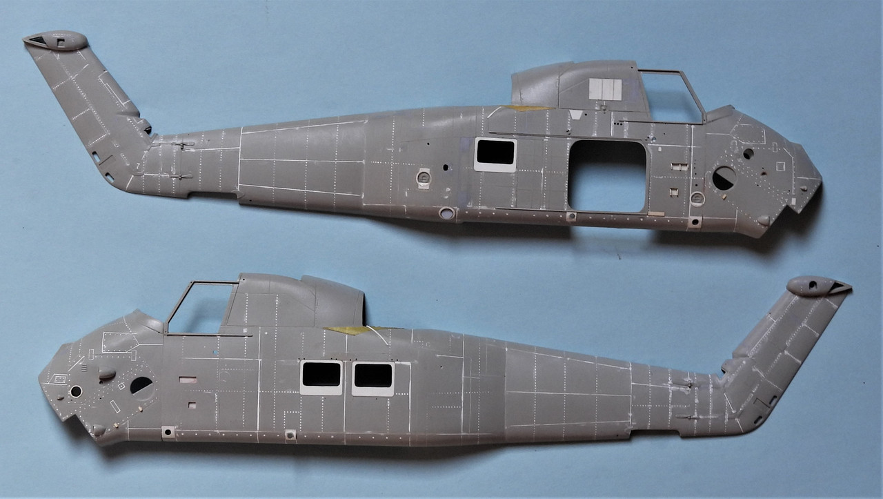

heloman1 Posted August 8, 2023 Author Posted August 8, 2023 Hi Loren, thanks but as I've said, I'm going to hold off on that build. I have in the past few days made some progress. My birthday and MotoGP got in the way at the weekend. I've added the laid-on window plates both sides of the fuselage, I've used .2mm plasticard, it's the thinnest I can find, anything thinner would suffer under the solvent. Some of the engraved panel lines have been filled using Tip-ex. It's solvent based but doesn't bite into the styrene to much. A couple of applications is enough and it shaves off with a the touch of a new blade. I'm also using Tamiya tape for some of the scabbed on panel detail. Here is the 'Dustbin' nose or to give it it's correct name, sand eductor nose. It had swirl chambers in the bottom which collected sand etc, particles and dumped them overboard and feeding the engines with clean air. The exit ducts are poorly moulded, so they were replaced, hinges have also been added. Until later Colin 13

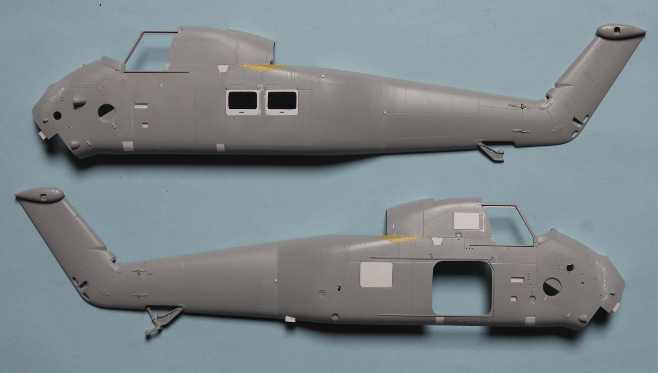

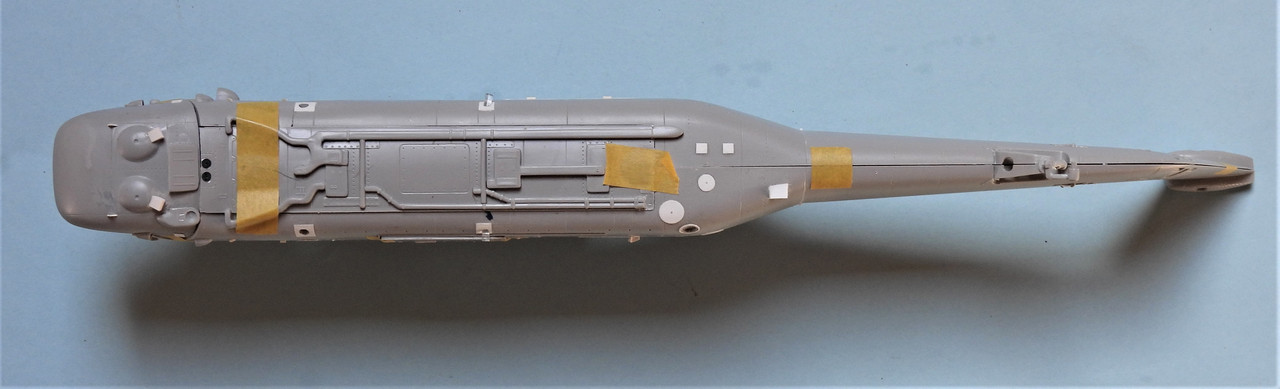

heloman1 Posted August 15, 2023 Author Posted August 15, 2023 Ok, guys, I thought it was time to look at progress and do a little mocking up. So, out came the Tamiya tape ad slapped the main parts together. All the parts in white styrene are the panels etc, peculiar to the HU Mk5, as my guide, I'm using the trusty 4+ book, almost he Wessex modellers bible. So, the starboard side, with new door window added, also the reinforcing plates around the re-fueling points. The port side, strengthening plates to the u/c trunnion point and the exterior tank support... And the underside... That's all for now folks Thanks for looking in. Colin 16
LorenSharp Posted August 15, 2023 Posted August 15, 2023 I'm in awe at how well you get the white styrene to look. I thought they were kit parts. And still would have had you not said anything. Looks Great
heloman1 Posted August 16, 2023 Author Posted August 16, 2023 9 hours ago, LorenSharp said: I'm in awe at how well you get the white styrene to look. I thought they were kit parts. And still would have had you not said anything. Looks Great Hi Loren, many thanks but having worked of the Wessex, I seem to know it's little nuances, plus the 4+ book with it's scale drawings are a great help. At present though, I'm half in the dark as I can't find my photo ref! Colin 1

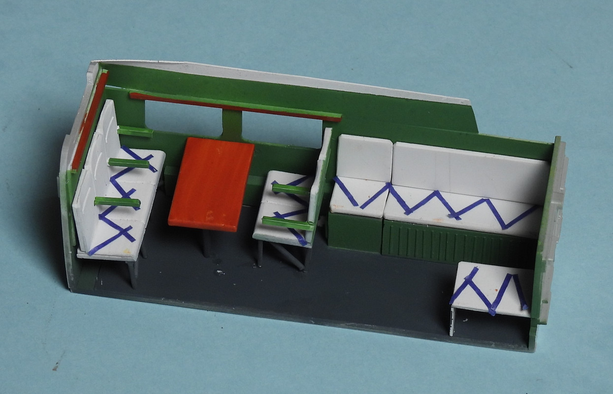

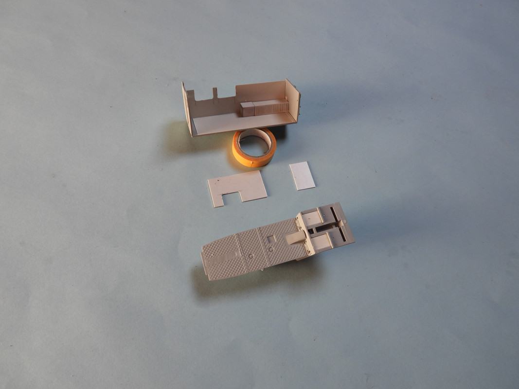

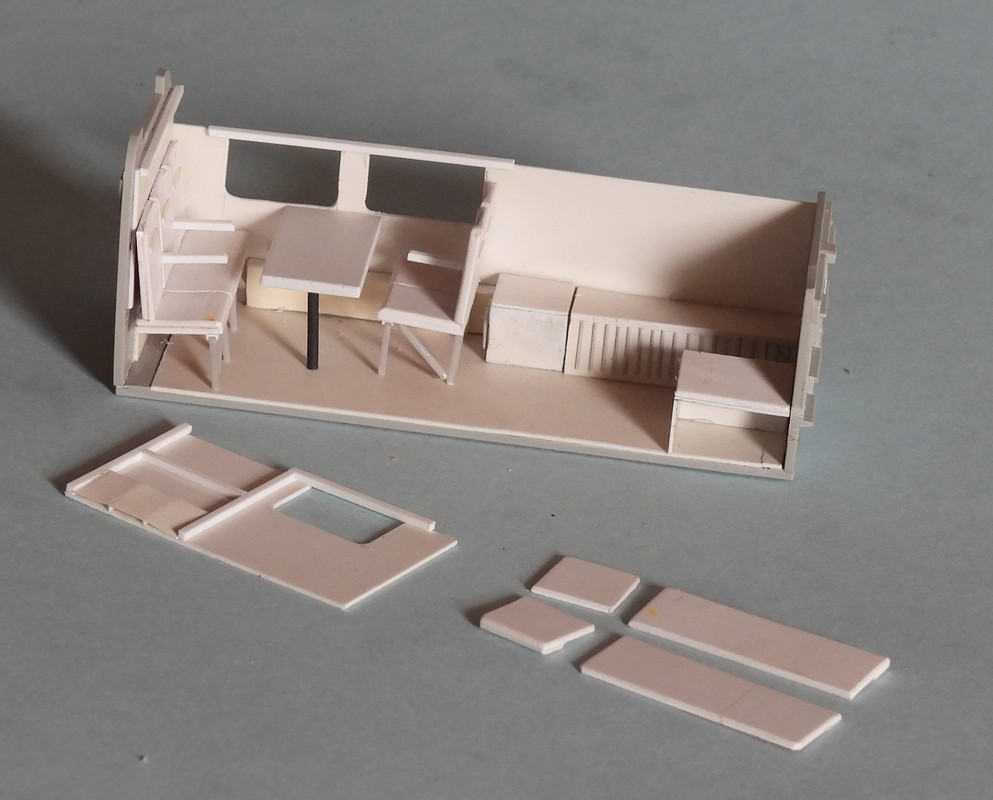

heloman1 Posted August 20, 2023 Author Posted August 20, 2023 Time to go indoors... There is dearth of info on the VIP interior, I have one image from the Haynes manual showing the front half of the cabin with the back of one high-back seat. I'm thinking it could have previously been the interior fit of a Heron or Dove. I'll investigate. So, working with that image, I've started building the interior... The box to the front of the post side is a cover for some radio gear, the second and smaller, I'm not sure. Aft of this is a low lever heating duct. Inside the cabin door starboard side is another box which is where the crewman would sit. Still lots to do... Thanks for looking is. Colin 10

heloman1 Posted September 19, 2023 Author Posted September 19, 2023 After a short weekend in a wet and windy Cape Town, visiting my old modelling friends at the Cape Peninsula Scale Modellers. Yesterday, I got get back to some work on the Parrot. So from the photos that were posted on Westland Wessex Enthusiast FB page and some first hand info, I've been able to get to this stage. Trippel rear seat, with arm rests, twin rear facing seats and table. Forward of this is the four place bench seat and inside the cabin door (starboard side) the crew mans seat. Up next is the cabin roof which has a curve to it, so some fashioning of some plasticard to be done... That's all folks, Thanks for looking in Colin 6

heloman1 Posted October 3, 2023 Author Posted October 3, 2023 Hello again... Some small progress on the cabin interior VIP fit. What I thought was going to be a fiddly drawn out process, tuned out to be a ten minute job! I've worked some thin plasticard to form the roof insulation. The port side piece has been fixed into place, the starboard side will be attached once everything is painted, which is the next task. Progress was slowed from id last week, when my two Sea King kits arrived from the UK. What a beautiful kit, I couldn't hep but delve into the box chock full of plastic delicacy! My build is in the Aircraft WIP pages. I've added an extra light the the cabin headliner, I'm sure their Lords would not have wanted to sit in the dark! So, until later... Colin 2
heloman1 Posted October 14, 2023 Author Posted October 14, 2023 Further to my work on the cabin interior, this week I got to paint it... I need to get the cockpit squared off, then I can close up the fuselage halves. Thanks for looking in. That's all folks... Colin 9

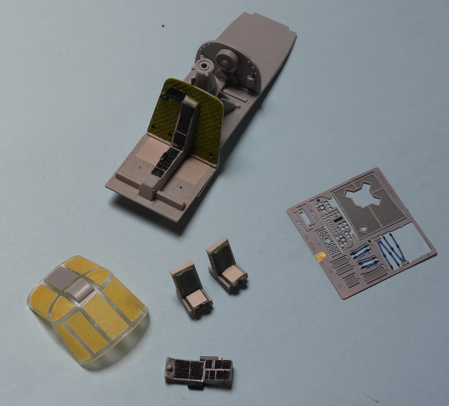

heloman1 Posted November 3, 2023 Author Posted November 3, 2023 Well, where has the time gone to? Too much happening in the household at present! Looking at my progress over the past couple of weeks, I don't think I'm going to make it to the line with this one! I would hate to rush it and then spoil all my good work. So, I'm going to set this build aside and concentrate on the Hellcat, which is close to the end. I'll have to move this build into the Aircraft WIP section (how do I do that?) Anyway, here is where I'm at as of today. External piping both sides of the fuselage and the main gearbox braces added. The latter are not 100% accurate but then I couldn't make them any better. Bottom image Above. The cockpit is almost finished , seatbelts, rotor break and IP to add. The seats have been refined and the lambs skin cushion cover added. That's about it for external details, once the internals are in place, I can close up... For the paint, I think I'm going to go with Tamiya LP (lacquer) paints. I should get the desired gloss finish without the need for clear coating. I finally found my Xtradecals sheet X48-111 for the markings which aren't covered on the kit decal sheet. So, until later. Thanks for looking in. Colin the Wessex nut. 7
