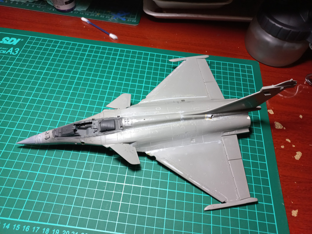

I added some plumbing with wires in the whells wells and an hydraulic reservoir in tne nose gear well.
I tried to simulate the air intakes channels with both preformed metallic foils.
I added weight in the nose with a few bearing rollers.
I painted and detailed up all the cockpit with my old Rotring 0.1 mm with white ink.

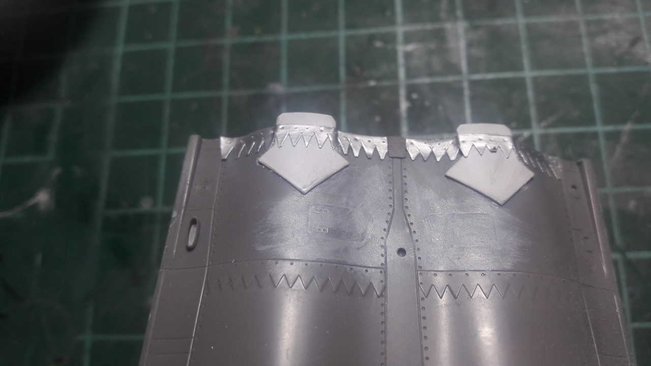

I added details to the rear of the fuselage like reinforcements and sawtooth panels missing in the kit.

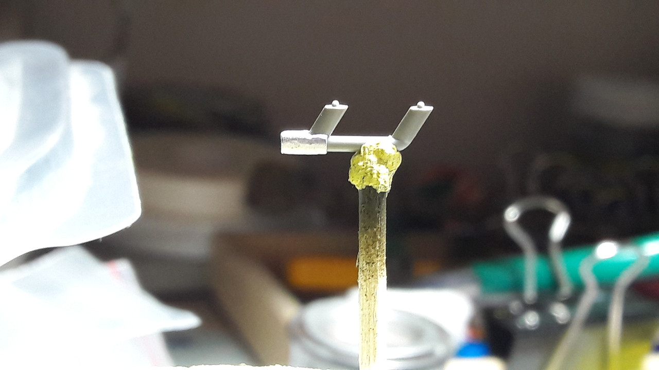

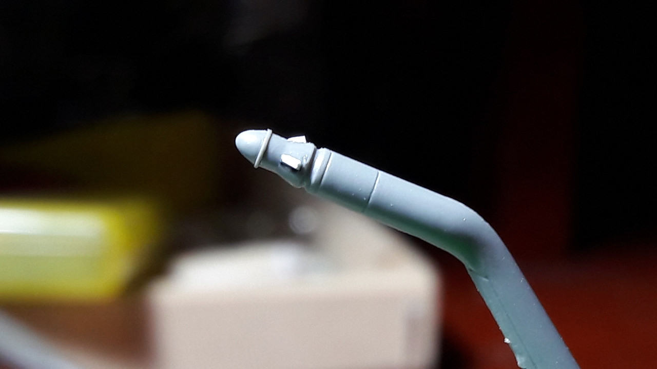

Later, I scratch build the integrated ladder and the footrest.
Added some details in the fuel probe, drain tube and fotrest well.

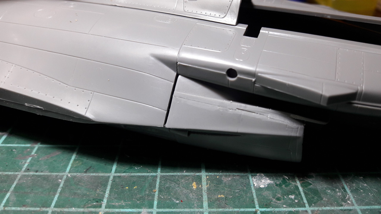

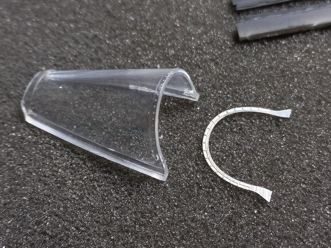

Ataching the air intake pieces, please take care of a prominent gap. I filled with a plastic strip and putty.

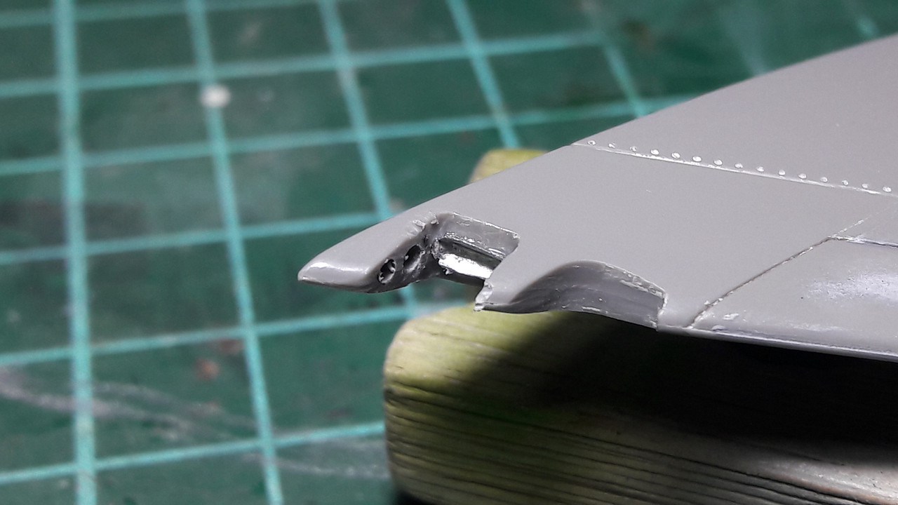

Also you must take care of a little gaps between fuselage and wings, the APU exhaust zone, the Wolfpack's resin nosecone and a pair of shrinkage on the wing's slats and the arresting hook.

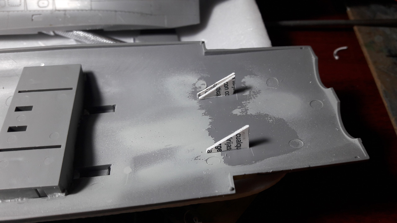

I added a pair of plastic as a bumper guard because I was affraid the resin exhausts pieces could pass inside.

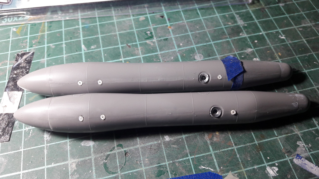

I detailed up the external fuel tanks with plastic and metal as drain valves or something like that.

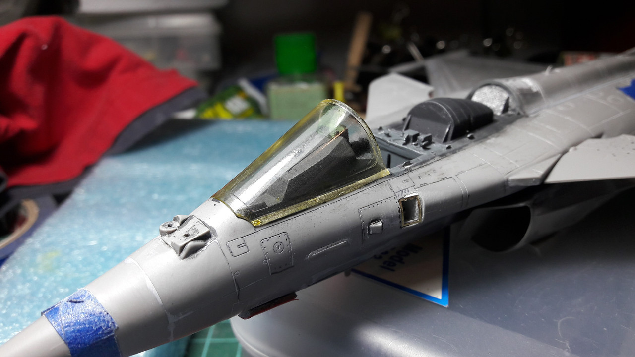

I tinted the canopy and windshield with a mix of Tamiya's smoke and translucent yellow.

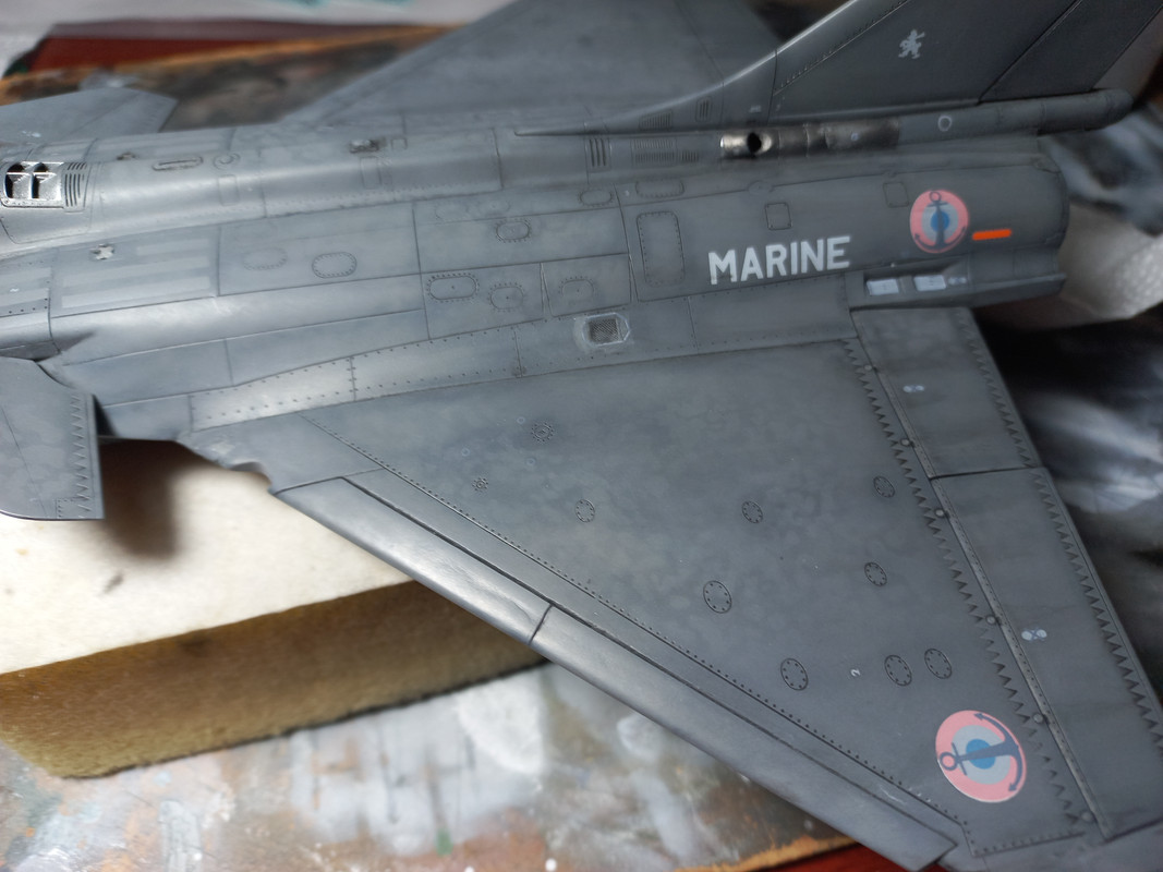

Finally I applied grey Ammo MiG one shot primer, and made some preshading with black. Later I applied the monochrome scheme, Tamiya's dark sea grey XF-54. Later I applied Aqua gloss clear barnish for the decals. I think this made a little bit dark the base colour.
I decided to represent the Rafale M number 15 at 2014 Tigermeet. This particular machine has a few "kill marks" on it, they are from bombs dropped in Operation Harmattan, Libya 2011.
The fuel tanks tiger scheme was a real challenge, because I found some pictures where I noticed this white and black stripes were in some places hard edges and in some place. soft edges. I decided to mask with Uhu tac putty.
Decals were applied without issue.
I sealed the whole model with Testor's acrilyc matt barnish and maked the panel lines with Ammo MiG products. Later I painted with a lighter grey the anti-slip stripes on both sides of the cockpit helped with the mask included in the Syhart's decals set.

I finally finished it a few weeks ago, after a long, long time. I hope you like it! Let me know if you see any flaw. I promise later take better pictures.
