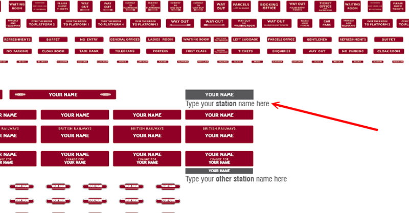

bootneck Posted June 19 Author Share Posted June 19 19 minutes ago, Black Knight said: For what you are wanting; I use an old Desk Top Publishing program Its very old, from about 1996. Its not supposed to run on my current lap top but it does. I can't show you what I can do with it as you'd need the same program. But basically, I draw a box and then type into the box. I can copy & paste that box with its writing several times. I can resize the writing (from a tiny 6 point to a very giant size) and the font (I have hundreds available to me), or change the colour of the letters, or the colour of the background I don't know if any DTP program can be bought anymore. I'm sure it can be Hi Fred, It is possible to do that in the freely available Inkscape program. I've done it before to make decals for all the markings and windows of this Air China Boing 737. I could do something similar for the number plates if I knew the dimensions and font for 1:35 scale. This is the sort of method that I'm trying to learn about, it shows various signs and they allow the user to type in the specific station name of their choice. It would be great if I could find out if there is a method to do similar for number plates. cheers, Mike Link to comment Share on other sites More sharing options...

John Laidlaw Posted June 19 Share Posted June 19 18 minutes ago, bootneck said: This is the sort of method that I'm trying to learn about, it shows various signs and they allow the user to type in the specific station name of their choice. It would be great if I could find out if there is a method to do similar for number plates. cheers, Mike That's a fillable PDF form. I can have a poke around and see what software you might be able to use, or create a sample or two for you if it would help you decide? 1 Link to comment Share on other sites More sharing options...
bootneck Posted June 19 Author Share Posted June 19 17 minutes ago, Natter said: Anything here of use, at 1/35 scale? https://motobitz.uk/general-decals.html Hi Dave, that is interesting and I'm presuming that, being silver letters, that would be correct for British vehicles of the 1950s and 1960s? 1 minute ago, John Laidlaw said: That's a fillable PDF form. I can have a poke around and see what software you might be able to use, or create a sample or two for you if it would help you decide? John, that would be really helpful and probably just what I am looking for. I would be very grateful if you advise me on software, especially not too expensive, and also if you could do a sample idea for me please. cheers, Mike 1 Link to comment Share on other sites More sharing options...
