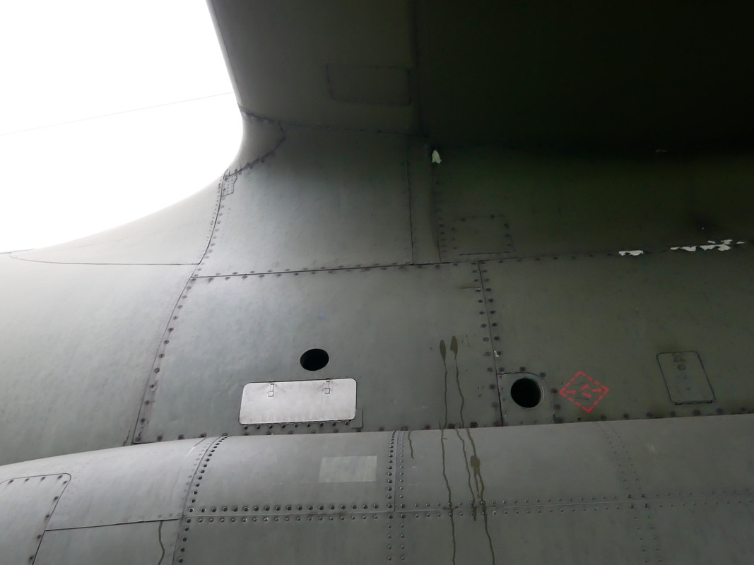

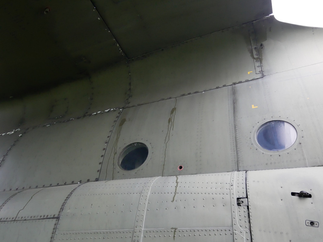

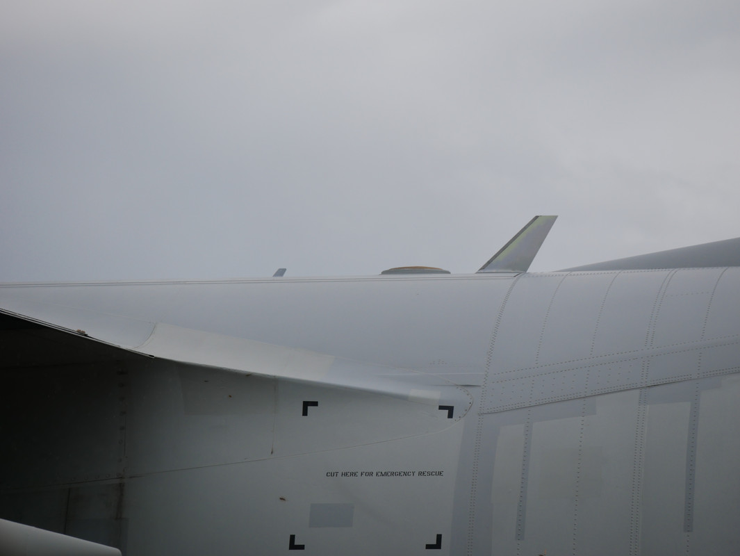

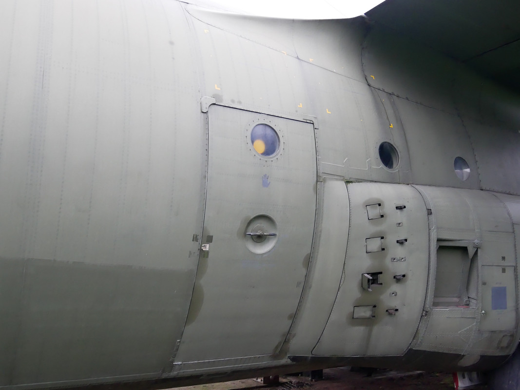

That "hydraulics bay' (I don't ever recall it being called as such) looks like pure fiction! As stated elsewhere, the RH bay is largely devoid of anything but screwjacks and landing gear tracks. The LH bay has two fire bottles and only the forward part is anything like cluttered as seen in the Black Dog set. In RAF service the bays are white, but do get very dirty from brake dust and beryllium from the MLG screwjack brake discs. Remember too that when retracted, the MLG shock absorbers occupy part of that space!
So apologies for the quality of photos - these are from the early days of digitals but hopefully will help. Though taken during maintenance, no parts are missing in these shots:
RH side:
jack5
And the LH side, showing the methyl bromide fire bottles:
jack10
MVC-007S
And this is a close-up of the MLG right-angle gearbox, driven by a hydraulic motor to the left (fwd) and which drives the front MLG screwjack via vertical shaft and then feeds into the aft MLG gearbox motor via a horizontal shaft:
MVC-008S

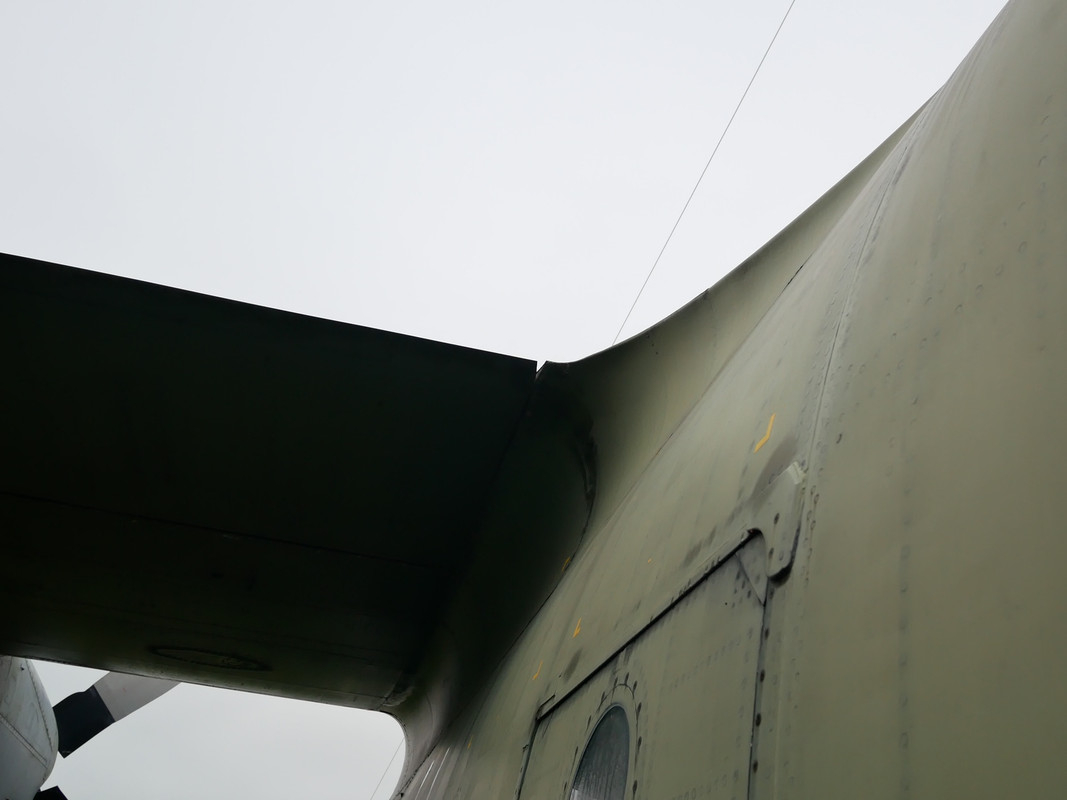

The most often talked about point on the Herk is the chine that runs along the whole length of the fuselage but half of it is hidden by the U/C sponsons. This corresponds to the cargo floor line inside and is a way of eeking out a more uniform space.
Of the kits the Airfix and Zvezda kits have this important detail, the Italeri kit does not.
Hairy leg is optional.

Hello @Head in the clouds.
Hope these help.
Starting with the RAF Herk at Cosford. Good reference points here.
This lets you know where the fillet ends.

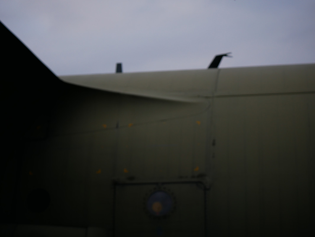

Ah a very big error on my part, oups, ( now it’s here I’m mot sure this isn’t the leading edge ). 🤔 A quick look at my own sequence of photographs does reveal this IS the L/H leading edge.
And an Italian one from RIAT this year.
Normally my camera doesn’t produce lousy images, but in this case it has. It’s been inserted as a comparison to the above photo, and @fatal bert‘s comment’s appearing to be true. The sit of the Italian aircraft is sitting rear down the rear door down ready for loading, versus a museum piece possibly robbed of usable materials for what was until July was an active fleet.
I’ve inserted this photo also for a comparison of t’other side. As for XV208 Snoopy will differ from the photos I’ve posted.
As always I don’t mind giving an apology when needed, the erroneous photo came from scrolling through and copying and pasting.

Cheers @amos brierley they do. A nice clear pic of the trailing edge fillet and the one showing some rivet detail that I had missed on the sponson, nice. The Italian C130 pic shows the fillet dropping as it moves back, is the camera angle or is that how it actually is?
Posted (edited)
It does drop,it follows the camber of the wing.

What i should say is that the bottom is straight and the top slopes to meet it.That probably makes more sense.
