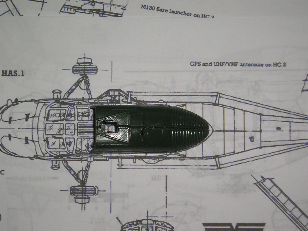

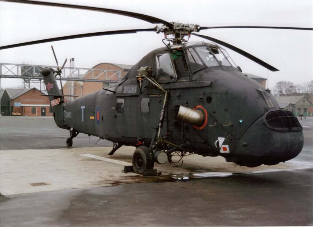

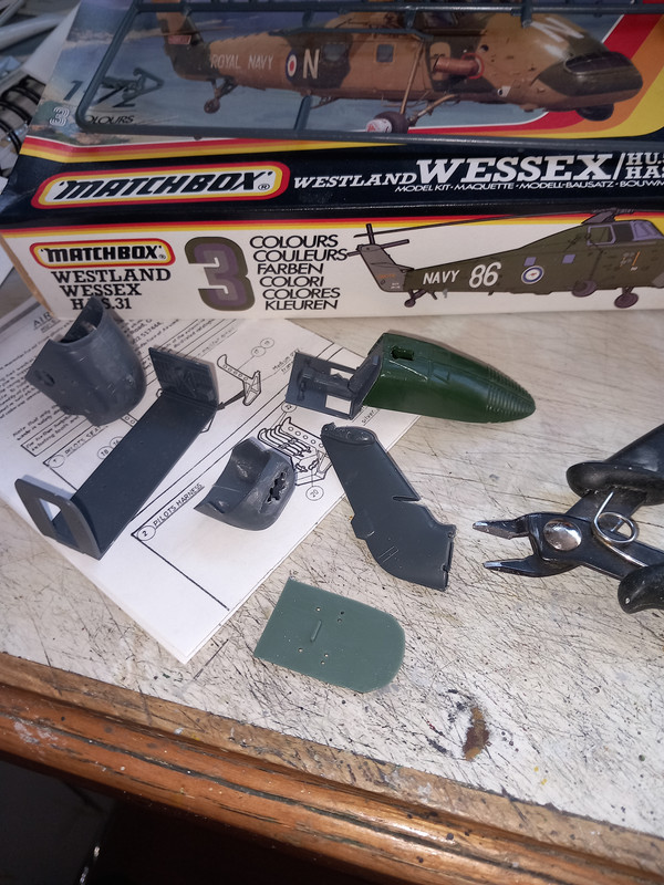

perdu Posted May 23, 2023 Posted May 23, 2023 I am taking a rotary breather amongst the fixed wing miscellany of builds and amongst the planned helicoptery in my future is a HU5 Wessex. Most helicopters in my collection are from the RAF collection so my next attempt has to be a Fleet Air Arm machine version. I have built a few Gnome engined Wessexes in my time and I find the nose on all of them to be missing something in the way of accuracy. Both kits nose filter sections are too large and need reduction to suit photographs of the same. The Italeri tail cone is too short but the Matchbox looks right but the Matchbox nose is rather dreadful, much too wide across the intake mouth. I am using the plans from the 4+ Wessex publication which has drawings for all versions as the design details and now to begin. This is what I am looking for, an HC2 here but the noses are the same for the 2 or the 5. Time to reduce the Italeri nose a bit This might not show the changes yet, but the left side of the nose hsa been reduced whilst the right side hasn't yet. This view of the finished intake shows a reduced width which will fit closer to the shape on the first picture Originally it was fatter on the front section but now it is filed to more closely follow the line of the nose. More to follow as I finish the trainers and Hawkers I'm already doing 19

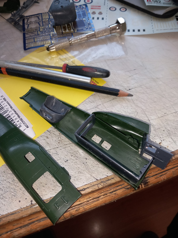

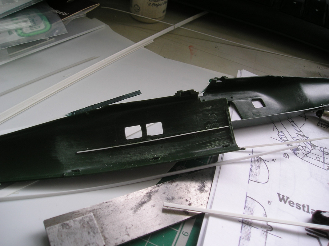

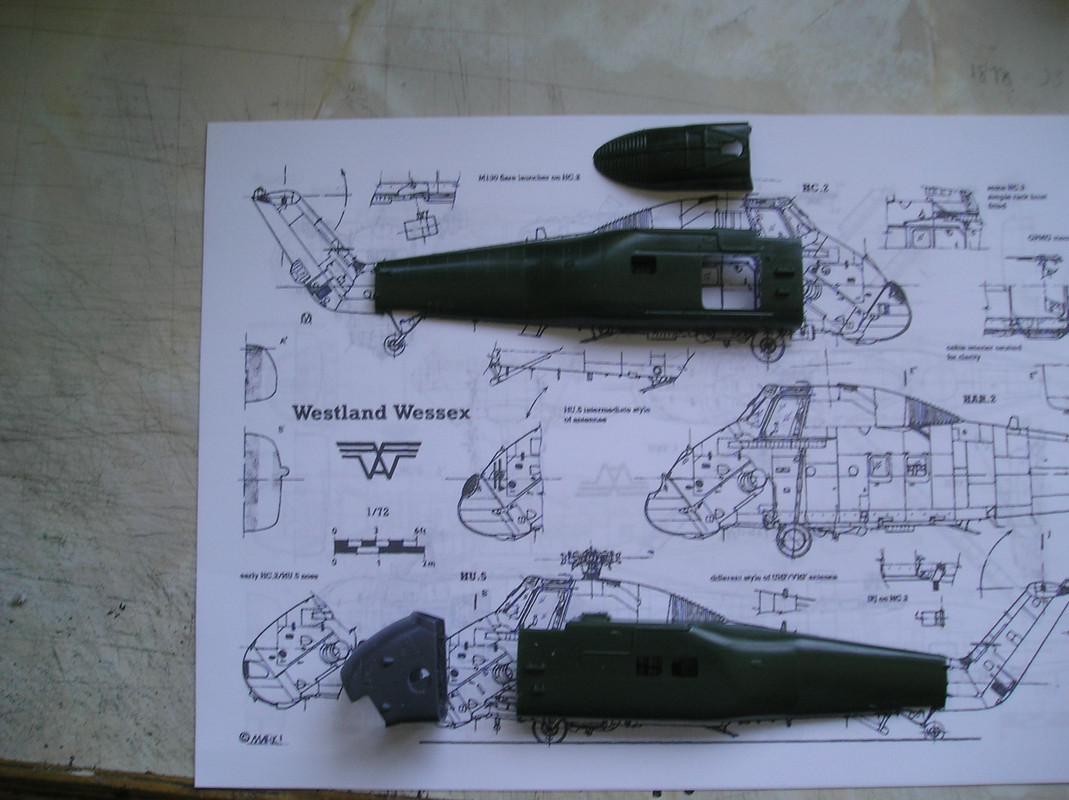

perdu Posted May 24, 2023 Author Posted May 24, 2023 OKeydoke Printed off the plans from my 4+ (don't get paints or cut diagrams this way) and laid the Matchbox fuselage halves over them to check (I always thought the basic accuracy was so good it shocked me just how awful the nose is!) Near enough a perfect fit and the six foot scale is exactly one inch so that has cleared me to go on with the project. The grill on the back of the turtleback is only engraved whereas the Italeri one actually has opened out louvres and a more pointy taper, so that will be used here, expect me to make the best use of the best parts on this, my favourite rotary ever along with the Gnome engined nose which Italeri have got mainly right, albeit with too wide an air intake. I have decided not to attempt open panels on the HU5 but deep inside I crave an 18sqn Walter from RAF Germany back in the seventies, emulating my first ever converted Frog kit which even now I remember with deep, abiding pleasure... That one which will be another kit-bash, may well get the MRG and open panels following on from @hendie's magnificent examples that we shared the excitement of. The HC2 will need smaller side windows on the cargo section and since the oft reported 'best way' is to use a tail from the Italeri Sea Bat and the nose from a 'UH5, both already in stock that is probably what's next. Down the road apiece though, this HU4 will join the Sea Vixen, Lightning and the ilk, from now on. Laters. 17

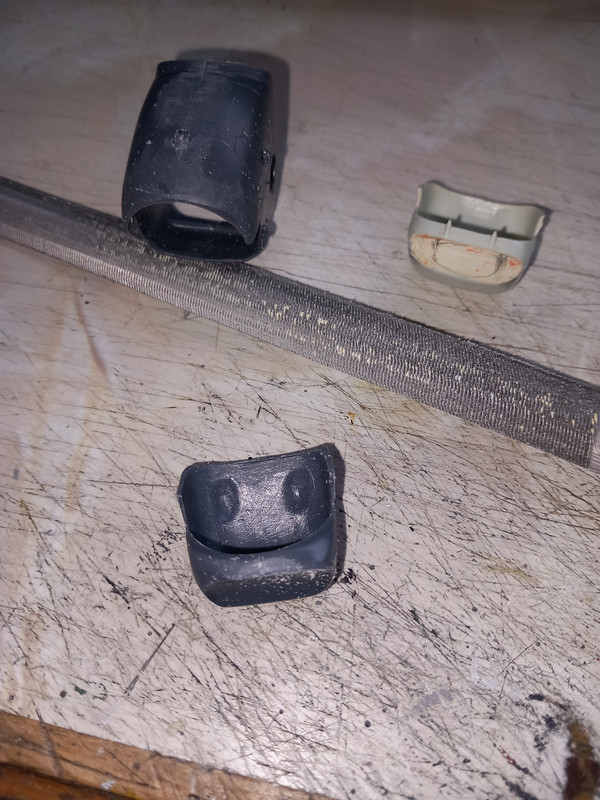

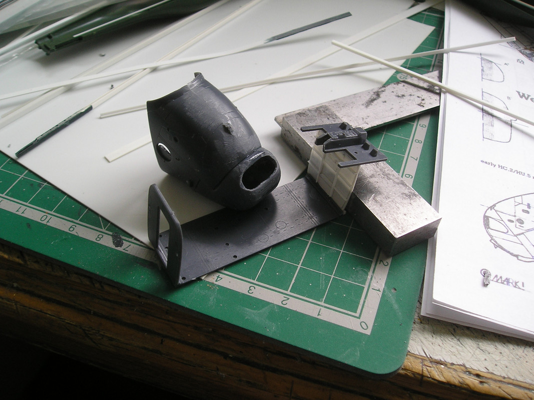

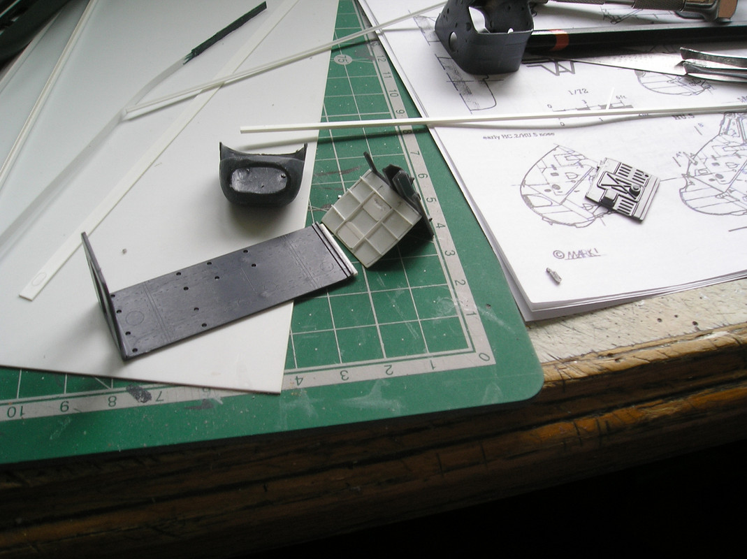

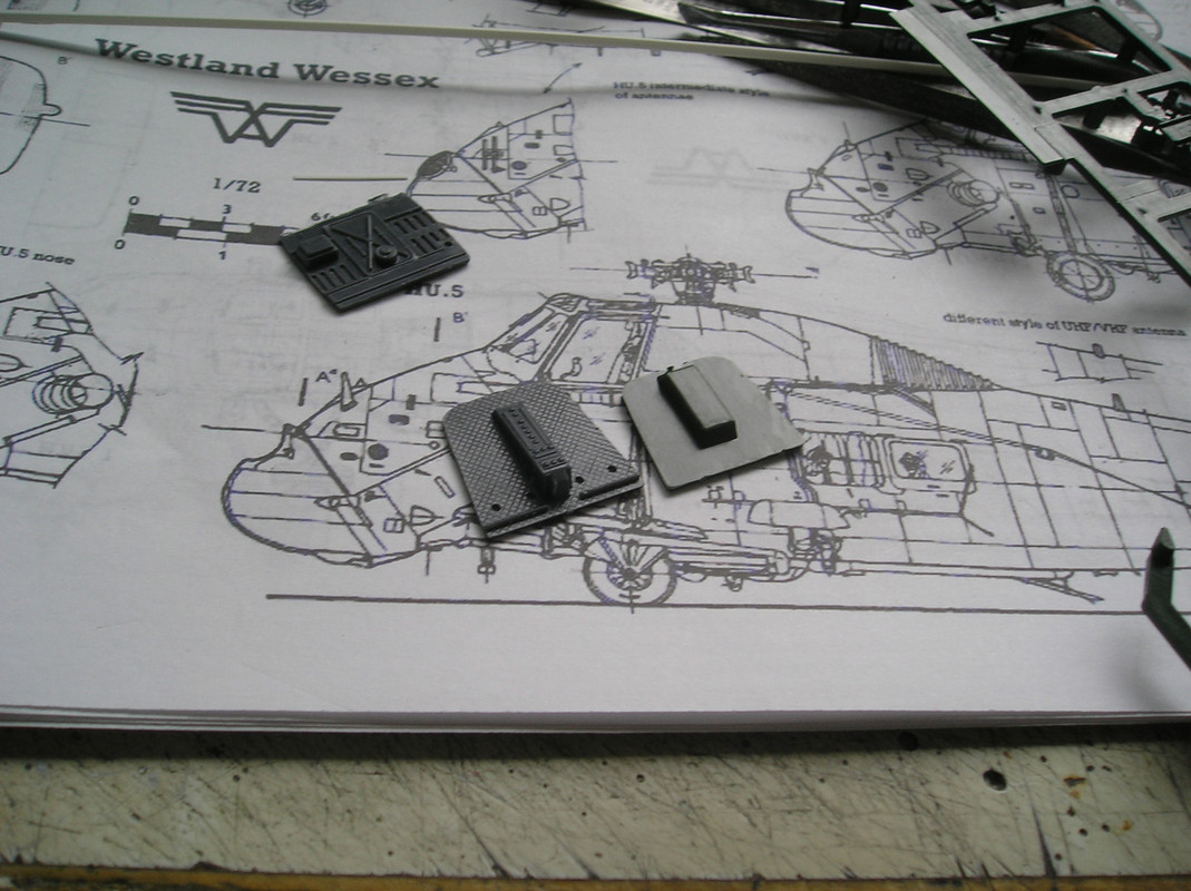

perdu Posted May 24, 2023 Author Posted May 24, 2023 A joy? Who figured? This is just skirting round territory that Alan and Colin have often trod in possibly different scales Steve but might be fun later on As the Italeri bears more 'detail' inside I intend using some of it for the build but frankly some of that detail is spurious in the extreme Here is an example. Much of the Italeri interior is of superior shape so it will be pressganged into sitting quietly inside the Matchboxer However this is where spuriosity reigns, the front panel does have ribs and surface changes but not the shape of the ones in either kit Should that worry me? Hmm maybe not but this is me so I will have to change the front bulkhead I'll try for a better shot of that in the morning, a before and an after I hope. Here's my inspiration, Harry Benson's 'Scram!' I know that as he was proceeding our own Ex-FAAWAFU was driving ships around down there, so an untidy link with a friend. Here's how I plan to fit it all together And this ends model making for today 14
perdu Posted May 25, 2023 Author Posted May 25, 2023 Apart from a tendency to make huge clangers* whilst making models of desire, THIS is why I cant get on with Italeri. Do you see that beautifully moulded panel sitting on the drawing? Fine and dandy ribbing. Panels for access to whatever it is that helicopters keep tucked away under the driver. Whatever it is it isn't THIS. Even the ribs are in the wrong place so I had to knock up one a bit more like, trying to decide whether I should add ribs approximately 0.003" deep. Or draw ribs on after the painting is done? Anyway this is what were getting... Also visible here is the drastically altered jet intake casing, now tacked onto the Italian nose section it belongs to. I have to decide which cockpit rear wall I will be using, obviously the moulded surface in useless anyway, no matter whether by Lesney or Italeri. I expect I will use the Italeri one but the cross hatching doesn't convince me as sound proofing padding somehow. Crack open the Prosecco foil or kitchen roll, both of which often bear quilted surfaces, I rather suspect my owner would prefer the former... It begins. Longerons first in construction. The rest will as night from day, follow. 15

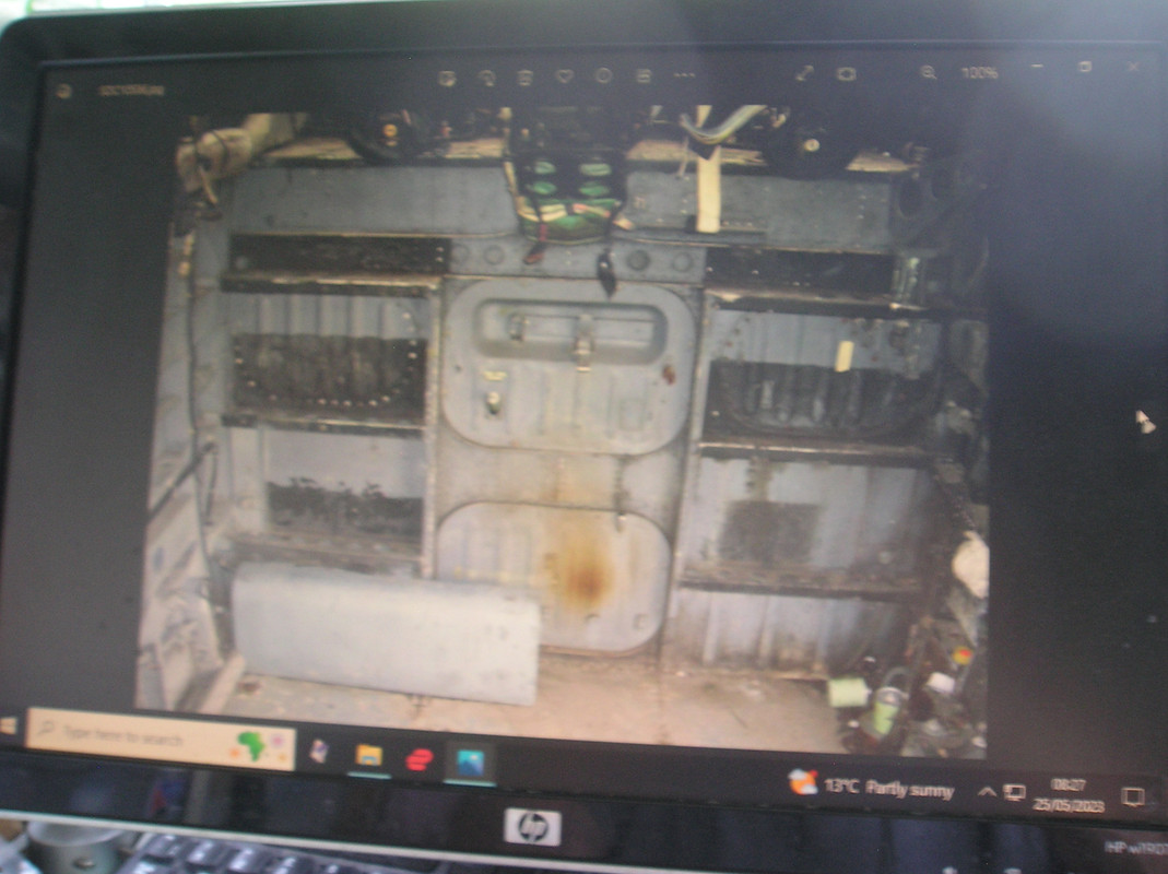

dolphin38 Posted May 25, 2023 Posted May 25, 2023 Are these interior shots of the HU5 cabin of use to you IMGP7774 by Phillip Wilmshurst, on Flickr IMGP7773 by Phillip Wilmshurst, on Flickr IMGP7776 by Phillip Wilmshurst, on Flickr IMGP7775 by Phillip Wilmshurst, on Flickr 7 2

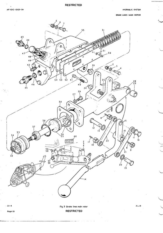

perdu Posted May 26, 2023 Author Posted May 26, 2023 A question for the team. Does the team think that Bill is about to have, inordinate, massive amounts of fun lashing about inside this little thing? Found lurking around in the interweb, yippee! More? OK Cara Italeri, this is how it works back there I wonder if anyone remembers the debacle with the search for a rotor brake on the Wessie's baby sister, crashing around inside the HAR10 in Hendon to no avail. No such worries here. Oh yes this is going to be fun. 8

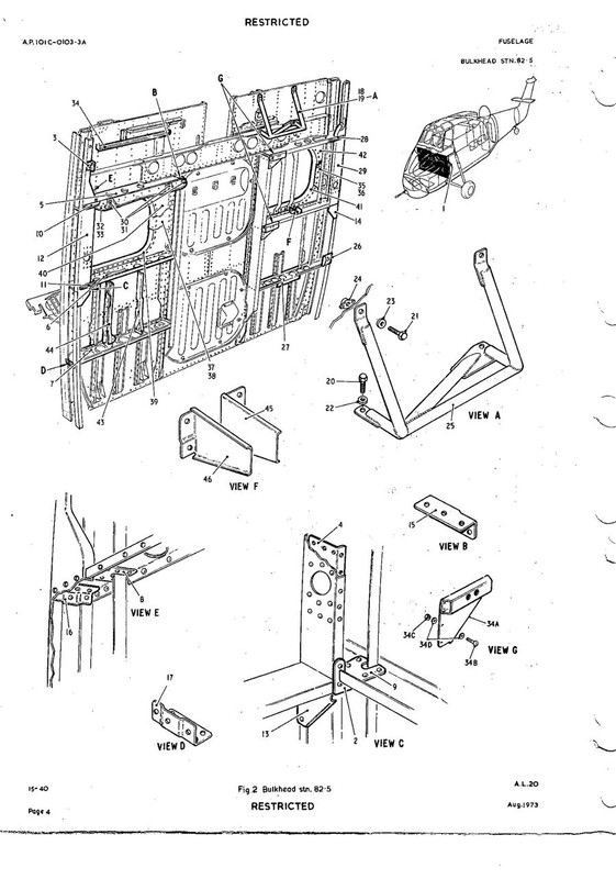

heloman1 Posted May 26, 2023 Posted May 26, 2023 That front bulkhead Bill, looks like it is a throwback to the H-34 kit. Glad you have remade it. To save you some heartache, the item View A, looks like a step I never saw on on a Mk5. I may be putting my foot in it! Colin 1
perdu Posted May 26, 2023 Author Posted May 26, 2023 I quite agree Colin, and as it doesn't show in the above photo of an HU5 that Philip sent us it isn't getting a look in. But irritatingly I saw it yesterday on a Wessex photo for the first time somewhere inside my archive collection place items. Damned if I can find it again.
