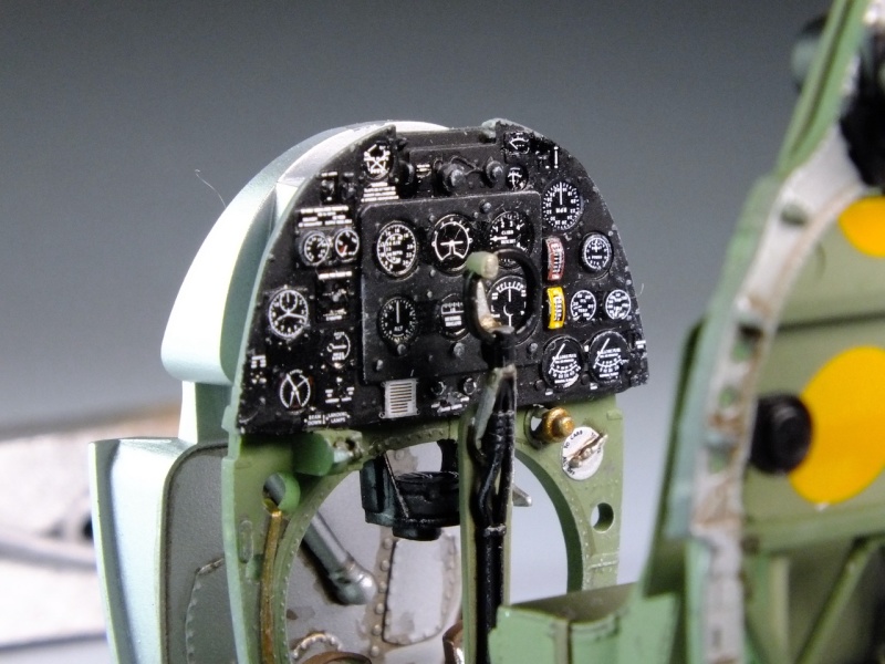

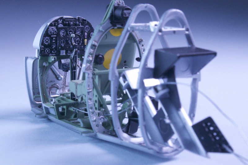

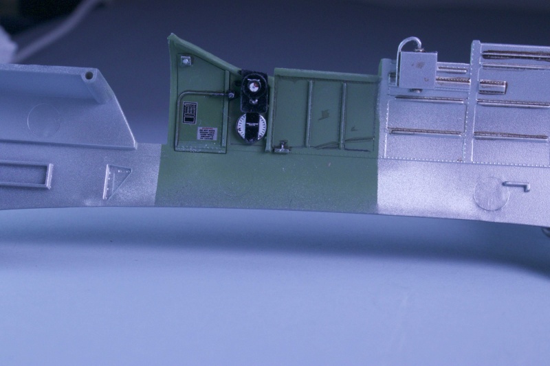

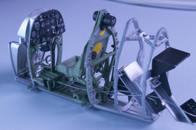

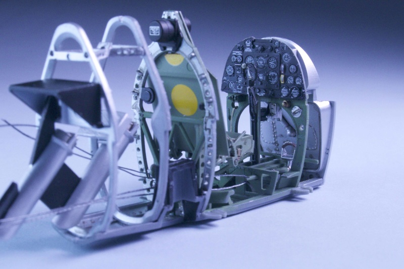

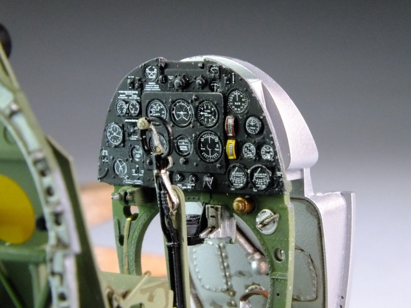

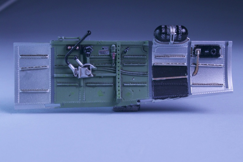

KiwiBob Posted March 19, 2023 Posted March 19, 2023 (edited) Hi all Being fortunate enough to live in the same city as the head office of Kotare Models, I received my pre-order delivery last Thursday evening. Decided, despite many other models on the bench, to move this one to the top - might even get it finished this year (since the birth of my daughter 8.5 years ago I've started many, finished 2....). Has been a pleasurable build so far, nothing out of the ordinary with putting it together. Only thing I have struck is very tight tolerances - so those familiar with Wingnut Wings will know to keep gluing surfaces free of paint. I used thin strips of Tamiya tape to mask areas that would be glued (bulkheads-to-floor for example). Spent a few hours painting, masking, then painting again. Not so sure on some of the colour call-outs - but knowing the people behind the model I'm sure the references and call-outs are accurate - just can't personally bring myself to paint the pilots armour plate black for example. Modelling is a lot about perception I guess (looks like a Spitfire, smells like, etc, etc - in my mind, early Spits have always been green-ish...). Anyway, here is where I'm at so far with the cockpit - a few things still to add, flat coat to apply overall and gloss details to be added to instrument panel. Also still to tension the cables (although I did debate the point of them given the limited visibility - used 0.2 braided fishing line coloured with a silver sharpie - slightly too large but it was either that or .1 which seemed a bit thin...). I've also assembled the wings, wheels, tailplane and fettled some other minor parts ready for final assembly. Cockpit painted with Tamiya paints, some mixed to the Kotare Models guidelines, some not. SMS Silver used for the fuselage. Mig/Ammo and Vallejo paints used for the details. Citadel washes used to cover up my mistakes... Changing cameras... Just goes to show how we can't trust colour images (let alone black and white war time images) for colour accuracy - same lighting, two cameras - one Canon, one FujiFilm - yet the tones, shadows, colour cast, etc, are completely different. Hence I model for enjoyment and don't fret too much about the colour shades and the correct number of rivets! Cheers Bob Edited March 20, 2023 by KiwiBob Change of image host 40 1
Robin-42 Posted March 19, 2023 Posted March 19, 2023 I don’t actually need this kit-I ordered one two days ago! Wow. That panel alone! 2
wschurr Posted March 19, 2023 Posted March 19, 2023 Your detail painting is stunning. It amazes me how a single kit can arouse so much excitement and I’m glad! I hope Kotare sells thousands! 2
RichieW Posted March 19, 2023 Posted March 19, 2023 Nice to see this on the bench after such a long wait. The cockpit looks stunning. I don't need the kit either but have it on pre order from Hannants. Richie

Whitewolf Posted March 19, 2023 Posted March 19, 2023 I opened the images ok and this looks absolutely superb! The best Spitfire model yet?

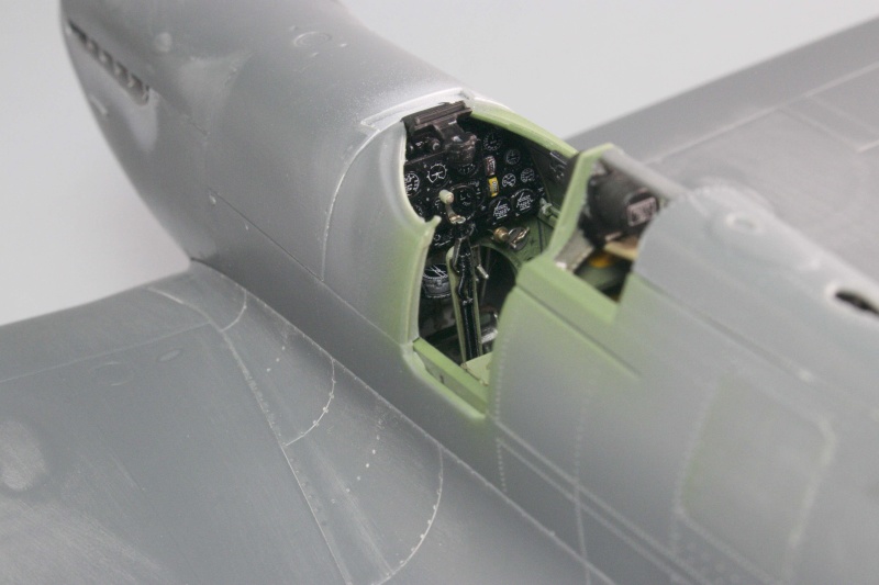

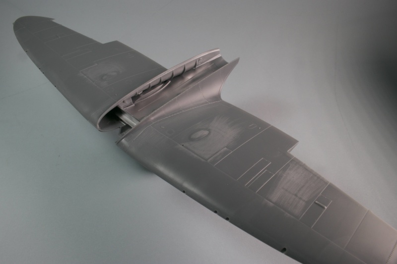

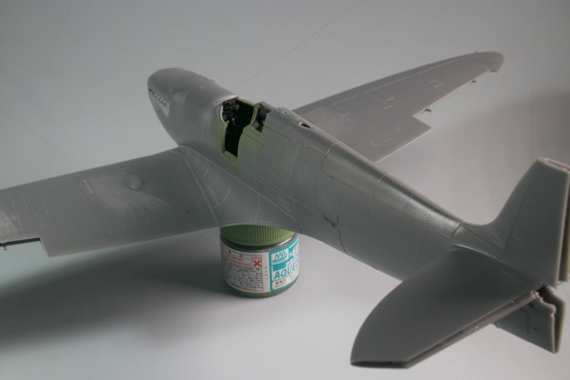

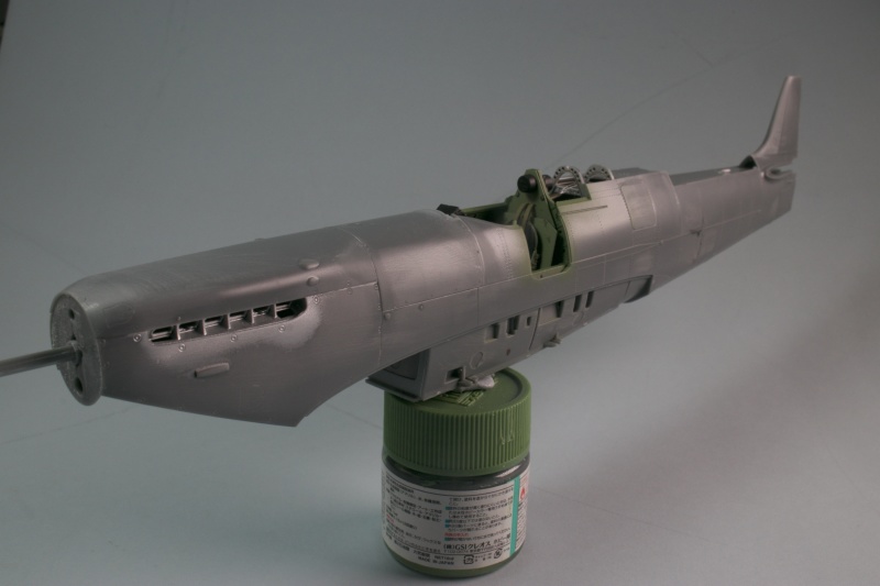

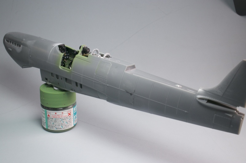

KiwiBob Posted March 19, 2023 Author Posted March 19, 2023 (edited) Hi all Some more progress - buttoned up the fuselage after tensioning the cables and adding a few minor parts (radiator flap lever and rear of the seat harness). A tip if you choose to run the control cables - connect, but don't glue one of the side panels to the central floorpan and frames, then tension the rigging. The reason is the cables run through holes provided on a piece connected to the flare chutes - which is connected at the top, underneath the radio (?) box - so the lower part of the flare chute is floating. If you tension the cables without preventing the last frame from moving (as you tension the cables, the flare chute can be pulled forward), you risk over-tensioning the cables - if that makes sense. Glued the wings together - no surprises although the wheel wells were a very tight fit and I did have to open the small slots that fitted over the main spar. Don't forget the gun barrels. Next step is the spine, fuselage to wing, tailplanes, etc. Cleanup and paint... Cheers Rob Edited March 20, 2023 by KiwiBob Change of image host 29

Scooby Posted March 20, 2023 Posted March 20, 2023 What a revolutionary way to join the wings. Beautiful build. 1
Johnson Posted March 20, 2023 Posted March 20, 2023 Most impressive. The cockpit looks superb. Are the placards, maps etc from the kit or did you add them? Thanks,
RichieW Posted March 20, 2023 Posted March 20, 2023 Looks great, I really like the way the top of the fuselage spine is added separately to show overlapping panels and no seam to fill. The photos are all visible to me and embedded in the thread. Richie
KiwiBob Posted March 20, 2023 Author Posted March 20, 2023 2 hours ago, Johnson said: Most impressive. The cockpit looks superb. Are the placards, maps etc from the kit or did you add them? Thanks, Hi - only thing I’ve added is some rigging for the control cables, everything else is out of the box - no photo etch or resin, just plastic and decals! Cheers Rob 1 1

Biggles87 Posted March 20, 2023 Posted March 20, 2023 Some rapid progress going on here. I like that they have included the landing lamps control, something most kits miss even though it is a very noticeably piece of equipment on early Spitfires. I also like the inclusion of the pilot's true airspeed calculator below the remote contacter. I find early Spitfire cockpits a bit of a minefield in terms of which items to include as things changed so rapidly in the first year of WW II. I had convinced myself that I had enough 1/32 Spitfires, now I'm not so sure. John 3
Phoenix44 Posted March 20, 2023 Posted March 20, 2023 Wow, the black leather on the seat... Utterly realistic, easily the best I've seen.
