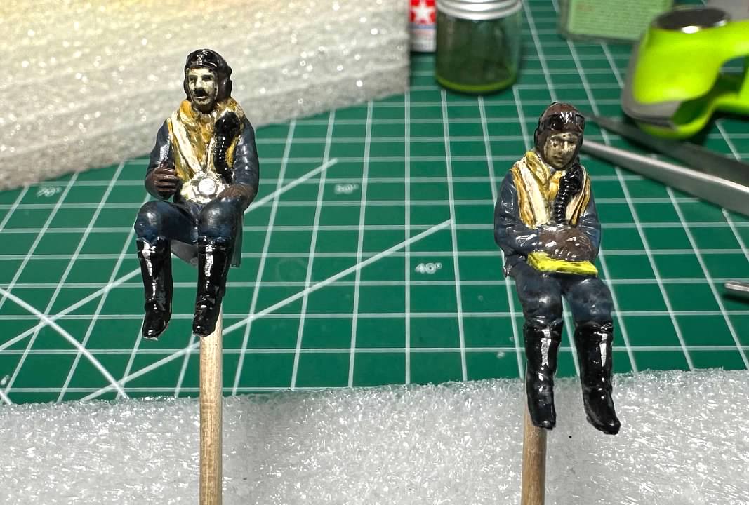

RaisingArizona Posted February 19 Share Posted February 19 Hello All, I am building a Tamiya 1:48 Mosquito and I decided to try to paint the pilot / navigator figures. This is my first attempt at figure painting. I viewed several videos and tried to copy the technique, and here is the result ... Can anyone steer me in the right direction on some tips and techniques. I am not real happy with the result. Looks OK at a distance, but close up doesn't look all that nice. I did coat it with a matt varnish, but till looks a bit shiny. I am going to see if I can get more matt finish with a different clear coat. Thanks, Steve 1 Link to comment Share on other sites More sharing options...
Homer Posted February 20 Share Posted February 20 What i do is putva skin wash on the face ,and a grey wash on the uniform. Then dry brush with the base colour, it works for me . Link to comment Share on other sites More sharing options...
moondrome Posted February 20 Share Posted February 20 Hi Steve, What kind of paint are you using? You should try to use water diluitable colours like Vallejo, ak 3d gen, citadel etc. And i would avoid glossy colours in general. As Homer says using the dry brush technique over the base colour to make highlights is good. And make a lot of practice! Link to comment Share on other sites More sharing options...
Slackbladder Posted yesterday at 08:04 AM Share Posted yesterday at 08:04 AM (edited) Steve I used to have the same problem when matt varnishing my old Warhammer figures, always made them come out shiny. I think all the super-duper matt finished figures you saw in the magazines were photographed before varnishing for this very reason. As these guys will be locked away in a cockpit there's probably no need to varnish at all if you can't get one that gives you a matt finish. I still use Citadel paints with the techniques mentioned above. Edited yesterday at 08:07 AM by Slackbladder Link to comment Share on other sites More sharing options...
oileanach Posted 16 hours ago Share Posted 16 hours ago On 2/19/2023 at 9:23 PM, RaisingArizona said: Hello All, I am building a Tamiya 1:48 Mosquito and I decided to try to paint the pilot / navigator figures. This is my first attempt at figure painting. I viewed several videos and tried to copy the technique, and here is the result ... Can anyone steer me in the right direction on some tips and techniques. I am not real happy with the result. Looks OK at a distance, but close up doesn't look all that nice. I did coat it with a matt varnish, but till looks a bit shiny. I am going to see if I can get more matt finish with a different clear coat. Thanks, Steve I recently had something similar. I got myself a bottle of Mig Ultra-Matt Lucky varnish. The name's a bit of a mouthful, but the varnish itself did the trick. It's pretty cheap, £2.96 from my preferred online seller (not sure if we're allowed to plug them?). Even with postage you'll be looking at less than a fiver. Link to comment Share on other sites More sharing options...
Matt P Posted 14 hours ago Share Posted 14 hours ago I always bin the stock plastic figures and buy pj productions resin ones. Much more detailed so look better once painted. 1/48 is difficult to get detail so don't try to do eyes etc. Just a thin line of black is enough. Vallejo matt varnish is great but better sprayed than brushed. Link to comment Share on other sites More sharing options...
