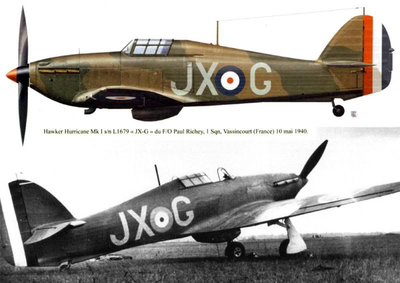

Troy Smith Posted February 8 Share Posted February 8 24 minutes ago, Hammer2023 said: I'm a bit confused on the variations offered within the kit and the variations of the MK I Hurricane I mentioned it was complex if you want to be accurate.... Props and spinners.... ah ha ha ha.. https://www.britmodeller.com/forums/index.php?/topic/234980181-hawker-hurricane-propellers-and-spinners-a-modellers-guide/ Is there a scheme you are looking at doing? They kit decals are for fabric wing.... 3 1 Link to comment Share on other sites More sharing options...
Hammer2023 Posted February 8 Author Share Posted February 8 That really is a deep dark rabbit hole to disappear down! I bought a decal set with a few options, so haven't finalised on that as they haven't arrived yet, but I'm not totally opposed to just using the box art and decals. Are the metal and fabric wings visually different? I notice you commenting on one of the photos in that threat you linked about it being hard to tell. I'm starting to think it might make life easier to go two blade prop and follow the box art! Link to comment Share on other sites More sharing options...
Troy Smith Posted February 8 Share Posted February 8 1 hour ago, Hammer2023 said: What I'm not sure is if this wing configuration is appropriate for the three blade prop? My confusion is added to by reading Robinson's 'A Piece of Cake' at the moment, and when CH3 gets the squadron's first 3 prop blade Hurricane, it has metal wings. Piece of Cake is fiction. As I posted above, there are lots of props and spinners. 3 blade props are seen from mid 1939, AFAIK, from the factory you get the DH Spitfire type, and then the DH Hurricane type. The DH Hurricane type is what is seen as a replacement for the 2 blade type. The limiting factor on replacement was the engine, the Merlin III had a universal prop shaft, the Merlin II does not. About the only thing you won't see is a 2 blade prop with a metal wing. 1 hour ago, Hammer2023 said: Also, the little bumps on the nose. When were these removed? When the side venturi was removed, the bumps cover the vaccum pump that replaces the venturi on one side. The nose ring got replaced when this happened. Venturi is only very very early. There are also some tiny little doors at the top on the UC doors, only seen on very early planes... 1 hour ago, Hammer2023 said: And the last query, how do the flat and spin strake tail sections fit into all of this? Appropriate for the 2 blade or not? Only seen on very very early planes, and another easy upgrade, Only seen with a 2 blade prop. There are not masses of photos of these very early planes, and they were progressively upgraded. 1 hour ago, Hammer2023 said: So, can this kit be used with the 3 blade prop and still be reasonably accurate? Or was it introduced in conjunction with the metal wings? there is no plain switch. there is only a start of metal wings, L1877 IIRC< and if you are lucky this is noted in production records... see link below. 1 hour ago, Hammer2023 said: (I may use aftermarket decals I have to put it into the summer of 1940, but undecided on this as I also have the Arma Mk I, so might be nice to leave this as a 2 blade...). Roughly when did the 3 blade come in, and did the late ejector exhaust come in at the same time as it? To really confuse matters, in the summer of 1940, due to the fighter emergency Hawker built 50 Hurricanes with fabric wings, that are otherwise standard mid production Mk.I's Even more fun, they are randomly mixed in! see here and following posts https://www.britmodeller.com/forums/index.php?/topic/235005804-hurricane-p3886-uniqe-fabric-wing/page/2/#elControls_3735801_menu Exhausts, see photos.... Perhaps more usefully, the Airfix kit is limited to what can be built with what's in the box, as it has the early style windscreen. Initially these did not have armour, and were retrofitted with external armour. This type gets replaced during the L**** series, (first batch of 600) and the straight lower edge becomes standard. (with the inevitable exception https://www.britmodeller.com/forums/index.php?/topic/235083989-hurricane-73-sq-france-may-1940-tp-o-p25-but-early-windscreen-fitted/ though this in the only example I have seen like this, problem is lack of photos, especially with visible serial) Note in one boxing airfix supply decals for VY-G/C (it's G BTW) which has the serial painted out, and this has the internal armoured screen and a DH Spitfire spinner, which are not in the kit. The Airfix kit also supplies 4 spoke wheels, which are fitted from the P**** series, prior to that they are 5 spoke, and a later aerial, which was initially a pole type. The prop in the Airfix kit is the 3 blade De Havilland Hurricane type. I did warn you that the Mk.I Hurricane is more complex than usually realised...... And there is an awful lot of tosh out there on the subject. In particular the Valiant Wings Airframe and Miniature No.16 is a case of style over content, as are the SAM modellers guide by the same authors. If you fancy a deeper delve, get the Wingleader Photo Archive https://www.wingleader.co.uk/shop/hurricane-mki-wpa3 Which is very very good, and the only book which is basically accurate. HTH 2 2 Link to comment Share on other sites More sharing options...
Troy Smith Posted February 8 Share Posted February 8 3 minutes ago, Hammer2023 said: That really is a deep dark rabbit hole to disappear down! I'd only just started. 3 minutes ago, Hammer2023 said: I bought a decal set with a few options, so haven't finalised on that as they haven't arrived yet, but I'm not totally opposed to just using the box art and decals. Which set? 3 minutes ago, Hammer2023 said: Are the metal and fabric wings visually different? I notice you commenting on one of the photos in that threat you linked about it being hard to tell. 3 minutes ago, Hammer2023 said: I'm starting to think it might make life easier to go two blade prop and follow the box art! Yes, they are different, but you need a clear photo to see the differences. What is the box art? the 111 Squadron option? Or the JX-G 1 Sq? 3 1 Link to comment Share on other sites More sharing options...
Hammer2023 Posted February 8 Author Share Posted February 8 It's the A01010A Kit, with the box art for LI679, of No. 1 Sq, Northern France Spring 1939. The decal set I ordered is this one: https://www.super-hobby.ie/products/Hurricane-Mk.I-Pt.II.html . There's quite a selection of Mk I options from 1940-1941 with both Northern Europe and Med options Right now, this is the option selection I'm considering: -2 blade prop -ventral section with keel -unarmoured cockpit bulkhead -unarmoured front canopy section -sanding the wing section flat behind the gun inspection hatches Does that make sense, or am I going off course anywhere? Thanks again! 2 Link to comment Share on other sites More sharing options...
Troy Smith Posted February 8 Share Posted February 8 16 minutes ago, Hammer2023 said: There's quite a selection of Mk I options from 1940-1941 with both Northern Europe and Med options All are metal wing. Overall it's a good sheet, I know the photos for most of them. Some great schemes. 18 minutes ago, Hammer2023 said: Right now, this is the option selection I'm considering: -2 blade prop -ventral section with keel -unarmoured cockpit bulkhead -unarmoured front canopy section -sanding the wing section flat behind the gun inspection hatches Does that make sense, or am I going off course anywhere? No, all good. Well researched! Top of the class! Note pole aerial. or I'd ignore the profile. Note no serial. These were usually painted out for security in France. As later was the JX see cheers T 3 1 Link to comment Share on other sites More sharing options...
