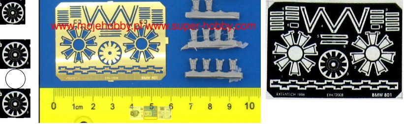

PeterB Posted January 10, 2023 Share Posted January 10, 2023 Hi Steve Yes, I noticed the absence of cooling fans when I built my 188E earlier. Apparently Airwaves did a conversion set with them but I think it is no longer available and I noticed elsewhere somebody is thinking of making a copy of those in a Revell Ju 290 kit, but I did not bother. Pete Link to comment Share on other sites More sharing options...
stevesoutar Posted January 10, 2023 Author Share Posted January 10, 2023 3 hours ago, PeterB said: Hi Steve Yes, I noticed the absence of cooling fans when I built my 188E earlier. Apparently Airwaves did a conversion set with them but I think it is no longer available and I noticed elsewhere somebody is thinking of making a copy of those in a Revell Ju 290 kit, but I did not bother. Pete Its a small detail, especially at 1/72nd scale, that I would not have noticed - and no-one looking at my models (apart from everyone online here) woould ever realise or care .... But now I do know, i'm trying to decide how much I care ... I have just printed out a couple of fans onto plain printer paper, and two more on a sheet of glossy photographic paper, so I am going to have a go cutting them out witha scalpel & see if that will do the job well enough for me Image cropped from a 1/72 BMW 801 engine kit online (PE & resin) - I can't gring myself to pay another £15 for engines which will be mostly invisible once assembled - for a diorama with engines exposed maybe, in the future this is a jpeg & have made - cooling fans cropped, and scaled to around 11mm diameter, which seems to fit nicely behind the spinner (the circle between is 10mm, as a reference) 3 Link to comment Share on other sites More sharing options...
Bertie McBoatface Posted January 10, 2023 Share Posted January 10, 2023 4 minutes ago, stevesoutar said: Its a small detail, especially at 1/72nd scale, that I would not have noticed - and no-one looking at my models (apart from everyone online here) woould ever realise or care .... But now I do know, i'm trying to decide how much I care ... I have just printed out a couple of fans onto plain printer paper, and two more on a sheet of glossy photographic paper, so I am going to have a go cutting them out witha scalpel & see if that will do the job well enough for me Image cropped from a 1/72 BMW 801 engine kit online (PE & resin) - I can't gring myself to pay another £15 for engines which will be mostly invisible once assembled - for a diorama with engines exposed maybe, in the future this is a jpeg & have made - cooling fans cropped, and scaled to around 11mm diameter, which seems to fit nicely behind the spinner (the circle between is 10mm, as a reference) A cunning plan indeed. 1 Link to comment Share on other sites More sharing options...

stevesoutar Posted January 10, 2023 Author Share Posted January 10, 2023 If anyone else want to make cooling fans for BMW 801 engines, this jpeg file should come out in the correct size for 1/72 if you download it & print it on an A4 sheet Using a scalpel, I cut two fans out of a sheet of plain printer paper, it seems good enough for this scale. The fan goes behind the base of the prop spinner Once the motor was assembled, I used fine forceps to put a twist on each of the blades 4 Link to comment Share on other sites More sharing options...

Lanmi Posted January 11, 2023 Share Posted January 11, 2023 15 hours ago, stevesoutar said: Using a scalpel, I cut two fans out of a sheet of plain printer paper, it seems good enough for this scale. The fan goes behind the base of the prop spinner It looks convincing, be sure to soak it with varnish to avoid wrinkles over time. Nice save with those 188 engines, looking forward for further progress pictures. 1 Link to comment Share on other sites More sharing options...
stevesoutar Posted January 11, 2023 Author Share Posted January 11, 2023 2 hours ago, Lanmi said: It looks convincing, be sure to soak it with varnish to avoid wrinkles over time. Nice save with those 188 engines, looking forward for further progress pictures. that sounds like a good tip - i hadn't considered that, I guess moisture could mess them up thanks @Lanmi 1 Link to comment Share on other sites More sharing options...
