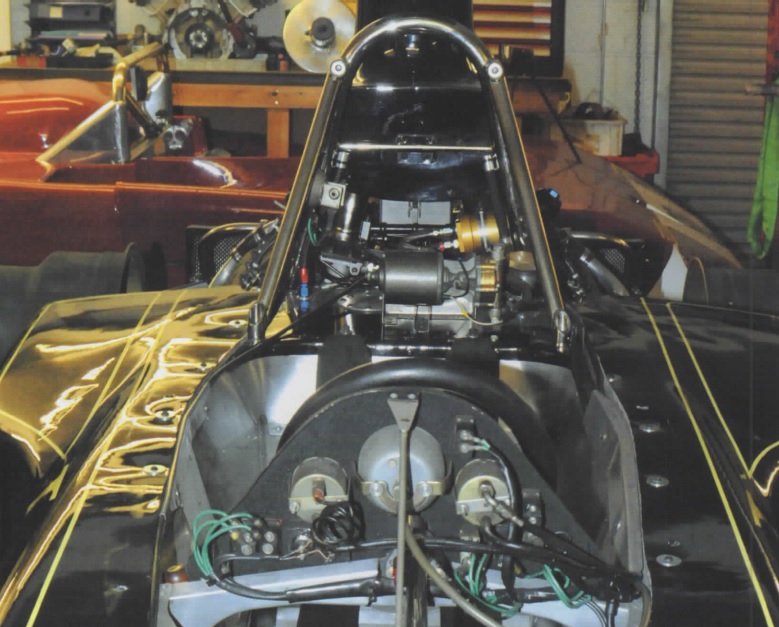

Question; Does anyone of you have some reference pictures of the wires on the instruments/gauges on the dashboard?
Every wire, hose and tube is there on the engine in this kit. Really impressive. In that light, the dash is put a bit behind I feel.
In the books I have on this car, there are no good pictures from the back of the dashboard.
There are a couple of photos on page 61 of the Haynes manual?
Here's one http://scaleautoworks.com/assets/L72Dash.jpg
I only have the Pete Lyons book, and a Emmerson Fittipaldi book.
But the picture from Brady is already very helpful.
Thanks for helping me.

I have some doubt about the two belts that go from the fire extinguisher to the bottom of the seat. This way they look to have no function.
They come from nowhere, and the end nowhere.
Is this right?
