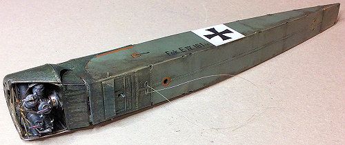

Sandbagger Posted January 15 Author Share Posted January 15 Hi all, Fuselage more of less complete now. 'Flory Models' Dart Dirt clay wash and 'Tamiya' Weathering Master Set A and C. 'AK Interactive' Kerosene wash used under the fuselage at the engine. Decals applied and sealed with 'Alclad' Light Sheen (ALC311). Now it's onto painting and pre-rigging before building continues, Mike 5 Link to comment Share on other sites More sharing options...
