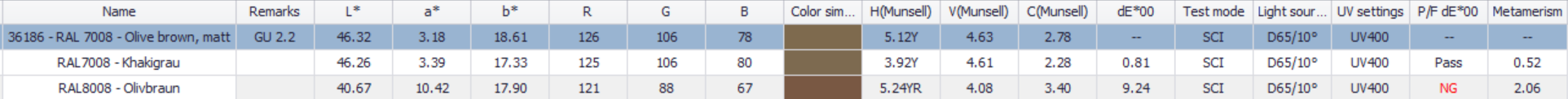

Troy Smith Posted February 2 Share Posted February 2 On 31/10/2022 at 20:35, Casey said: RAL color matches Matched with RAL K5 color fan. I've matched most of them and they all are pretty close matches, here are some examples A question, you list 36186 Olive brown as RAL 7008. RAL 7008 is listed as Khaki Grey https://www.ralcolorchart.com/ral-classic/ral-7008-khaki-grey RAL 8008 is listed as Olive brown https://www.ralcolorchart.com/ral-classic/ral-8008-olive-brown the Revell sites does not list a RAL code https://www.revell.de/en/products/modelmaking/colors-accessories/aqua-colours/aqua-color-olive-brown-matt-18ml.html I ask as RAL8008 is the colour used by the Israeli AF in the blue/brown scheme of the late 1950's to late 1960's , so which is 36186? Thank you Link to comment Share on other sites More sharing options...
Casey Posted February 2 Author Share Posted February 2 (edited) 30 minutes ago, Troy Smith said: A question, you list 36186 Olive brown as RAL 7008. RAL 7008 is listed as Khaki Grey https://www.ralcolorchart.com/ral-classic/ral-7008-khaki-grey RAL 8008 is listed as Olive brown https://www.ralcolorchart.com/ral-classic/ral-8008-olive-brown the Revell sites does not list a RAL code https://www.revell.de/en/products/modelmaking/colors-accessories/aqua-colours/aqua-color-olive-brown-matt-18ml.html I ask as RAL8008 is the colour used by the Israeli AF in the blue/brown scheme of the late 1950's to late 1960's , so which is 36186? Thank you It is RAL7008. The RAL equivalent is given on their site here: https://content.revell.de/revell-colors/en.html#revell-aqua-color They call the color 36186/32186 RAL 7008 Olive brown The paint label contributes to confussion, as the label reads (line by line) Khakibraun, matt, Olive brown, matt, 36186 Gris kaki, mat, Kaki, mat. Spectrophotometer readouts show: So it is a great match for RAL7008, and definitely a "nope" for RAL8008. Edited February 2 by Casey 1 Link to comment Share on other sites More sharing options...
