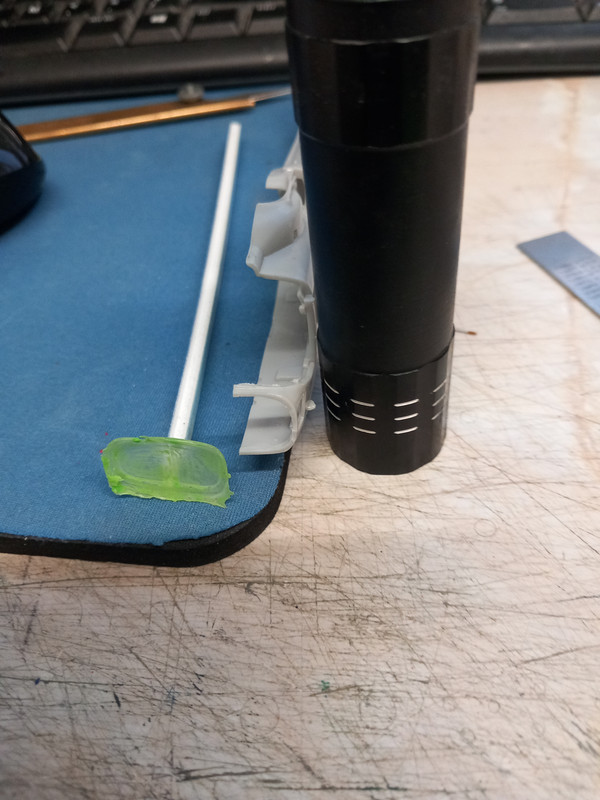

I am trying out ways to replicate the skin of the nose that has been torn apart, this version has a Lynx nose dipped into plasticene and withdrawn to leave a replica of the nose in negative form.
Now I want to try running UV setting resin around the walls of the skin and lamping the recess of resin with the UV torch

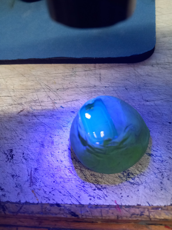

The purple light IS shining into the resin here
But the flash flooded the image, flash now off.
Green plasticene-a-like doesn't like to let go when the parts are removed
I was hoping this will look like torn and tattered skin forced apart by the bomb pulling off the radome, especially if coupled with some/lots of this
Oh well on we go, more thoughts on doing this coming along.

Bill, I think your resin may well have reacted with the oils in the Plasticene, horrible stuff to work with. Maybe try some air-drying modelling clay, which should become inert once hardened.
When I was involved with the Mould makers Guild in Johannesburg, Plasticene was frowned upon!
Colin the Wessex nut
Yes I think so too Colin, it will let its layer of 'cene go eventually but I'm not too worried just now 'cos it  is just a 'test the concept' idea.
