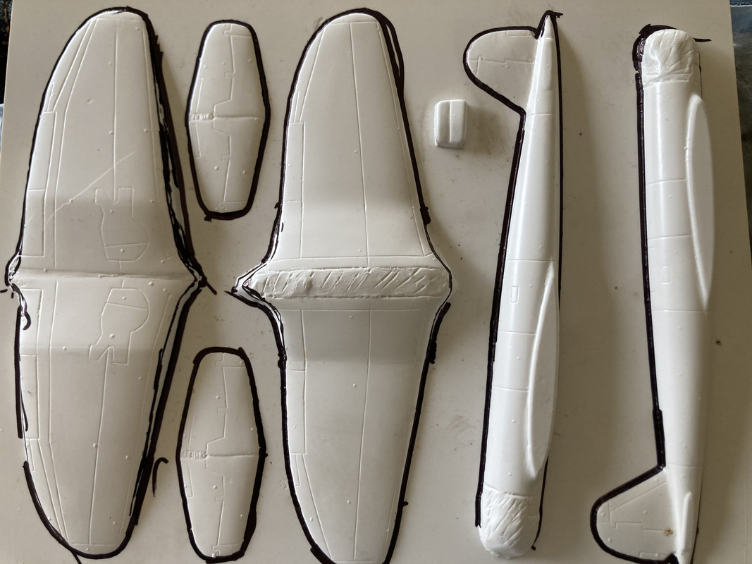

Marklo Posted September 22, 2022 Author Share Posted September 22, 2022 (edited) Out with the sharpie….. For a potential bomber it’s not a big plane, closer to a Stuka in size than a He111 or a Do17. Edited September 22, 2022 by Marklo 5 Link to comment Share on other sites More sharing options...
Corsairfoxfouruncle Posted September 22, 2022 Share Posted September 22, 2022 1 hour ago, Marklo said: Out with the sharpie….. For a potential bomber it’s not a big plane, closer to a Stuka in size than a He111 or a Do17. I wonder how big it is compared to an He.70 ? 1 Link to comment Share on other sites More sharing options...
Marklo Posted September 24, 2022 Author Share Posted September 24, 2022 Parts cut out and partially sanded. 10 Link to comment Share on other sites More sharing options...
