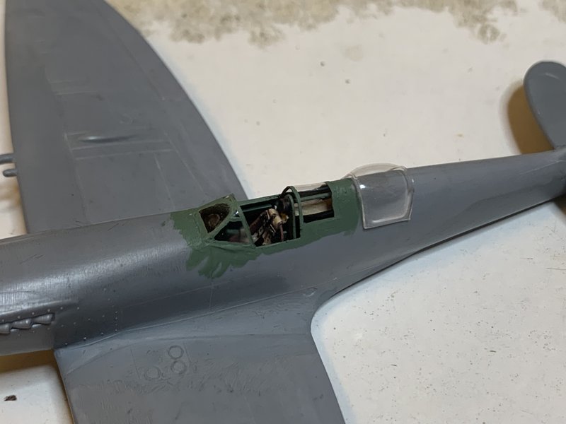

I have chopped up another Falcon canopy, this time from set #2 "RAF Fighters", and I have a windscreen and opening canopy part:
E997-C142-7-E95-494-F-A459-B74868-EAD254
The rear section is simply some clear plastic heated over a flame and squished over the rear fuselage before trimming. Front and rear parts have been canopy glued down, and all gaps have been covered with a ridiculously thick coat of Humbrol 78 ready for a bit of sanding down.
An easy solution that I've used before. Nice Falcon canopy, very clear and sparkly. Have to tried the Rob Taurus canopies? Very nice but hell to cut out.

So, naïve question; the heated clear plastic doesn’t tend to stick to the fuselage it’s been formed over?
There are only naïve answers!
No, it doesn't if you do it pull it over as soon as it starts to get floppy over a candle flame. There isn't enough heat to transfer to the fuselage from the thin plastic.
Regards,
Adrian
[edit] that said, I wouldn't ever build a vacform buck out of polystyrene.

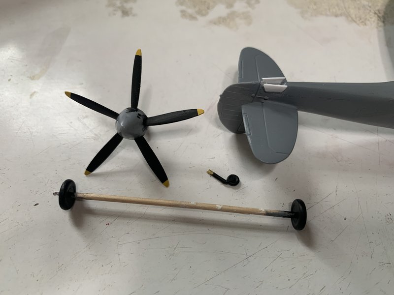

Some micro-progress:
33491-E4-F-7-FCA-4655-88-C8-70182-DC6-F1
Tail wheel doors added.The kit tail wheel is too small so this one is cut out of the retracted outrigger wheel from the Airfix P1127 kit with a brass tube sleeve. Wheels are painted and the propeller is mounted up so that it can be pushed into the tube in the nose and spin freely.
All blessed relief from my NMCZ build!

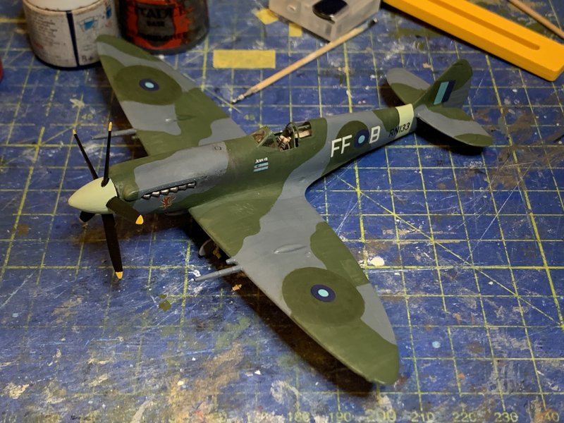

In another bout of displacement activity to avoid my NMCZ GB duty, I've more or less finished the painting:

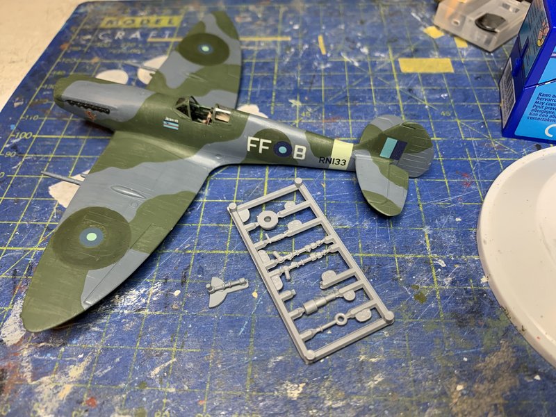

Rather annoyingly, the undercarriage legs both snapped off while painting. I'm not sure whether I will mend them or use the spare ones from my wheels up build:
77-A2-E3-D5-2-BD9-4-C68-91-AE-AEED22-EA0
I will try lashings of thick CA first, and do the repair properly if that doesn't work.

Here's the problem:
06-A32274-673-B-4-AA6-A395-2-C9-B7-BF253
You can see that the legs have snapped in between the two large bushes. They have very sharp angles and take a lot of cleaning up, and the sideways stress of holding them for painting overcomes the cheesy plastic quite easily. Too thin to pin so I will try a blob of CA, and if that doesn't work I can replace the legs.
Also you can see my fun with the decals. I had two sets, one that wasn't yellowed with  white crescents poking out of each roundel, and one that was with horrible crinkly film at the edges. I've touched up the crescents on the fuselage but I think I need to replace the wing ones to match. The badge and lion have worked well, after some touching up with a brush.

Replaced the wing decals, touched up the white crescents, repaired the undercarriage and footled with a seemingly endless snagging list:
3-C862696-7-E67-48-C3-9-F4-A-A21-A295083
Of course, where the legs broke was right above the first pin to the door, so max stress point. Confident that the blob of CA will do the trick from here on in.
Getting there slo-o-wly... 🐌

Good to see this backnon the go Adrian,  looking good with the paint, what a shame about the undercarriage legs snapping, but great to see repaired.  The overpainted roundels look good too.
