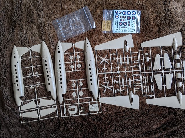

Mjwomack Posted June 1, 2022 Share Posted June 1, 2022 (edited) Already I'm wondering if I've bitten off more than I can chew, but more on that later! I'm in with the Valom Vickers Viking C.2 (Royal Flight), already I think three V's in an alteration is worth something. It comes in a proper box with a lift off lid and is so solid no cat will be able to resist sitting in it! So, let's get the bits and bobs out and make room for the cat... It's not just the cat that's happy; there's a little sheet of etched brass that's got the carpet monster happy as well! And a spare fuselage (could be handy for the proposal) Decals and instructions A choice of VL233 for Queen's flight (1956) or VL247 King's flight (1947). This is going to be easy isn't it? VL233, biff bash boff proper job and off to the pub before you can say Platinum Jubilee! Ah yes though, I did say I wondered if I'd bitten off more than I can chew. Good job I'm not doing VL233 for the king isn't it? Because the decal options are wrong. Decal 16 is actually a common for both as an instrument panel. Only decal 8 for Queen's Flight is provided. And this matters because tucked away in an unused part of my memory is that a 'queens' crown and 'king's one are different. Google agrees, basically a Kings one goes up and a Queens has a 'dimple' plus the decal is for EIIR. Obviously none of this is a problem because this is all about the Queen's flight option and its a lovely looking decal for that. No, the real problem is VL233- I can't find the clinching photo of Queenie-love with it, only of VL 247, and that's only of the tail so I don't know what the markings should be. What I need is a gallant knight of the realm to confirm that VL233 was used by HM and I'm back in the clear.. ...Otherwise, I'm in deep about markings We'll worry about bare metal finish later!!! Edited June 2, 2022 by Mjwomack Title change 8 Link to comment Share on other sites More sharing options...

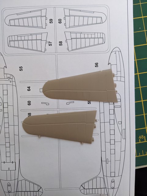

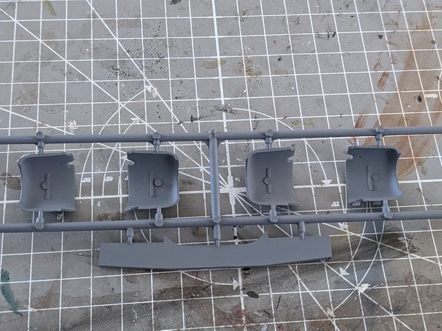

Mjwomack Posted June 9, 2022 Author Share Posted June 9, 2022 At top the horizontal stabiliser parts, and they look exactly like this on the sprue. Below are the spares in the box, which I assume are for making a Valetta. In all cases the reverse face is completely smooth. So there's no way 57 can go with 59 and look plausible, equally if 57 goes with 58 then they become very asymmetrical and that feels all wrong. Hoping there's a Viking expert out there who can put me right (Google is very keen that I know how Viking cruises go into Valetta!) Otherwise, I'm going with the Valetta parts. Looking at the only built example I've found on the t'internet, I won't be the first person to take this option. 1 1 Link to comment Share on other sites More sharing options...
Dave Swindell Posted June 9, 2022 Share Posted June 9, 2022 11 minutes ago, Mjwomack said: equally if 57 goes with 58 then they become very asymmetrical and that feels all wrong. It may feel wrong but it is right. 57/58 are top & bottom of the stbd tailplane, 59/60 are top & bottom of the port tailplane - check the plan views in the painting guide they show the assymetric tips. It's an aerodynamic fix for something that escapes me at the moment ( @Graham Boak?) and wasn't uncommon on aircraft of the era DH used it on the Dove and Heron for example. 1 1 Link to comment Share on other sites More sharing options...
Mjwomack Posted June 9, 2022 Author Share Posted June 9, 2022 Huge thanks. A case of so wrong it's right Link to comment Share on other sites More sharing options...

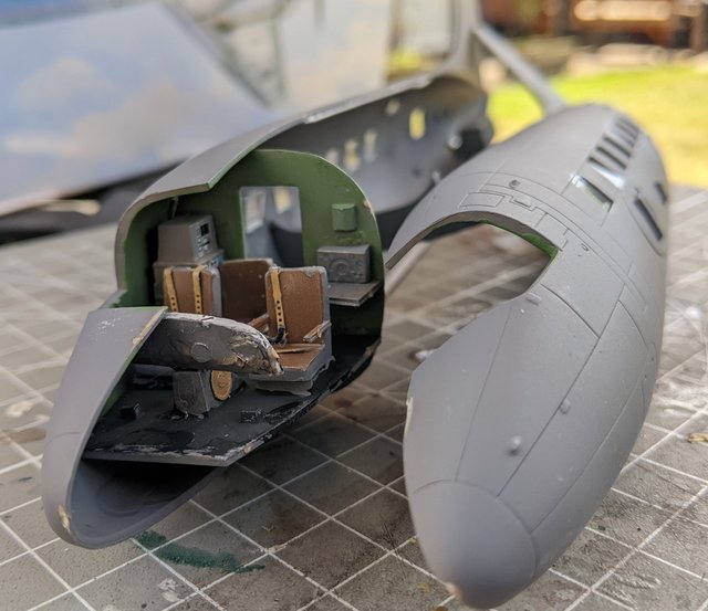

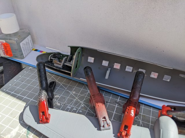

Mjwomack Posted June 20, 2022 Author Share Posted June 20, 2022 Even allowing that I skipped the throttle levers and three parts of the seat harnesses completely disappeared (the carpet monster denies it so maybe they're stuck to the cat), this is still the most detailed flight deck I've ever done. Shame most of it will soon be out of sight but it was a bit of fun. Also bizarre how there's a complete lack of cabin detail the other side of the cockpit door. Given how large and clear the cabin windows are, this even more of a pity. The notorious centre spar is there, apparently this made the plane unpopular with cabin crew whereas a certain type of business traveler was very keen on certain seats. Presumably HMQ never clambered over it to visit the crew! Anyhow bit more curing time in the hot sun and it'll be getting joined up. 4 Link to comment Share on other sites More sharing options...
Mjwomack Posted June 20, 2022 Author Share Posted June 20, 2022 And another view as one of the main wings does some sunbathing as the cement sets 4 Link to comment Share on other sites More sharing options...

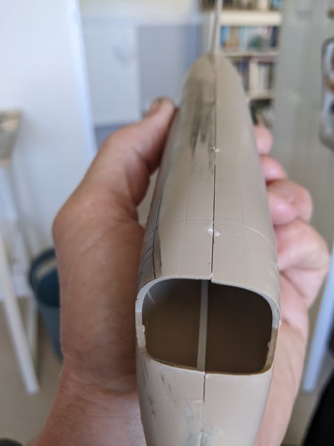

TheyJammedKenny! Posted June 30, 2022 Share Posted June 30, 2022 Hey, @Mjwomack! You're making great progress on this, and as a veteran of the Valetta kit, I can confirm that you have the right idea about treating this as you would a vac-form. I would only caution that the plastic thickness on the fuselage top and bottom can vary between the right and left halves, which means that you might get an uneven surface after you assemble it, so check your fit carefully. The windows are incredibly clear, so protect them carefully. I see you have the wings together, and that's good, but be prepared for a "fight" to align at the wing root with the spar. On mine, I needed to add 1mm of plastic to the wing leading edge inboard of the engines so that it would align neatly with the fuselage wing stub fairing. Remember that there is a slight raised lip on the fuselage around the entire wing representing a doubler plate, so leave that intact. Also, regarding the engines, you just might want to substitute the engines, nacelles, and cowl flaps with those from a Wellington III or other Bristol Hercules-powered Wellington variant. If you do that, be advised that you'll need to trim back the engine stubs on the wing nacelle to account for a new "firewall" location. Otherwise, use the kit's engines, but sand the cowl flaps at the top until they are exactly even up and down--the kit's cowl flaps represent a Valetta. The engines themselves are a little squirrelly when it comes to keeping them on the wing. What else? Well, if you're ambitious about the shape of the cockpit roof and forward fuselage, I would add some plastic and filler to the "eyebrow" area just above the windshield, as well as carefully sand the upper fuselage to avoid a "flat" roof. The real thing had a slightly ovoid cross-section, and the roof of the fuselage was crowned fore-to-aft. Don't worry about a navigator bubble, as these Viking C.2s didn't have one. Best! Alex 1 1 Link to comment Share on other sites More sharing options...
