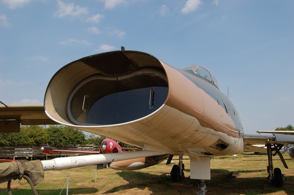

Marklo Posted June 25, 2022 Author Posted June 25, 2022 I was going to cut out the bulkhead in the kit and mold a new interior, but found this in the internet. Some handles, edging and the bulge and I have a FOD cover, and much easier to model. 2 1

Corsairfoxfouruncle Posted June 25, 2022 Posted June 25, 2022 3 hours ago, Marklo said: I was going to cut out the bulkhead in the kit and mold a new interior, but found this in the internet. Some handles, edging and the bulge and I have a FOD cover, and much easier to model. Thanks been trying to decide what to do with a similar intake on the AMT Two seater. 1
Sam Posted June 26, 2022 Posted June 26, 2022 13 hours ago, Marklo said: I was going to cut out the bulkhead in the kit and mold a new interior, but found this in the internet. Some handles, edging and the bulge and I have a FOD cover, and much easier to model. Nice move!
