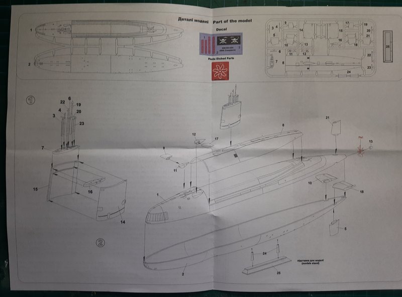

Courageous Posted May 23, 2022 Share Posted May 23, 2022 Hi All, After completing a couple of stalled aircraft builds, it's time to get back to the maritime builds, not the Fushimi Maru as expected but this most recent arrival of a Churchill Class Submarine in 1/350 by Mikro Mir...FANTASTIC! The mandatory stuff... The box art. Hull sprue and base. The other sprue with the upper casing, sail, planes and masts. Also a PE propeller and some decals. Instructions As you can see, like most submarine kits, it has very few parts, so that means it'll be a quick build right... The box art and decal option is for HMS Conqueror, sister to HMS Courageous but seeing that I served on Courageous, it'll be her that I shall be doing, not that there is any difference except the flying of the 'Jolly Roger'. I have to thank @maarten.schonfeld for helping Mikro Mir and @Terry1954 for also helping to bring it to my attention. Stuart 18 2 Link to comment Share on other sites More sharing options...

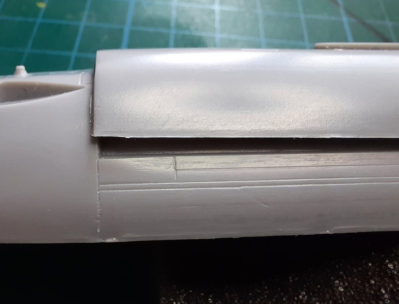

Flintstone Posted May 24, 2022 Share Posted May 24, 2022 I have just received my example of this kit and have completed it already! The top deck section needs some care in fitting, but the finished model looks to be a good representation of the real thing. Thank you Mikro-Mir! 1 Link to comment Share on other sites More sharing options...

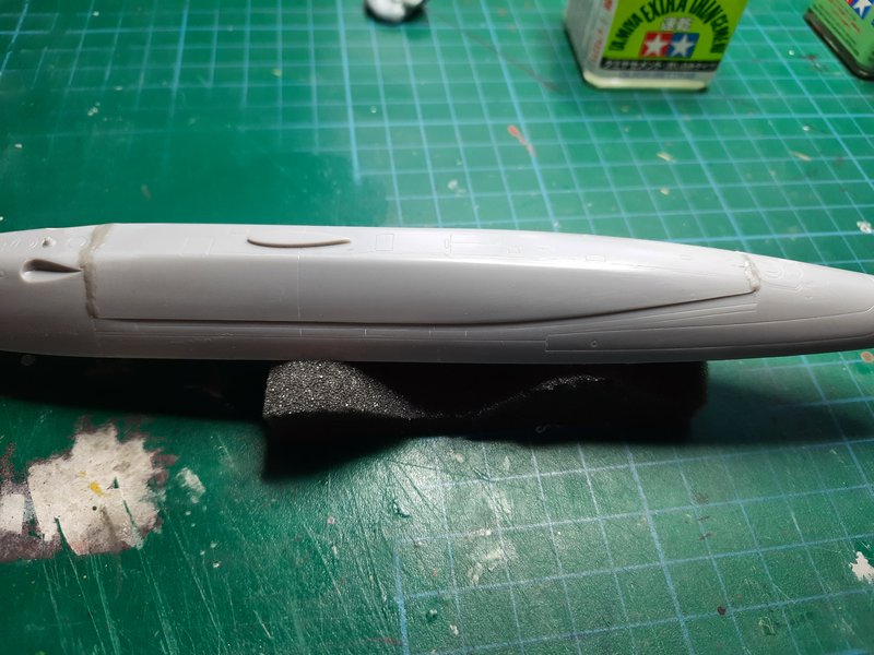

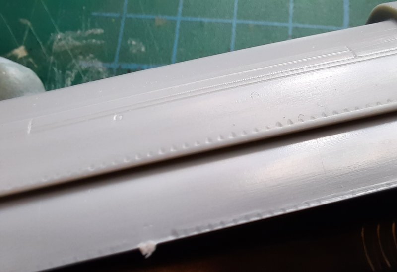

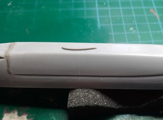

Courageous Posted May 30, 2022 Author Share Posted May 30, 2022 Back from our break and got chores out of the way. As promised, I'm now starting this build but it looks like @Flankerman has also started a thread. Not to sure what all these dots are about, they only ran along one side of each hull half and shouldn't be there. I'm doing my build as waterline, so the lower hull isn't going to be used except may be as a brush tray. I won't be worrying about those dots on the upper hull either as the typical waterline is much higher than is depicted in the instructions and the 'water' will be covering them. A little bit a fit issue between the upper hull and casing part. Some care is needed to get the casing to fit correctly because of those pair of parallel lines that ran forward to aft, can't remember what they were used for, something to do with safety lines(?). Casing fitted and the vertical lines filled with gloop. Stuart 10 Link to comment Share on other sites More sharing options...
Flankerman Posted May 31, 2022 Share Posted May 31, 2022 Re the 'dots' along the hull Stuart..... you must have got a 'duff' mould - those dots are not present on my kit.... Ken 2 Link to comment Share on other sites More sharing options...

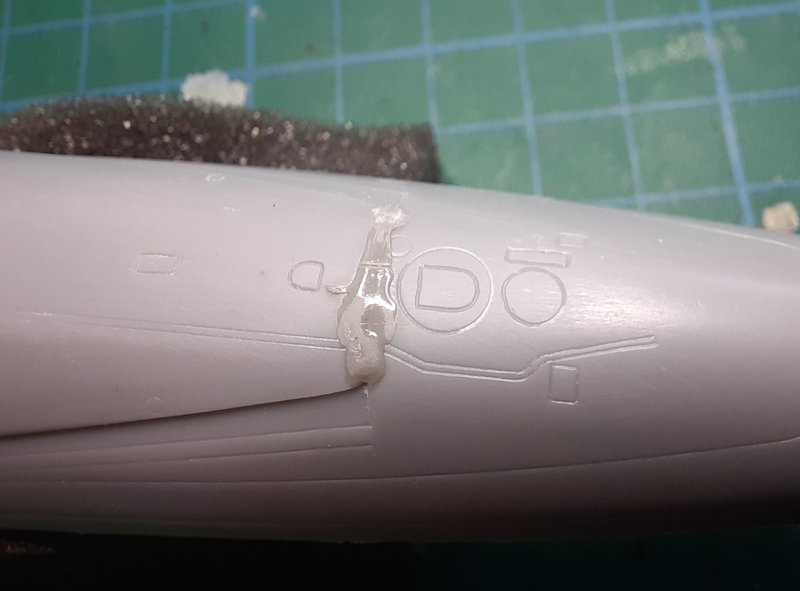

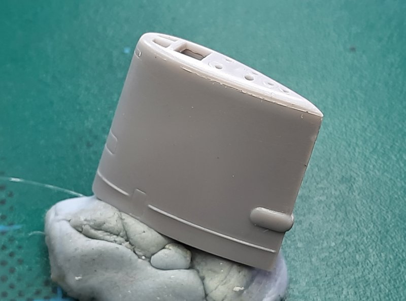

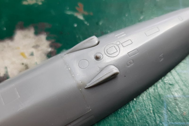

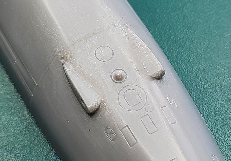

Courageous Posted June 1, 2022 Author Share Posted June 1, 2022 16 hours ago, Flankerman said: must have got a 'duff' mould It does happen, just have to deal with it. Foreplane actuator housings are on and need a bit of fairing in. Not sure why they made these as separate parts, well I do...parts count, so few in a submarine kit. A few filler and sanding cycles later. Sail, conning, whatever people call it, also done. Nice to see the access door hasn't been forgotten. Something I have noticed is that the square looking vent on the hull is missing from the plastic, the box art depicts it, period photos show it, so that needs to be added. Also of note is the colour of the draught marks which should be red but the decals are white. Again the box art shows this, as do photos and they're are also etched in my head as I had to record the draught when on sentry duty as a youngster. Not sure what can be done about this if anything. Stuart 9 Link to comment Share on other sites More sharing options...

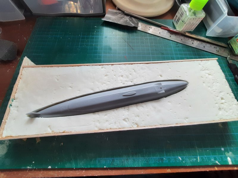

Courageous Posted June 3, 2022 Author Share Posted June 3, 2022 On 6/1/2022 at 12:06 PM, Terry1954 said: Perhaps fine red lines from a very fine red marker pen I was thinking along those lines Terry. Hopefully any drift onto the clear decal won't be noticeable on a black hull. On 6/1/2022 at 7:42 PM, Flankerman said: Do we know what is inside the vent ? I can't remember what's inside but IIRC, the outer we're vertical louvres, so a decal or a few scored lines in a box might do the job...more investigation needed. Have temporarily put the boat aside to do the base... Insulation board surrounded by balsa strip. Even though I have only used the upper hull, I've had to make an 8mm recess so as to get the water line correct. Stuart 5 Link to comment Share on other sites More sharing options...

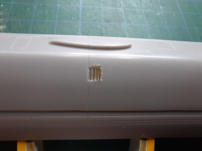

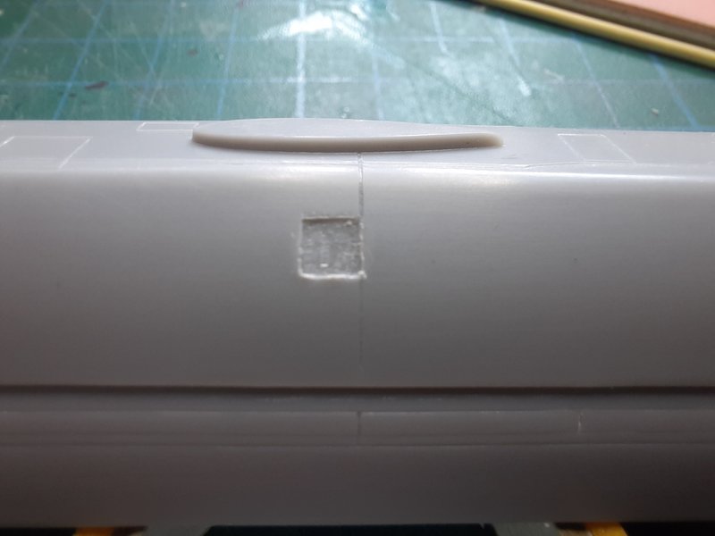

Courageous Posted June 4, 2022 Author Share Posted June 4, 2022 Decided to tackle the side vents... 3mm x 3mm area was very carefully excavated. A sacrificial bit of PE railing was chopped into 3mm lengths and added to the hull, more convincing than nothing but macro still has no friends. With vents done, sail on and foreplanes added, she is starting to look very much like I remember her. Stuart 18 Link to comment Share on other sites More sharing options...
ArnoldAmbrose Posted June 4, 2022 Share Posted June 4, 2022 Gidday Stuart, good job with the vents. I think small additions such as this go a long way in enhancing a model. Regards, Jeff. 1 Link to comment Share on other sites More sharing options...

Flankerman Posted June 4, 2022 Share Posted June 4, 2022 Great work on the vents - although you are forcing me to re-think my square of black decal fix - thanks a bunch I also noticed that on her return to Faslane, Conqueror has her name plate attached to the sides of the sail - decal not supplied by Mikro-Mir, sadly. Ken Link to comment Share on other sites More sharing options...
Courageous Posted June 4, 2022 Author Share Posted June 4, 2022 2 hours ago, ArnoldAmbrose said: good job with the vents. I think small additions such as this go a long way in enhancing a model. Cheers Jeff. Submarines generally have little detail, so little details need to be added, not to sure how it'll show up on an all black boat? 1 hour ago, S-boat 55 said: Coming together very nicely indeed, All ten kit parts plus my little PE bits... 33 minutes ago, Flankerman said: thanks a bunch Your welcome . 34 minutes ago, Flankerman said: Conqueror has her name plate attached to the sides of the sail Another reason why I now do my maritime 'at sea'. Stuart 2 Link to comment Share on other sites More sharing options...
