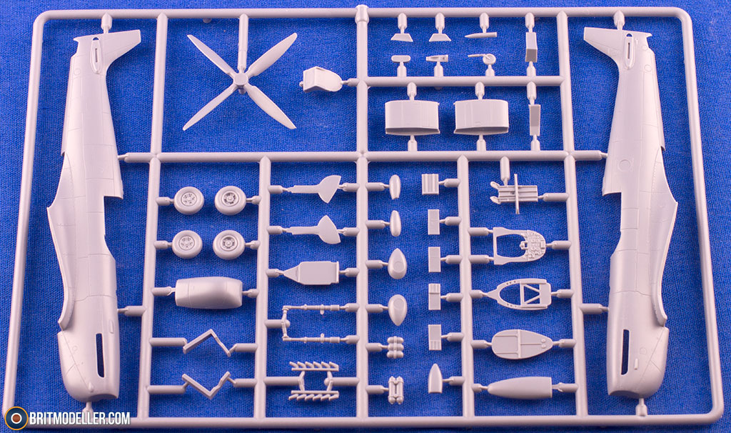

Julien Posted May 10, 2022 Share Posted May 10, 2022 Supermarine Spitfire PR.Mk.XI "USAAF" (KPM0291) 1:72 Kovozávody Prostějov The Spitfire was the champion of the Battle of Britain along with the Hurricane and a few other less well-known players, and it’s an aircraft with an amazing reputation that started from a bit of a damp squib in the shape of the Supermarine Type 224. The gull-winged oddity was the grandfather of the Spitfire, and despite losing out to the biplane Gloster Gladiator, designer R J Mitchell was spurred on to go back to the drawing board and create a more modern, technologically advanced and therefore risky design. This was the Type 300, and it was an all-metal construction with an incredibly thin elliptical wing that became legendary, although it didn’t leave much space for fuel, a situation that was further worsened by the Air Ministry’s insistence that four .303 machine guns were to be installed in each wing, rather than the three originally envisaged. It was a very well-sorted aircraft from the outset, so quickly entered service with the RAF in 1938 in small numbers. With the clouds of war accumulating, the Ministry issued more orders and it became a battle to create enough to fulfil demand in time for the outbreak and early days of war from September 1939 onwards. By then, the restrictive straight sided canopy had been replaced by a “blown” hood to give the pilot more visibility, although a few with the old canopy still lingered. The title Mk.Ia was given retrospectively to differentiate between the cannon-winged Mk.Ib that was instigated after the .303s were found somewhat lacking compared to the 20mm cannon armament of their main opposition at the time, the Bf.109. As is usual in wartime, the designers could never rest on their laurels with an airframe like the Spitfire, as it had significant potential for development, a process that lasted throughout the whole of WWII, and included many changes to the Merlin engine, then the installation of the more powerful Griffon engine, as well as the removal of the spine of the fuselage and creation of a bubble canopy to improve the pilot’s situational awareness. Its immediate successor was the Mk.II with a new Mk.XII Merlin, followed by the Mk.V that had yet another more powerful Merlin fitted. With the development of new Merlin 60 powered Spitfires, both the Mk VII and VIII were to have photo-reconnaissance (PR) variants. T he Mk XI was based on a combination of features from the marks VII, VIII and IX. It was the first PR variant to have the option of using two vertically mounted F52 cameras in the fuselage behind the cockpit. Other configurations could also be fitted, depending on the mission. The Mk XIs had a deeper nose fairing to accommodate a larger 14.5 gal oil tank and used the unarmoured, wrap-around PRU windscreen. Booster pumps for the wing tanks were fitted these being covered by teardrop shaped fairings under the wings. Retractable tailwheels were fitted as standard and the majority of the Mk XIs built had the later large-area pointed rudder. 260 Mk XIs were powered by Merlin 61, 63 or 63A engines, while the remaining 211 used the high-altitude Merlin 70. All of the Merlin 70 and 198 of the Merlin 60 series aircraft were fitted with the Vokes Aero-Vee dust filter in the extended, streamlined carburettor air intake under the nose. All Merlin 60 powered aircraft featured the fuel cooler in the port leading edge wing root. Additional slipper drop tanks could be fitted under the centre-section; in common with the Mk IX these could be 30, 45 or 90 gal capacity and, for the Mk XI, a tank of 170 gal capacity was also available. The aircraft were capable of a top speed of 417 mph (671 km/h) at 24,000 ft and could cruise at 395 mph at 32,000 ft. Normally Spitfire XIs cruised between these altitudes although, in an emergency, the aircraft could climb to 44,000 ft. However, pilots could not withstand such altitudes for long in a non-pressurised cockpit.[info from Wikipedia] The Kit This is a new tool 2022 boxing in KP's line of Spitfire kits. As is usual, they have produced a number of boxings that vary in decals and parts , giving the modeller plenty of choice which one(s) to get. The kit arrives in a small end-opening box, and inside are two sprues in grey styrene, a clear sprue, decal sheet and A5 instruction booklet, with the decal options printed in colour on the back of the box. Detail is excellent for the scale. Construction begins with the cockpit, the front bulkhead gets its instrument panel, with the instruments being provided as decals. The seat back and head armour attaches to the rear bulkhead and this is fitted to the floor members. The control column is added followed by the seat. Belts are supplied as decals. At the front of each fuselage half blanking plates go in for the exhausts and then the cockpit can go in the and halves can be closed up. Moving onto the wings the left and right uppers can be added to the single part lower wing making sure the small parts for the wheels wells go in first. The radiators go on. The wing can now be fitted to the fuselage and at the rear the tail surfaces and rudder are fitted, along with the tail wheel. The main gear can be built up and added along with the chin intake and prop. On top the canopy and aerial mast is added. At the front the prop is fitted. Markings There are three decal options in the box to represent The USAAF 14th Photographic Squadron of the 8th Air Force, which operated Spitfire Mark XIs from November 1943 to April 1945 Decals are printed in-house and have good registration, colour density and sharpness, with a very thin carrier film cut close to the printing. Conclusion Another great release from KP with excellent detail, and plenty of choices. Recommended. Review sample courtesy of 9 2 Link to comment Share on other sites More sharing options...

lasermonkey Posted May 11, 2022 Share Posted May 11, 2022 Is it me, or does that canopy look more like the early Mk I windshield than the rounded type of the PR variants? Link to comment Share on other sites More sharing options...
Julien Posted May 11, 2022 Author Share Posted May 11, 2022 44 minutes ago, lasermonkey said: Is it me, or does that canopy look more like the early Mk I windshield than the rounded type of the PR variants? You sir are correct, I have just checked all 3 boxings and its the same. We will be dropping KP a mail to see if they sent us the wrong canopies? It would not be too much work though if you have one to buff it out though. Julien Link to comment Share on other sites More sharing options...

Hardtarget Posted May 21, 2022 Share Posted May 21, 2022 (edited) Ive just received my 4 boxings, and im in construction at present. one thing that the kit has an issue with and that the cockpit floor, its too short. if you mate up the rear bulkhead/armor plate and then affix the control panel, go to locate it on the side wall of one of the fuselage halves snags the detail on the wall and the CP is approx 5-8mm too far back and is not located under the cockpit coaming. As first i thought this was user error so i separated the CP and bulkhead with seat from the floor and located them in the slots they should go into and its confirmed the floor is too short. How they allowed this oversight is anyone's guess. Thought people should know, and see if their boxings/builds have the same issue. Edited May 21, 2022 by Hardtarget 2 Link to comment Share on other sites More sharing options...

Julien Posted June 22, 2022 Author Share Posted June 22, 2022 8 hours ago, hajt said: Hello Julien Have you got any answer or news from the KP regarding those canopies ? Best Regards Teemu H. They said it was correct. I see very feint lines there but TBH they will polish out. 1 Link to comment Share on other sites More sharing options...
lasermonkey Posted June 22, 2022 Share Posted June 22, 2022 7 minutes ago, Julien said: They said it was correct. I see very feint lines there but TBH they will polish out. It’s not, it’s just the closest thing they have (from their early Mk I). The windshield should have a smooth, continuous curve. It’s quite noticeable on the real thing and KP have rather stuffed this up. Again, it’s not exactly new information and if they’d spent five minutes on the internet, they could have found plenty of photos. Hopefully someone will come out with an accurate replacement soon. 1 Link to comment Share on other sites More sharing options...
lasermonkey Posted June 23, 2022 Share Posted June 23, 2022 I have just spent a few hours trawling the internet for images of period photos of Spitfire XIs to check the windshield shape. Interestingly, it looks like there *might be* examples of both curved and flattened windshields. Now, photos of that particular area of the canopy are not exactly common or clear and it is possible that only one shape was used. If this is the case, the flat at the front end is very subtle and not at all like the canopy supplied by KP, which really does look like the early Mk I style. I was about to apologise for posting misleading information, but from the images I have seen, the kit canopy really doesn’t capture the subtle curves at all. It’s not easy to post links from my iPad, but if you Go ogle for images of the PR.XI you’ll soon see what I’m getting at. I will have a look through my books to see if there’s anything better in there, but as it stands, a replacement canopy is still needed. Cheers, Mark. 1 1 Link to comment Share on other sites More sharing options...
lasermonkey Posted June 28, 2022 Share Posted June 28, 2022 Some of the best photos I have been able to find can be seen here. Also this pic. Having seen a completed model here on Britmodeller recently, I think today's luncheon may consist of headwear. I'm still not convinced KP have got the subtle shape of the windscreen quite right, but you can tell from the completed model that it's a lot better than the photos of the canopy part on its own suggest. Anyway, apologies to KP and anyone else I may have inadvertently misled. Hopefully the pics will help you make up your own mind. Best regards, Mark. 1 Link to comment Share on other sites More sharing options...
Dave Fleming Posted July 7, 2022 Share Posted July 7, 2022 Do they have the back end of the canopy correct? The fuselage is lower for the PRX, so I’m hoping the PR XI canopy has a larger fuselage area. Link to comment Share on other sites More sharing options...
Arccos Posted August 26, 2022 Share Posted August 26, 2022 The largest issue of this kit is the rear cockpit. The kit shares sprues with KP Spitfire PR.Mk. X, but cockpits of XI were NOT pressurized. As a result almost everything behind the pilot seat is wrong in this kit. There were no bulkhead. Instead there were the classical perforated frame (as clearly visible in the pics above). Also there we no extra oxygen cylinders, in fact the radio equipment was behind the seat instead, as it was moved there from the fuselage to make room for cameras. Also the headrest is missing in the kit, as well as the voltage regulator behind the headrest (also quite typical for Spitfires). I wonder why no reviews mentioned this. Fortunately it is not difficult to fix the issue - just replace the bulkhead with struts, scratch the mentioned details and the radio equipment. I have no pictures of this part, but you can probably get inspired by the set from Attack Squadron (http://www.attacksquadron.pl/en/2015/05/26/spitfire-pr-xi-172-scale-from-attack-squadron/) Link to comment Share on other sites More sharing options...
