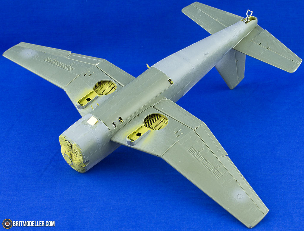

Mike Posted March 28, 2022 Author Share Posted March 28, 2022 The fuselage seams took a while to get right, but I whipped them into shape eventually after creating lots of dust and sanding residue. A couple of doses of primer confirmed things were satisfactory, so I moved on to the wings. The seams were easy enough to sort out, so I set about the flying surfaces, which were a bit confusing if I'm honest. How much of that was me being a bit dim is up for debate I got them glued together and started to add them to the rear of the wings, which showed up a few issues of my own making. If you check out the pics below you can see some white sections in the flap hinge department, where I'd managed to knock off the hinges during constructions I made good with some styrene strip so things look OK, and while I was waiting for the glue to dry, I made up the prop, which was easy-peasy. I smoothed out the seams and inserted the wingtip lights, which fitted quite well, although I did sand them back a little so they were flush-fitting with the wingtip. During the gear bay painting process I sprayed zinc-chromate in the exterior part of the gear bays, which I later found out should actually be the same colour as the underside, as should the gear legs and bay doors on both sides. I'll overcoat that in due course once the wings are glued on and ready for paint. No-one's perfect 15 Link to comment Share on other sites More sharing options...

Mike Posted April 2, 2022 Author Share Posted April 2, 2022 I worked up the nerve to glue the wings on today, after fettling them to within an inch of their lives to ensure they stuck. I also dug out my EBMA jig to keep everything in order while the glue sets up, which makes it a must-have. The wings are almost a butt-joint in shallow sockets, apart from one location tab that projects about 2mm inside the fuselage, so it's key to get a good joint. I flooded the area with liquid glue and held them in place for a few minutes while I watched some Galactica 80. Remember that? It's a bit more hokey than the original, as most of it is based on earth, presumably to keep the budgets down, one of the main reasons the original got cancelled. It was costing over $1m per episode, with much of it being spent of the SFX. I digress. That's not like me! I snapped a pic on my phone where it's sitting next to my photobooth, as I daren't move it for now. I'll take a proper pic later. 17 Link to comment Share on other sites More sharing options...

Mike Posted April 2, 2022 Author Share Posted April 2, 2022 Last update before I decided to pose the dive-brakes in the closed position mainly because everything else is going to be open, so I washed off the primer with some Liquid Reamer to give the CA a better chance of sticking. Someone asked whether the PE brakes fit well in the bays, and the answer is like a glove. I cleaned up the attachment points, sloshed a bit of CA into the recesses so that the edges of the parts would catch, then put each one in, one after another. Any overflowing CA was wiped off with debonder, which I'll wash off with some IPA tomorrow once the CA has cured fully. You might have noticed the canopy masks change from vinyl to tape half way down. I was having trouble getting the edges to stay down, and there were some tiny overlaps on the frames, which was taking longer to deal with than just making my own, so I did I've tack-glued the rest of the canopy on, filled any gaps with Blutak, and installed the new highly powerful Blutak 2800 engine in the cowling, which is also tacked on with GS-Hypo, so all the demarcations match up at the end. Those little bits of tape on the top of the removable canopy sections are to remind me which way they go, as they fit better this way. In case you were wondering, some of the vertical frames widen about half way down, so it's not my wobbly masking 15 Link to comment Share on other sites More sharing options...
