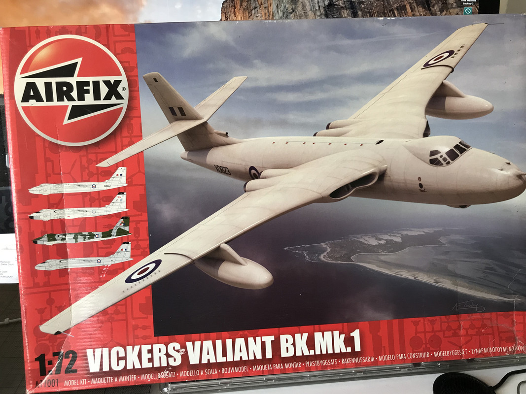

Timmas Posted March 7, 2022 Share Posted March 7, 2022 I've been umming and ahhing about this for a day or two. It was a toss up between a Nimrod or Valiant...both Airfix and both 1/72. Since there are two Nimrod builds started already and only one Valiant so far (I'm interested to see how your's comes together Adam), I'll almost certainly go for the Valiant. No idea which version yet but I'll get round to that later. 3 Link to comment Share on other sites More sharing options...
Adam Poultney Posted March 8, 2022 Share Posted March 8, 2022 Well a second Valiant would be a welcome addition to this group build. The Airfix kit is pretty nice, a few errors which are easily overlooked but the resin does exist for those with a desire to correct it. Do you have any thoughts on which scheme you plan to go with? For an aircraft with such a short service life there are plenty of schemes available. I think my next 1/72 one when I get a chance to build it will be camouflaged (but I don't think I'll be getting any opportunities to build it any time soon unfortunately). Going to leave a photo here of my previous 1/144 Valiant not quite a build... it's a repainted, modified and improved diecast. Much more accurate than anything in its scale... 3 Link to comment Share on other sites More sharing options...
Timmas Posted March 8, 2022 Author Share Posted March 8, 2022 8 hours ago, Adam Poultney said: Well a second Valiant would be a welcome addition to this group build. The Airfix kit is pretty nice, a few errors which are easily overlooked but the resin does exist for those with a desire to correct it. Do you have any thoughts on which scheme you plan to go with? For an aircraft with such a short service life there are plenty of schemes available. I think my next 1/72 one when I get a chance to build it will be camouflaged (but I don't think I'll be getting any opportunities to build it any time soon unfortunately). Going to leave a photo here of my previous 1/144 Valiant not quite a build... it's a repainted, modified and improved diecast. Much more accurate than anything in its scale... Hi Adam. That's a nice one I have a Noah's Ark of unmade V Bombers in my stash...two of each. This one will very likely be finished in anti-flash white but I have no idea which particular airframe I'll go with yet. The other one will probably end up camouflaged. I know what will happen after that...I'll get another one and do it in silver. That's how the addiction works ! 1 Link to comment Share on other sites More sharing options...
