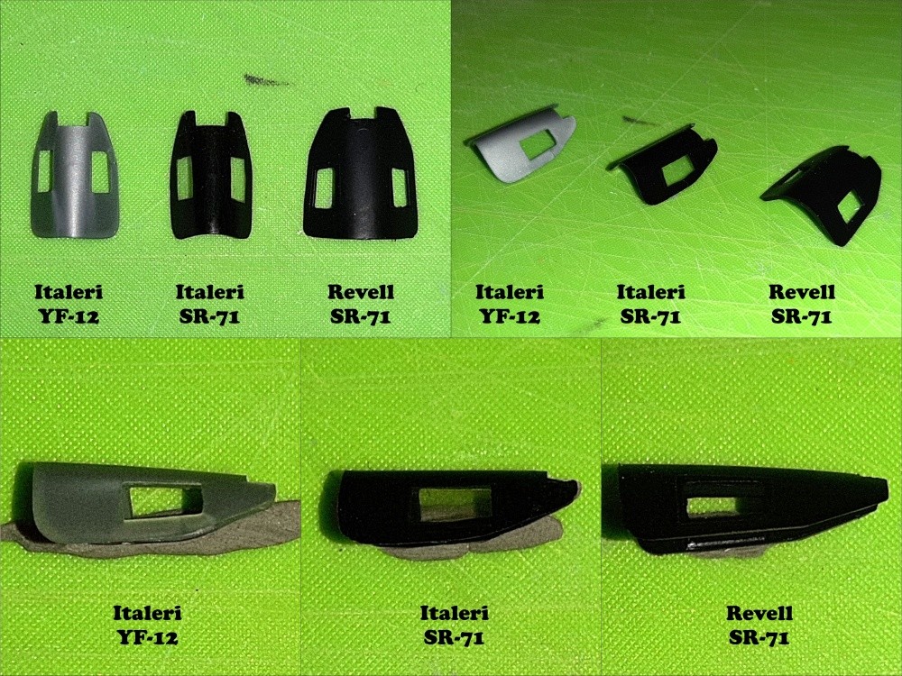

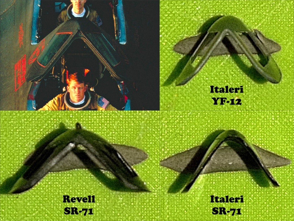

Serkan Sen Posted March 13, 2022 Posted March 13, 2022 The cockpit details and pilots looks amazing. I also have pair of Revell Blackbird kits in my stash because the price was very attractive. But after getting a bit experience on Blackbird I have seen a lot of inaccuracies in this kit. Some of them can be fixed but especially the cockpit and canopy area as well as MLG bay is a big problem. I can share some images from my Oxcart build to show the canopy issues: The Italeri/Monogram YF-12A kit has the best canopy shape: Mainly because of the canopy shape I started to convert this kit into A-12B in 1:72 scale using the printed part. I have removed the entire fuselage section and replaced with the printed one. I will follow your build with great interest. Serkan 5 2

SaminCam Posted March 15, 2022 Author Posted March 15, 2022 On 3/13/2022 at 12:54 PM, Serkan Sen said: The cockpit details and pilots looks amazing. I also have pair of Revell Blackbird kits in my stash because the price was very attractive. But after getting a bit experience on Blackbird I have seen a lot of inaccuracies in this kit. Some of them can be fixed but especially the cockpit and canopy area as well as MLG bay is a big problem. I can share some images from my Oxcart build to show the canopy issues: The Italeri/Monogram YF-12A kit has the best canopy shape: Mainly because of the canopy shape I started to convert this kit into A-12B in 1:72 scale using the printed part. I have removed the entire fuselage section and replaced with the printed one. I will follow your build with great interest. Serkan Thanks Serkan, this is massively useful information and a study that I'm sure others will want to refer to as well. I see what you mean about the cockpit shapes but have already committed (ie glued on!) the parts ootb - it doesn't look too bad after a fair bit of sanding and filling so I'll stick with it. I'm afraid my 'bird isn't going to get close to your beauties but I'm using them as inspiration - who knows, maybe airfix are watching you as well and can be persuaded to produce a new, 1/72 version 😝 1 1
