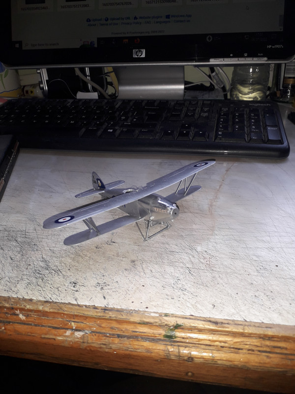

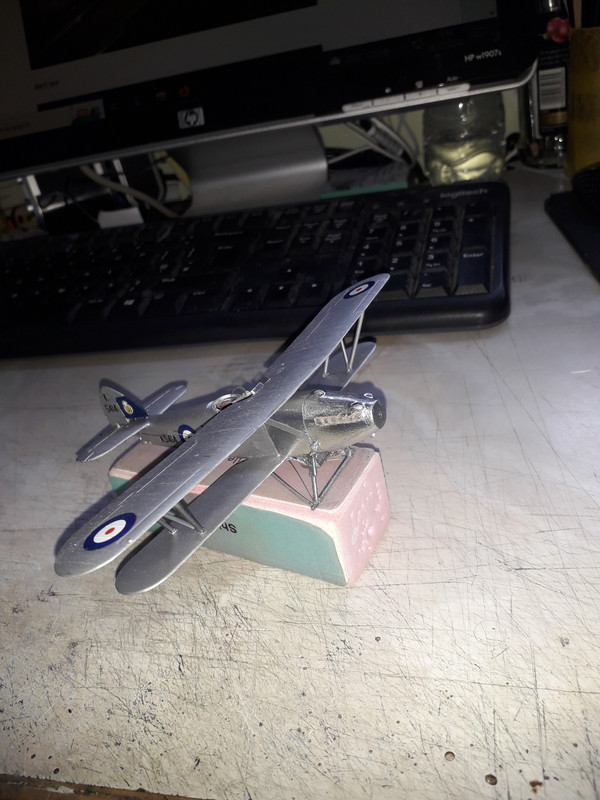

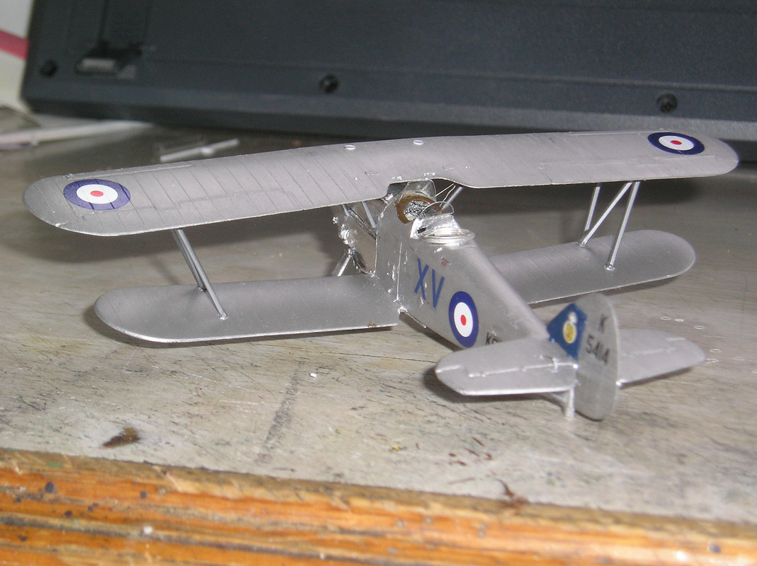

perdu Posted July 6, 2022 Author Share Posted July 6, 2022 Found it! Dammit, I have been searching high and low (kind of...) for my lost tube of Airfix Tube Glue, the obvious choice for certain choices I have made. Now of course I cannot put off adding the interplane struts, which was a difficult decision to make. Superglue for instant grab or Tamiya Green for a little give or take? With my shaking old hands the superglue option flew in the face of common sense and Tamiya Green often makes a 'too weak for stress joints' job of the job. All I could think of was tube glue which dries hard and fast after a decent fiddling about time. And had the benefit of being lost so I have had to give the job a lot of hanging about time, but now I have found it! Did I mention dammit? Struts are one of the numerous, almost too numerous to count reasons I normally shy away from biplanes. Struts are not natural, per se, so I religiously stuck to monoplanes and you know what? I do not blame me. But I found it so an attempt is being made to add interplanes to the space between the planes. We'll see Probably... 9 Link to comment Share on other sites More sharing options...
perdu Posted July 6, 2022 Author Share Posted July 6, 2022 This looks horrid to me, upper wing far too close to the fuselage Hmm I may be some time... 10 Link to comment Share on other sites More sharing options...
heloman1 Posted July 6, 2022 Share Posted July 6, 2022 Come on Bill, you can do it... Colin 1 Link to comment Share on other sites More sharing options...
hendie Posted July 6, 2022 Share Posted July 6, 2022 Looks damned fine from here Bill. 1 1 Link to comment Share on other sites More sharing options...
The Spadgent Posted July 6, 2022 Share Posted July 6, 2022 6 hours ago, perdu said: Probably... This made me chuckle. I think I had similar suspects propping up my wing sticks. Looking mighty fine by the way. Johnny 1 1 Link to comment Share on other sites More sharing options...
giemme Posted July 7, 2022 Share Posted July 7, 2022 10 hours ago, The Spadgent said: Looking mighty fine by the way. Agreed 100% Ciao 1 1 Link to comment Share on other sites More sharing options...

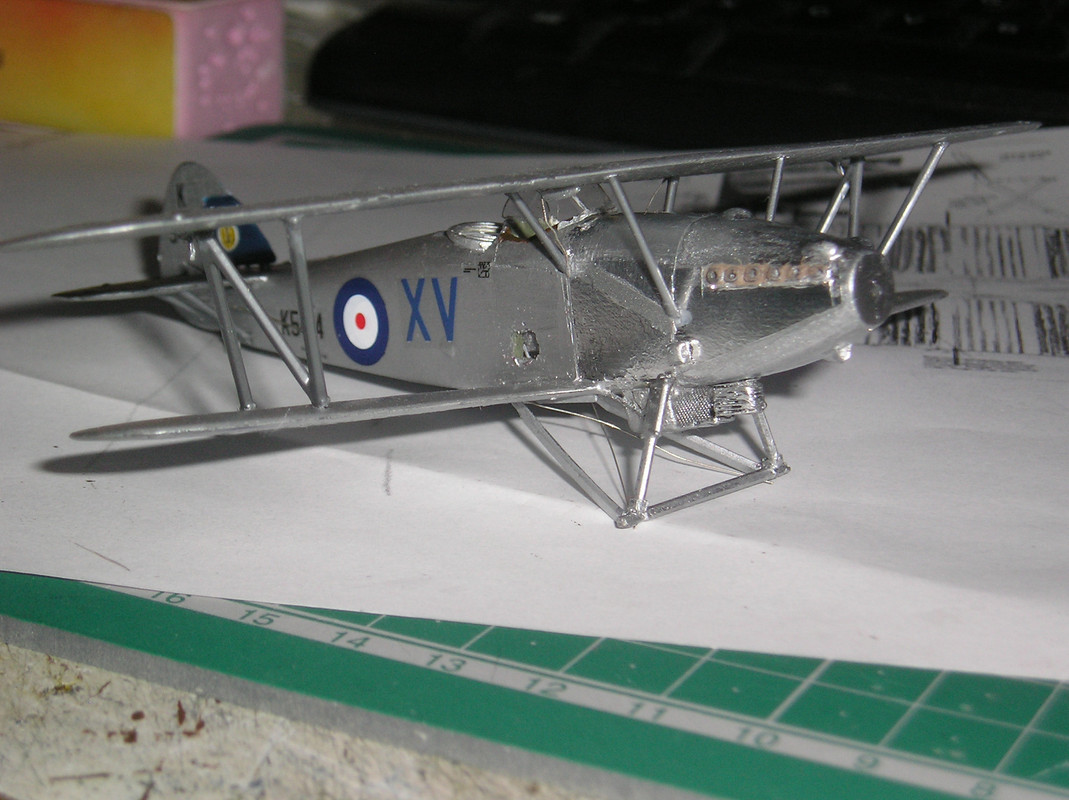

perdu Posted July 9, 2022 Author Share Posted July 9, 2022 How many impossible things before breakfast was it? I can't find enough topside pictures to KNOW for certain but I think there should be two slightly prominent filler caps by the side of the pair of hook shaped pipes atop the tank. I've seen several guesses at the purpose of dem tings, I think tank vents with a front opening to maintain higher than ambient pressure inside the tank thus allowing fuel to be drained normally to the engine rather than causing suction in the tank. It could be disastrous for an aeroplane to lose fuel pressure whilst planing the air couldn't it? Any way filler caps just slightly proud of the tank surface, must get paint on them. The holes for the aforementioned vent pipes are alongside the caps. There's a few more shots of the present day stance of the cabanes and we might just be able to spot the pair of aileron control cables at the rear cabane junction. No I haven't seen them yet either, lets take a trip. This ugly shot shows the control cables and the fuel feed to the engine casing, didn't expect that. Yuk. Don't know why but this picture reminds me I need to make underwing bomb racks to model this machine as she is equipped at Shuttle worth. Wheels and weapons nextest, ciao. 13 Link to comment Share on other sites More sharing options...
AdrianMF Posted July 9, 2022 Share Posted July 9, 2022 Looking super Bill. The magic is showing through! Regards, Adrian 1 1 Link to comment Share on other sites More sharing options...
giemme Posted July 9, 2022 Share Posted July 9, 2022 That last shot is mighty impressive, Bill! Even if you magnify it (and I did ). Ciao 1 1 Link to comment Share on other sites More sharing options...
perdu Posted July 9, 2022 Author Share Posted July 9, 2022 It does seem to be a reasonably decent thing, quite nice from that angle Giorgio. But not a lot of magic though Adrian, thanks. 1 Link to comment Share on other sites More sharing options...
hendie Posted July 9, 2022 Share Posted July 9, 2022 the brethren have it right Bill - looking mighty fine there. The Audax had two 'P" shaped pipes running aft from the fuel fillers on top of the wing but I'm not sure if her brothers and sisters had the same configuration. one question though - are you sure there was a second windscreen at the gunner/observer position? Link to comment Share on other sites More sharing options...
Brandy Posted July 9, 2022 Share Posted July 9, 2022 5 hours ago, perdu said: two slightly prominent filler caps by the side of the pair of hook shaped pipes atop the tank. The hook shaped pipes are indeed vents. They allow air into the tank as the fuel is being used, and air out when being refuelled. Without those, a vacuum would be created and fuel starvation would be the result. On refuelling if the air can't escape it would overpressurise and damage the tank. Ian 3 1 Link to comment Share on other sites More sharing options...
perdu Posted July 9, 2022 Author Share Posted July 9, 2022 Thanks for verifying that Ian, as an automotive engineer the pointing forward pipes looked as if that was the state of things, otherwise there would be fuel starvation. Which always comes when you don't need it. Alan this is going to be a replica of the preserved ex-Afghan Hind and as such is a very often photographed machine. All photos I have of her show a round/sorry semi-circular, screen behind the driver. Sadly I don't have such photos available in postimg.cc. 3 Link to comment Share on other sites More sharing options...

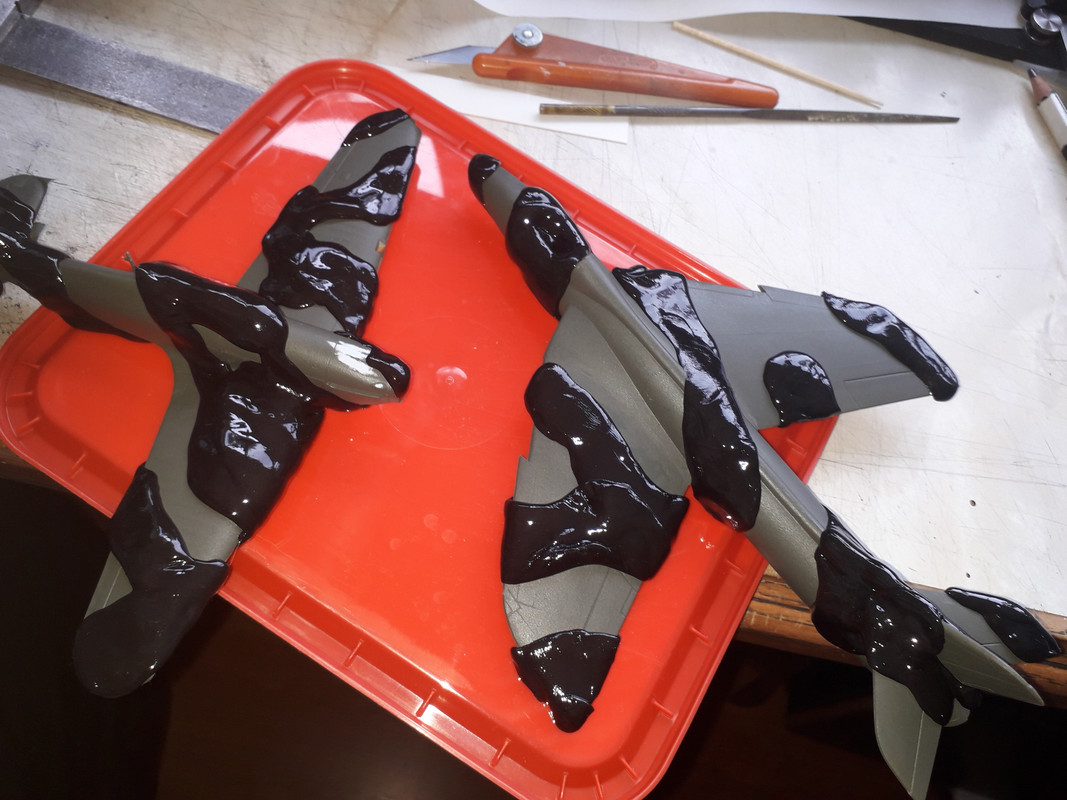

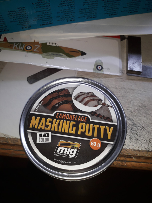

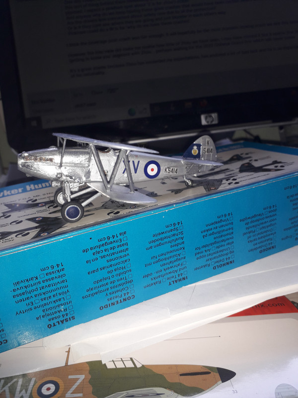

perdu Posted July 11, 2022 Author Share Posted July 11, 2022 Wheels on and a big-gish apology, seems it is the restored Demon with the semi-circular window between the seats Alan. Good spot, my bad very bad. Any road up the wheels on board and the window now disposed of. Wires to fit and zorst to paint next. Inviting albeit reluctantly your opinions. Is this single handedly the worst waste of money that you have ever seen me do? I admit it, I was unrelentingly displeased with masking with gurt dollops of Blu-tak sossidges. But £16 for MIG Masking putty? I suppose the stuff is unlikely to be re-useable once painted on, but hey, there is still half a can unused, probably two more models worth left. That makes model masking for about four squids possibly OK, in the scheme of things type thing. Here's the tin 7 Link to comment Share on other sites More sharing options...
perdu Posted July 11, 2022 Author Share Posted July 11, 2022 Bydaway, the hole in the starboard cockpit side masking was filled in immediately after the picture was uploaded. Link to comment Share on other sites More sharing options...
hendie Posted July 11, 2022 Share Posted July 11, 2022 56 minutes ago, perdu said: seems it is the restored Demon with the semi-circular window between the seats Just glad to have been of service Bill. 57 minutes ago, perdu said: Is this single handedly the worst waste of money that you have ever seen me do? Well that depends upon whether it works or not. Didn't our Ced use something similar a while back? If memory serves (no guarantee), isn't he say it ate the paint when it was all rolled up and back in the tin? I think he also said it had a tendency to spread out over the airframe if left for too long. P'raps Ced can confirm? Or not. 3 Link to comment Share on other sites More sharing options...
perdu Posted July 11, 2022 Author Share Posted July 11, 2022 That might be true Alan, It is beginning to hang off the underwings already. I have just scissored off a piece the size of a marble, back into the tin with you miladdo. It might be a very ugly story tomorrow morning when I hit the paint shop. 2 Link to comment Share on other sites More sharing options...
Terry1954 Posted July 11, 2022 Share Posted July 11, 2022 49 minutes ago, hendie said: If memory serves (no guarantee), isn't he say it ate the paint when it was all rolled up and back in the tin? I recall reading similar re this stuff i.e. its re-usable once rolled back up again. Probably not infinitely, but each reuse will reduce the cost - can you tell I did rithmatic at school? As Alan says, if this stuff works, and I see no reason why it shouldn't, then it's maybe worth it? T. 1 Link to comment Share on other sites More sharing options...

TheBaron Posted July 11, 2022 Share Posted July 11, 2022 If yon putty avoids the risk of those those ugly sweat stains you sometimes get left behind by die Blautak then I reckons it's well worth the investment Bill. Would love to see a shot of that silver bird out in sunlight; it'll glint in a most superb fashion. 30 minutes ago, hendie said: imagine you're wrapped in barbed wire and subject to vicious beatings while rubbing your belly and patting your head, simultaneously trying to model a park bench in Fusion Looking forwards to your next build already Alan. 3 Link to comment Share on other sites More sharing options...
