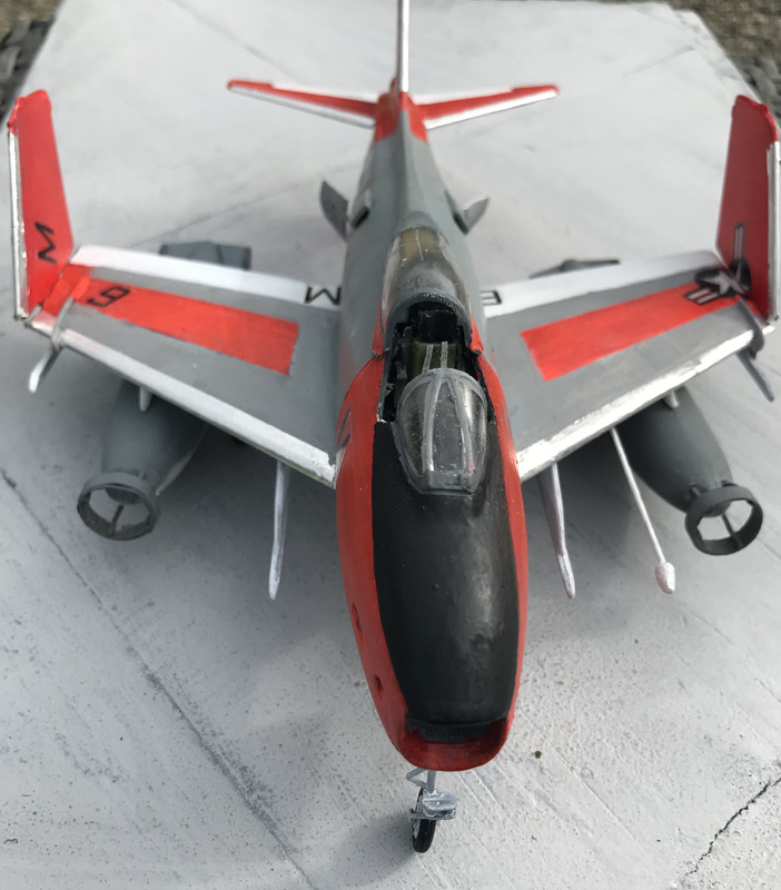

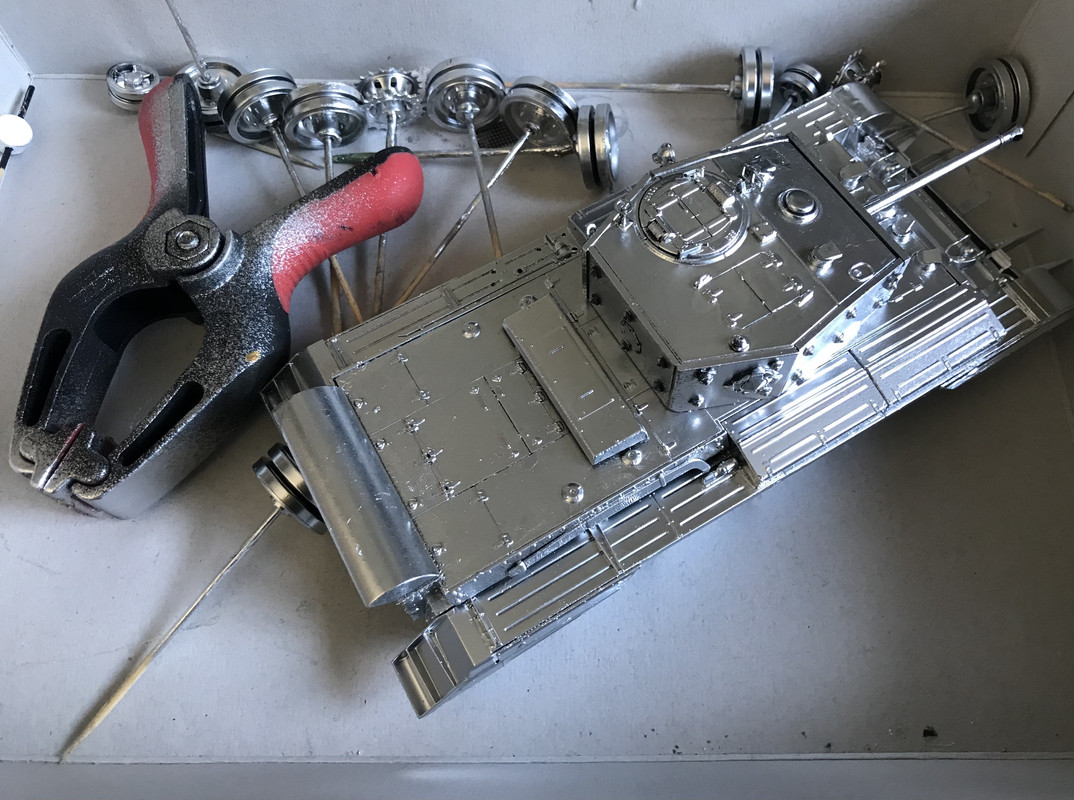

The Spadgent Posted June 2, 2022 Share Posted June 2, 2022 Damn nose! every time I have to coated the molotow stuff it has reacted. Not as bad as what you’re showing but deffo lost its lustre. As @giemme mentioned earlier I think, I do only use it for little bits and from the pen. But I’m more reluctant to top coat after your experiences. I did some tests to see what effect top coat had on different paints. All Vallejo but I used Dull Aluminium, Duraluminium and chrome. As you can see on this test with a top coat of Airbrushed thinned Tamiya X-22 closest and TS-13 furthest (can’t remember what the middle test was ) they all end up almost the same. all lost the “super shiny” and some became “less dull” but over all it was a good enough test. I’m still yet to find a top coat that keeps that crisp chrome look. I might do more tests? I do tend to use Tamiya smoke to post shade too, that knocks the whole lot back but the gloss coat brings everything into a middle register. The nose you had I thought looked good. But I think that super shine with a top coat is still elusive. For me and thee both. dust off, Onward and upwards dear Bill. Jont. fwiw the nose on my demon ended up less shiny than I would have liked. Maybe bare metal foil for small bits next time? ps. Excuse the bits of fluff in the paint above. I was not in ze booth. J 3 1 Link to comment Share on other sites More sharing options...
mark.au Posted June 2, 2022 Share Posted June 2, 2022 37 minutes ago, The Spadgent said: fwiw the nose on my demon ended up less shiny than I would have liked. Maybe bare metal foil for small bits next time? All of the samples look pretty fine to me but I am a big proponent of Bare Metal Foil. Aside from really tight compound curves it's not that difficult to apply and you can realise a finish anywhere between shiny chrome to flat corroded duralumin with careful sanding or polishing plus finish coats. But you probably know this already so I'll stop the wittering... 4 Link to comment Share on other sites More sharing options...

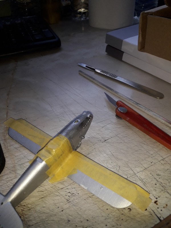

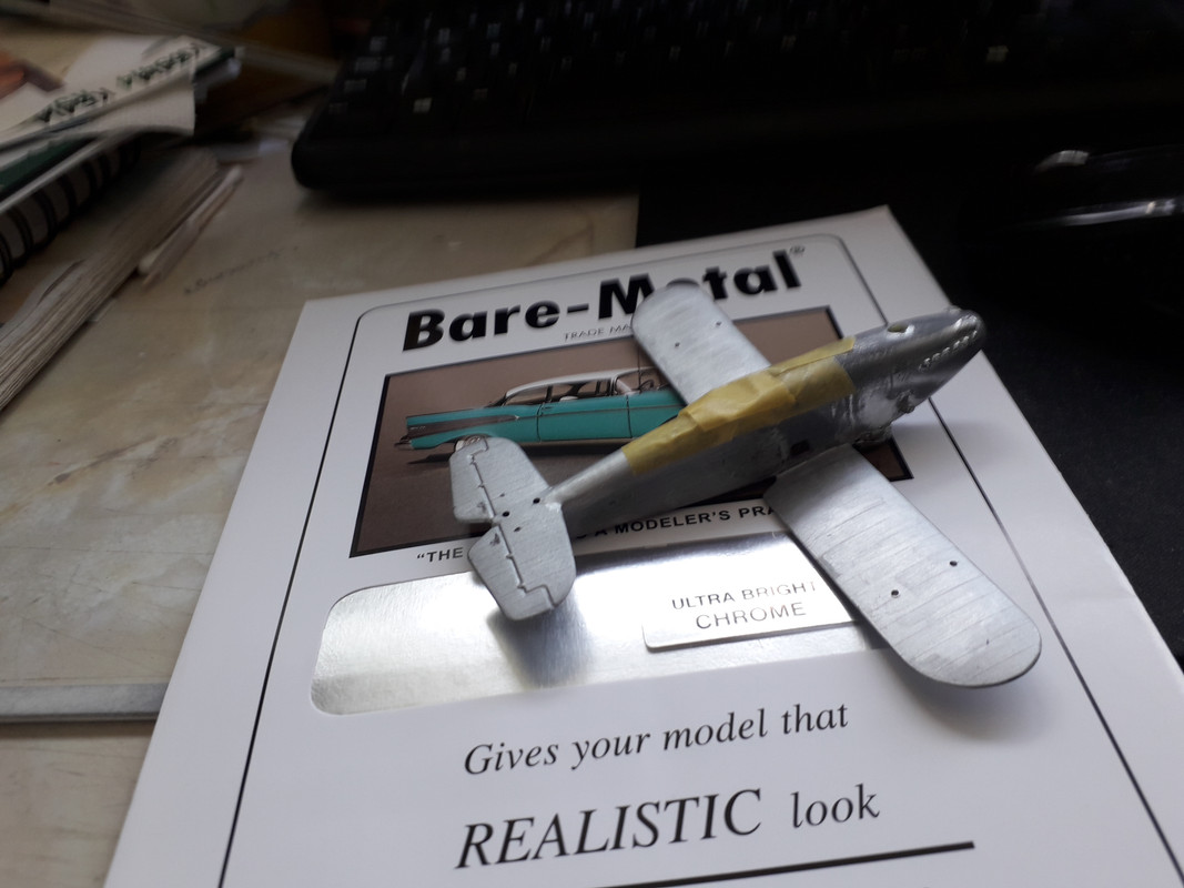

perdu Posted June 17, 2022 Author Share Posted June 17, 2022 On 02/06/2022 at 08:50, perdu said: Should I buy Bare metal Foil now? Hannants out of stock. Ordered on the Bay! The test looks pretty conclusive, thanks Johnny. BMF has landed, Molotow reserved for infilling jobs as required. Once again the new window panels installed and I am about to take this outside for application of Tamiya Flat varnish so that Vallejo Aluminum takes to its skin without falling off it. Maskol windows shaper on clear sellotape™ film to make the windows We will see. 8 Link to comment Share on other sites More sharing options...

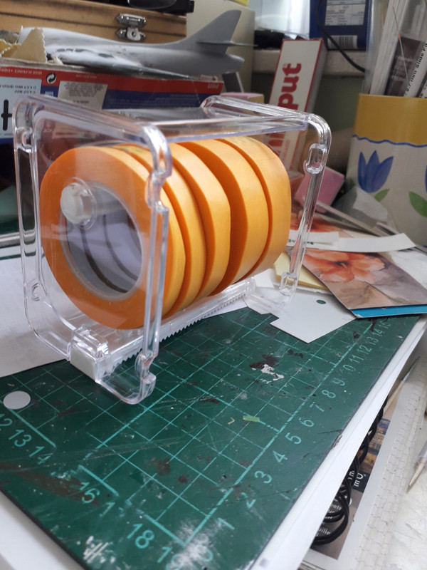

perdu Posted June 20, 2022 Author Share Posted June 20, 2022 In need recently of new supplies of washi type tape I wandered into the serried ranks of such suppliers in the large river named emporium. There I had a WWCBD? moment, but immediately decided I already knew. Meet one more attractive and entirely unnecessary item of equipment. fated to be. Possibly the next twenty years of masking covered 1 7 Link to comment Share on other sites More sharing options...

Martian Posted June 20, 2022 Share Posted June 20, 2022 17 minutes ago, perdu said: In need recently of new supplies of washi type tape I wandered into the serried ranks of such suppliers in the large river named emporium. There I had a WWCBD? moment, but immediately decided I already knew. Meet one more attractive and entirely unnecessary item of equipment. fated to be. Possibly the next twenty years of masking covered Alternatively, a couple of Takom Zeppelins masked. Martian 1 1 Link to comment Share on other sites More sharing options...
perdu Posted June 20, 2022 Author Share Posted June 20, 2022 52 minutes ago, Martian said: Alternatively, a couple of Takom Zeppelins masked. Martian Quite possibly, does this give you an idea of how small my future objectives bode? 2 Link to comment Share on other sites More sharing options...

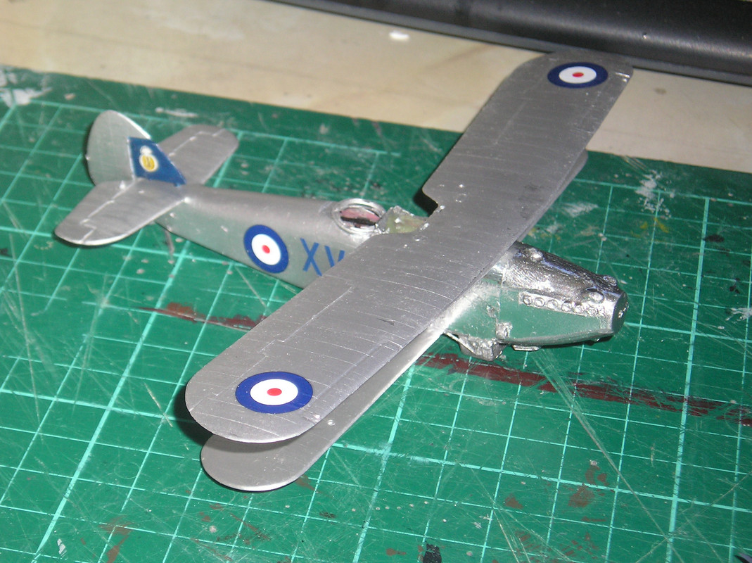

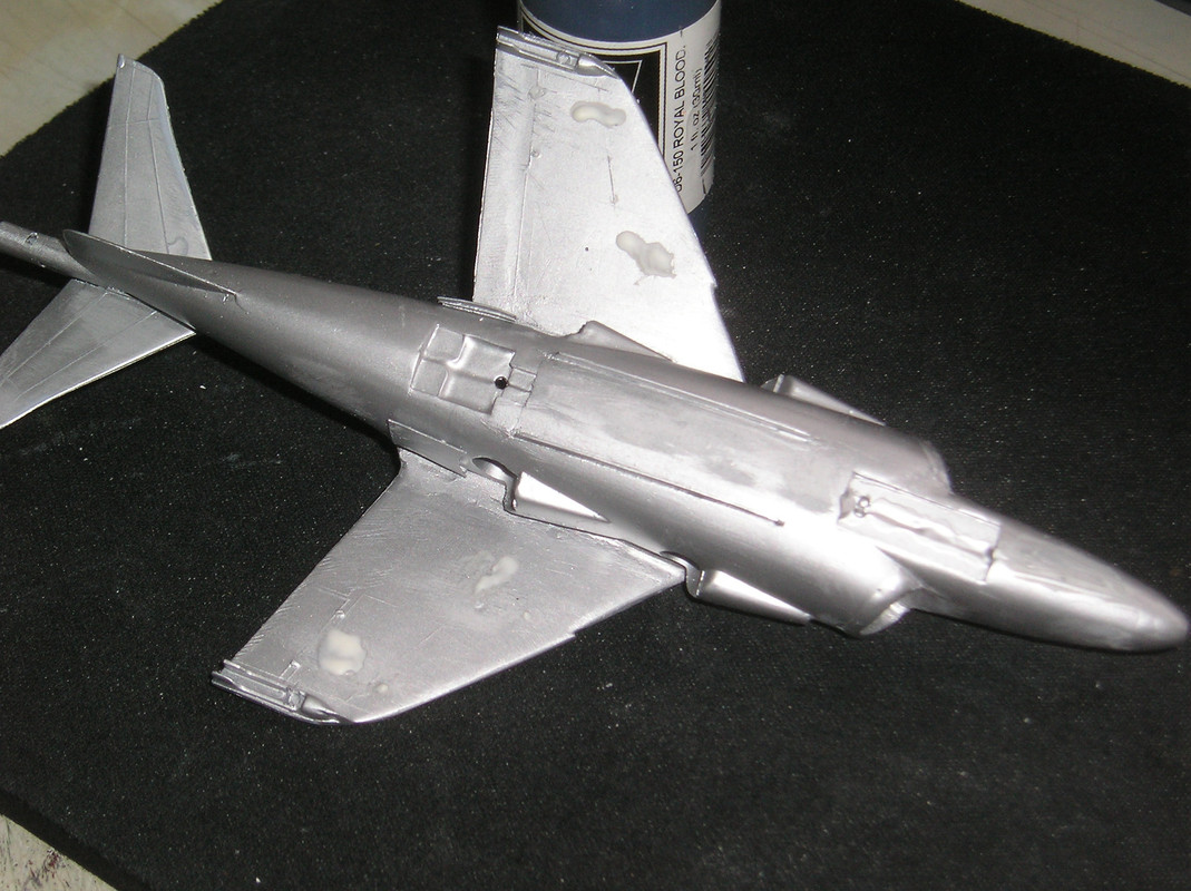

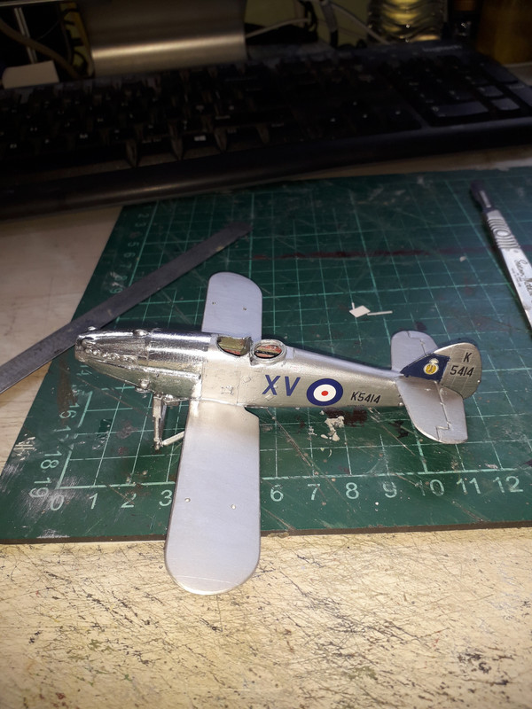

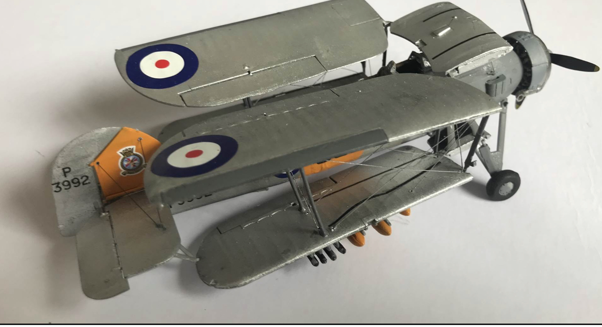

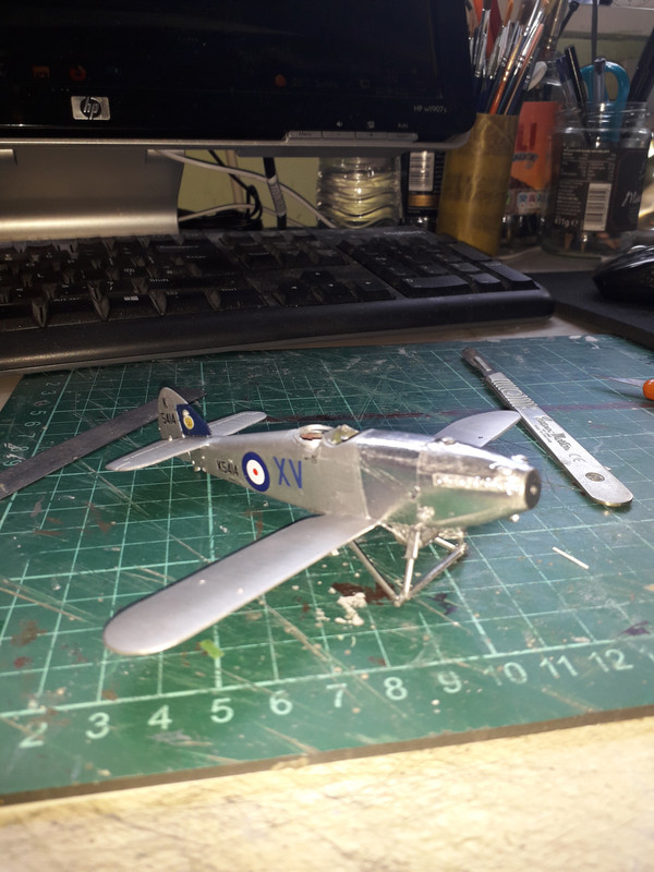

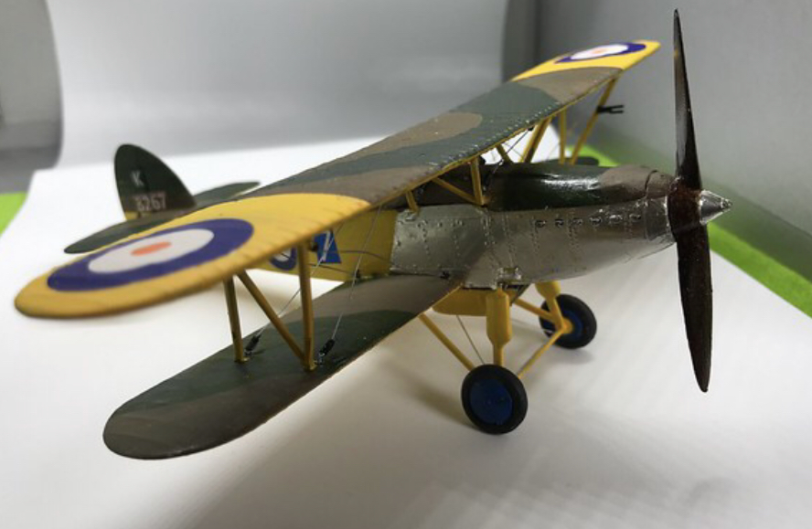

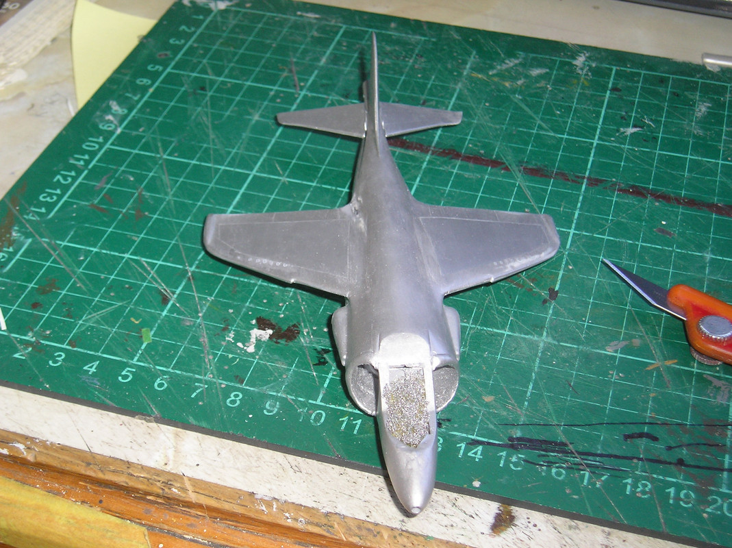

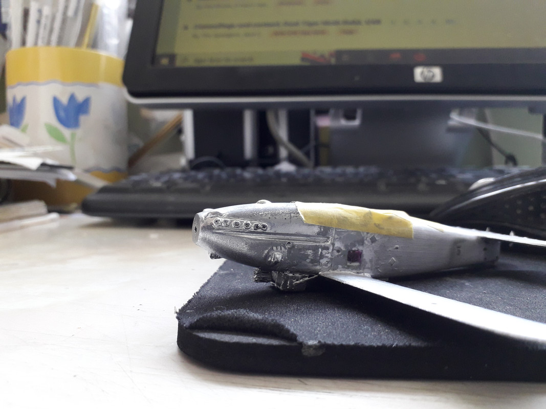

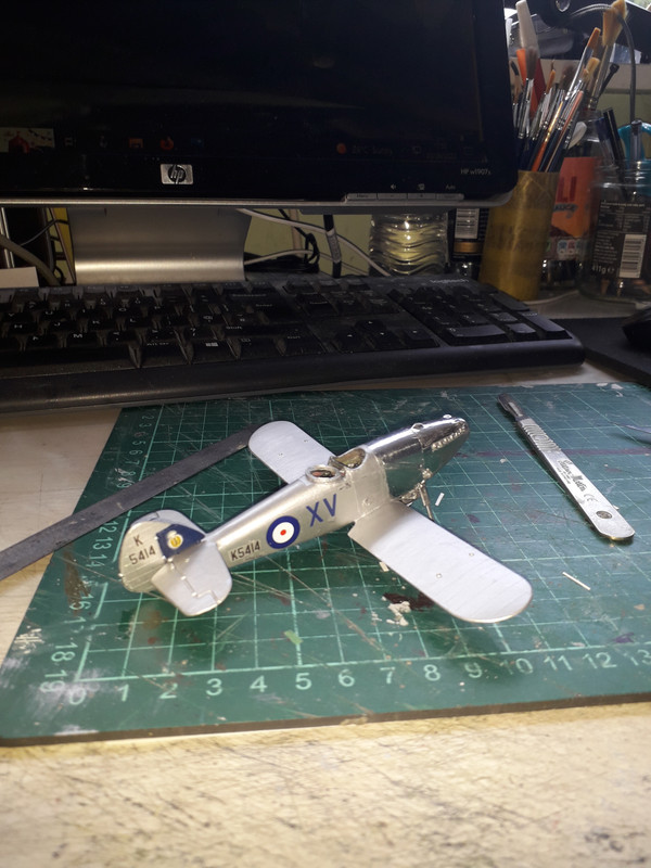

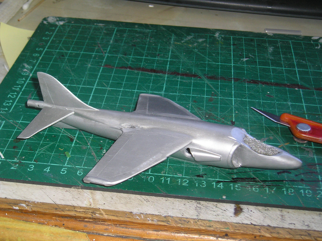

perdu Posted June 22, 2022 Author Share Posted June 22, 2022 This morning I gave the stickers a chance to impress me on the Hind. Colour me uncertain... Once I find small serials for pre-war bipes I can reattach the undercarriage and make the benighted thing a biplane. Kinda like this only betterererer. Utter c rap I think, the nose has been finished with a combination of Bare-Metal foil and Molotow. You know what? I might paint it brown and green camo instead... I have lost the gunsight for the Hurri and begun more painting on the Kestrel. Paint got put on And taken off in selectively selected other places Still not sorry I didnt open up the wheel wells, so there! On top we have Some shades of aluminium paint. The once busted tailplane tip still OK Special decals for this on the agenda soon. ciao 10 Link to comment Share on other sites More sharing options...

perdu Posted June 22, 2022 Author Share Posted June 22, 2022 Yes they will mostly CalliG, like the small serials on the Hind. Most of the decals here though are from the Modeldecals set. Legs on now and much progress needed to play catch up with where it was before I messed up the nose again. I need to remake the rear seater/standee's windscreen as well as the pilot's harness to reattach.. Johnny's lovely wheels will be painted and added to the undercarriage too as will the tail wheel I had to make up for this version as it has a wheel instead of a skid. For the Kestrel I need to print over the most heavily browned out piece of decal sheet I can find with the ejector seat and intake warnings. That search continues... 10 Link to comment Share on other sites More sharing options...
giemme Posted June 22, 2022 Share Posted June 22, 2022 Looks good to me, Bill Ciao 2 Link to comment Share on other sites More sharing options...
Terry1954 Posted June 22, 2022 Share Posted June 22, 2022 That last shot looks superb Bill. T Link to comment Share on other sites More sharing options...
Martian Posted June 22, 2022 Share Posted June 22, 2022 The Hind is coming along nicely Bill. Martian 1 Link to comment Share on other sites More sharing options...
corsaircorp Posted June 22, 2022 Share Posted June 22, 2022 Look like a nice hind to me !! Well done Sir !! CC 1 Link to comment Share on other sites More sharing options...
Galligraphics Posted June 22, 2022 Share Posted June 22, 2022 4 hours ago, perdu said: For the Kestrel I need to print over the most heavily browned out piece of decal sheet I can find with the ejector seat and intake warnings Could you add a light browny-yellow background when you create the ejector seat and intake warning signs? Printed on clear decal paper? 1 Link to comment Share on other sites More sharing options...
