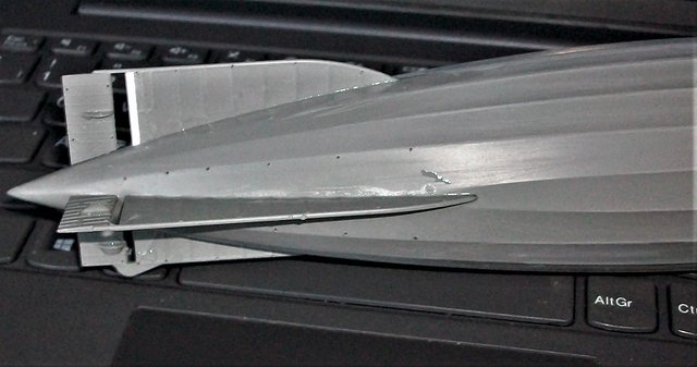

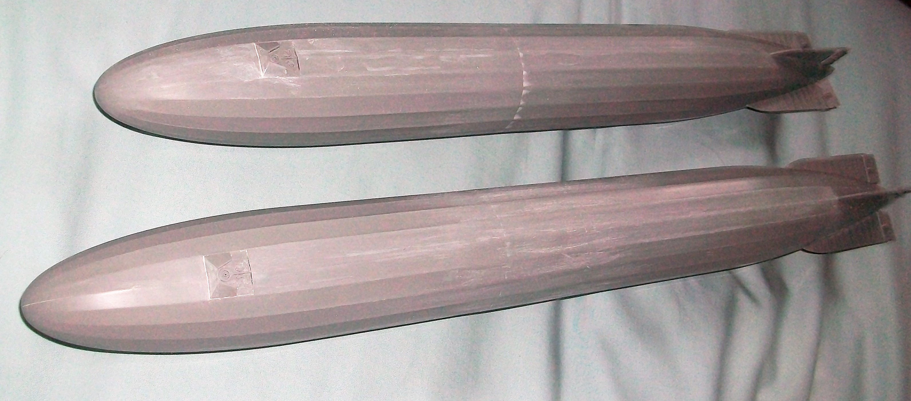

Martian Posted November 25, 2021 Author Posted November 25, 2021 We now have the hull of the P Class glued together and have the first of the heads ups. While there is a good strong join between the fore ad aft parts of the hull, there is a small but very noticeable step between them. A small amount of filler and some vigorous sanding will take care of this. There is a gap between the fore and aft lower panels for the hull and a section of .30 'thou plastic card was let into fill it. At this stage, probably the most urgent heads up involves the supports for the rudders and elevators. These are very prone to catching on just about anything in their way with concomitant risk of damage or breaking. I found the best thing to do was to get the elevators and rudders prepared early on in the build and get them fitted to the main assembly as soon as possible. This adds considerable strength to this area. Even though there is a considerable gap between the control surfaces and their respective rudder/elevator posts, I felt that the gap between the upper rudder and the rudder post was too great and let in some plastic stock to reduce it a bit. Most of the locations for the gondola and outrigger supports are just anaemic dimples and will offer little or no support when we come to build these areas. I have therefore deepened these by drilling them out and enlarging them slightly to allow for some wriggle room when I come to tackle these areas of the model. Next up will be to sand the hull down a bit more and start marking out where the the frames for the hull should be and begin scribing them. The blobs on the last picture are drops of water from were I have been wet sanding the model and not dried it off properly. Thanks for looking. Martian 👽 22
Graham Boak Posted November 25, 2021 Posted November 25, 2021 Is the step between for and aft hulls all the way round, or can it it be removed by appropriate pieces of microstrip between the parts? Or at least minimised? 1
Martian Posted November 25, 2021 Author Posted November 25, 2021 13 minutes ago, Graham Boak said: Is the step between for and aft hulls all the way round, or can it it be removed by appropriate pieces of microstrip between the parts? Or at least minimised? It is there all the way round but I found that a smear of Mr White Putty and sanding out over about four inches either side of the join took the step away without leaving a dip in the hull and without any need for adding plastic stock. The step is very small but does need attention all the same. Once the putty had cured, it took me less than half an hour to remedy matters. Martian 👽 5
europapete Posted November 25, 2021 Posted November 25, 2021 looking good Martian, too late now, but for other builders, how about joining the fore n aft parts first using dry fit to eliminate most or all of the step, then glueing the two built halves? Would that work? Regards, Pete in RI 3

Martian Posted November 25, 2021 Author Posted November 25, 2021 1 hour ago, europapete said: looking good Martian, too late now, but for other builders, how about joining the fore n aft parts first using dry fit to eliminate most or all of the step, then glueing the two built halves? Would that work? Regards, Pete in RI Thanks Pete, that could work, though there will be some filling regardless as there are one or two small holes that need filling. 1 hour ago, gingerbob said: And now I'm hearing Prince in my head... "Remarkably large courgette, baby you drive too fast..." So, what's it going to be when I have the larger Q Class together? Or if Takom go on todo the even larger R Class! Martian 👽 1

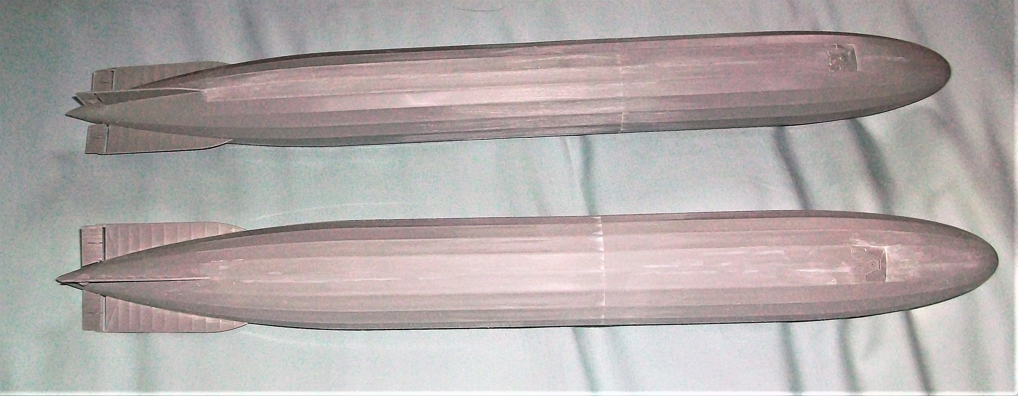

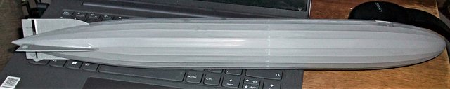

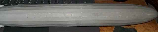

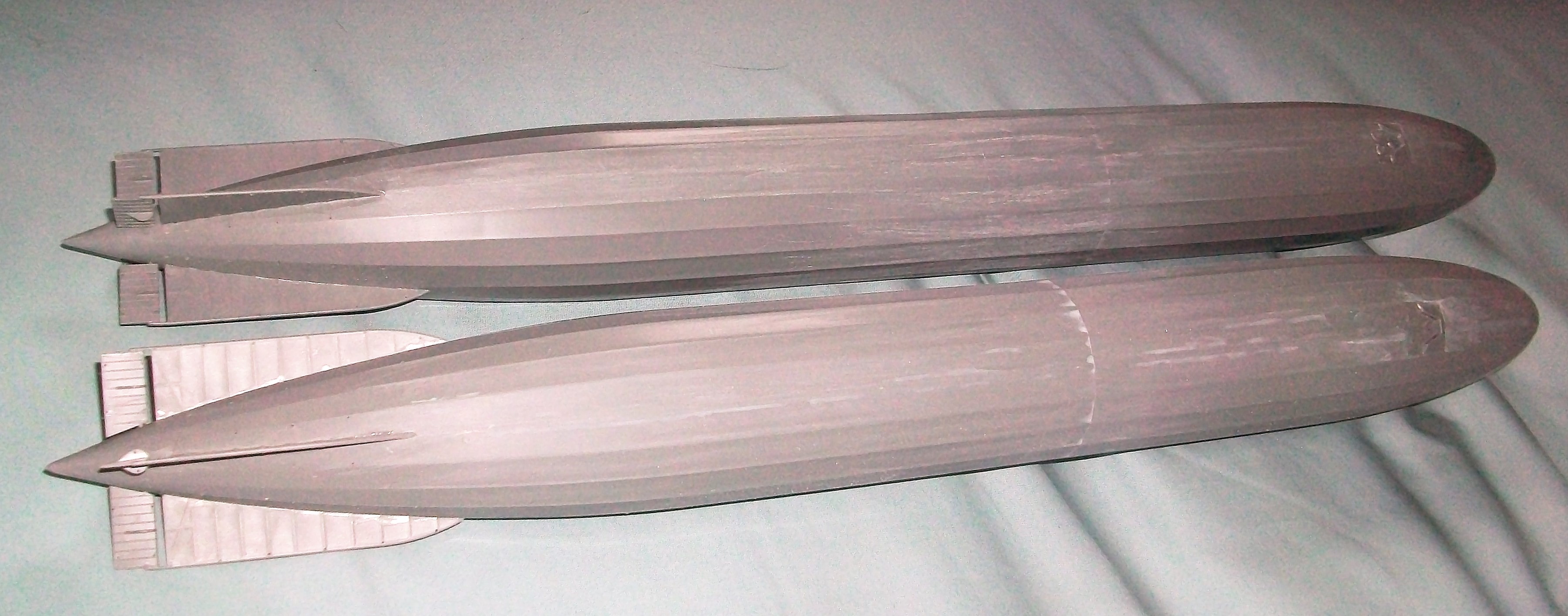

Martian Posted December 3, 2021 Author Posted December 3, 2021 What has he been up to recently? I hear you all ask. The answer is that I have been busy getting the Q Class ship to the same stage that the P Classis at. I have just the filling on the lower hull panels of the Q Class left to do and they will both be ready for a lot of fine sanding and polishing, prior to all that scribing that I have been so looking forward to. This leads me to a question. The next stage on the hulls is not exactly going to be a five minute process and is likely to be somewhat short on "eye candy". Does anyone have any ideas as to how I might keep you all entertained whilst this process is taking place? I thought about showing where I have got to with Mark1's 1/720 R Class kit That I am converting to the L.48 but that build is at exactly the same stage as these two bad boys. I notice that Airfix's BE 2c has markings for Leefe Robinson's machine so I could just about fit that on the bench or I could put some pictures up of my Zeppelin souvenirs. I also have a 54mm figure of Kapitain-Leutnant Peter Strasser that plan to add to the display. Anyway here are some not very interesting pictures. Thanks for looking. Martian 👽 21
npb748r Posted December 3, 2021 Posted December 3, 2021 1 hour ago, Martian said: The next stage on the hulls is not exactly going to be a five minute process and is likely to be somewhat short on "eye candy". what is the next stage all about ?? You mention loads of scribing, would be good to understand what and why - if this had wings and was made of metal I'd know instantly what you planned to do but being new to floaty things I am clueless (as I have been for most of my life really !!!). By the way, on the back of this post I have one of these on backorder at an online store so following with interest so I can learn something. 2
Martian Posted December 3, 2021 Author Posted December 3, 2021 1 hour ago, npb748r said: what is the next stage all about ?? You mention loads of scribing, would be good to understand what and why - if this had wings and was made of metal I'd know instantly what you planned to do but being new to floaty things I am clueless (as I have been for most of my life really !!!). By the way, on the back of this post I have one of these on backorder at an online store so following with interest so I can learn something. When you look at a Zeppelin you can see longitudinal stringers which Takom have got right. You will also see very prominent vertical lines, spaced at regular intervals. these are where the frames of the airship are located and where the outer covering of the envelope is stitched to the frames. Takom have neglected to represent these and this is the scribing to which I refer. Hopefully this makes things clearer: Martian 👽 11 1
