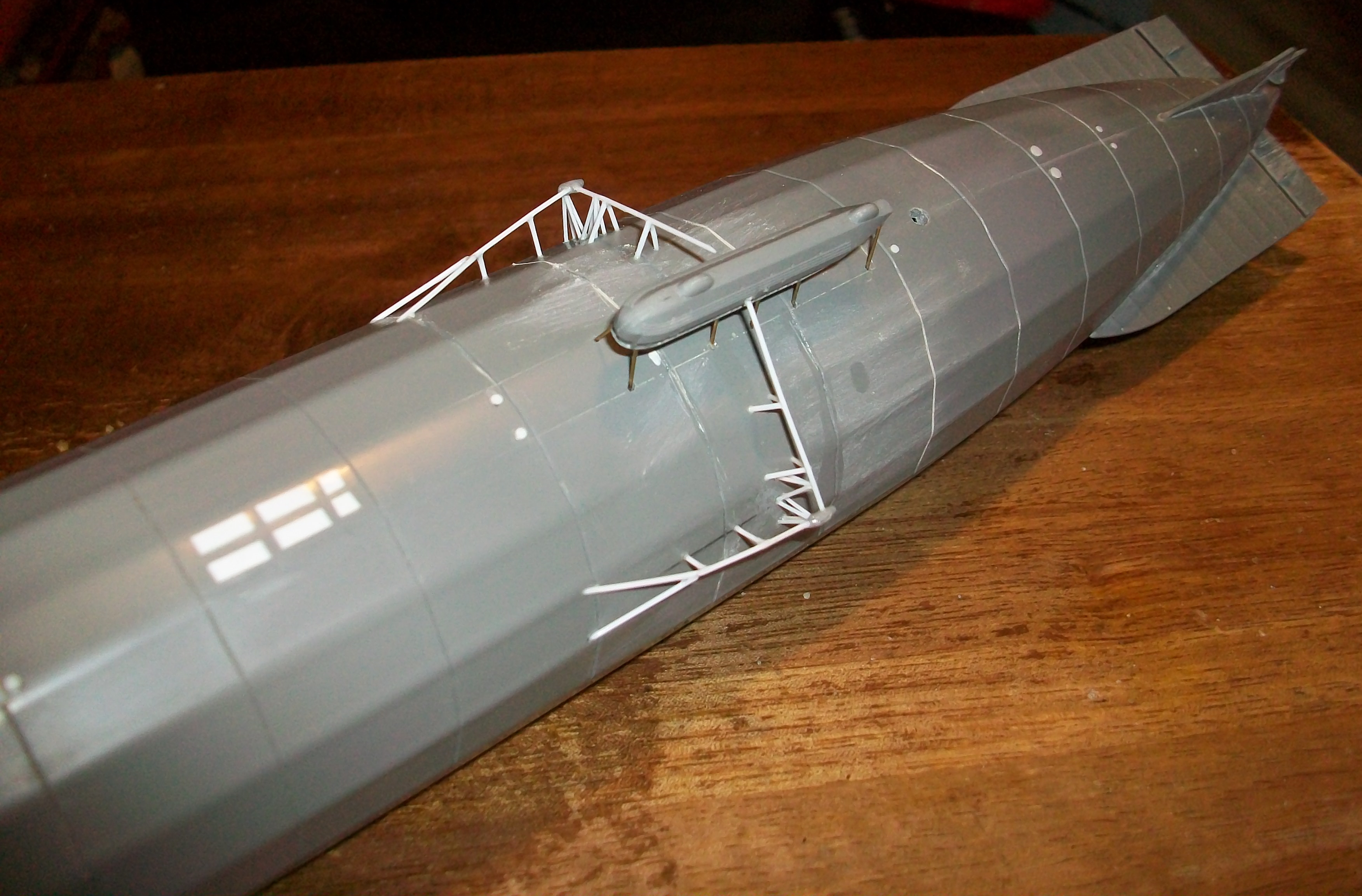

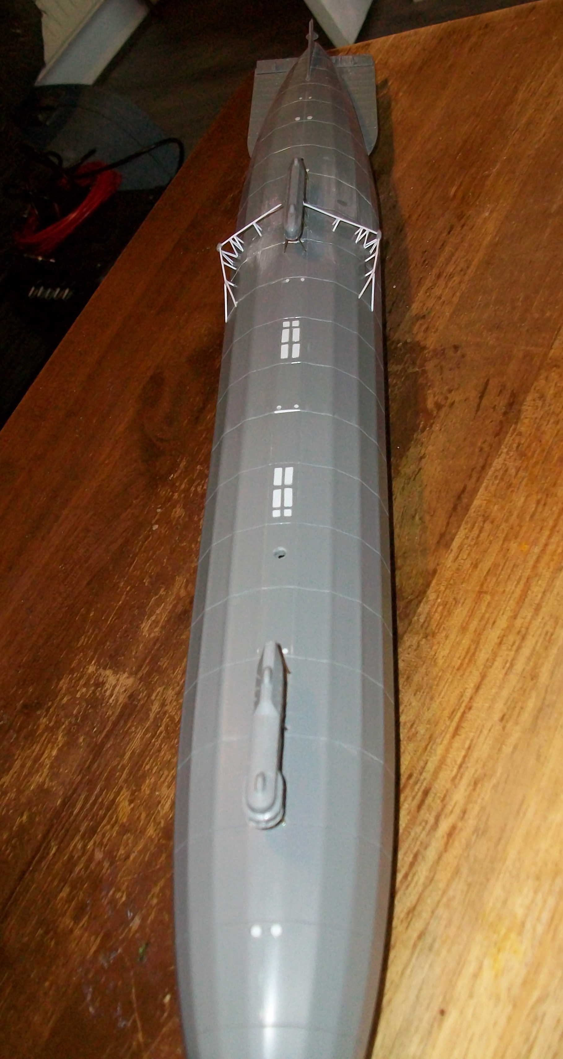

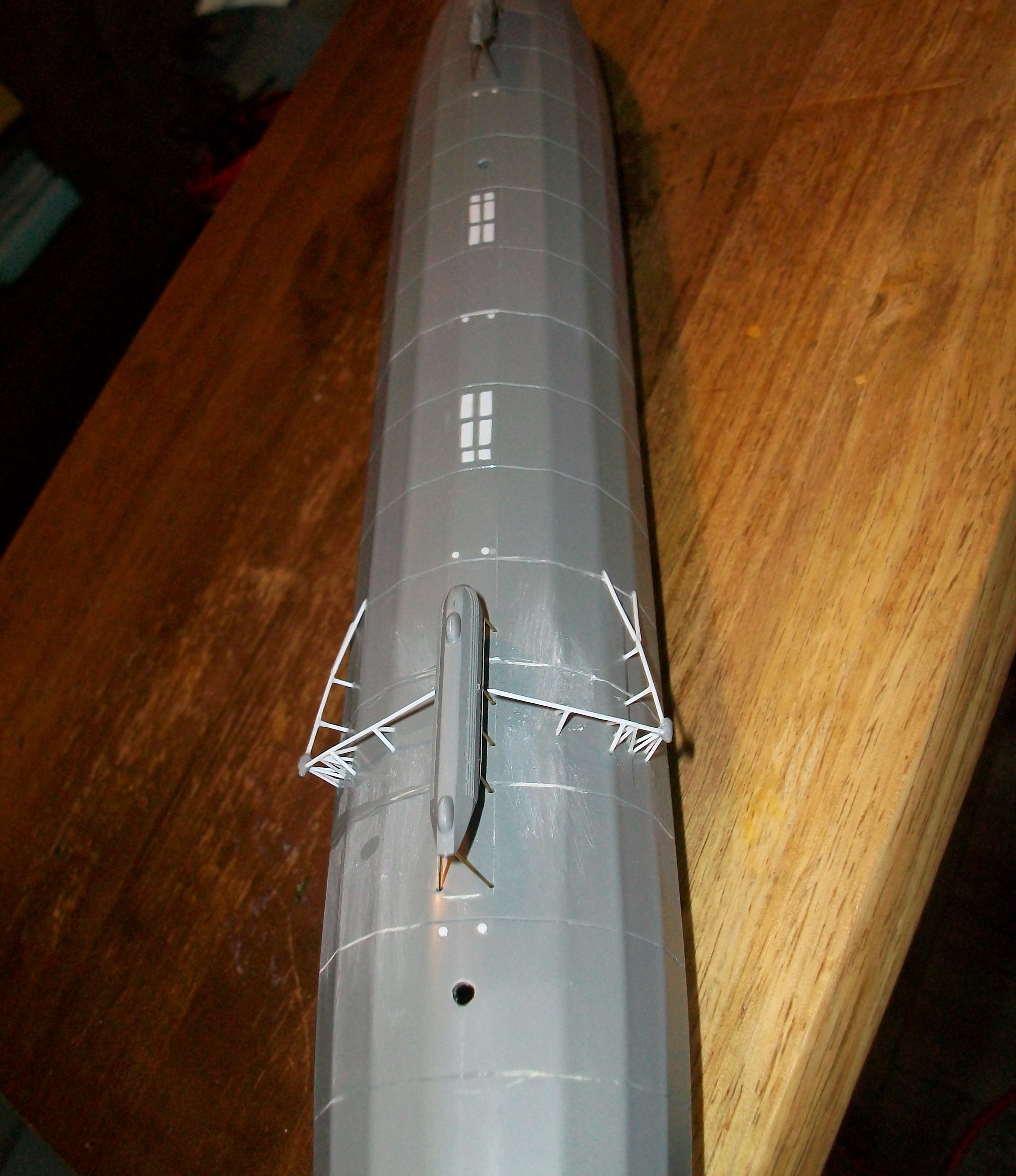

Martian Posted February 23, 2022 Author Share Posted February 23, 2022 Once again I am going to have to be a killjoy and interrupt the learned debate that has been going on with a progress report. Plastic worrying has taken place and the secondary supports for the outriggers have been attached to the P Class and a start made on the same for the Q Class. The outriggers, if one is replacing them, are probably the hardest part of the build and, if one is going down the plastic route, need to be dealt with in four phases due to the imperative to allow glued joints to set properly before proceeding to the next stage. For those that choose to go down this route, I shall take you through them stage by stage. Stage One: Assemble the structure that leads forward from the driveshafts and allow to set overnight. Stage Two: Construct the driveshafts and glue them to the previously constructed supports. Do not glue them to the gondola as we need to remove this later for detailing and painting. Once again, let this set overnight. Stage Three: Add the main supports for the driveshafts and set aside to dry. Stage Four: add the secondary supports at the end of the driveshafts and your out riggers are now complete. For maximum strength, I use Tamiya Extra Thin cement for the joins and then very carefully run some thin CA over them. Although the outriggers are flimsy at first, the four stages do build up into a very robust structures. I shall proceed with detailing the gondolas as soon as I have completed the out riggers on the Q Class ship. They are at the end of stage two at the moment. Thanks for looking. Martian 18 Link to comment Share on other sites More sharing options...

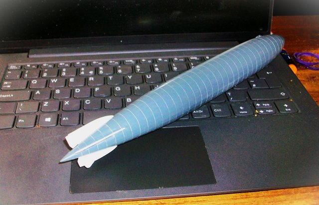

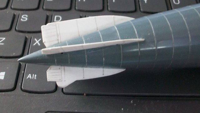

Martian Posted February 26, 2022 Author Share Posted February 26, 2022 The outriggers on the Q Class build are proceeding apace but I can't see much point in posting identical pictures of what I have already shown you. So, in other plastic action, I have been working on the first of the R Class models. There is good and bad news here. During a recent reorganisation of the house, the Martian Cave included, three of the four parts for the tail surfaces went walkabout, seemingly never to return. No matter says I, I can use the parts from my second R Class kit as templates to scratch build a new set. This has duly been done. The upshot of this extra styrene molesting is that I feel the parts that I have made for the model are better than those supplied in the kit. In one respect this is obviously good as I will end up with a nicer model. However, the parts were a right fag to make and part of me thinks that I should scratch new parts for the second R Class and the U class kits but the lazy side of me says not to go through all the extra hassle x 2. I shall therefore, leave you with the pictures and go and award myself a well deserved "confused" reaction to this post! Wibble! Thanks for looking. Martian PS: I still have to make the control Horns. 17 1 Link to comment Share on other sites More sharing options...
