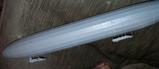

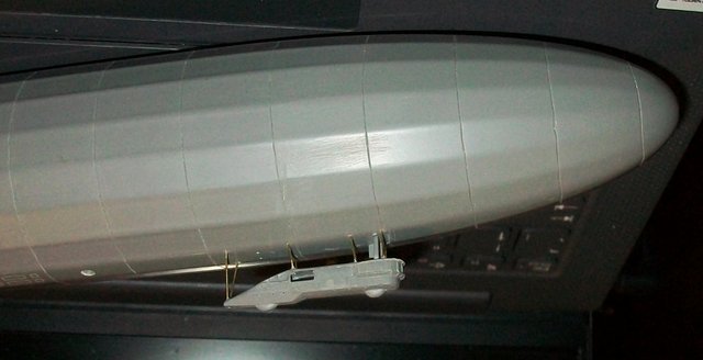

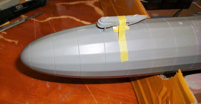

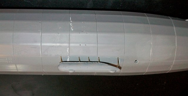

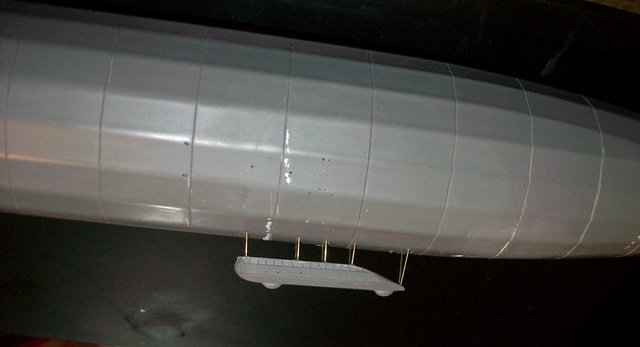

Martian Posted January 22, 2022 Author Share Posted January 22, 2022 Well it looks like I am going to have to disappoint @Learstang as my plan to sort out the gondola struts seems to be working. How I have gone about creating stronger struts is as follows: First, I laminated sone plastic strip together until I had got it to the distance that I wanted the gondolas to sit beneath the hull and temporarily attached it to the hull with double sided sticky tape. I then attached the gondola to the plastic strip, also with double sided tape. I also added some Tamiya tape to be sure that things would not move about too much. With the gondolas held in place, I cut some Albion Alloys' 0.45mm brass rod to about 1.5mm over the length that I needed and sharpened both ends with a diamond file. Then, starting with the foremost struts, I the applied Super Goo (Gel) to the end of the strut that I wanted to attach to the gondola and then slid the unglued end into the corresponding hole in the hull. The wire was then gently slid up to locate in the previously drilled hole in the gondola roof and the CA allowed to set. This procedure was repeated on the opposite side. Once the first two struts were in place , I carried out the same process with the aftermost struts. when these are secure, the other struts can be fitted as described. Once the CA has had time to properly cure, the gondola can be, carefully lifted clear of the hull and we can then carry on with detailing it. More on that later ,as in many respects the etch brass with the kit is either, too small/so small it is breaking on the fret even be for it has been handled (not good!), is lacking in detail or is just way too two dimensional to cut the mustard. I may try using some 0.40mm or 0.35mm rod on the Q Class build. I need to be careful there though as I don't want to end up making the struts too fragile. I would far rather have them a bit over scale than have a model that breaks as soon as you breath on it, let alone try and take it anywhere. Thanks for looking. Martian 24 Link to comment Share on other sites More sharing options...

JohnT Posted January 22, 2022 Share Posted January 22, 2022 Lovely and ingenious work there my Martian friend. I was very relieved when you posted the last two photos though. When I saw the first two I thought "Wait a minute. The silly interstellar chappie has allowed Baldrick to hold the plans and instructions upside down again. The last time Baldrick did that he had The General making a full frontal assault on the French Riviera. Or do Martians design Zeppelins with conning towers?" I was dreadfully confused for a while and thought I'd need to go back onto the stronger medication again but after a proper reading of the entire post and photos all became clear. Mind you clever chappies the German scientists. Wouldn't put it past them to have gondolas on top to confuse our Ack Ack boys on the ground. 8 Link to comment Share on other sites More sharing options...

TheBaron Posted January 23, 2022 Share Posted January 23, 2022 I see you've been strutting around the place in the next possible sense - a great peice of problem solving on those fittings Martian. By the time you took the last photo it already appears to be heading off into The Matrix under its own power... 1 Link to comment Share on other sites More sharing options...

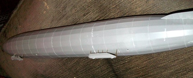

Martian Posted January 23, 2022 Author Share Posted January 23, 2022 Good job I remembered where I put my serious hat this morning as there is more actual modelling to report on. @Learstang will be dobbing me in to the Mods at this rate on a charge of gratuitous plastic worrying on a public forum. (On with the bracelets, chink, chink, oh god I'm nicked: again!) This afternoon, I spent an hour or so adding the struts to the after gondola. Having finally worked out how to do them, they went into place in the time it took me to play a CD, plus about 45 minutes cutting and filing thee struts to shape and length. The Albion Alloys' Cutter was a godsend here in helping me churn out lengths of brass to exactly the same length. One thing I did do was when the struts had set, I let a small amount of thin CA flow into any gaps in their locating holes for extra strength. I will most likely glue the gondolas to the hull with small drops of 5 minute epoxy cement so as to allow time for any adjustment. I have made the locating holes in the hull slightly over sized to allow a bit of wriggle room during this process. Thanks for looking and back to the mayhem that I so rudely interrupted. Martian 11 1 Link to comment Share on other sites More sharing options...
