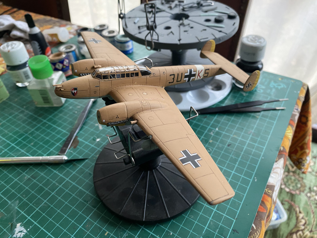

TonyOD Posted December 2, 2021 Author Share Posted December 2, 2021 This will be the extent of my weathering, well not weathering really, just an attempt to add a bit of life to it. A mix of brown and dark grey Humbrol enamel washes thinned with lighter fluid and thrown at the panel lines. It might bear a last wipe down with thinner-moistened kitchen roll. After that, one last coat of Klear and then it'll be time for a matt finish. 7 Link to comment Share on other sites More sharing options...

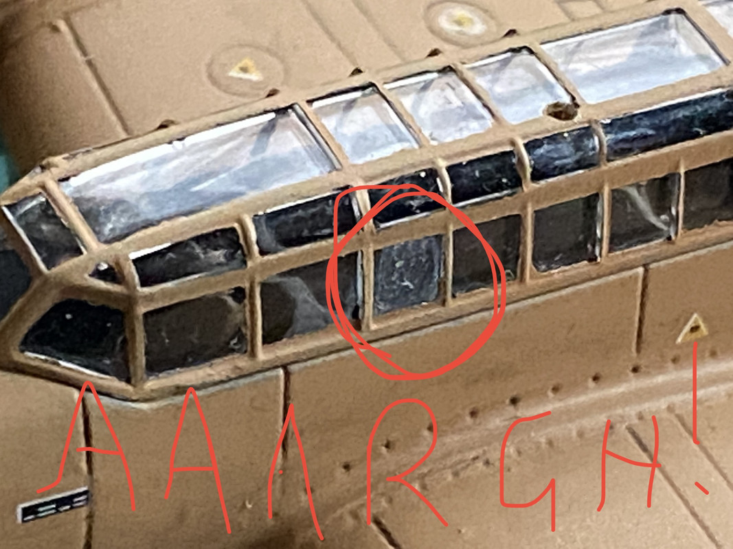

TonyOD Posted December 5, 2021 Author Share Posted December 5, 2021 Nearly there now… …but I’ve managed to put a very visible glue thumbprint on the canopy while sticking it on, which is infuriating. Going to have a go at polishing it out. 6 Link to comment Share on other sites More sharing options...
Hook Posted December 5, 2021 Share Posted December 5, 2021 Isn't it always this way...? Good luck with the polishing! 1 1 Link to comment Share on other sites More sharing options...

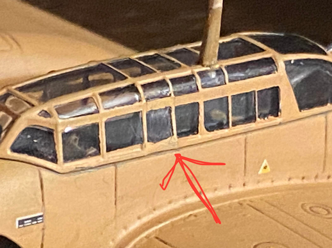

TonyOD Posted December 5, 2021 Author Share Posted December 5, 2021 (edited) Not that it merits a picture, the polishing of the glue print o the canopy has improved things a bit, although I'm going to need to touch up the framing. In other news, the panel inside one of the engine nacelles broke free while I was putting the landing gear in, the only way to do a good job of putting it back in place would be to dismantle the wing, and that ain't happening, so I've flooded the thing with Tamiya Extra Thin and am hoping for the best... Edited December 6, 2021 by TonyOD 2 1 Link to comment Share on other sites More sharing options...
opus999 Posted December 10, 2021 Share Posted December 10, 2021 The "Arrg!" on the photo made me chuckle even though the thumbprint was an aggravating issue. The framing is so thick I don't know how I would fix it, but it sounds like you improved it. Wow, this looks great. I find that I'm thinking more and more about doing a 110 in this scheme. Before I was thinking of doing a night fighter. Hmm... Might have to do both. 1 Link to comment Share on other sites More sharing options...

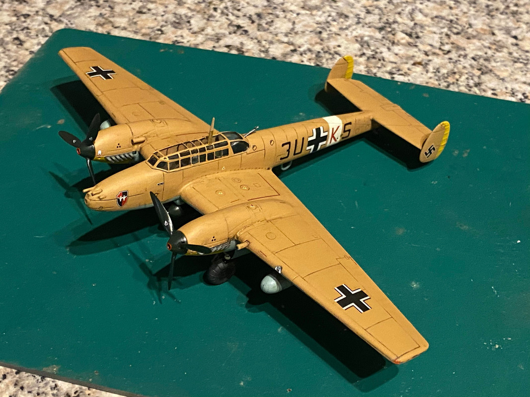

TonyOD Posted December 11, 2021 Author Share Posted December 11, 2021 12 hours ago, opus999 said: The framing is so thick I don't know how I would fix it, but it sounds like you improved it. Yeah that's pretty much where I'm at. I couldn't get into the edges but I've managed to shift the worst of it and then touch up the framing, doesn't look bad to the naked eye. Anyway, the bird is finished. I'm happy enough with it, it's been a fun build and it is a nice looking plane. RFI pics and maybe a bit of commentary later. Many thanks to everyone who's looked in on this one. 9 Link to comment Share on other sites More sharing options...
Hook Posted December 11, 2021 Share Posted December 11, 2021 She turned out pretty good! Cheers, Andre 1 Link to comment Share on other sites More sharing options...
Martian Posted December 11, 2021 Share Posted December 11, 2021 Nice! Martian 1 Link to comment Share on other sites More sharing options...
John Posted December 11, 2021 Share Posted December 11, 2021 Very nice job. I'm quite fond of the Airfix Bf110 - no doubt nostalgia for the old Dogfight Double . One thing I did with mine that I think improves the look quite a bit is to add Quick Boost mass balances to the undersides of the ailerons. It's another one of these "can't unseen it" things for me John 2 Link to comment Share on other sites More sharing options...

TonyOD Posted December 11, 2021 Author Share Posted December 11, 2021 @John Got to be honest I don't even know what they are and I'm going to avoid looking them up to avoid spoiling it for myself The RFI pics are here if anyone's interested. Cheers 3 Link to comment Share on other sites More sharing options...
VT Red Sox Fan Posted December 11, 2021 Share Posted December 11, 2021 Nice—I really like the restrained weathering—best, Erwin 1 Link to comment Share on other sites More sharing options...
opus999 Posted December 12, 2021 Share Posted December 12, 2021 Oh yes, that turned out nice. I really like it's look in that scheme and your weathering and wear. 1 Link to comment Share on other sites More sharing options...
TonyOD Posted December 12, 2021 Author Share Posted December 12, 2021 33 minutes ago, opus999 said: Oh yes, that turned out nice. I really like it's look in that scheme and your weathering and wear. Thanks. I’ve had a few positive comments about the weathering… really nothing to it, just an enamel wash (brown/dark grey mix) diluted with lighter fluid, a trick I learned from @Troy Smith. For the effort I put into it (i.e. practically none) it doesn’t look bad, and it’s a skill level I’m comfortable with. 1 1 Link to comment Share on other sites More sharing options...
