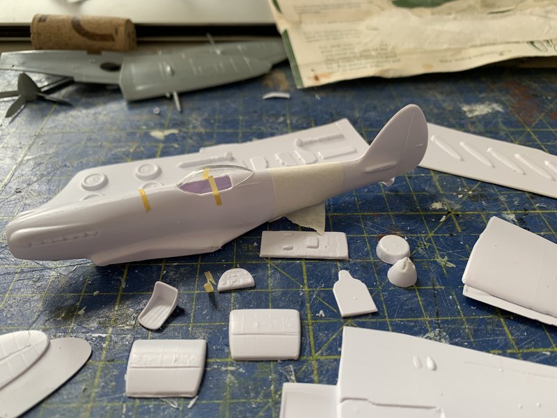

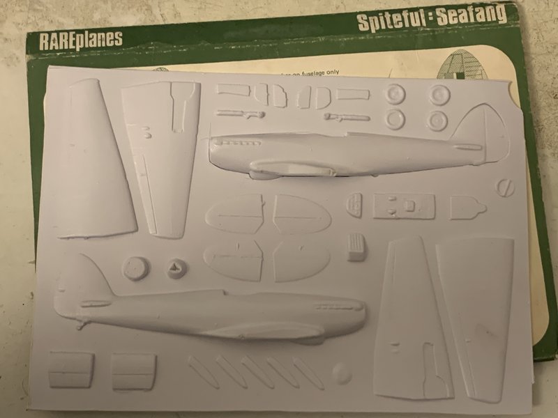

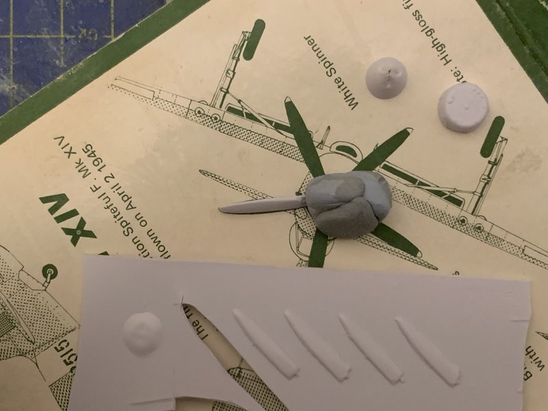

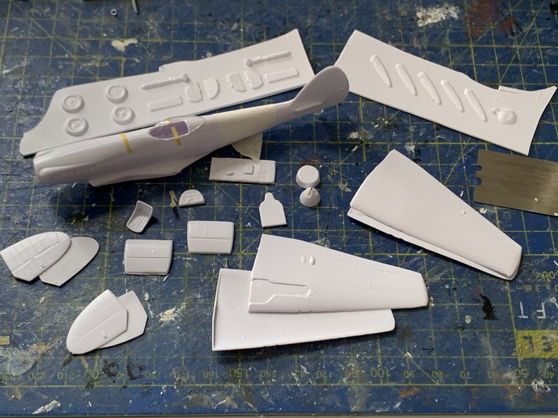

AdrianMF Posted July 31, 2021 Posted July 31, 2021 This one only dropped through my letterbox from eBay on Thursday. It’s not “collector price” because the packaging has been savaged and the spinner and wing roots have suffered from attic rash: I was just looking at it with a scalpel in my hand, and this happened: I have a Frog Spitfire XIV+V1 kit that I can take mouldings from if the propeller and wheels don’t work out: The canopy is not yellowed (good) but it doesn’t have a clean edge to show where to trim it (bad!). I thought at one point that I had messed it up but it suddenly fell into place after a bit more trimming. 15

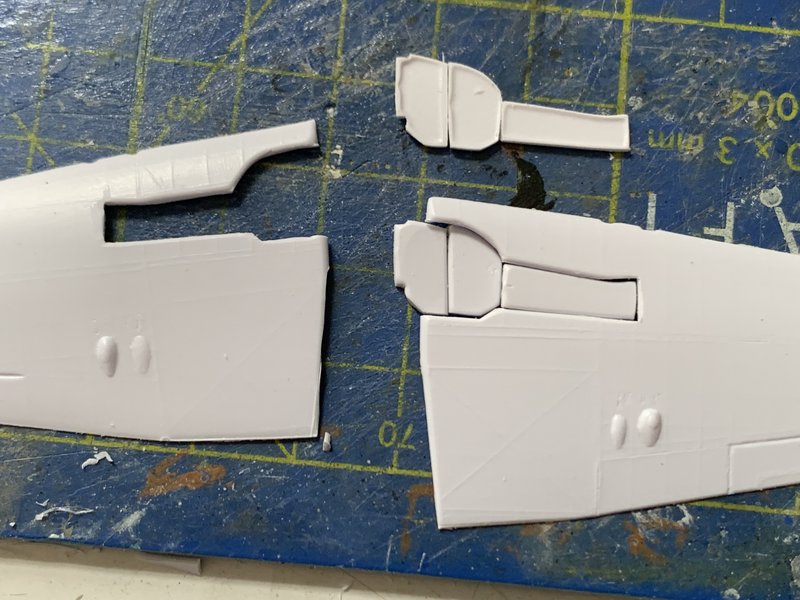

AdrianMF Posted July 31, 2021 Author Posted July 31, 2021 Wheel wells and doors done. I’m going to leave the raised edges for a bit of visual interest: I will do a 5 thou roof that I can extend to cover the bit of the well in the fuselage. 6

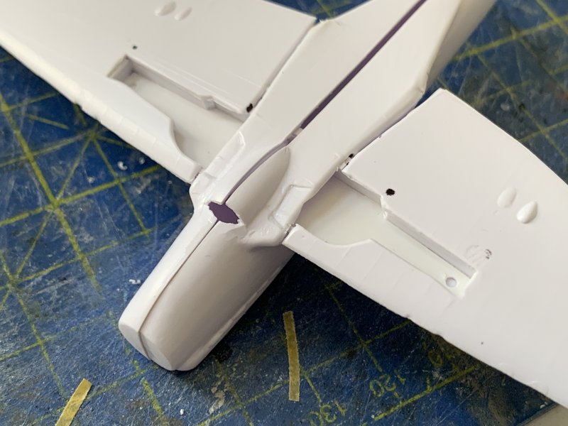

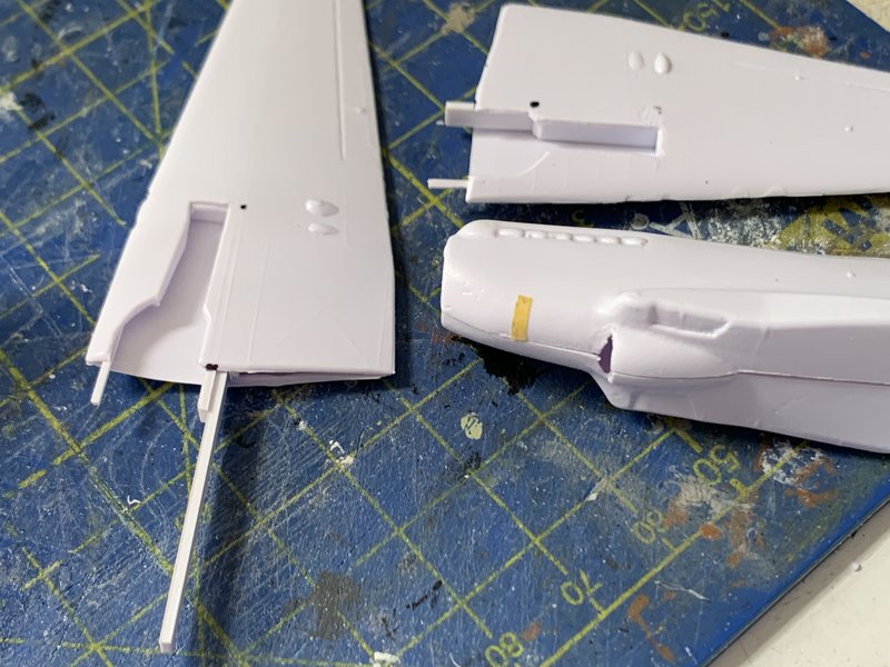

AdrianMF Posted August 1, 2021 Author Posted August 1, 2021 A bit more: box in the undercarriage, cut away the blobby air intake, add a guide for the wing spar (dummy spar dry fitted here), add some gluey fingerprints! I’m going for the early version before the intake was extended up to the chin. Rareplanes do provide a plastic shape that you can cut out to replace the whole lower cowling but that looks like a step too far to me for a fun build. If I were to do it I think Milliput would be my weapon of choice. Regards, Adrian 7

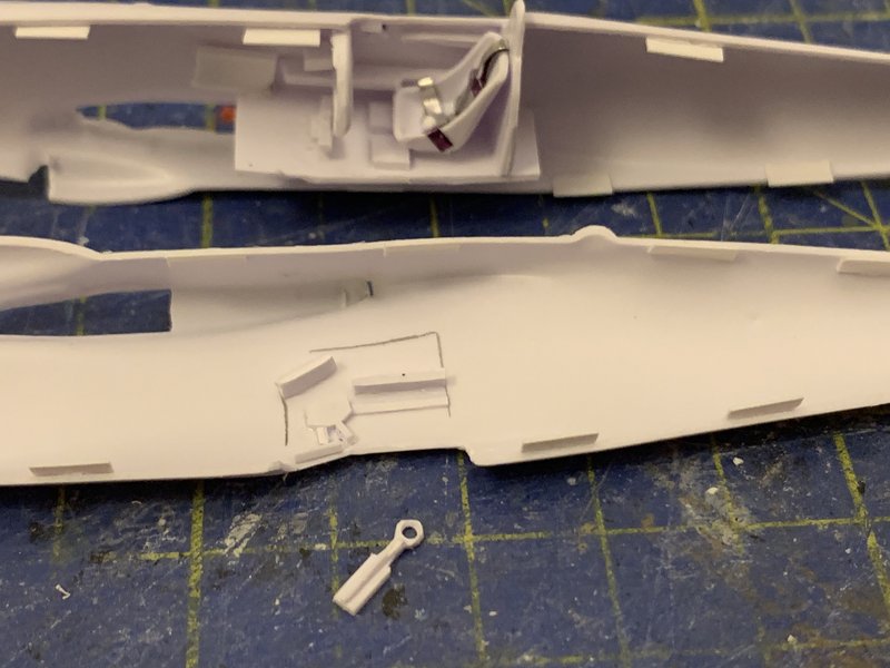

AdrianMF Posted August 1, 2021 Author Posted August 1, 2021 Spar made and dry fitted, undercarriage wells coming along and looking embarrassingly deep, almost deep enough for the wheels! 5

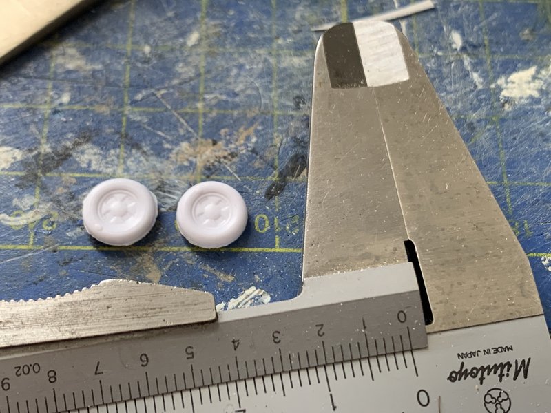

AdrianMF Posted August 1, 2021 Author Posted August 1, 2021 The vac wheels turned out nice enough, both 2.8mm wide: [edit] or do I mean thick? anyhow , the direction you sand down in! 5

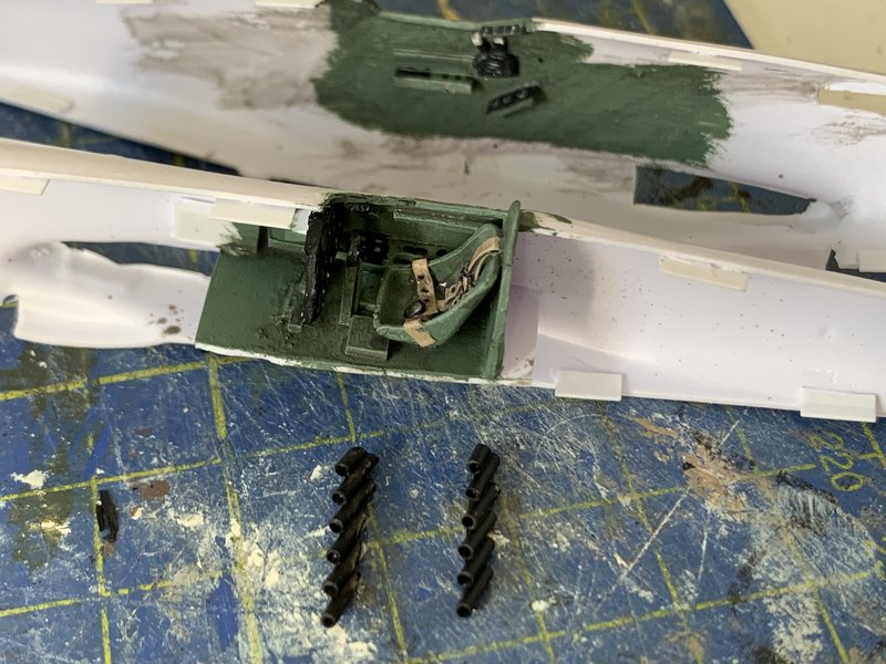

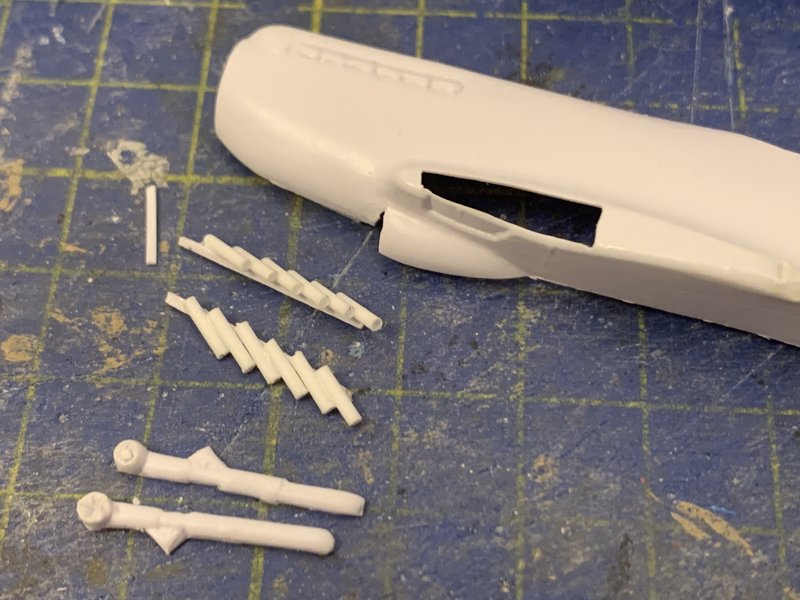

AdrianMF Posted August 2, 2021 Author Posted August 2, 2021 Some more progress tonight. I knocked up a quick cockpit around the rather nice seat and instrument panel that come with the kit: And I decided I couldn’t live with the rather ill-defined exhaust stacks so I made some more from 1.2mm rod with the ends hollowed out: I cleaned up the kit undercarriage legs too - they might well make it onto the build! 7
AdrianMF Posted August 2, 2021 Author Posted August 2, 2021 Just for a laugh I will try to make the propeller. I will mould five copies of the blade in Milliput after I’ve extended it a bit: 8

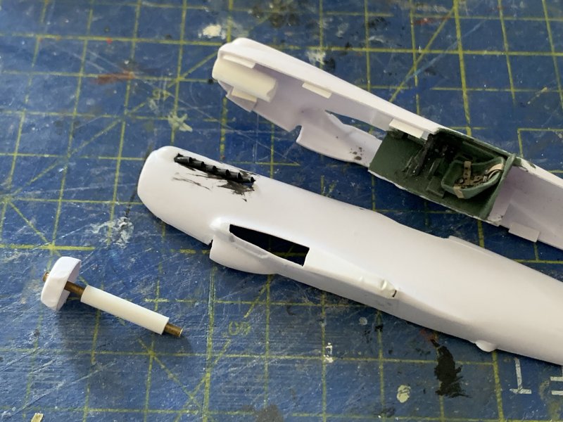

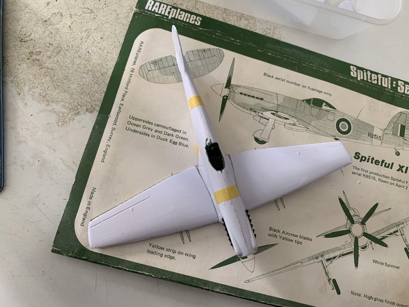

AdrianMF Posted August 7, 2021 Author Posted August 7, 2021 On 05/08/2021 at 19:08, Troy Smith said: All look like the underside colour to me. Me too. Thanks! On 05/08/2021 at 19:27, Alex Gordon said: Good work so far Adrian Thanks Alex, made a bit more progress today. 22 hours ago, PlaStix said: a vacform!! I was regretting that a bit (especially as a Pegasus one has come up on the bay for less than a tenner) but I think I’ve got over the tricky vac bits now (he said, tempting Fate). 7 hours ago, stevehnz said: pure beauty. Its main shortcoming seemed to be that it wasn’t a Spitfire, sadly, and the Tempest/Fury/late Spitfire were all available to fill the gap until the jets got going. Progress today! Cockpit painted and exhausts given a coat of black before fitting: A propeller housing more-or-less central and square, and the inner mechanism that should allow a freely-rotating prop: Fuselage together and and wings glued in over the wingspar: Starting to feel like a regular kit now! 7
