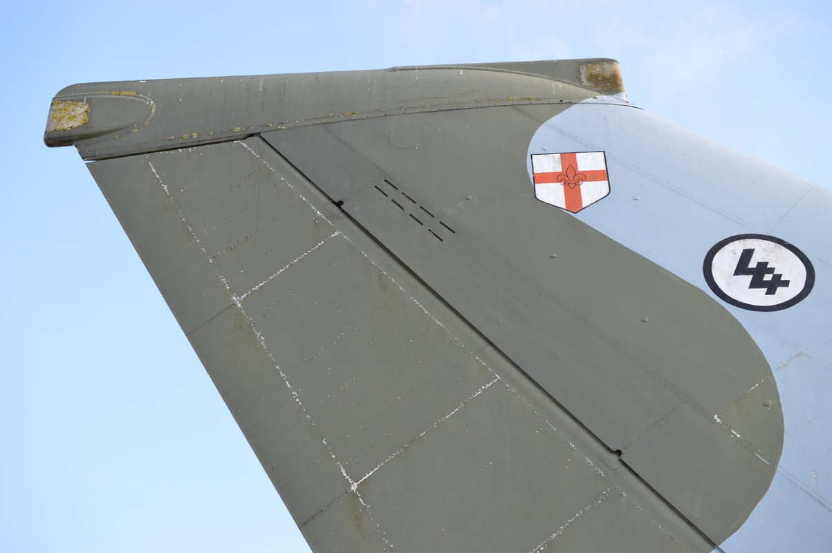

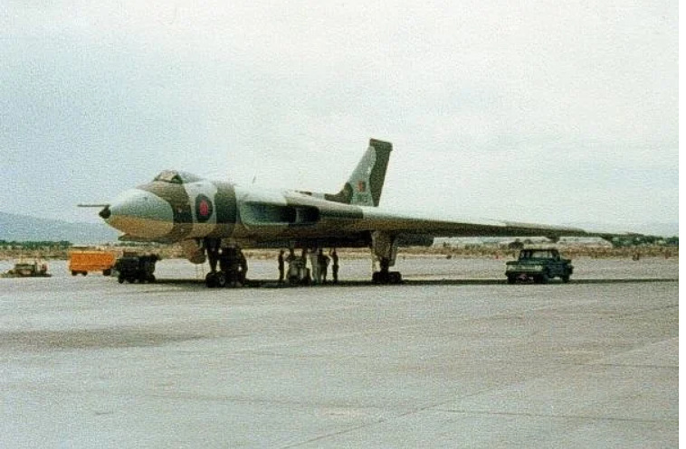

Adam Poultney Posted July 5, 2021 Author Posted July 5, 2021 @Seamus, good news! I have found a very useful photograph of XM594 in freefall bomber configuration c.1973. Some Vulcans kept their Type D roundels well into the 70s Photograph I immediately noticed that you'll need to use the later UHF aerials, which were painted yellow, and by this point TFR was installed. Less obvious is the ECM tailcone tip, in the kit scheme you'd need to just leave it as is, with the slightly less bulbous, more rounded part which housed Orange Putter. In the 1973 scheme, you'll need to use the alternate part provided for Red Steer Mk.2 which had a longer and more bulbous housing. They really didn't make this easy with so many strange names in the same format... Blue Steel, Red Steer, Orange Putter, Yellow Sun, Blue Danube, Red Shrimp, Violet Club, etc... 6 1

Adam Poultney Posted July 5, 2021 Author Posted July 5, 2021 13 minutes ago, general melchett said: The change to Low Visibility (blue/red) markings occurred circa 1973 and the change to LAG and a 'matt' finish started a short while later. A few aircraft were seen sporting an interim finish with a combination of black radome, non RWR fin cap, Low Visibility markings LAG undersides and a white 'bib' on the underside of the nose but these were quickly upgraded to the standard finish as they passed through servicing and maintenance. It's a bit of a pain trying to figure out exactly which airframes had the low viz with black radome scheme of either variation... I'm slowly compiling a list of each one which has it in photographs, but need to start again after i realised there's two variations (fulln white underside or LAG underside). It's also one of the few schemes entirely missing from my collection (also missing are the ones from 617 sqn with type d roundels and no black radome, the unique camo worn by XM607 with a desert camo underside, XH558's version of wrap around and the experimental DSG scheme applied to XM600 and XM597) 2

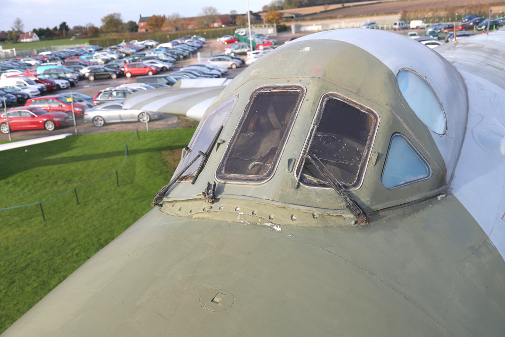

Adam Poultney Posted July 5, 2021 Author Posted July 5, 2021 Crude attempt at a central wiper in the neutral position. 9

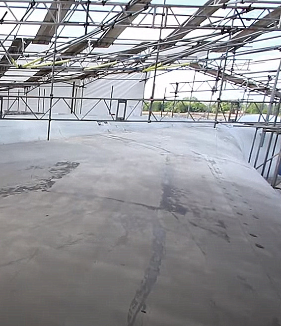

general melchett Posted July 5, 2021 Posted July 5, 2021 (edited) Quote 1 - the two rows of rivets or bolt heads on the top of each wing above the front Skybolt bulges. From an engineering point they appear to be related to local reinforcing for the pylon mounting - are these Skybolt related, or (i suspect more likely) are they associated with the Black Buck shrike mounts or Martel trials? Dave, they seem to be related to local reinforcement but the real things are far less prominent than portrayed on the kit. I sanded mine way back, almost smooth, the same goes for the rear ones. They definitely appear on XH558 and XM603 and were picked up on XM594, looking at Airfix's original data LIDAR scans of that aircraft (sadly the upper wings are in a poor state so it's hard to make them out). If so then they wouldn't be related to Skybolt or Black Buck/Martel as 558 wasn't modified to that spec. Regarding the rear ones, as you point out it's a bit of a coincidence that they correspond to the positions of the ECM plate centreline supports when fitted but, so far I haven't been able to find out their exact purpose. XM594 had two ECM plates fitted which may account for the two rows. Interestingly this video of XM603's restoration picks them up nicely. Video, (relevant part from 01.50). Quote The fin is moulded smooth on both sides except for panel lines, however detail photo's of the fin in the Linewrights Vulcan monograph show two widely spaced rows of 6? substantial bolt heads running approx in line with the rudder hinge line at 1/3 and 2/3 chord. They're on at least 2 airframes (XH561 & XM597) on the stbd side and XL462 port side. These appear to be in service circa 1983/84. In the Vulcan Warpaint they're visible on the port side of XH558 on p30 and the stbd side of a 617 sqn fin on p37. Anyone care to speculate on what they are and which Vulcans had them? These were omitted for some reason and are quite prominent on the aircraft (same goes for the two rows of narrow slots). Below is one of the images I took of XM594 during research for the kit. Newark Air Museum were fantastic, giving access to the whole aircraft. Adam, with the use of NAMs 'giraffe' I was able to take a few photos of the windshield (mainly to verify the position of the 'gutter' that runs around it's base), unfortunately the central wiper is missing but you can clearly see the parked position. Edited July 5, 2021 by general melchett 11

Adam Poultney Posted July 6, 2021 Author Posted July 6, 2021 4 hours ago, general melchett said: These were omitted for some reason and are quite prominent on the aircraft (same goes for the two rows of narrow slots). Below is one of the images I took of XM594 during research for the kit. Newark Air Museum were fantastic, giving access to the whole aircraft. Ah I hadn't noticed that they were missing... That's just one more detail on the list of things to add. 4 hours ago, general melchett said: Adam, with the use of NAMs 'giraffe' I was able to take a few photos of the windshield (mainly to verify the position of the 'gutter' that runs around it's base), unfortunately the central wiper is missing but you can clearly see the parked position. I mostly used reference images from XH558 (I know, terrible idea to use anything on 558 for reference for an in service Vulcan) and XM603 as there are readily accessible photos of both, 558 also having a working set is helpful. 46 minutes ago, Rabbit Leader said: Has anyone had a chance to trail fit the new kit’s engine FOD covers onto the old kit? From all reports, that would save me a bit of work! I'll give it a go at some point but I don't expect the fit to be great
