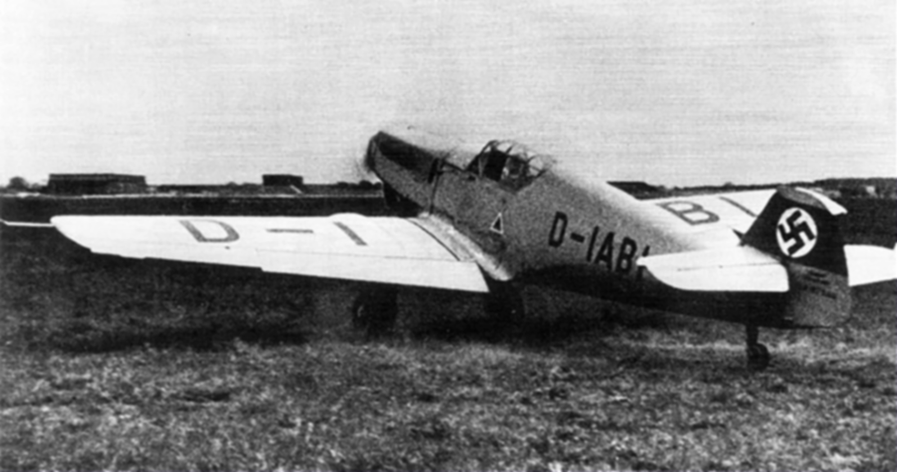

Troy Smith Posted May 24, 2021 Share Posted May 24, 2021 3 hours ago, Marklo said: Afaik just the oil coolers and armament, will recheck my references. long slats, wide balloon tyres, so has upperwing bulges similar to late G/K wings, different wheel doors, circular wheel wells. this is a later prototype, but shows the upperwing bulges HTH T 5 Link to comment Share on other sites More sharing options...

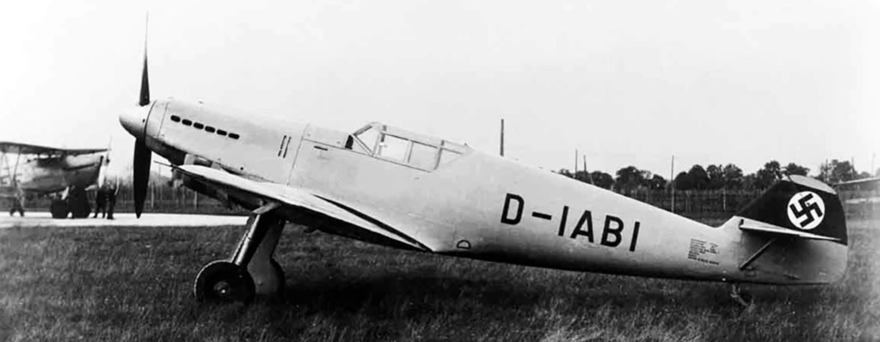

Marklo Posted May 24, 2021 Author Share Posted May 24, 2021 (edited) 1 hour ago, Troy Smith said: 5 hours ago, Marklo said: long slats, wide balloon tyres, so has upperwing bulges similar to late G/K wings, different wheel doors, circular wheel wells. Still nothing too tricky. Good photos. The lower one isn’t V1 but I’m assuming it has the same wing? Now since I have the 109 experts on the thread, tell me this; what colour should it be RLM grey, Silber, Silbergrau, bare metal? or something else? Edited May 24, 2021 by Marklo Link to comment Share on other sites More sharing options...
Graham Boak Posted May 24, 2021 Share Posted May 24, 2021 You can rule out 02 because at this time this was only used on interoris: the exterior equivalent would be 63. Which I suppose could still be termed RLN grey but when bright shiny new wouldn't look quite as light as that. I suspect non-standard colours were still available at that time, for the manufacturers at least. Link to comment Share on other sites More sharing options...
Marklo Posted May 25, 2021 Author Share Posted May 25, 2021 (edited) This the image that leads me to either Silber or bare metal as it looks shiny and metallic. And of course I do have plans to work to Edited May 25, 2021 by Marklo Link to comment Share on other sites More sharing options...
Troy Smith Posted May 26, 2021 Share Posted May 26, 2021 20 hours ago, Marklo said: And of course I do have plans to work just on a casual look, these are terrible. note the wing do not have the long slats, but do have gun access panels, and the wheel bulges are obviously wrong compared to the photo I posted. I think there was colour info in he Monogram German Aircraft guide. I'll have a look if I can find it. You might want ask in the WWII section on possible colours. I know @SafetyDad as many of the references. HTH Link to comment Share on other sites More sharing options...
Troy Smith Posted May 26, 2021 Share Posted May 26, 2021 The Monogram book say the aircarft was 'civiliain grey' with a blue underfusleage. but I don't see a darker blue as their drawing show here, but I know there was a Civil grey. (which I think is similar to RLM63, Hmm @Graham Boak any thoughts?) s this looks to be a far better drawing as well Note, this is the image which Monogram took their blue undersides from all from here https://www.asisbiz.com/il2/Bf-109D/Bf-109D.html 1 1 Link to comment Share on other sites More sharing options...

Marklo Posted May 26, 2021 Author Share Posted May 26, 2021 So a neutral light grey. Would the shiny look in my picture then be due to a semigloss finish or heavy retouching of the image? I’m thinking this might be close it’s a mix of Humbrol greys. Or possibly this it’s AK RFC battleship grey but I think it has a bit of a blue cast to it and isn’t quite neutral. Opinions? Link to comment Share on other sites More sharing options...
Graham Boak Posted May 26, 2021 Share Posted May 26, 2021 It is shiny because it is new and carefully polished up for the publicity photos. But in that period they would be a pretty smooth finish anyway, when new. The Heinkel floatplane appears too dark, perhaps overly influenced by representations of 02 which is wrong for the period anyway. Though the most recent examples of 02 I've seen on this board appear quite the opposite in being too light, but this may not be representative. The lower photo appears nearer but perhaps a little lighter would be preferred, more like the impression given by the nearer wing than the tailplane. However working from b&w photos can be misleading, but at least we are not talking about light blues. Link to comment Share on other sites More sharing options...
