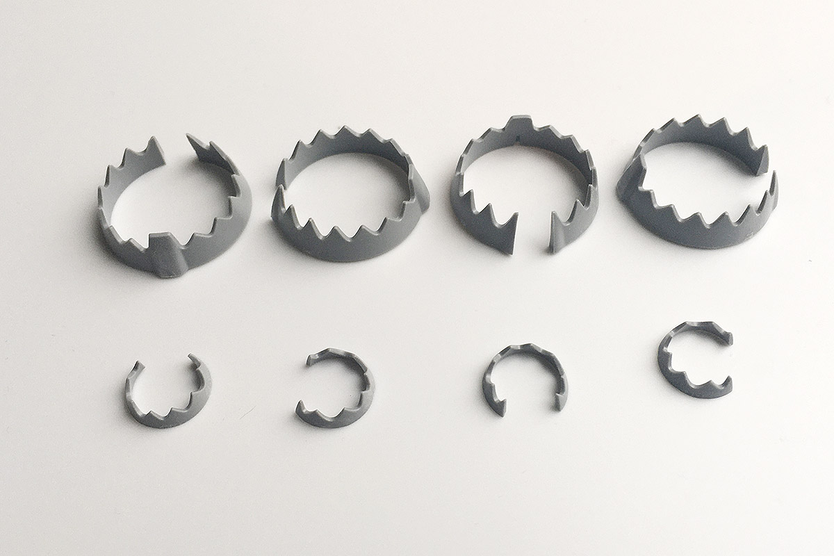

Back in the Saddle Posted November 7, 2021 Author Posted November 7, 2021 On 26/10/2021 at 19:30, Terry1954 said: Looking at the difference between the Revell and Zvezda outboard pylon lengths, it seems although the Zvezda is longer, that one places the engine "pod" further back compared to the leading edge of the wing (I'm guessing form the pic). The Revell pod would appear to sit much further forward therefore. Does that seem right? Hi Terry. Sorry about the delay in replying; it's been hectic week! Going back to the classroom is hard work too... 😁 Here's a photo showing the lower sides of both wings for comparison (Zvezda left and Revell right): A few things to note - 1) Revell has more surface detail and deeper panel lines, Zvezda is very understated in this regard. 2) The pylon locations both start at slightly different distances from the leading edge. The Zvezda pylons are slightly further forward and also longer overall, so consequently they also extend further towards the trailing edge. 3) The flap track fairing location points are very subtle on the Zvezda wing - you can just see the outline of where to put them. 4) Not visible in this picture, but the Zvezda trailing edge looks much better than Revell, with a beautifully thin finish - I believe I mentioned this a few pages back...? In case you were wondering, the section in the top right corner is a piece from the tail fin of G-CIVL. My inner geek saw this was for sale and I couldn't resist it - that will go onto the wall of my man cave at some point! On 31/10/2021 at 08:00, aurelien wolff said: I'll get both but I'm not sure if 1/2 mm difference is that much of a problem I tend to agree - the causal viewer (and even a critical one) will struggle to see that difference! 1

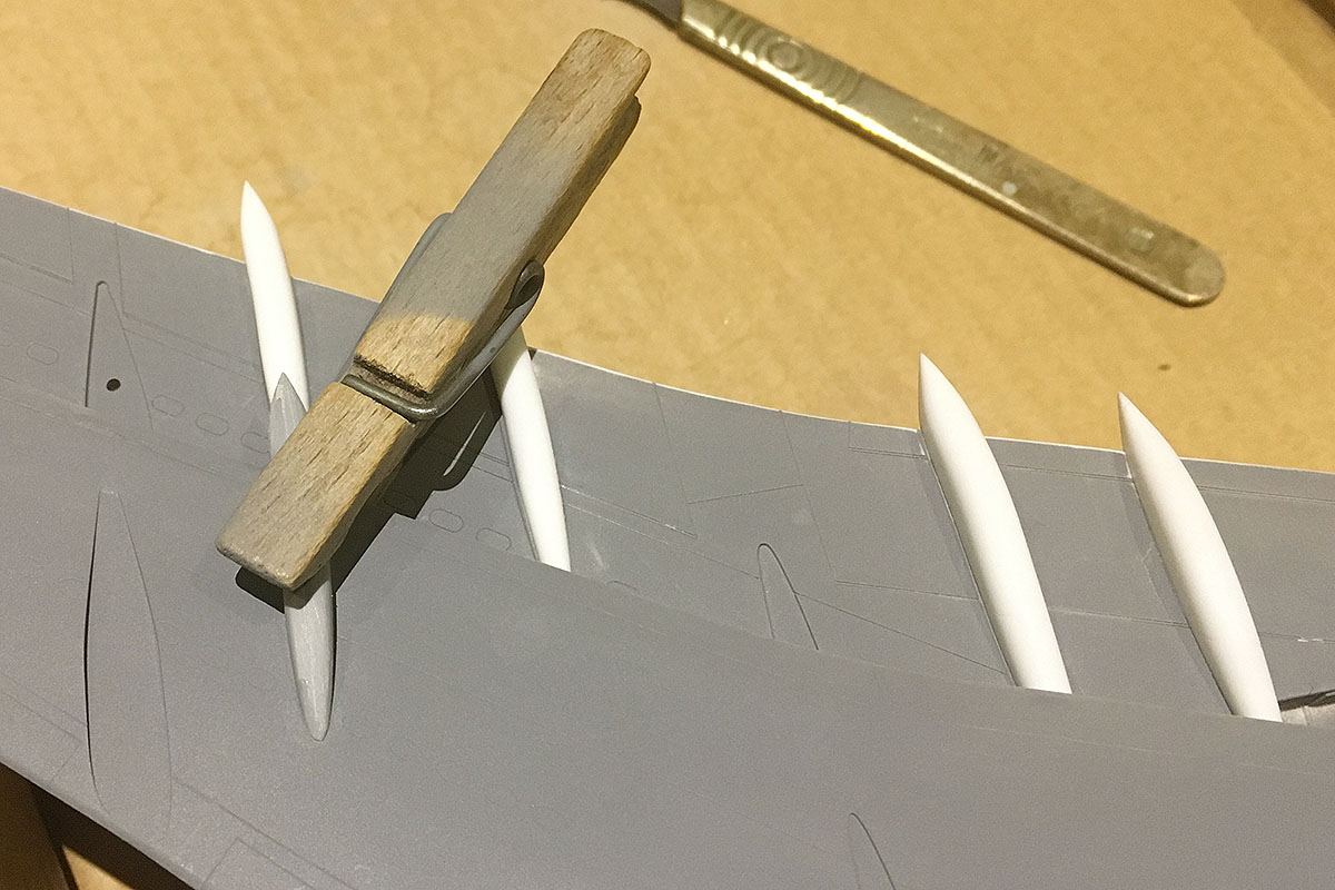

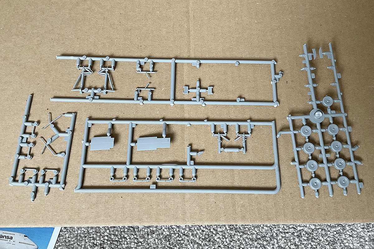

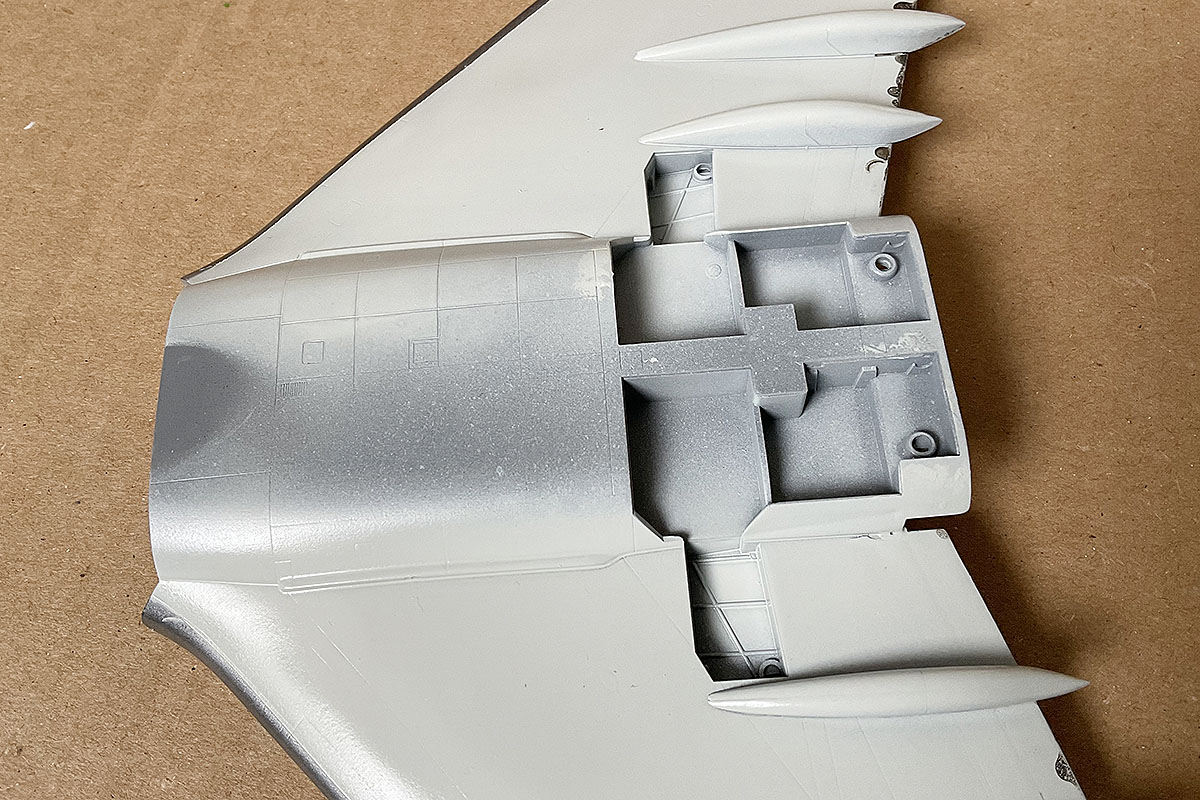

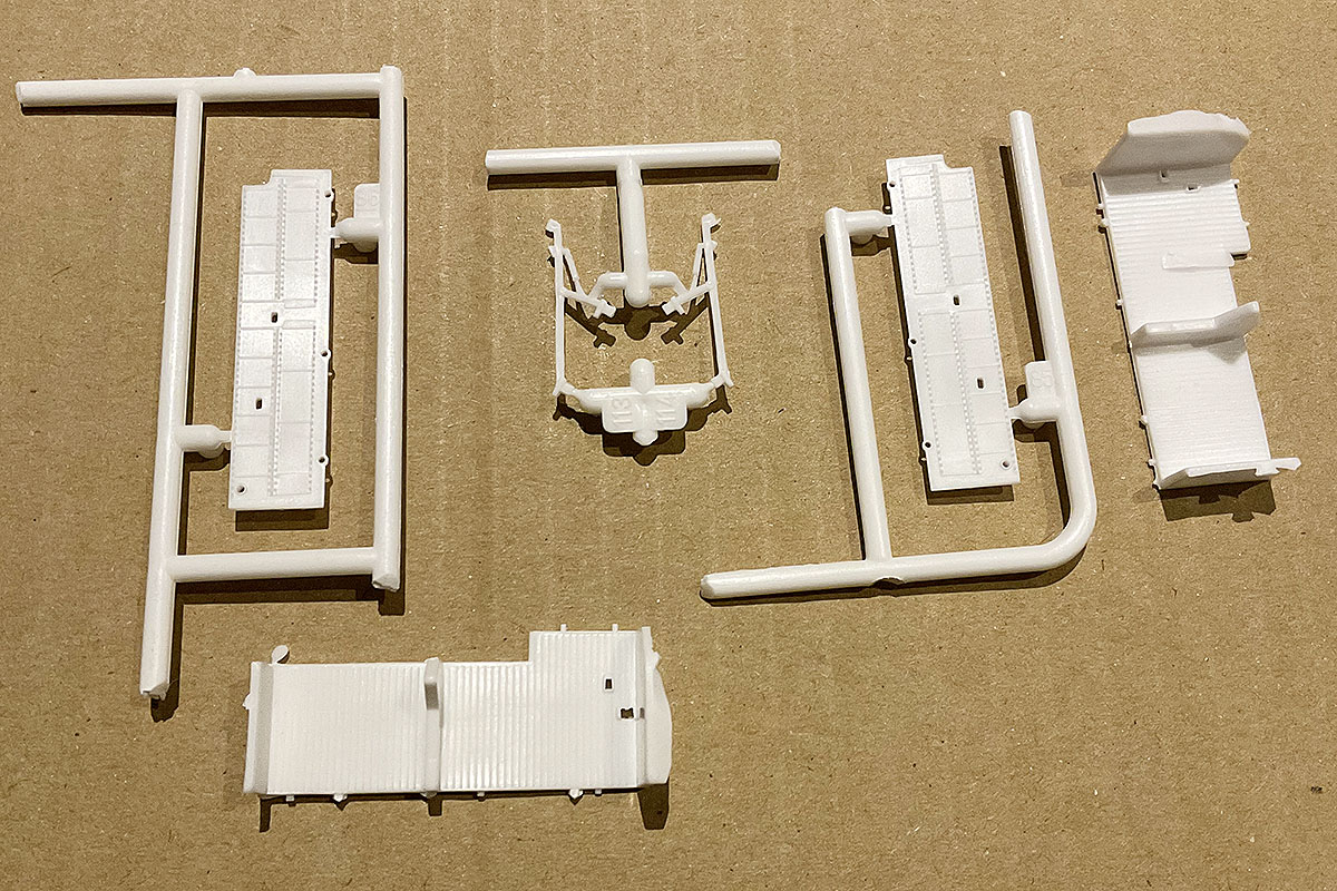

Back in the Saddle Posted November 24, 2021 Author Posted November 24, 2021 On 08/11/2021 at 08:54, ianwau said: Great build detail - and meticulous work on the decals Thank you! You're welcome! Model making has taken a back seat for a few weeks due to work commitments, but I have now made a bit more progress. Here are the components for the flap track fairings: Zvezda are on the left and built up nicely into eight pods: Revell's offering was pretty comparable and the flap track fairings were glued into place: Both sets will need filling and sanding along the seams, but I have attached them to give them more rigidity and stop them flexing. They were also very fiddly to hold! The Revell wing root and wing tips needed some filler, due to minor sink marks. I will use decals for the landing lights (lights are not supplied in the Zvezda kit), so the Revell transparent plastic needed filling around the edges and blending: Work on the engines has also progressed. The inlet rings on the Revell kit do not match with the nacelle anti-icing rings on the real engines, so there is no advantage in leaving them off and attaching them after they have been painted. I have glued them into place so they can be blended smooth and then I will spray the metal finish in the correct area: The Zvezda inlet rings are are more accurate size, so I intend to paint those silver and attach them at the end of the build. Finally for the engines, here are the exhaust scallops from the Zvezda kit (Revell's were very similar): These all glued into place without any problems: Both sets of engines look very similar, but I prefer the Zvezda offering (on the left) for a few reasons. The aforementioned appalling fans on the Revell kit are the biggest issue. However, the general fit of the Zvezda components is also slightly better and the ability to add the inlet ring after painting the engines should result in a very tidy finish. The one advantage with Revell's kit is that the tail cone can be added at a later stage in the build, which makes painting the back of the engines much easier - you'll see from the above picture that these have not been glued on yet. 4
Terry1954 Posted November 24, 2021 Posted November 24, 2021 Looks like you've made some very nice progress there Matt. Those flap track fairing look particularly neat. I assume you will paint all the engines before fixing them to the wings? Terry

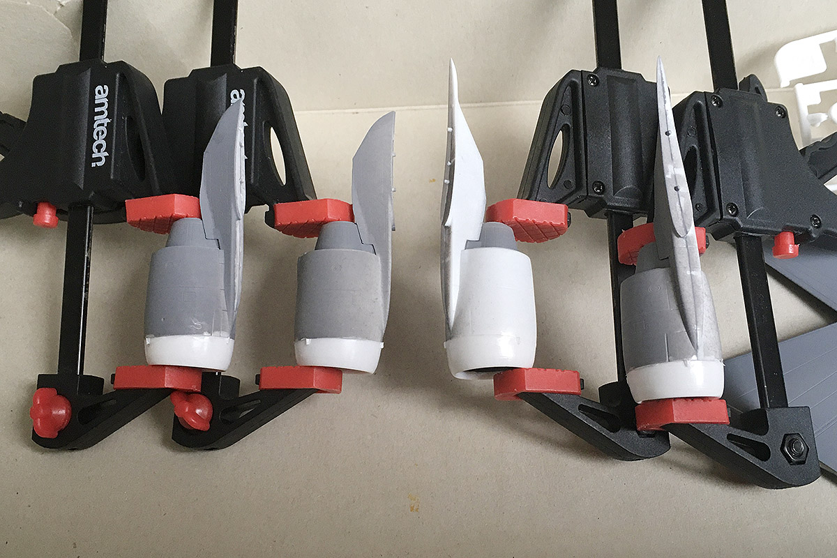

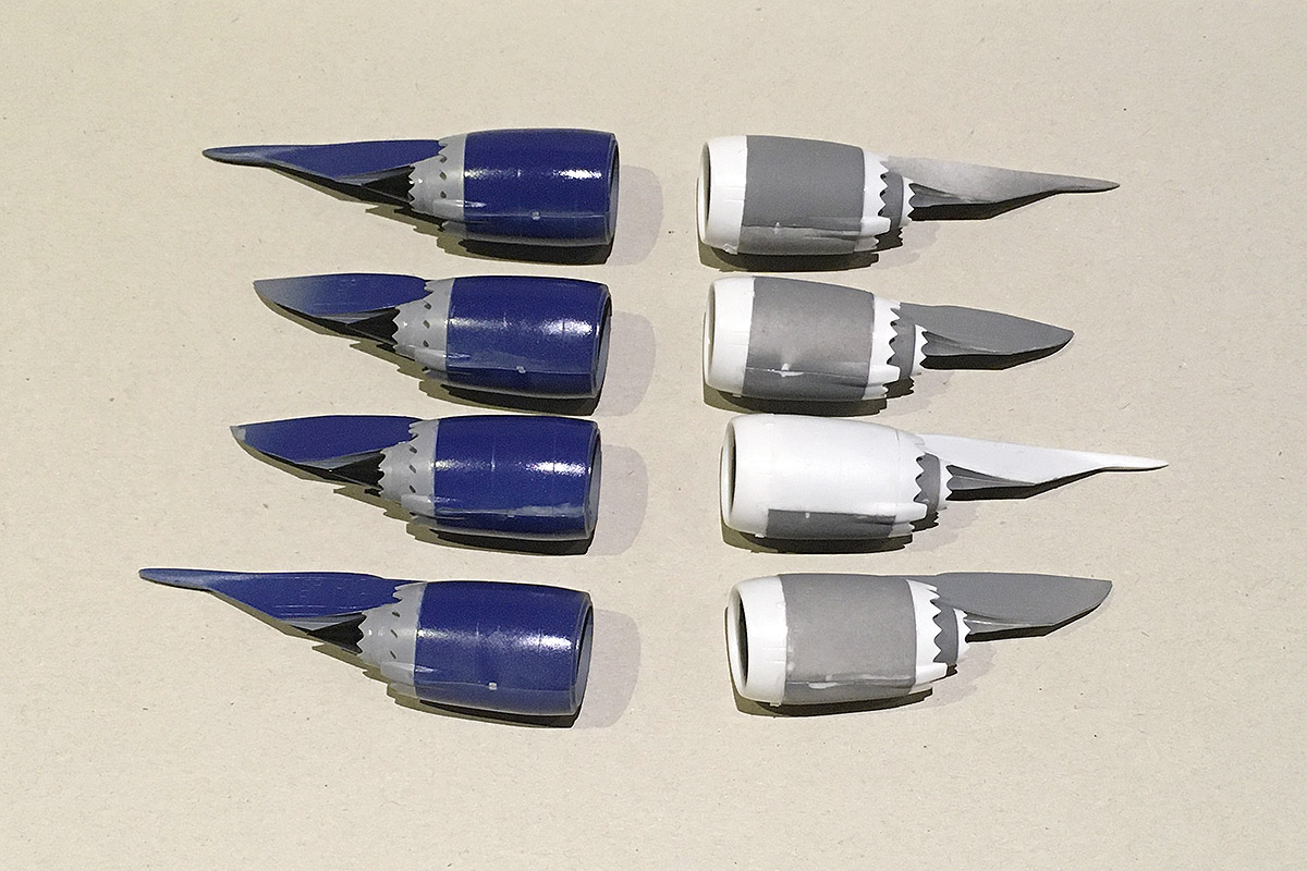

Back in the Saddle Posted November 30, 2021 Author Posted November 30, 2021 On 24/11/2021 at 11:48, Terry1954 said: Looks like you've made some very nice progress there Matt. Those flap track fairing look particularly neat. I assume you will paint all the engines before fixing them to the wings? Thanks Terry. Funnily enough, I did some work on this one last night. I’m still working on the engines and flap track fairings, blending and filling. Hopefully I’ll get them primed later today. The plan is to glue the completed engines onto the model as one of the final stages of the build. @Abandoned Project I guess the warped fuselages were more widespread than I realised! It is a relatively simple fix though and once done, the Revell and Zvezda fuselages look almost identical - the main difference being the antenna bulges on top of the cabin. Your models look to be coming along well! 10 hours ago, Abandoned Project said: The Zvezda 747-8i is definitely more modeller friendly than the over engineered Revell. I completely agree! 🙂 1

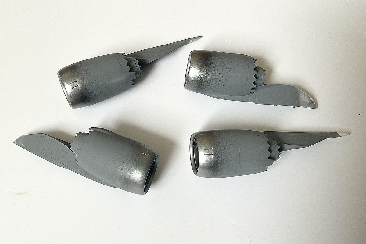

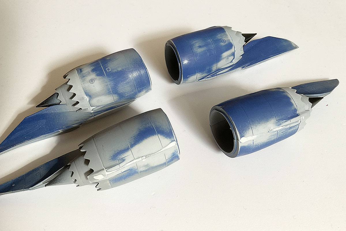

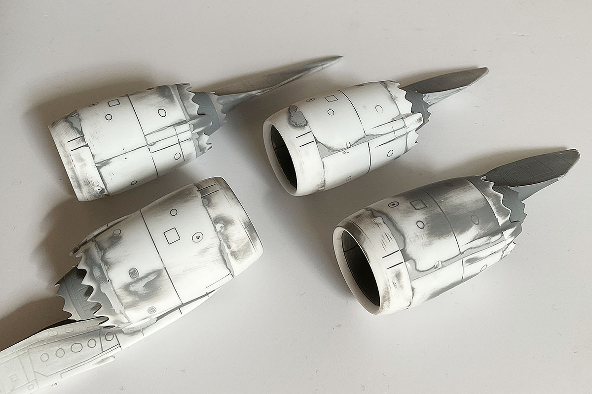

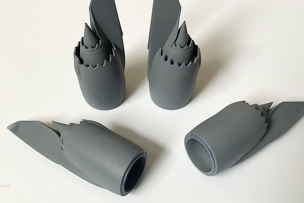

Back in the Saddle Posted May 3, 2022 Author Posted May 3, 2022 Sorry for the lack of updates recently... These models have been progressing, but I'm at the filling/sanding stage so there has not been much to report! The engines are finally ready for painting - here are the Revell ones: As you can see, quite a bit of filler was required! Zvezda engines next as a comparison: Definitely a better fitting set of cowls! Despite the slow progress over the winter months, the painting stage is imminent and I'm hoping this build will speed up and reach completion relatively soon.🙂 5
Terry1954 Posted May 3, 2022 Posted May 3, 2022 Looking good Matt. I think on aircraft like these, getting the engine cowls looking the biz is essential to set the finished model off. Looks like you are nailing that! Terry 1

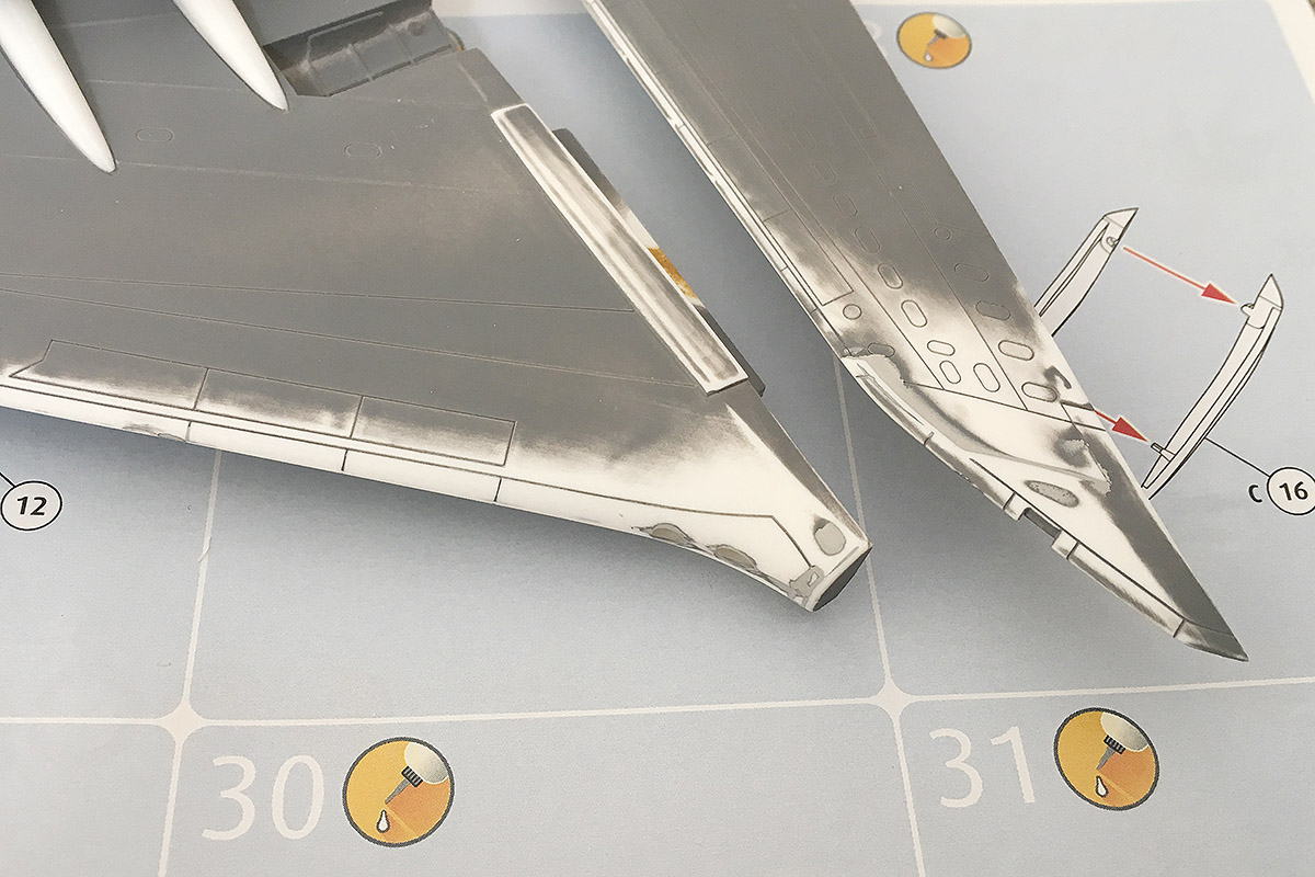

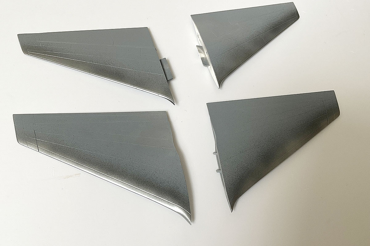

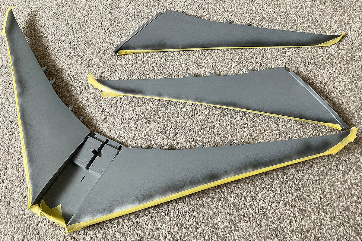

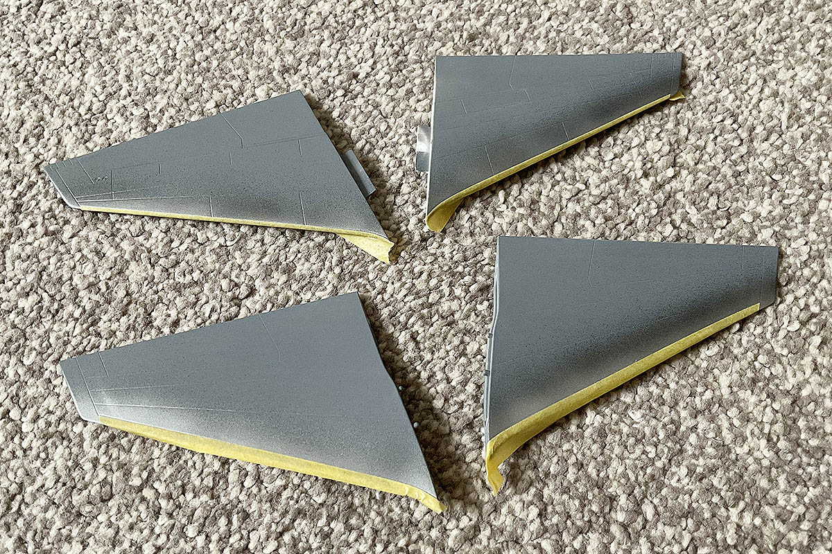

Back in the Saddle Posted July 24, 2022 Author Posted July 24, 2022 Life has been busy lately, hence the delay in progress... I finally managed to mask the leading edge anti-icing panels: With these areas safely protected, I can paint the main surfaces of the wings and tailplanes. I will be using Halford's Racking Grey for this job, as it is a great approximation for Boeing Grey. Having said that, I'm not sure if this colour would even have been an option on the 747-8, as many of these aircraft appear to have white wings...? However, as these models are both in 'what if' liveries, I have a bit more freedom. This option matches the scheme on the BA 747-436's wings, and I think it looks suitable.👍 2

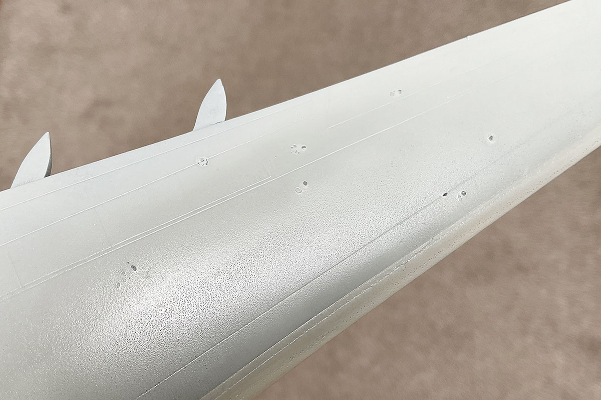

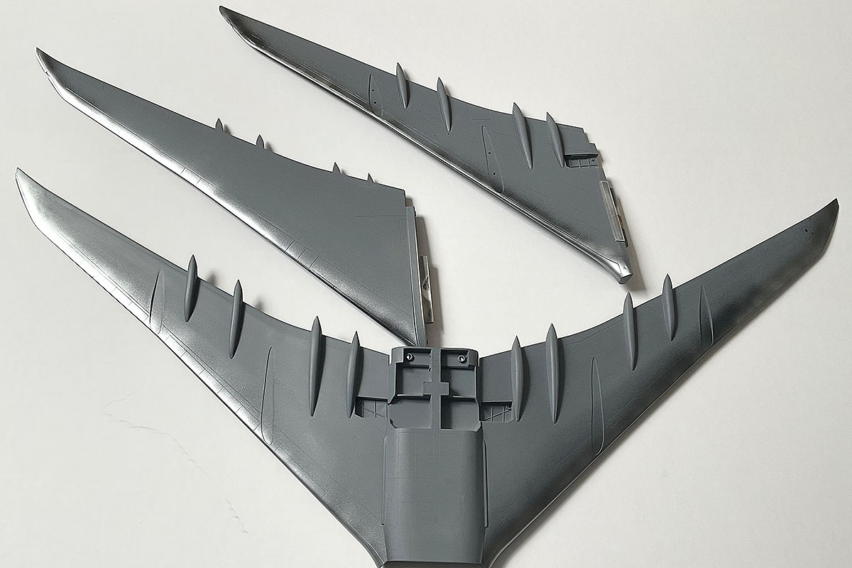

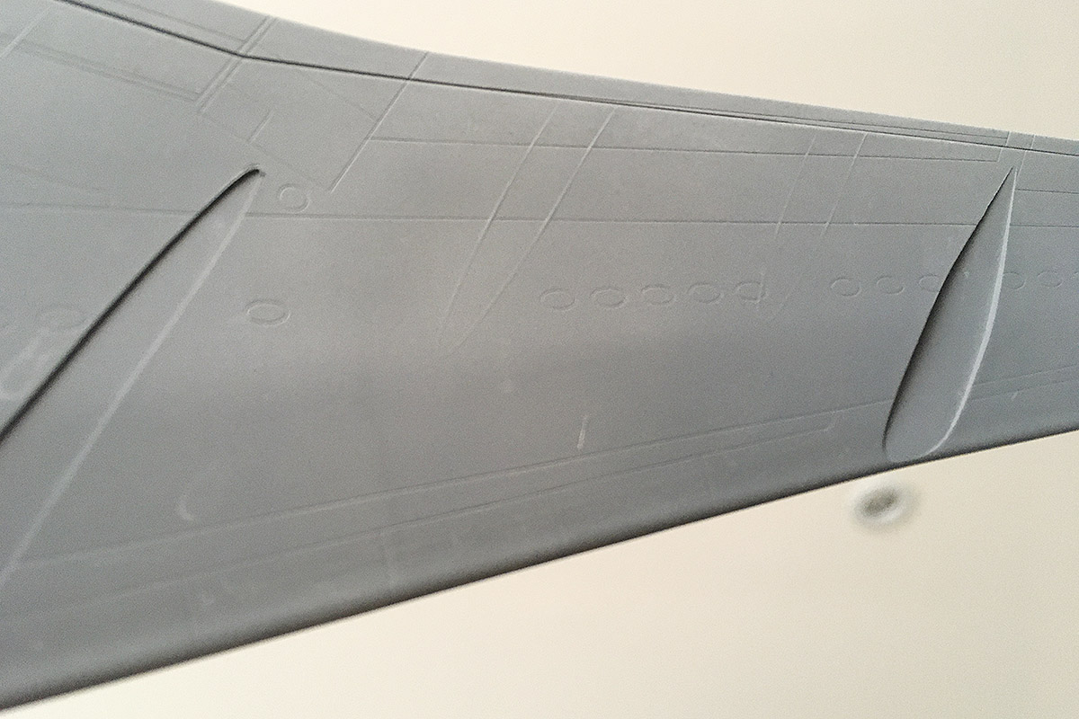

Back in the Saddle Posted August 5, 2022 Author Posted August 5, 2022 I started to spray the wings a few days ago, but had a slight issue with some light drizzle starting at just the wrong time... It was enough to ruin the finish, which consequently needed to be sanded back: The second attempt was much better, although if you look very closely the blemishes can still be seen: I like the finish on the leading edges; it just needs a Flory wash to weather it slightly and pick out the panel lines. 1

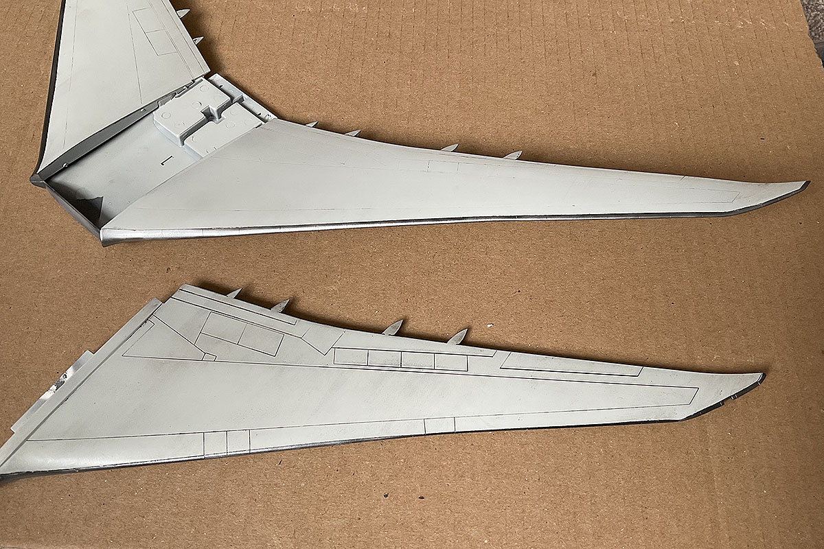

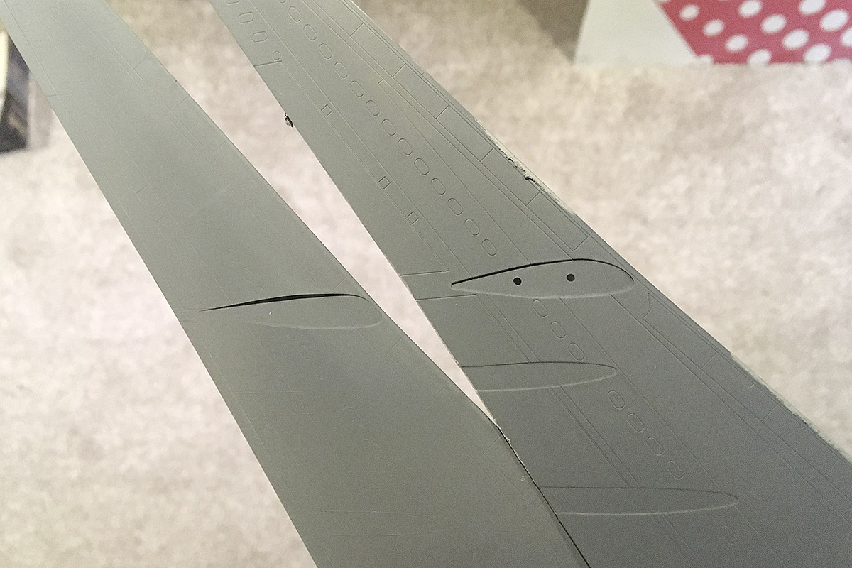

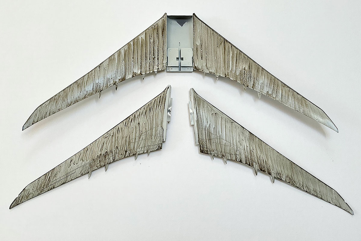

Back in the Saddle Posted August 8, 2022 Author Posted August 8, 2022 The Flory wash has been applied, stealing @The Spadgent's technique of brushing this in line with the airflow, as any grime would naturally flow backwards: A few hours later it (mostly) was wiped off. The Zvezda wing (top) has very shallow panel lines and could probably do with being re-scribed, this resulted in most of the wash being removed. On the other hand, Revell's wings (bottom) have lovely engraved details and the panel lines look much more authentic: I may add more Flory later, but that's an easy amendment if I decide to go down that road. Time to turn my attention to the undercarriage, starting with the wheel bays. Revell has a set of parts to construct the main gear bays: Whereas Zvezda have moulded their bays into the lower wing section: Note the Flory wash on the trailing edge - I must wipe that off! 😆 Much more detail with Revell kit, but obviously some added complexity too. How much of this would actually be seen...? Let's look at the undercarriage parts next, starting with Revell. Here are the wheels, brake units and some struts: And the main bogies: Zvezda somehow seems to have designed the undercarriage more simply (albeit one set of wheels is missing from this photo): A close up of the wheel detail too (Zvezda is the grey plastic): Pretty similar quality and plenty of attachment points to smooth back with either manufacturer...! One major failing with Revell concerns the size of the nose gear wheels, which was flagged up early in this build by @Alex1978 and @Milczacy . Here's a photo showing the issue: These four wheels are all for the nose gear. Revell's (in the middle) are much smaller than they should be. Zvezda's (at the sides) are the correct size and nicely detailed. Fortunately I have some resin replacements, printed for me by @Bangseat (thanks!), these will be used instead. Time for some more cutting, gluing and painting! 5

Terry1954 Posted August 9, 2022 Posted August 9, 2022 Great updates Matt. It can be a bit frustrating using washes when engraved detail isn't consistent. Terry
