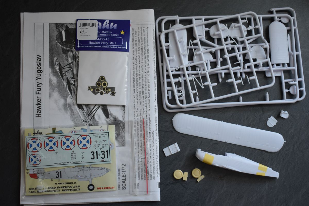

Patrik Posted April 10, 2021 Share Posted April 10, 2021 (edited) With the Fairey IIIF completion going along nicely, time to start another book inspired build. This time it was inspired by the book on the left. The book was published in Serbia, and made it to me in quite an adventurous way. I bought it directly from the author/publisher (thanks a lot for the friendly inscription, Aleks), who warned me openly about the height of the postage costs. Therefore, I arranged another way. I am in aerial survey business. We do quite a lot together with an Austrian company from the same branch. Now, one of their employees, herself Norwegian, lives partly in Belgrade. She took over the book from the author in Belgrade in August last year. In September we were making aerial survey job in Croatia, she acted as liaison agent for our crew and handed over the book to one of our pilots in Rijeka, who then flew it then back to Czechia. At that moment the only real complication arose, as said pilot refused to hand the book over to me (his boss), before he finished reading it. Then he even started negotiating in the sense that he did not want to part with the book at all. However, you know how it goes, even nice bosses, as (I think) I am, can have convincing arguments ready at hand, if they really need to. The book is very interesting, with amazing detail on Fury, Hind and Hurricane in pre-war Yugoslav service, and also on their gallant participation in the defense of the kingdom against the German invasion in April 1941. Highly recommended. Finally to the kit – nicely moulded in satisfactorily hard white plastic, with fine details and engraved panel lines. The dimensions seem to be spot on, the interior details more than adequate and the differences from the standard RAF Fury seem to be very well researched and represented. Therefore, I intend building the kit OOB, with just a few extras in the form of Yahu instrument panel, aftermarket seat harness and guns, and resin wheels from my spare parts box (coming most probably from Pavla Gladiator as far as I remember). It seems I am unable to escape the Kora connection though, so decals by Kora. The Kosovo crosses from the kit have been unusable. One dilemma. The Hawker book shows the letters B (for Belgrade airport) and the numbers 6 (for 6 LP) on the lower wing surfaces of "black 33", whereas Kora decals show nothing like this for "black 31". The profile in the book is correct. The book contains photos of "black 33" after a crash, with the lower planes clearly visible. There are other photos of airplanes of 6 LP in the book, with the B under the upper wings clearly visible too, so I suppose B was standard. Unfortunately, the undersides of the lower wings are always in rather deep shadows, so I have not been able to find confirmation so far that the number 6 was standard marking too. Any opinion among the more educated forum members? Otherwise, I must hope the second volume of the Mushroom Yugoslav Fighter Colours will be published soon enough, and it will contain sufficient additional information to dispel my doubts. The last photo shows the fuselage halves after I removed them from the sprue. Both of them bent outwards, but it was nothing that a nice short bath in hot water would not improve. Edited April 11, 2021 by Patrik 9 Link to comment Share on other sites More sharing options...
2996 Victor Posted April 10, 2021 Share Posted April 10, 2021 Hi Patrik, Looks like a great start on what should be a really interesting build! I'll be following along, if I may. Cheers, Mark Link to comment Share on other sites More sharing options...

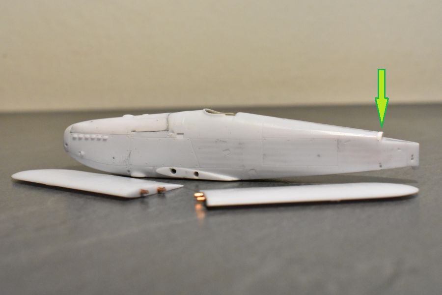

Patrik Posted April 18, 2021 Author Share Posted April 18, 2021 (edited) Started cleaning up the parts. The fit of the fuselage halves is very satisfactory, nevertheless, the principal challenge in this kit is rather obvious right from the start. I am afraid, it cannot be solved until the fuselage halves are glued together, as it requires both reducing the width of the engine cowling and widening the fuselage at the joint line. Edited April 18, 2021 by Patrik 4 Link to comment Share on other sites More sharing options...
Mr T Posted April 18, 2021 Share Posted April 18, 2021 Hi Patrik, I built the kit for the Interceptor GB and I found it relatively straight forward apart from the issue with the upper fuselage you have highlighted. Some care is needed with the struts as they are very thin and drilling out the location holes is a good idea to make them a little more secure. Will watch this with interest. 1 Link to comment Share on other sites More sharing options...

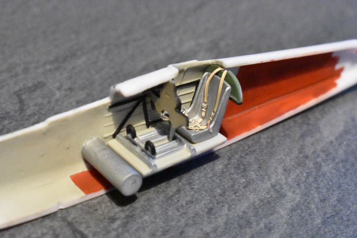

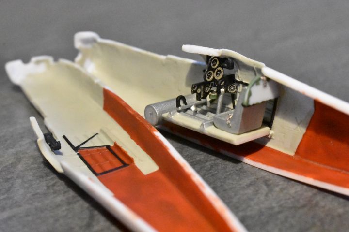

Patrik Posted May 7, 2021 Author Share Posted May 7, 2021 (edited) First, I thought I would beat @airscale in cockpit detail, but then I thought again, considered the differences in scales and skills, took into account the cockpit occupies whole 1.5 centimetre square, and the results is below. I used Yahu instrument panel, steel seat belts by Eduard, removed the lower part of the rear bulkhead and added the oil tank. The fuel tank will be supplemented later, as part of the solution for widening the top of the front fuselage. Edited May 7, 2021 by Patrik 10 Link to comment Share on other sites More sharing options...
warhawk Posted May 7, 2021 Share Posted May 7, 2021 Excellent job so far! I had the same gap at the front when I did my A-model. Please note that the ventral fuselage fabric detail is missing, and the prop/spinner could use some cleaning up. Mine was one of the poorer copies, so I ended removing the blades altogether and turning the spinner on a lathe before re-attaching the blades: https://www.maketarskikutak.com/index.php/topic,9511.msg91911.html#msg91911 1 1 Link to comment Share on other sites More sharing options...

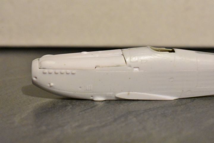

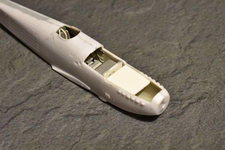

Patrik Posted May 14, 2021 Author Share Posted May 14, 2021 Fuselage widened with plastic insert, bulkhead with fuel tank added. Which, together with careful modification of the engine top cover, ensured acceptable fit of the latter (not glued yet on the photo below). 5 Link to comment Share on other sites More sharing options...

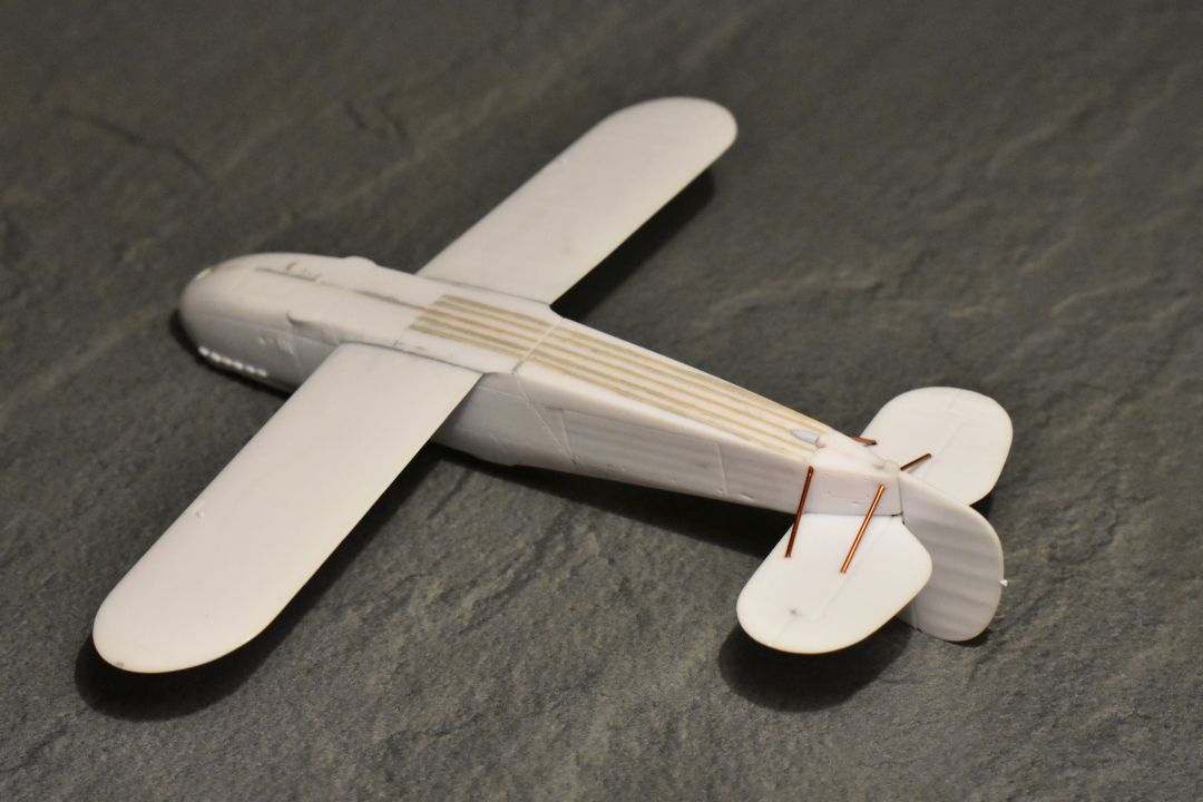

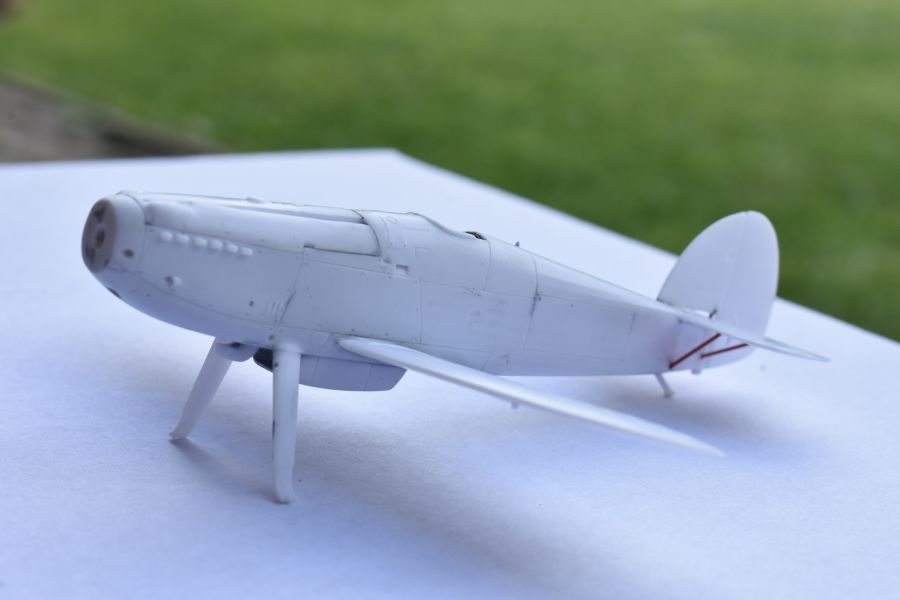

Patrik Posted May 30, 2021 Author Share Posted May 30, 2021 (edited) Attached lower wings and completed the empennage except tail skid, which will come later, as it is the part most easily harmed by my frequent chaotic hand motions. As suggested by @warhawk I added some detail to the flat ventral part of the fuselage, using my own method of scribing straight grooves, filling them with stretched sprue and than schmirgling them down. I am sure it will look fine under few coats of silver. Now I am going to take short break, because the replacement decals for my stalled Fairey IIIF build arrived, so Fairey takes precedence now. Edited May 30, 2021 by Patrik 5 Link to comment Share on other sites More sharing options...
2996 Victor Posted May 30, 2021 Share Posted May 30, 2021 1 hour ago, Patrik said: schmirgling Is this technique patented? If not, I think you should consider it - it sounds rather effective! Perhaps try a coat of Mr Surfacer and a second schmirgle before the silver dope? Cheers, Mark 1 1 Link to comment Share on other sites More sharing options...

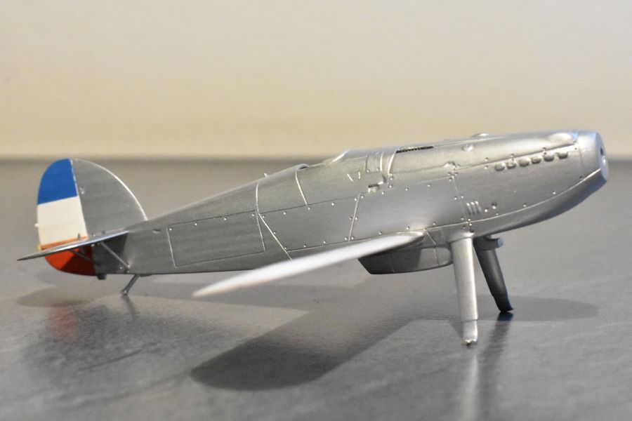

Patrik Posted June 13, 2021 Author Share Posted June 13, 2021 Even as wheelless and propellerless monoplane, the Fury is an elegant machine. Painting started this evening. 4 Link to comment Share on other sites More sharing options...

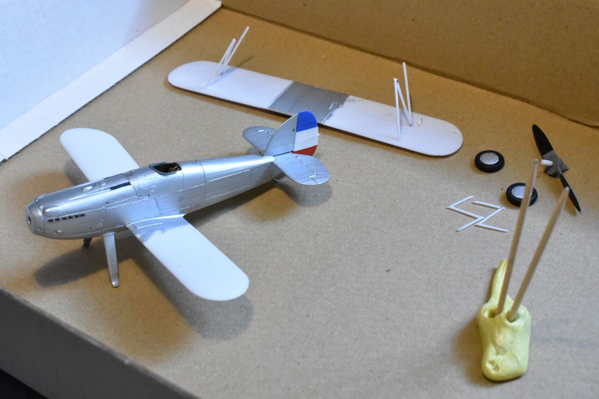

Patrik Posted June 27, 2021 Author Share Posted June 27, 2021 Painting in a kind of intermediate state. Basic colours on, details still to be painted. Nice weather, released covid restrictions and EURO 2021 are not exactly progress-supporting factors most recently. 5 Link to comment Share on other sites More sharing options...
