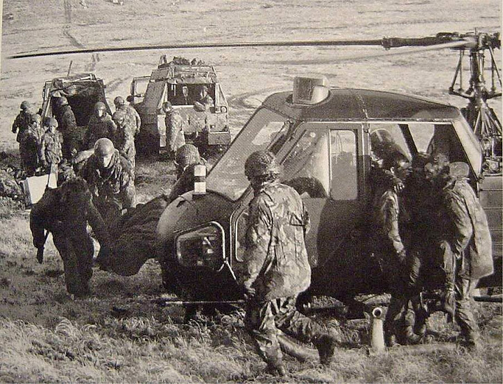

Carlos Guate Posted April 5, 2021 Share Posted April 5, 2021 (edited) A proyect taken again this holy week time, after more than 10 year stored in a shelf corner. The oldie Airfix AH1 1/72 planned to be a Falklands war subjet. Also the Airwaves weapons set was selected, but due the metalic material adds a lot of weigth to the thin plastic skies something must be do. details and questions as follow: 1. cut the access doors has shows some real photos ( is posible the 4 doors were descarted during the war ?) 2. make the undercarriage skies with thin steel rod, available in some handcrafts stores. the partes were fixed with 2 part epoxy. 3. polish the clear part, built scratch seats, instrument panels and the underside tubing/anttenas 4. detail the rotor hub with plastic from spare parts box. a step later will be detail the turbine and other parts like the AS.11 missiles launchers in the last photos a dry test , proving the new undercarriage will support the ancient airwaves parts. finallly a question regarding the falkland colours used, after check in the forum some topics related I can't find a clear answer, please if someboy has the answers: 1. the Scout colour squeme suggest dark green and black, but what is the humbrol paint suggested ( in colour photos looks like a olive drab tone) not the humbrol #30 tone. 2. the lettering as ARMY, ROYAL MARINES and codes were overpainted with black ? thanks a lot and comments are welcomed: (and praying that Airfix release a new Westland and Wasp model kits) Edited April 5, 2021 by Carlos Guate spelling errors corrected 21 Link to comment Share on other sites More sharing options...

perdu Posted April 5, 2021 Share Posted April 5, 2021 Looks good I like it Can I just say here NEVER use Humbrol 30 as a dark green for any UK aircraft, ever. If you are using Humbrol paints you should use Humbrol 163 RAF Dark Green, in Tamiya use XF-81 Dark Green 2 (RAF). Humbrol 30 has been quoted for years but is a too bright green, nice if you want a basic green but just not for UK aircraft from any period I can recall. Wasps often flew without doors because they needed less weight so they could take loads further, Scouts less so. I have this photograph of a Scout transferring casualties in the Falklands which show the rear doors removed. It may be useful to you. 3 1 Link to comment Share on other sites More sharing options...

HAAFPhot Posted January 28 Share Posted January 28 12 hours ago, Carlos Guate said: never is too late for information. thanks a lot for it hoping some day a new Scout kit will light us cheers. Carlos I have spent time in the Falklands (84/84) and with Scouts so nothing would please me more. Many don’t realise that around 10 or 12 were built as pure utility, having no SS11 infrastructure fitted. The obvious sign is height adjustment on the crewmans seat extending back into the pax compartment but otherwise it’s pretty subtle. Many don’t realise that the Nimbus is largely of French design and manufactured under licence from Turbomecca. Folks at shows just wouldn’t have it until you chase them up the side to look at the makers plate Link to comment Share on other sites More sharing options...

perdu Posted February 1 Share Posted February 1 42 minutes ago, HAAFPhot said: All doors were often removed, particularly over water or in hot climes or with embarked eagle flights, jumpers etc. There were 3 basic types of door (not withstanding local mods for early heli telly). Flat. Stretcher 1 (looked like a 45 gallon drum on the bottom of the door, allowed stretcher handles/stretcher to protrude doors closed, Stretcher 2, upper Perspex blown to match bulged door. Also allowed more room for pax on bench seat with webbing etc on. Bench seat has effectively 4 modes. Seat (front slightly raised so it removes your nuts on the frame/corner as you leave), Stretcher (basically drops parallel to the cargo deck), stowed (up against rear bulkhead) removed. There was a GPMG Mount both Pintle and skid mounted. During the Falklands most cabs didn’t use the stretcher pods. The effect on the casualty was awful and it made the rear quite awkward to access so they basically stuffed folk in the back on stretchers or walking wounded. There is usually a small green pouch attached to the rear cabin first aid kit that carried a clip attached to a pip pin via a short cord. The pouch is usually empty but the clip came in to attach giving sets to the cabin roof for casevac. Fantastic little aircraft, nearly all British and the thinking man’s Spitfire IMHO but then I am biassed Me too I often have a Scout or Wasp in planning or recently completed, loves 'em I do. 5 Link to comment Share on other sites More sharing options...
