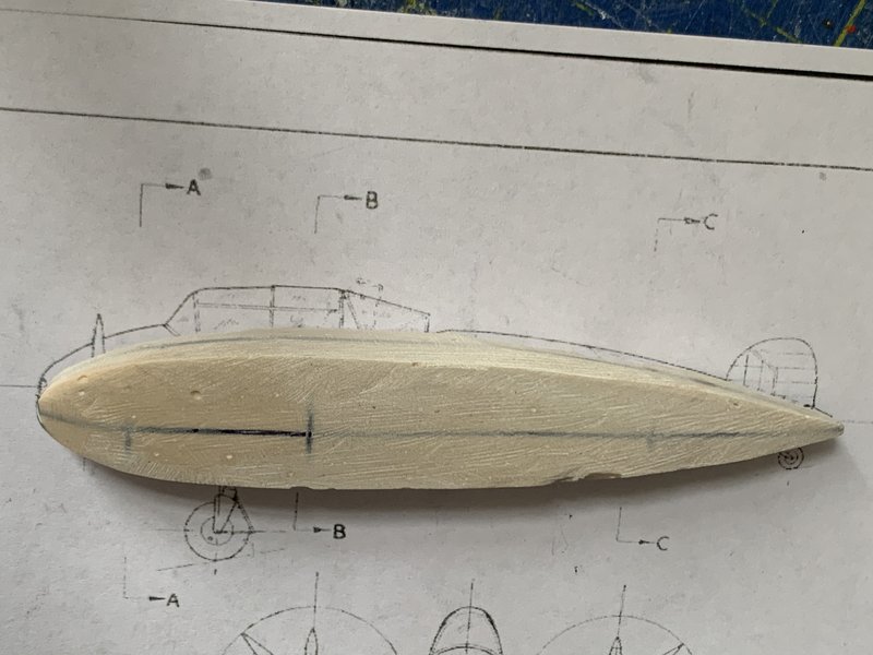

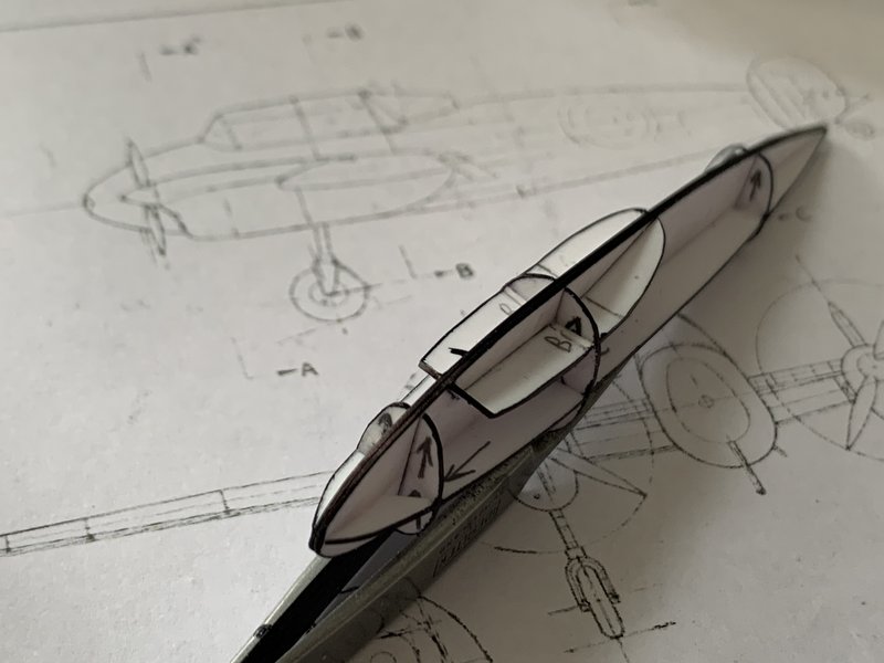

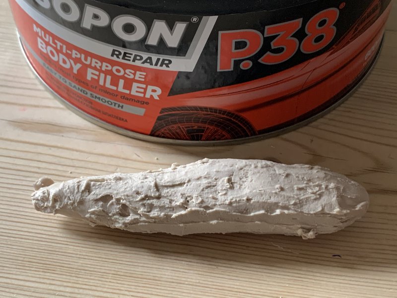

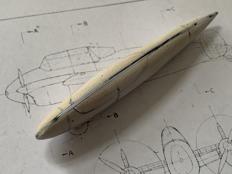

AdrianMF Posted March 28, 2021 Author Share Posted March 28, 2021 I wanted a former to show the plan fuselage outline and something to mark out where the cockpit should be: I’ve now stuck everything together, given it all a light sand to level things off and outlined the edges with a Sharpie: Time for a cuppa while that all sets up before I slap on the filler (outside because it smells and it’s not raining). The Sharpie marking is there for two reasons: the black outline starts to show through the filler when you are getting close to an edge when sanding it down; and when it goes white, it’s time to stop sanding! The Aeromodeller plans that I’m using don’t quite agree between the profile and the plan but it hasn’t been too bad. This is pretty much the norm for plans from that era. 17 Link to comment Share on other sites More sharing options...

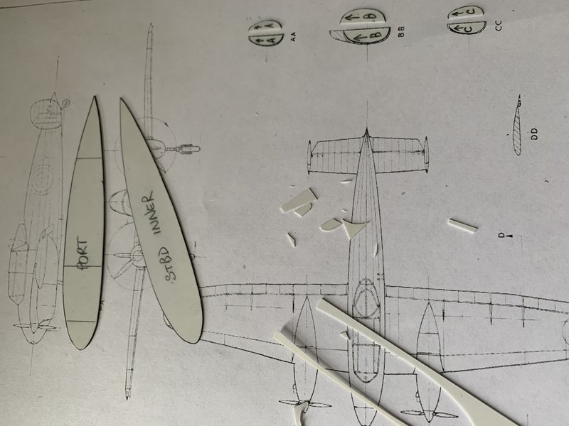

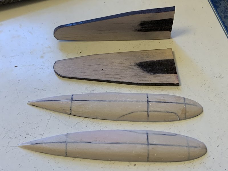

AdrianMF Posted March 28, 2021 Author Share Posted March 28, 2021 So I split the fuselage in half and made some wings: The pinker patch on the fuselage is where I filled a slightly sunken area. The fuselage is pretty much dead on and a teeny bit small all around, so I can do some plunge moulding next, with 20 thou card: The wings were cut out carefully, edges marked with a sharpie, strengthened with superglue and sanded down to crisp and sharp leading and trailing edges. The wing blanks were then tapered down with a sharpie patch at the wing root to act as a “tell” to stop me sanding too far. Fabulous. Unfortunately, the maker of this kit failed to trace over the distinct kink near the wingtip, so my decision to use balsa for these is paying off already: New wings tomorrow. I thought they were looking a bit narrow. At least I’ve practised the method now. 11 Link to comment Share on other sites More sharing options...
AdrianMF Posted March 28, 2021 Author Share Posted March 28, 2021 Waste not, want not. I tried out my wing preparation for painting, and it seems to work, here with a coat of Revell Acrylic Grey: I’m using superglue with baby powder, so it’s a nod back to dope’n’talc. I asked Mrs MF to get me some, and only just now did I realise why she was asking me if I was sore! Note the perfect fit to the shape as traced. Time to go clean superglue and baby powder off now. My phone is refusing to work with my index finger. At least I haven’t glued it to the screen... 6 4 Link to comment Share on other sites More sharing options...
