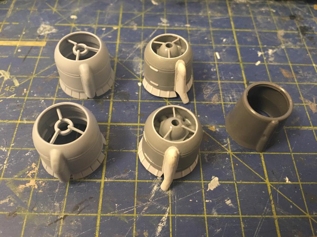

Rabbit Leader Posted March 22, 2021 Author Share Posted March 22, 2021 Engine Construction and ‘Warning’ - Steps 46 to 58 Best to get this off my chest first.. I had to have two goes at these engines assembles as yours truly had a real ‘D-H’ moment (and I don’t mean De Havilland)!! During my first attempt I cut all the engine parts off the sprue, painted these up and left them to dry. I used up all the parts including these inner propeller spindles C15, which I’ve never used before on any other Airfix kit. Most parts look pretty identical, however there are slight differences and not knowing what part number was what, I happily glued these together... that was a big mistake! Rabbit Leader tip - follow the instructions very carefully and look out for ALL locating tabs! .... Because if you don’t the end result will be an engine power egg bursting at the seams and not lining up with the keyed nacelle locator holes. The photo below shows my first engine attempts on the right. The three ‘prongs’ that connect the internal collector ring (Parts C5 & C6) should fit within three small slots cut into the top row of engine cylinders (Parts C1 & C2). As I had already painted these a Metallic Smoke colour I must have missed these in the dark shadows and the ‘prongs’ were cemented in the wrong position. I’m afraid it doesn’t end there! The rear row of engine cylinders (Parts C3 & C4) have a small locating tab that (in hindsight) is the key tool to getting all this lined up. Whilst cutting away these engine parts on my second attempt, I noticed that the sprue attach point is attached to this small tab. Thinking back, I must have assumed this tab was part of the sprue runner, so sanded this off during clean-up. Best to look at all parts very carefully and ensure all small tabs are left in place. When you all eventually get your Beaufort kits, I recommend you follow these “10 survival steps for success”. 1. Paint all the engine parts on the sprue so that you can still easily identify all part numbers 2. Cut off just the parts required to assemble ‘ONE’ engine and leave the other parts still attached. 3. Dry fit all the parts for one engine and tape it together. 4. Do not glue anything until you have an assembled power egg that fits into the corresponding engine nacelle. 5. Once you are happy that it all fits.... check it again! 6. Glue these parts together and set to dry. 7. Cut off the parts for the second engine 8. Dry fit again and tape it all up - just like engine #1. 9. Do a fit check on the other engine nacelle. 10. Glue it all together and take a break. One other thing.. those propeller spindle parts look pretty useless to me so I left them off on my second set of engines. I’ll find a suitable width shaft to secure the props in place, just like those old school kits. After all that, I’ll need to source some new engines for my second kit, however there’s are few chaps around who are designing P & W powerplant conversions, so that might just be the way I go on that kit. Fingers crossed this is my only ‘Recovery Session’ that I always tend to have on every kit build. Cheers, be careful and regards.. Dave 14 8 Link to comment Share on other sites More sharing options...
AdrianMF Posted March 22, 2021 Share Posted March 22, 2021 Ah, finally! Something I had less trouble with on the Frankenbuild. The engines and cowlings I used from the FROG Beaufighter (middle) were all a single piece. No seams or fit issues there: I don't think Airfix have quite got their radial engine fit engineering sorted yet. I've had trouble with every one I've built, except for the Beaufighter engines (fitted to the FROG kit), where I sanded off everything that looked like a locating lug. In particular, As a modeller who likes to see propellers go round, I really detest their "stick the propeller firmly onto the tiny pin that projects from the front of the crankcase" approach too. Once again, thanks for an open, honest and extremely helpful build. You will have prevented a lot of sticky moments around the planet! Regards, Adrian Regards, Adrian 5 2 Link to comment Share on other sites More sharing options...
Rabbit Leader Posted March 22, 2021 Author Share Posted March 22, 2021 Glad I’m not the only one who doesn’t like these Airfix prop shafts @AdrianMF, IMO there is no way what’s provided will do the job intended. Anyway, I shouldn’t criticise too much, we do ‘finally’ have a new Beaufort to savour don’t we? Cheers.. Dave 1 1 Link to comment Share on other sites More sharing options...
jackroadkill Posted March 22, 2021 Share Posted March 22, 2021 Hi Dave, I noted most of the issues highlighted in your previous post. I say most because I also cut the tab off the locating rings, but hey, not the end of the world. I saw that it would be relatively easy to get the rear bank of cylinders back to front, thus confusing things further. Still, I think I'm about ready for the assembly of the engines. I'm also going to scrap the spindles, as they seem to be the worst component on the kit by some margin. I think I have some steel rod somewhere which will do a much better job. 1 Link to comment Share on other sites More sharing options...
Beard Posted March 22, 2021 Share Posted March 22, 2021 That's good advice on the engines/ nacelles Dave. I did almost exactly the same as you oon mine. Apologies for not warning you. 1 Link to comment Share on other sites More sharing options...
Rabbit Leader Posted March 22, 2021 Author Share Posted March 22, 2021 3 minutes ago, Beard said: That's good advice on the engines/ nacelles Dave. I did almost exactly the same as you oon mine. Apologies for not warning you. That’s fine Beard.. I really should have been more careful myself. I can also confirm your suspicions about the incorrectly numbered torpedo bomb doors on the instruction sheet. Now I think I’ve also found a way to insert the rear turret ‘after’ you cement and blend in the turret / fuselage fairing. It’s a bit fiddly, however I can’t see myself doing it the way Airfix suggest. Cheers.. Dave 1 Link to comment Share on other sites More sharing options...
tonyot Posted March 22, 2021 Share Posted March 22, 2021 (edited) 4 hours ago, Rabbit Leader said: Engine Construction and ‘Warning’ - Steps 46 to 58 Best to get this off my chest first.. I had to have two goes at these engines assembles as yours truly had a real ‘D-H’ moment (and I don’t mean De Havilland)!! During my first attempt I cut all the engine parts off the sprue, painted these up and left them to dry. I used up all the parts including these inner propeller spindles C15, which I’ve never used before on any other Airfix kit. Most parts look pretty identical, however there are slight differences and not knowing what part number was what, I happily glued these together... that was a big mistake! Rabbit Leader tip - follow the instructions very carefully and look out for ALL locating tabs! .... Because if you don’t the end result will be an engine power egg bursting at the seams and not lining up with the keyed nacelle locator holes. The photo below shows my first engine attempts on the right. The three ‘prongs’ that connect the internal collector ring (Parts C5 & C6) should fit within three small slots cut into the top row of engine cylinders (Parts C1 & C2). As I had already painted these a Metallic Smoke colour I must have missed these in the dark shadows and the ‘prongs’ were cemented in the wrong position. I’m afraid it doesn’t end there! The rear row of engine cylinders (Parts C3 & C4) have a small locating tab that (in hindsight) is the key tool to getting all this lined up. Whilst cutting away these engine parts on my second attempt, I noticed that the sprue attach point is attached to this small tab. Thinking back, I must have assumed this tab was part of the sprue runner, so sanded this off during clean-up. Best to look at all parts verify carefully and ensure all small tabs are left in place. When you all eventually get your Beaufort kits, I recommend you follow these “10 survival steps for success”. 1. Paint all the engine parts on the sprue so that you can still easily identify all part numbers 2. Cut off just the parts required to assemble ‘ONE’ engine and leave the other parts still attached. 3. Dry fit all the parts for one engine and tape it together. 4. Do not glue anything until you have an assembled power egg that fits into the corresponding engine nacelle. 5. Once you are happy that it all fits.... check it again! 6. Glue these parts together and set to dry. 7. Cut off the parts for the second engine 8. Dry fit again and tape it all up - just like engine #1. 9. Do a fit check on the other engine nacelle. 10. Glue it all together and take a break. One other thing.. those propeller spindle parts look pretty useless to me so I left them off on my second set of engines. I’ll find a suitable width shaft to secure the props in place, just like those old school kits. After all that, I’ll need to source some new engines for my second kit, however there’s are few chaps around who are designing P & W powerplant conversions, so that might just be the way I go on that kit. Fingers crossed this is my only ‘Recovery Session’ that I always tend to have on every kit build. Cheers, be careful and regards.. Dave I did try to warn you about the engine Dave in my last build post! "building the engines and cowlings for the first one,..... they fit together beautifully but I found it easier to dry fit each engine to the model, then build the cowling around it in order to get everything to line up better,.... as the fit at the rear of the engine is handed and it will only fit in a certain way. " Edited March 22, 2021 by tonyot 3 Link to comment Share on other sites More sharing options...

jackroadkill Posted March 22, 2021 Share Posted March 22, 2021 Hope you don't mind me chiming in again, Dave. I've just built up my engines and was thrown by the asymmetrical nature of the construction. If builders don't / didn't know already it appears that the bracing spars(?) aren't symmetrical port-to-starboard and that the cowlings and exhausts are actually different, leading to the starboard engine's outer bracing being at 9 o'clock and the port's at four o'clock. The port exhaust is also higher than the starboard one. I built mine correctly the first time, then dismantled them, re-built them, dismantled them again, panicked, looked on the internet for references, failed to spot any, and then finally checked your head-on pic above..... Turns out I'd got in right in the first place. 3 Link to comment Share on other sites More sharing options...
bigbadbadge Posted March 22, 2021 Share Posted March 22, 2021 20 minutes ago, jackroadkill said: Hope you don't mind me chiming in again, Dave. I've just built up my engines and was thrown by the asymmetrical nature of the construction. If builders don't / didn't know already it appears that the bracing spars(?) aren't symmetrical port-to-starboard and that the cowlings and exhausts are actually different, leading to the starboard engine's outer bracing being at 9 o'clock and the port's at four o'clock. The port exhaust is also higher than the starboard one. I built mine correctly the first time, then dismantled them, re-built them, dismantled them again, panicked, looked on the internet for references, failed to spot any, and then finally checked your head-on pic above..... Turns out I'd got in right in the first place. Does this mean the Shop Steward gets to keep his job then ??? 4 Link to comment Share on other sites More sharing options...

AdrianMF Posted March 22, 2021 Share Posted March 22, 2021 The exhaust thing nearly caught me out too. Port 3 o’clock and Stbd 8 o’clock. For the bracing rods I switched my brain off and just copied pictures! The Warpaint plans look OK at first glance but on more detailed inspection they are not reliable. The plans posted in this thread were the best that I’ve seen. From what I’ve seen on the web, the High Planes kits were very accurate, albeit hard to build and expensive. I did see an Australian one in the flesh in Comet Miniatures in Lavender Hill around 1998-2002, but balked at the 20-odd quid asking price back then (and it wasn’t a Mk I). Regards, Adrian 2 Link to comment Share on other sites More sharing options...
dogsbody Posted March 22, 2021 Share Posted March 22, 2021 Those collector ring struts are correct. The Beaufighter's are the same, with unequal spacing. I wish Airfix was paying more attention to this when they did the Lanc II. It has 4 equally spaced struts, when it should be just three. Chris 1 1 Link to comment Share on other sites More sharing options...
