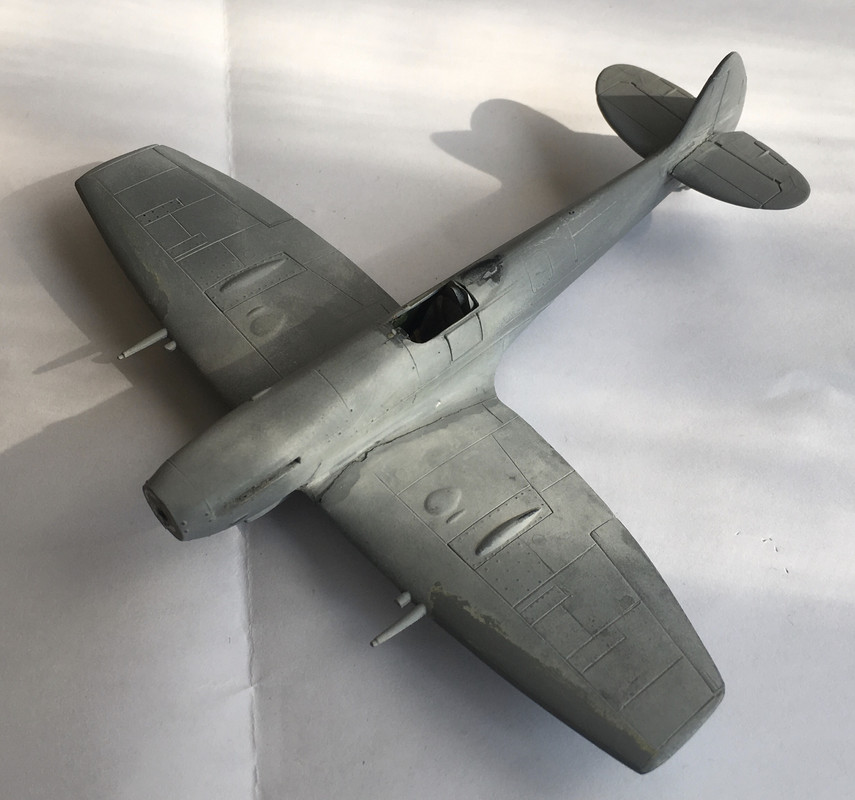

TonyOD Posted March 2, 2021 Share Posted March 2, 2021 If I wanted to strip everything off a 1/72 Spit and repaint/redecal it while not harming the interior, while hopefully reserving the lovingly scribed panel lines, what's the best way to go about it? Would I have to go at it with sandpaper or is there a method that uses a liquid? Thanks Link to comment Share on other sites More sharing options...

TonyOD Posted March 7, 2021 Author Share Posted March 7, 2021 On 3/2/2021 at 10:45 AM, arnobiz said: Breaks fluid or Oven cleaner will remove most paints without touching the plastic Oven cleaner did the job. Interestingly, the plastic was originally black. 3 Link to comment Share on other sites More sharing options...
