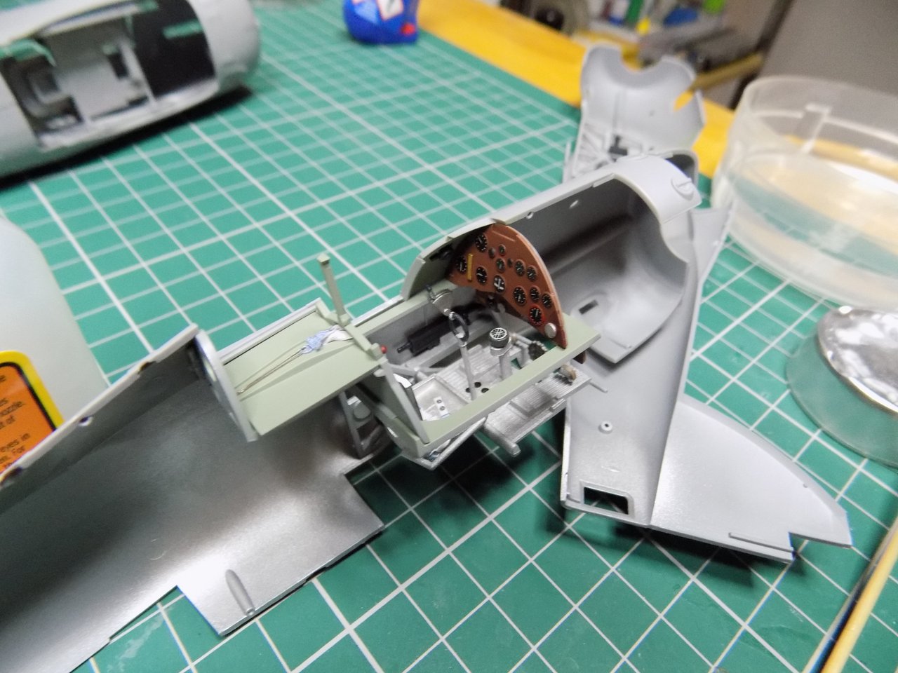

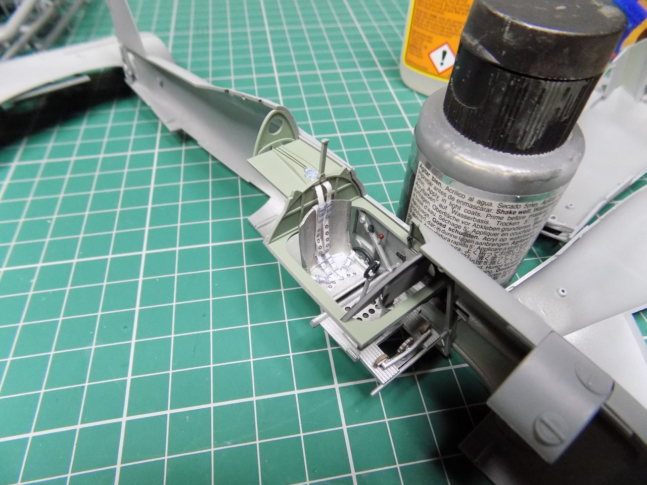

Stew Dapple 17,335 Posted February 20 Author Share Posted February 20 16 hours ago, 2996 Victor said: Interesting what you say about the KitsWorld 3D-printed decal harness: I used a set in 1/72 scale for a Spitfire I'm building. Even in the smaller scale I would say it was adequate, although with a closed canopy it'll be alright. Its a shame as its an idea with mileage, but somehow it didn't work for me and I'll be back to PE in future. Hi Mark, that's a shame, I thought they might work better in a smaller scale, but it seems not - I'm inclined to agree; I shall stick with the HGW fabric belts in 1/32 as far as possible. Anyway I got the seatbelts fitted, though I had to hack them about a bit to more closely resemble the particular arrangement of the harness in the Gladiator: I made the two restraining cables on the trough of the back 'shelf' out of .1mm nickel silver wire, all I had to hand, and what fun I had: two of them with the ends dipped in superglue gel pinged out of the tweezers to go to wherever it is bits go when they ping out of the tweezers; I shall probably find one of them stuck irrremovably to my head at some point in the future. The wire is a bit too shiny for what was needed but it will have to do. I also fitted the IP's which look like they might actually be semi-visible from the outside even with a closed cockpit so I'm glad I put some effort into them: The instructions would now have me start on the starboard fuselage interior but since I already did that I'll have to check the instructions to see where I go next... Cheers, Stew 13 Link to post Share on other sites
bigbadbadge 8,998 Posted February 20 Share Posted February 20 Cockpits looking very nice indeed Stew, the seatbelts do look a lot better now you have them in place. Great job Chris 1 1 Link to post Share on other sites

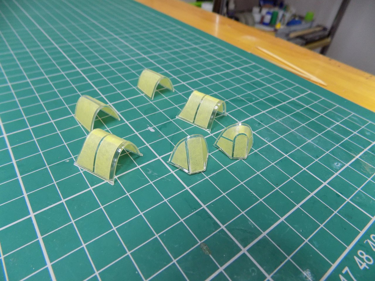

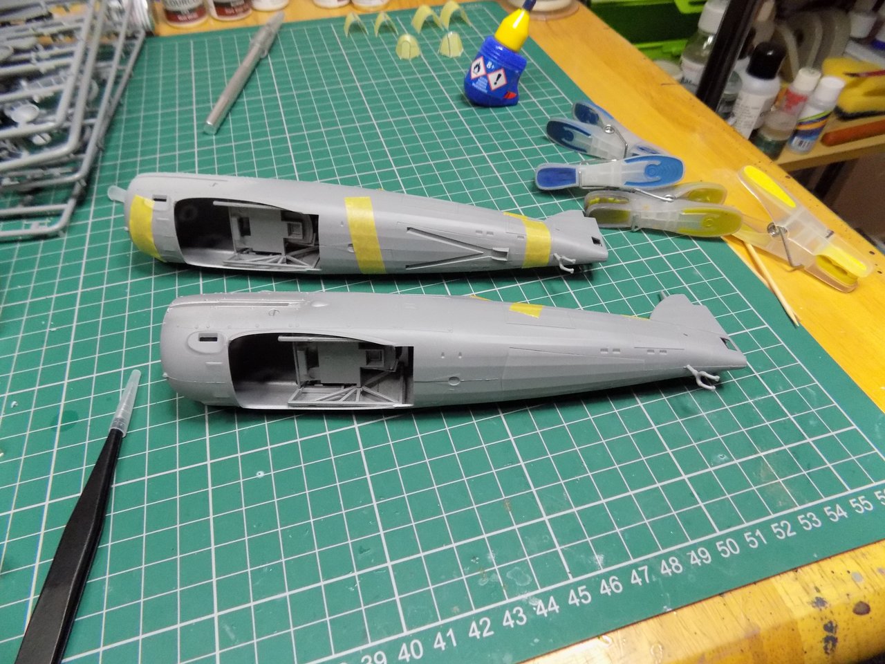

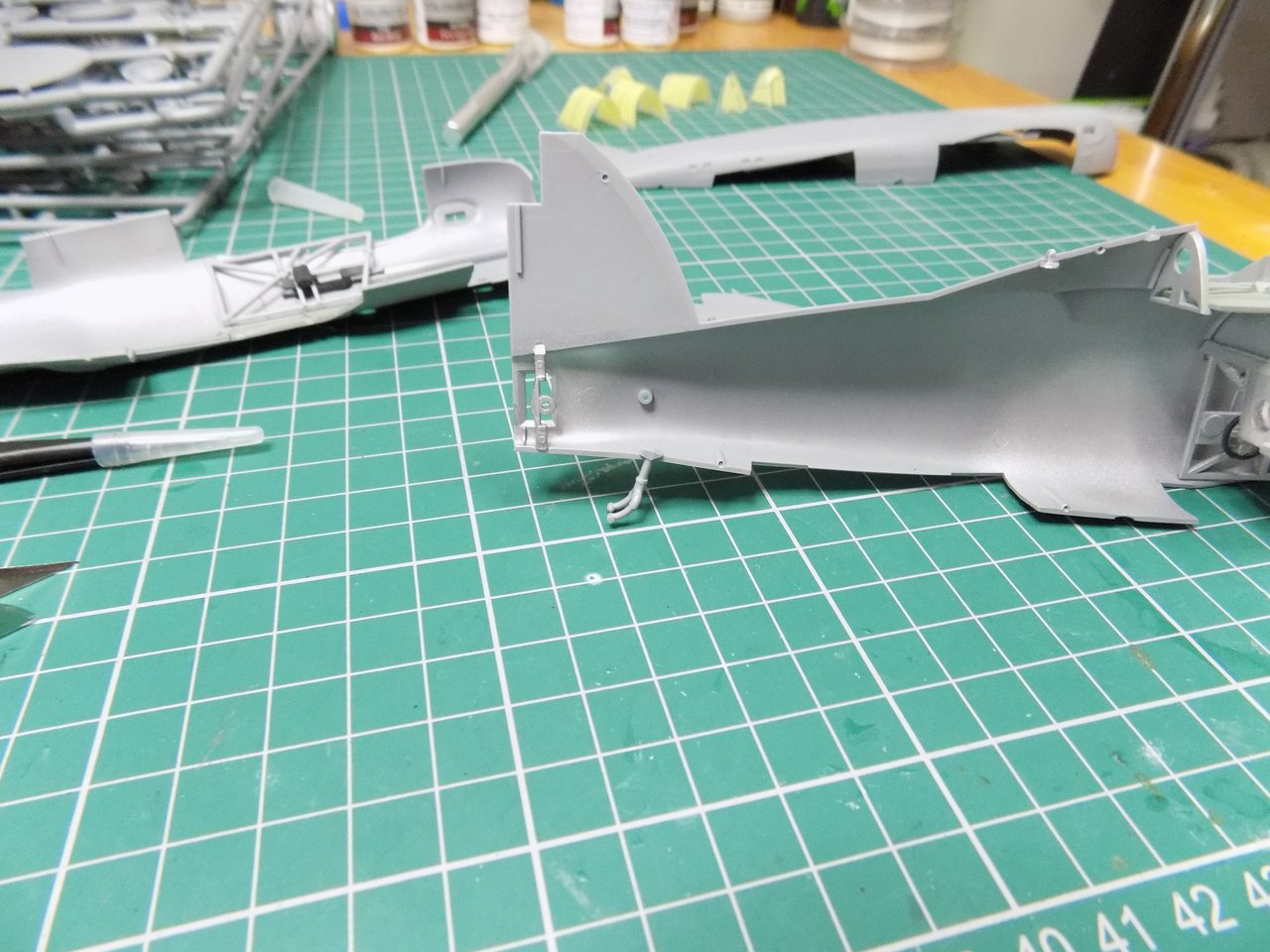

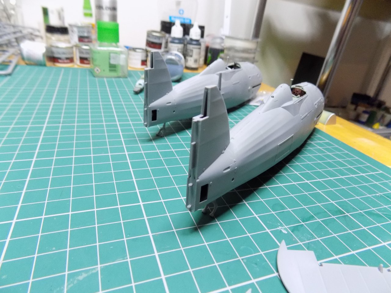

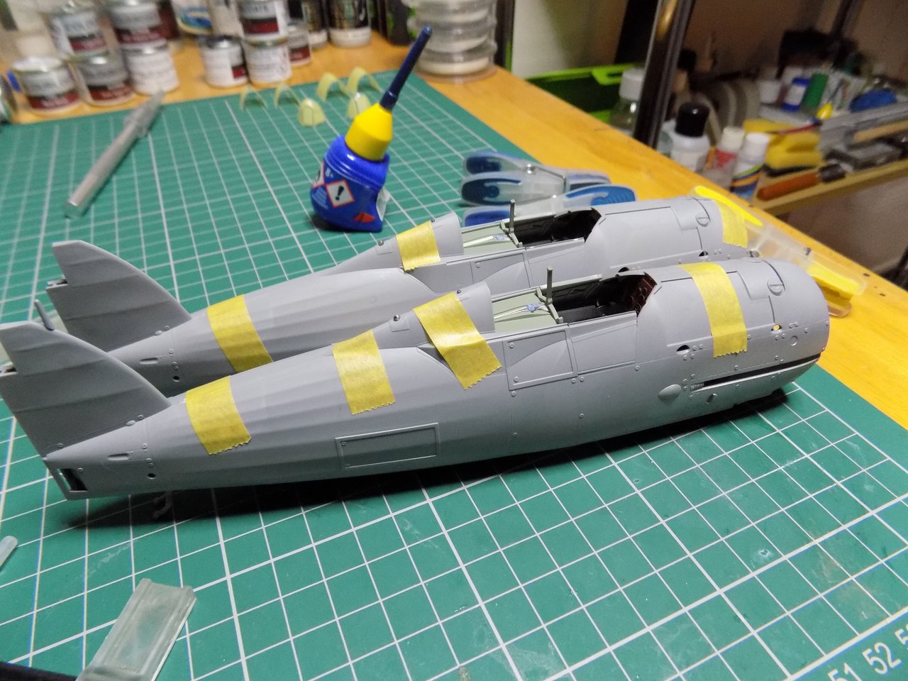

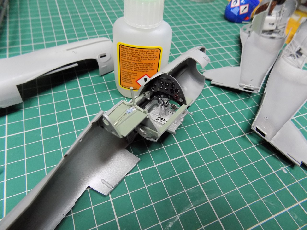

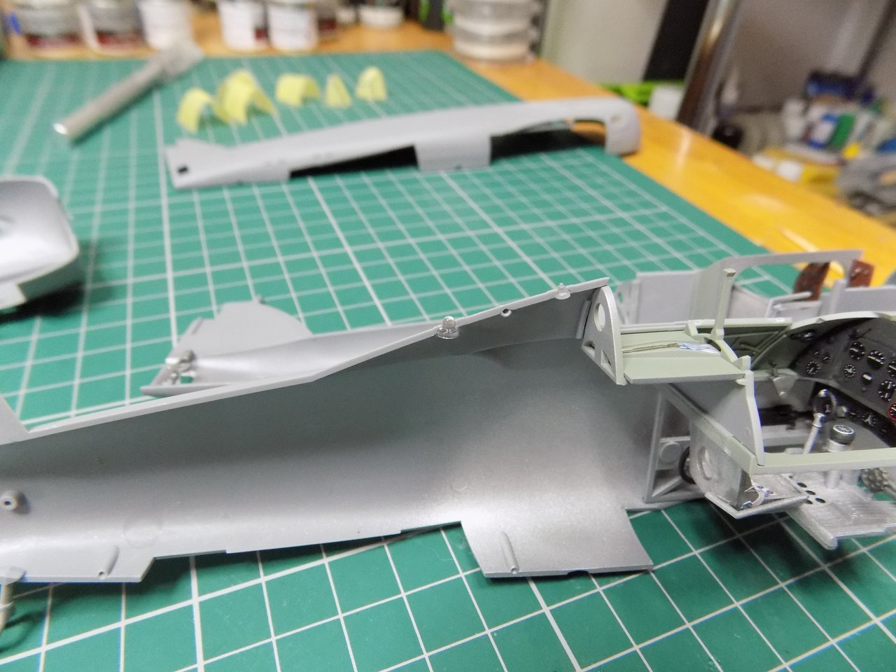

Stew Dapple 17,335 Posted February 21 Author Share Posted February 21 Thanks Chris, I've got a set of the Kits World seatbelts for the CR.42 but I see that ICM are bringing out a set with a seated Regia Aeronautica pilot so I might just put a little guy in there and see how it goes when I do get round to it. A couple of bits needed to be done before closing the fuselage: fitting the tailwheel (I opted just to fit the fork and add the tyre later for ease of painting): ... and two clear parts; the fuselage spine light and another clear part which from its position I think must be the glass insulator for the R/T wire: Both lovely little details but will be a bit of a pain to mask While I had the clear parts sprue to hand I applied the Eduard masks to the canopy sections: Then I joined the fuselage halves together. There's a bit of 'flex' and care is needed to make sure it's lined up front and back, I was a little less careful than I might have been but it should all come out right in the end: ... then the underside inserts for the Gladiator and the Sea Gladiator were fitted: They fit well, but will need a little bit of tidying up to blend in. So far I have managed not to fit any of the wrong parts to the wrong kits; plenty of time yet, but so far so good Cheers, Stew 18 1 Link to post Share on other sites
bigbadbadge 8,998 Posted February 21 Share Posted February 21 They look great Stew, I am pleased to hear that they go together okay too. I can't wait to see these come together and it's making me eager to do mine, however I must resist as I have others in the queue first. Great work Chris 1 1 Link to post Share on other sites
stevej60 38,161 Posted February 21 Share Posted February 21 Excellent progress Stew,the more I see the more I'm liking this kit. 1 Link to post Share on other sites

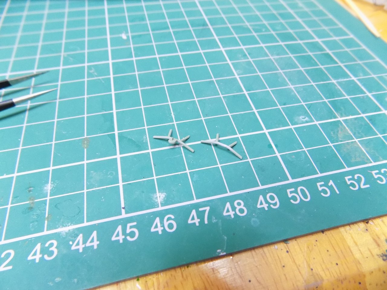

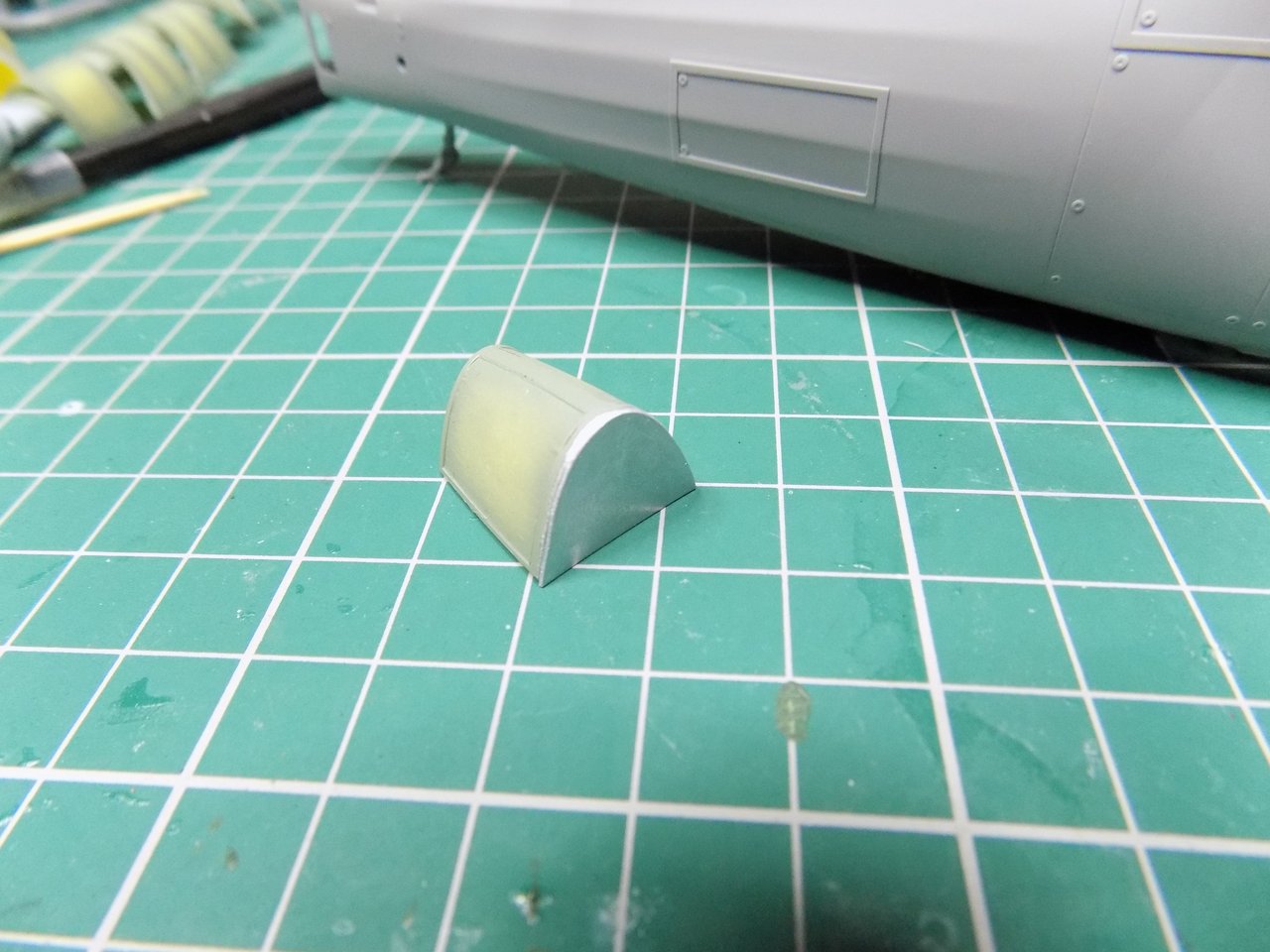

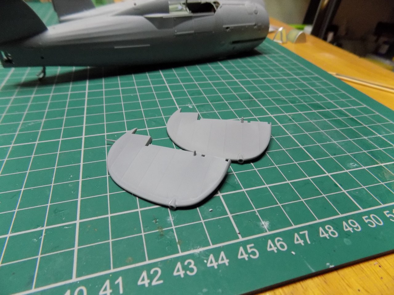

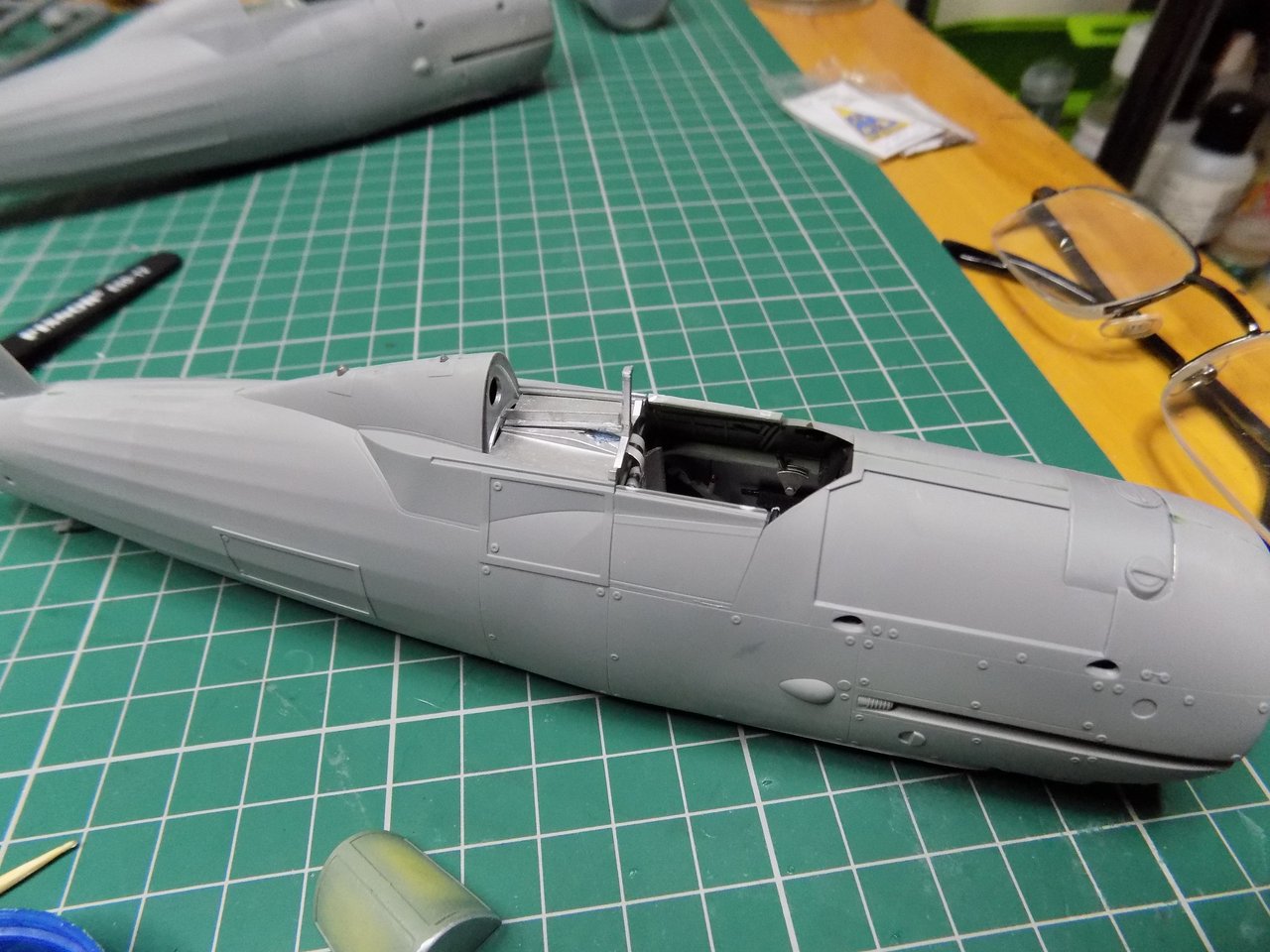

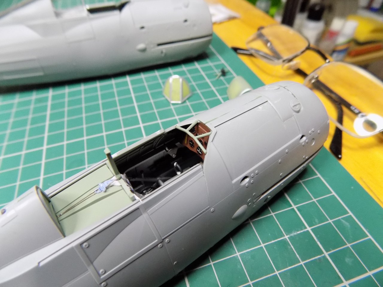

Stew Dapple 17,335 Posted February 22 Author Share Posted February 22 Thanks Chris, thanks Steve Yes, I'm enjoying it so far, but I'm getting near the stage where I have to start drilling holes in things As far as I can tell from the limited number of pictures I've been able to find, the Belgian Gladiators were not fitted with reflector sights which is logical given that they were top military tech at the time and therefore probably embargoed for exports. The mounting over the dashboard was fitted though; the kit part includes a part of the gunsight moulded onto the frame, but it's easy enough to remove if you are careful: I attached the clear parts to a paint-kebab and sprayed them interior grey-green: ... and the filling and sanding was completed: Chris @bigbadbadge was kind enough to point me at @tonyot's useful posts here, which shows the armour plate fitted to the Malta Gladiators - thankfully before I got the canopy parts fitted! I'm attempting to replicate the upper part of the armour with plastic card and I should be able to fabricate its support from plastic strip; the lower part... well it's too late for that, but it should be less noticeable in its absence: It's also apparent that N5520 has the older-style windscreen (the one on the right on the paint-kebab above) and not the later-type with the arched windscreen panel. There was at least one visible difference between N5519 and N5520 from the outset - a two-blade prop vs. three-blader - and they were repaired wth what was available when necessary but I can't find any pictures that suggest that N5519 has the later windscreen as indicated in the instructions. In a sense that's a shame, as I wanted to include as many differences as possible between my two Gladiators, but you can't always get what you want, and the Sea Gladiator kit does include the older windscreen on the clear sprue, and the Eduard mask set includes masks for both windscreens, so it could have been worse. Cheers, Stew 11 Link to post Share on other sites
bigbadbadge 8,998 Posted February 22 Share Posted February 22 Thanks for the Mention Stew, I like the paint kebab great idea. It's great that you have added the armour plate too. Looking forward to seeing the lower wing and bits and bobs going on now, they certainly look good assembled so far. Great work Chris 1 Link to post Share on other sites

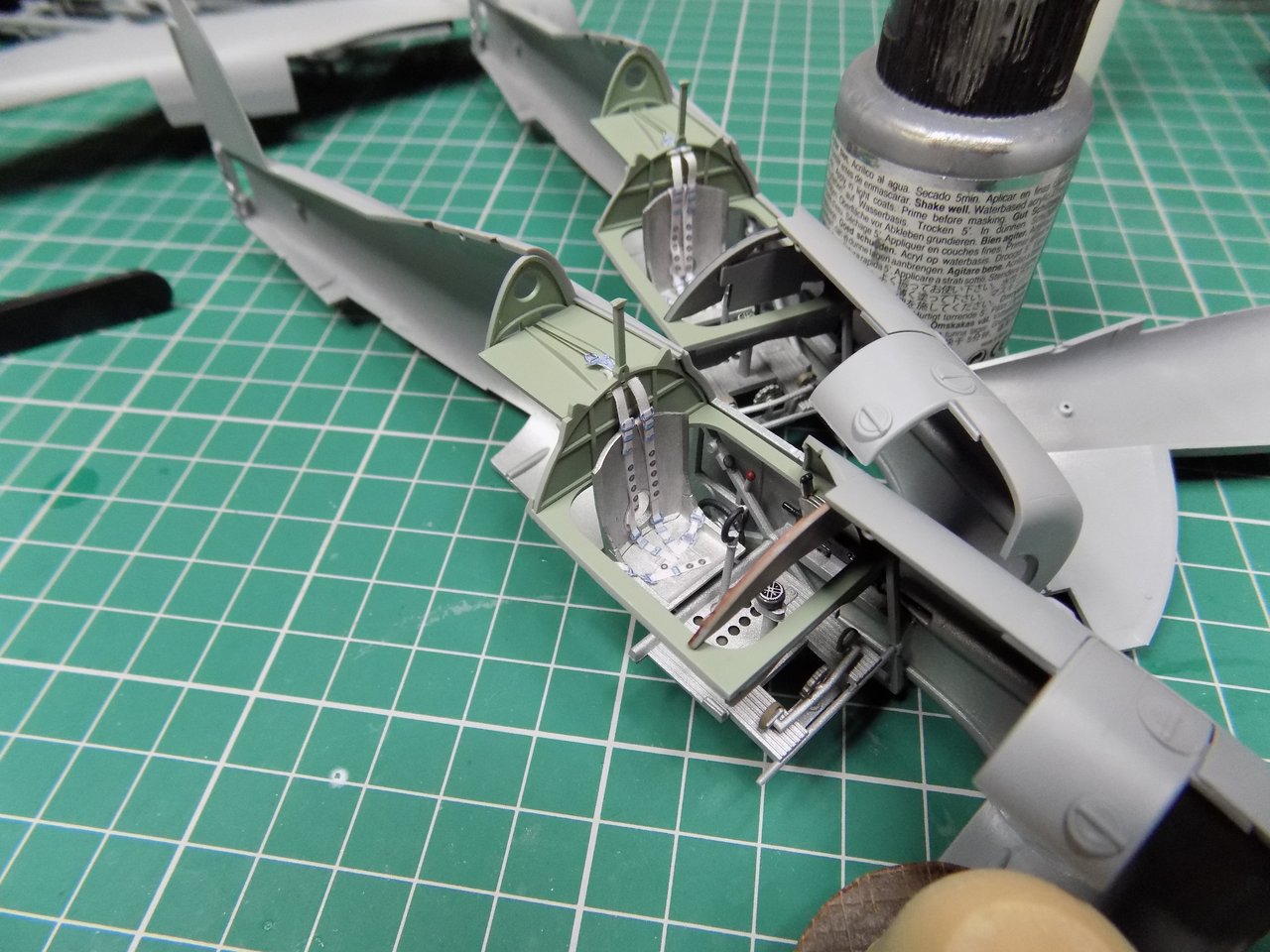

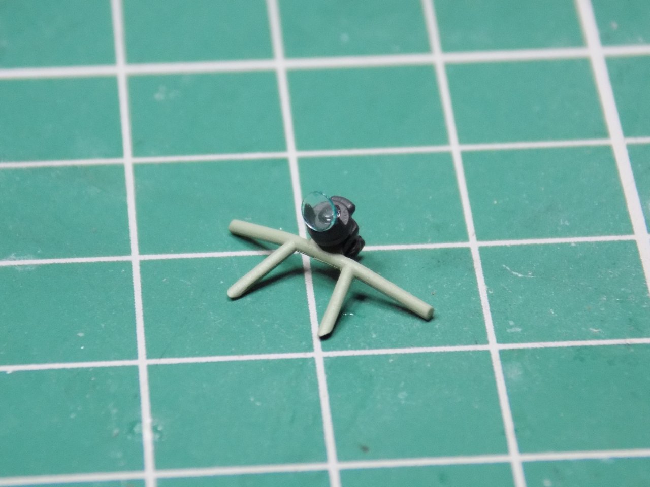

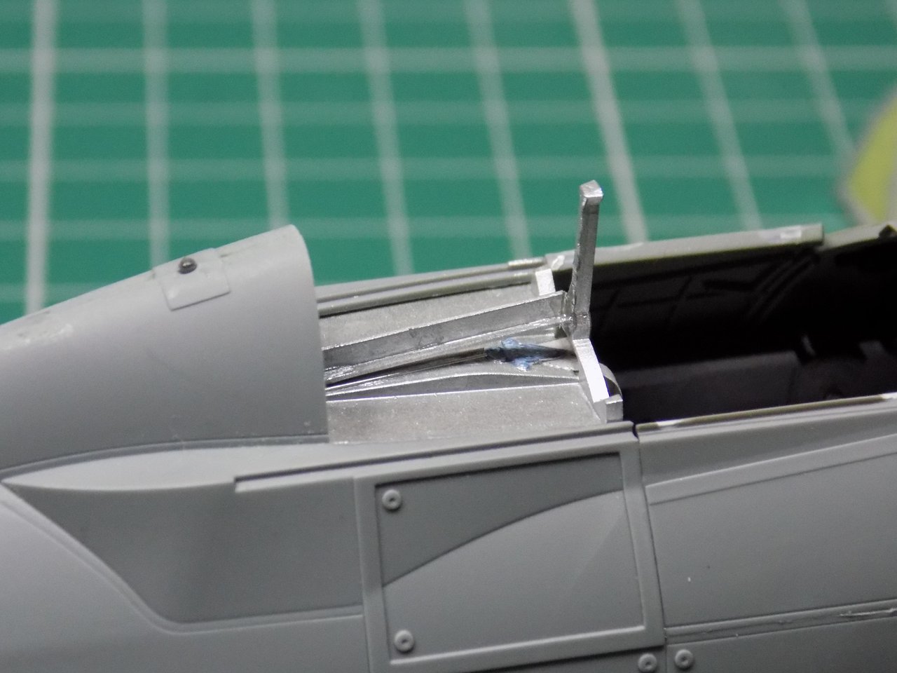

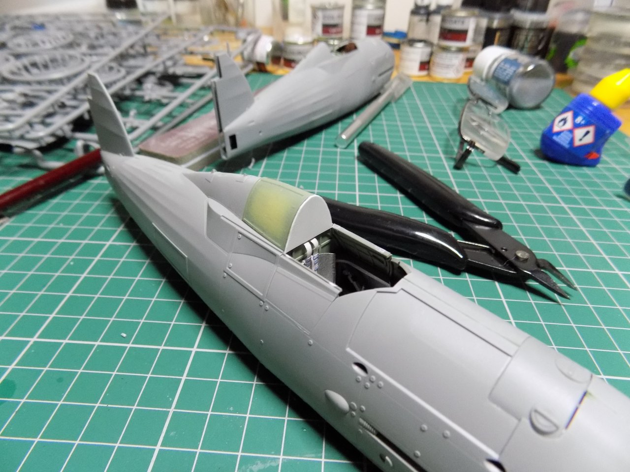

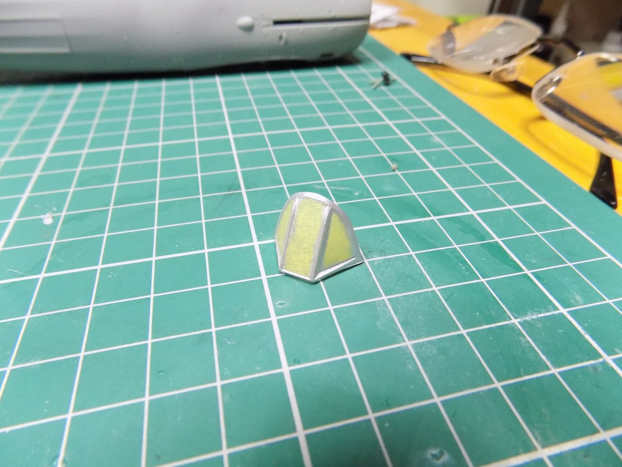

Stew Dapple 17,335 Posted February 23 Author Share Posted February 23 Thanks Chris; thanks Tony - it is a beautiful kit, what particular aircraft are you building, or have you not decided yet? From Tony's photo's the area aft of the pilot's seat and the interior framing are painted Aluminium; I repainted this area with Vallejo Metal Colour White Aluminium with a brush rather than try to mask it all off for spraying: You can also see the T-section bracing for the armour plate, which I made from Slater's Microstrip - this bit here: Also painted at the same time was the armour plate: It was really too late to repaint the canopies so that the Aluminium colour shows on the inside, as I had already sprayed them interior grey-green - the options were to either paint the canopy framing Aluminium from the inside, or leave it as IG-G. I decided discretion was the better part of valour on this one and left them as they were, except for the 'replacement' front windshield which I had not previously painted, so that was masked and done in Aluminium: I also made up the gunsight and put in more effort than is probably healthy, painting it black with a blob of Kristal Kleer to represent the projector lens and stamping out an acetate disc for the reflector plate, which got a coat of a mix of Tamiya Clear Blue and Clear Green round the edges to give it a more glasslike look: It might seem a disproportionate effort given that it will most likely be unnoticeable once the kit is completed, but it took me all of five minutes and I was enjoying myself I didn't do much on the Belgian Gladiator as a result of spending most of my spare time yesterday on the Sea Gladiator, but I did fit the gunsight mounting: Most likely there was some sort of pad on there in real life to stop you breaking your face in the event of a hard landing, Cheers, Stew 14 1 Link to post Share on other sites

Mottlemaster 3,039 Posted February 23 Share Posted February 23 It looks like your getting loads of fun out of this project Stew .I'm building the ICM cr42 at the moment and it has loads of parrels to the Gladiator kit . I'm just gobsmacked how good the fit is and the excellent design of the parts. Your glass for the gun sight looks so realistic, an idea i will take forward myself. Looking forward to seeing how you tackle the rigging asiv never tackled this myself . Cheers Alistair 2 1 Link to post Share on other sites
bigbadbadge 8,998 Posted February 23 Share Posted February 23 (edited) Great update Stew, like the repaint and additional bits for the armour. The gunsight looks great too. Fantastic job. Chris Edited February 23 by bigbadbadge Predictive text changed gusight to gunfight !!! 1 Link to post Share on other sites
