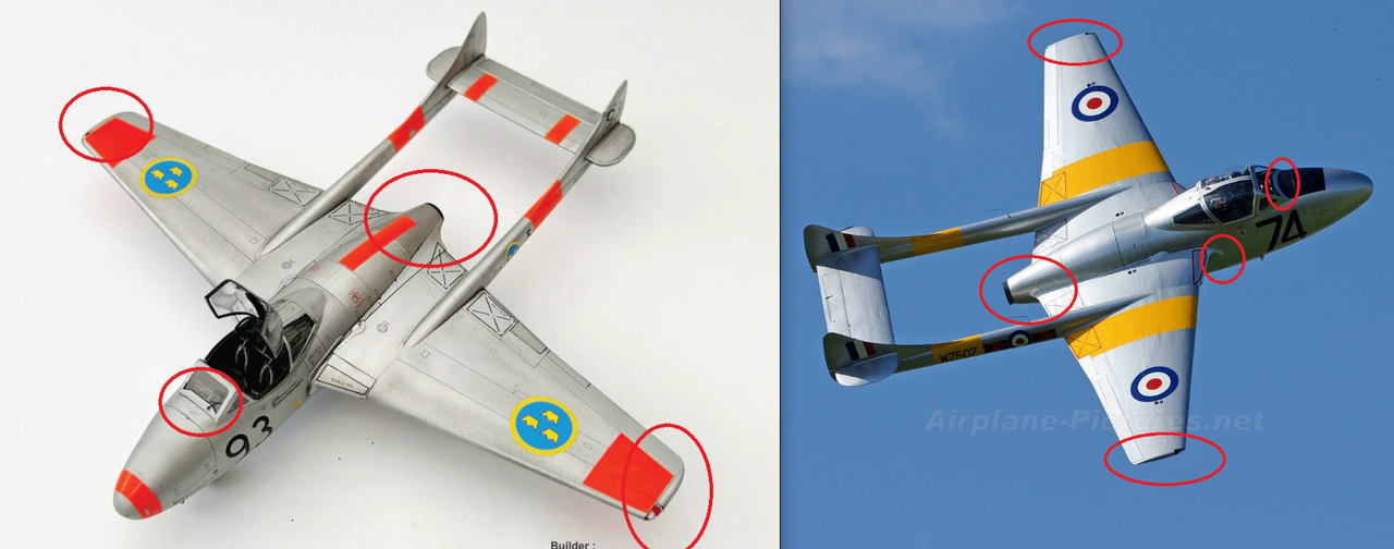

I'm really hoping that this is built from a clunky test shot.
The rear fuselage/tailcone area of both the kit and three view drawings is a work of fiction and doesn't follow the actual aircraft at all.  I'm wondering if it's a result of what @NAVY870 says with the wing chord appearing to being too great.
The wing itself looks too thick, not only at the leading edge but also at the tips (which also looks too rounded) and the trailing edges.
1920px-De_Havilland_DH115_Vampire_bankin
Edited by 71chally
re-posting picture link
  • Thanks 2

6 hours ago, general melchett said:
The Vampire T.11 is one of my favourite aircraft so the news of PR doing one in my favourite scale was music to my ears BUT, and I hate to get into speculation before getting hold of the plastic, something does seem a bit off here.
Vampire T.11 wing trailing edge fillet area.
Also, the wings on the models shown appear to be quite deep and lack a sharper more defined leading edge. (Aircrew just keeping getting younger!) The 'crease line' of the leading edge should be central and not in line with the top of the intake which would suggest that the chord of this portion of the wing is incorrect. Just my observations from what are admittedly test shots. Must wait and see.
Vampire T.11 leading edge.
Yes that leading edge doe look suspect.

4 hours ago, Homebee said:
:crying:
V.P.
I like this post. Nice comparison to show the supposed issues.
Well done.
Andy

Old fashioned thinning of the wing from the "inside" should help. The problem is if the wing profile is off, i.e. if the wing profile is more like a Hawker Typhoon than a Mk.22/24 Spit. Then the  leading edge will look too blunt anyway.
And I agree the wing tip shouldn't be a problem.
And again, even if the plastic of the wing is not thick enough for heavy sanding, it can be reinforced from the inside with miliput...
Link to comment
Quote
It's not a test shot that has been built up, as far as I understand it's the released kit
If that's the case Johan, just going by these images, then it's quite disappointing. I think I'll hold off a while and see what detailed reviews turn up. I didn't even notice the awful windscreen shape, it seems that the nose area, forward of the windscreen, is way too flat.
2-01e82e70-de47-42a5-83ab-a3a72609ca87.w
De-Havilland-D-H-115-Vampire-Trainer-Mk-
Image courtesy of Wikimedia Commons, link here.
https://commons.wikimedia.org/wiki/File:De_Havilland_D.H.115_Vampire_Trainer_Mk.55_(VT-8)_K-SIM_03.jpg.
I thought something looked off in this CAD view.
138794043-3777202385633078-7887676265812
Edited by general melchett
  • Like 2
Link to comment
