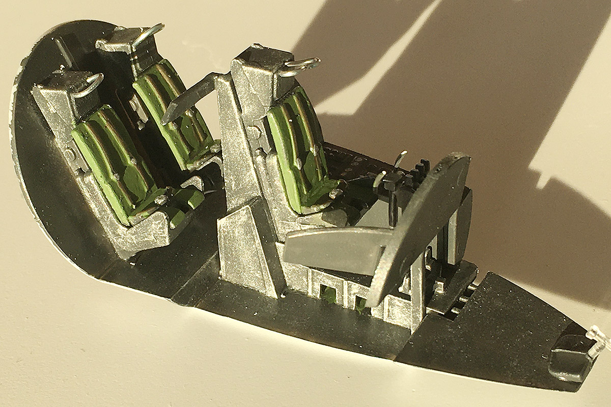

Back in the Saddle Posted January 6, 2021 Posted January 6, 2021 I know I should really finish one of the five models currently on my workbench, but I felt compelled to start another one...! 😄 This will be a very straightforward build, almost completely OOB with only minor improvements to the kit offering. Talking of which, I know there are various inaccuracies with this kit, but I'm just planning a simple build - no rivet counting on this one! There are some very talented modellers on this website who have already done wonderful things with the various Airfix Canberra kits - I cannot compete with that degree of commitment so I'm just having some fun with this one! To start, here's the box: A £14.99 bargain from Modelzone, many years ago! This is the scheme I will build, a 213 Squadron B(I)6, based at Bruggen in 1969: From other threads, I know this model can be a tail-sitter. The instructions recommend 100g of nose ballast! That seems excessive (I really hope I don't regret saying that) and I have settled on about 75g of rolled up lead on top of the bomb bay, held in place with silicon: The cockpit interior was painted dark grey. I think once it's closed up it will look pretty black. I have also picked out the details on the axe, just in case it can be seen: Work on the cockpit was basic - I suspect the rear two seats will be almost impossible to see once the fuselage is closed up. Here's the current progress: Ejection seat handles were roughly fashioned from a paper clip. Here's the other side, which will be more visible through the open cockpit door: I applied some dry-brushed aluminium to this side, as it might just be seen through the door! This was then glued into position: I intend to close the fuselage up tonight and start the wings.👍 15
(ex)Sgtrafman Posted January 6, 2021 Posted January 6, 2021 Hey Matt lookin good mate, sometimes you need something new just to get the juices flowing, I know that I suffer with burn out every now and again, especially when your devoting a lot of time and effort to other builds (love the 747 btw) have fun buddy coz that’s what it’s all about. stay safe Iain 1
bar side Posted January 6, 2021 Posted January 6, 2021 Well if it’s anything like the PR.9 then I would say all 100g nose weight is needed. Maybe even more! Let’s just say the nose weight is heavier than the kit nose wheel can a silky take. Nice work so far & looking forward to seeing it progress

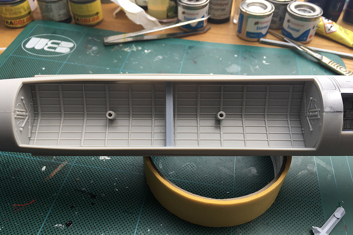

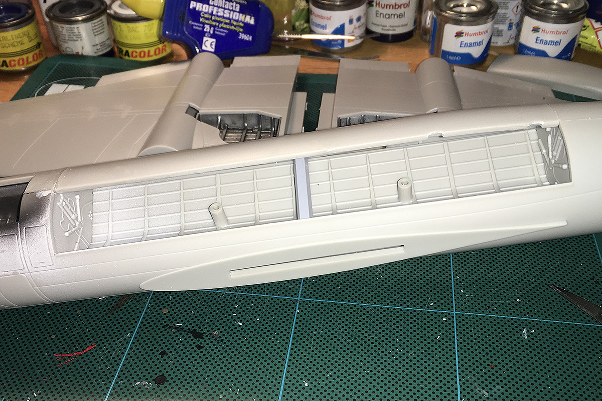

Back in the Saddle Posted January 8, 2021 Author Posted January 8, 2021 21 hours ago, franky boy said: Nice start Matt Thanks James. I wasn't expecting too much from this kit, hence planning to make it a quick, basic build. However, despite it's poor reputation for accuracy it's actually a very pleasant build - the fit so far has been excellent and the general shape is pretty accurate. I attached one bomb bay door initially, gluing first one end, then the other, then the long side: Once that was rigid I attached the second door, following the same procedure to get it aligned: The engines are for my 1/72 BOAC 707 build - a kit which needs much more fettling than this one! They were primed this afternoon, along with the Canberra bits edging in at the top of the picture. My final job today was gluing the remaining transparencies into place - another job which was surprisingly straightforward: I'm building this one without any armament (except the rocket pod on the belly), so only a few more sub-assemblies to construct. 7

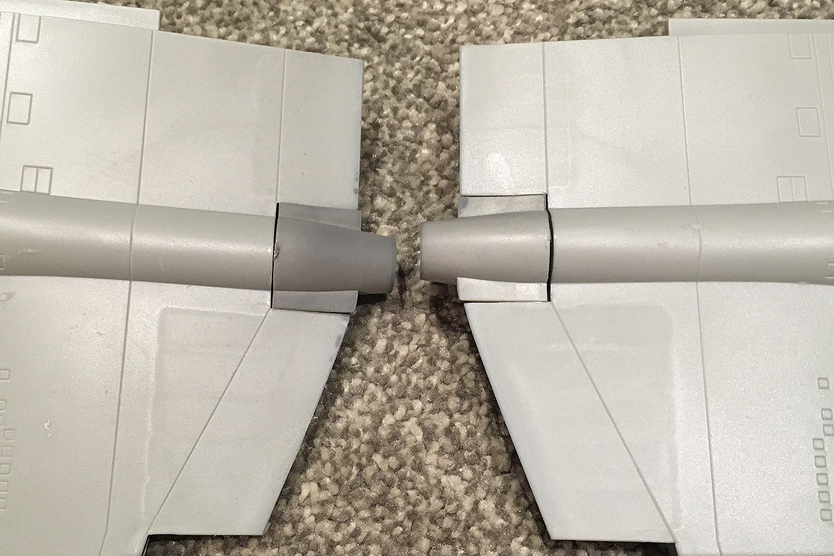

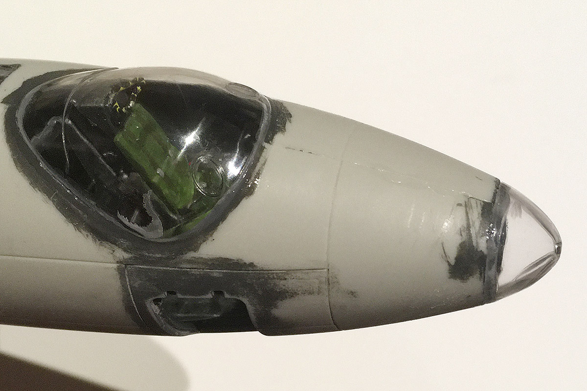

Back in the Saddle Posted January 10, 2021 Author Posted January 10, 2021 Despite my earlier enthusiasm for the great fit of the various parts, I have inevitably found something now that doesn't fit so well! The exhaust attachments will need a little fettling: I also need to rectify a couple of own-goals, caused by my clumsy modelling. On the canopy some Tamiya extra thin ran under the tape on the right hand side and I have also scratched the nose window at the top: A session with polishing clothes should fix that! 7

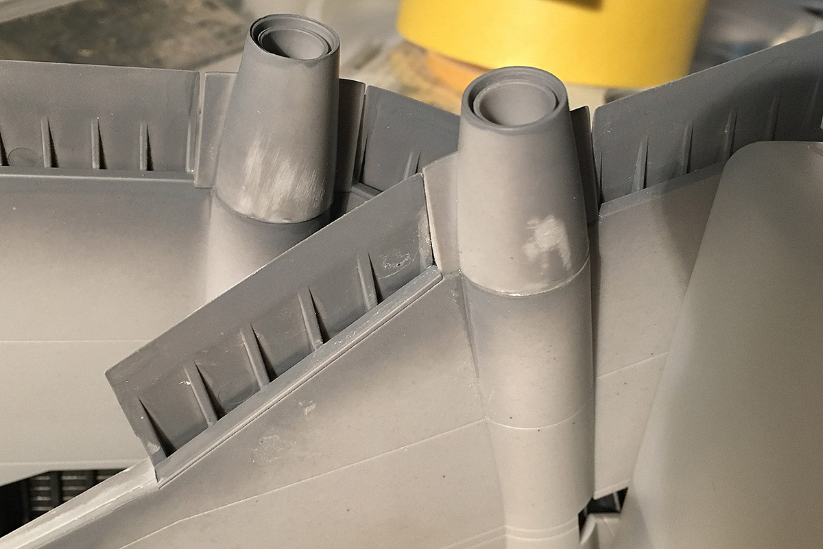

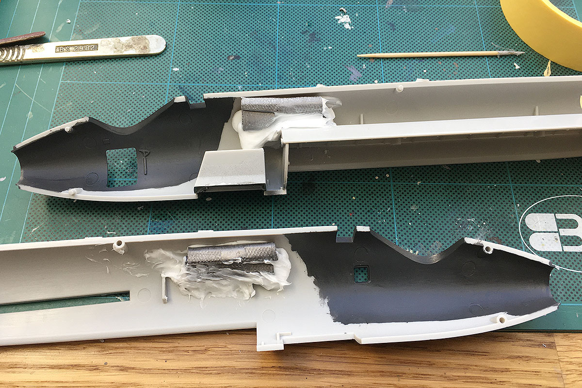

Back in the Saddle Posted January 15, 2021 Author Posted January 15, 2021 The polishing clothes worked a treat, so I can now get the transparencies masked before priming the fuselage. In the meantime, I have turned my attention to the exhausts. After some judicious filing I have slotted them into place and applied extra thin around the joint: The nacelle diameter is different at the point where the exhausts attach to the main body of the wing, so some filling and blending awaits - deep joy! 😆 There is also a mismatch with the trailing edges, as the inboard section is drooping slightly. These will be clamped into a straight line (forcing alignment with the exhaust inserts) then glued into place. 9
The Spadgent Posted January 21, 2021 Posted January 21, 2021 oooh I missed this. Looking good. I would have put more weight in that nose. I’ve never built one of these but I did the Academy Catalina. Oooh boy that needed a house brick up front.😩😳🙀 But as you said you have a prop so all good. The internals look grand. Deffo look into getting some gators grip for your clear bits. Best thing I ever did. I’ll tag along if I may. Johnny 2

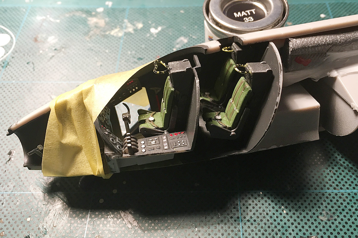

Back in the Saddle Posted January 26, 2021 Author Posted January 26, 2021 On 20/01/2021 at 18:37, exdraken said: Great build! Thank you! It's all very basic but I'm enjoying it immensely - its just what I needed! On 21/01/2021 at 23:58, The Spadgent said: oooh I missed this. Looking good. I would have put more weight in that nose. I’ve ever built one of these but I did the Academy Catalina. Oooh boy that needed a house brick up front.😩😳🙀 But as you said you have a prop so all good. The internals look grand. Deffo look into getting some gators grip for your clear bits. Best thing I ever did. I’ll tag along if I may. Cheers Johnny. I *think* there's enough nose weight, but it's definitely less than recommended - it's heavy enough as it is! The tail prop is there if needed... I've struggled getting any gator's grip, so have used plain old poly cement. It seems to have worked OK without fogging - the cockpit area is well ventilated as the door is not attached yet. Welcome along! On 22/01/2021 at 01:25, Gary Medland said: Watching builds like this progress helps me to understand what an amateur I am! 🤣😂 Nice build sir, keep it up. 😉 👍🏻 Thanks Gary, you're too kind.👍 My skill level has come on enormously over the past year, with plenty of tips from the many great builders on this forum. There's nothing particularly difficult about what I do - certainly compared with what some people achieve! IMHO, it's a combination of three things. Firstly, you have to want to produce a better model. The time I spend filling and sanding nowadays is much more than it used to be - but it pays off handsomely. Talking of which, the second issue is time. Be prepared to put in some effort and you will see a huge difference - don't rush things. The third consideration is practice. I have learnt several new modelling skills over the past few months simply by reading other threads and attempting the techniques that other builders have used - many of which have been new to me. It doesn't always work first time, but its fun to try and very satisfying when it does come off! Since my last post I have worked a bit more on blending the exhausts - but they still need more attention... I have also started to work on the nose and am filling the gaps: Once I have finishing prepping I will get the fuselage primed.👍 8 1

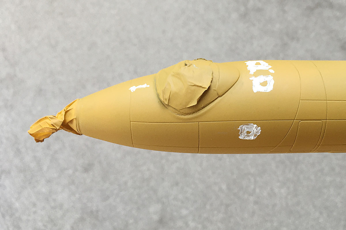

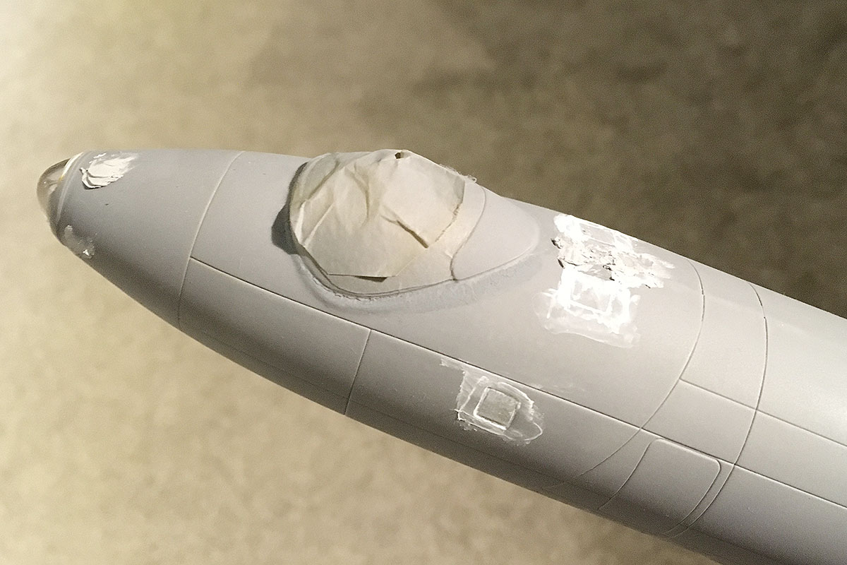

Back in the Saddle Posted February 19, 2021 Author Posted February 19, 2021 On 26/01/2021 at 21:19, The Spadgent said: Looking good . I would have masked up before filler but I’m sure you have it in hand. I do love this aeroplane. 👏👏 Thank you! @Gary Medland - this is the great thing about BM. Loads of friendly tips to help you build better models! I took Johnny's advice and masked up the transparencies: I also put some tape over the cockpit entrance to stop primer getting in... The primer certainly helps to show where more sanding is needed!😆 I will try to get some more done on this over the weekend. Life has been a bit busy for the past few weeks...! 6

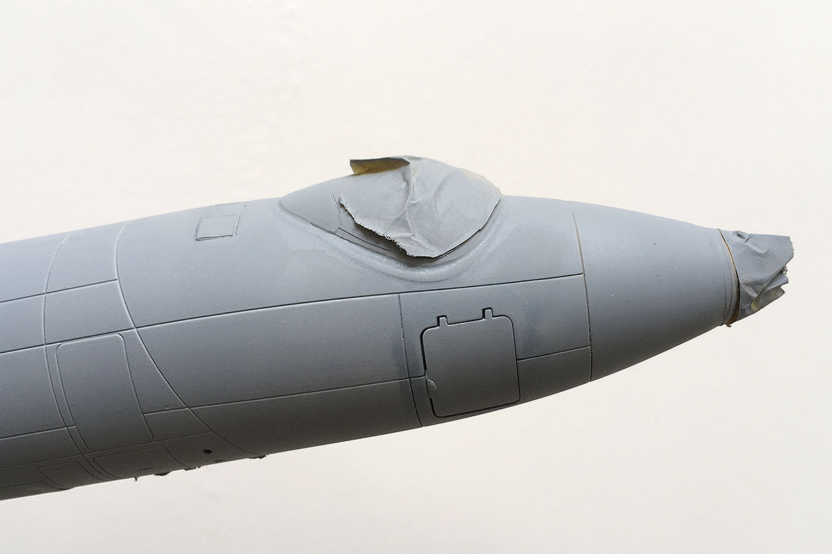

Back in the Saddle Posted March 15, 2021 Author Posted March 15, 2021 I've been neglecting this build recently, but have worked on the nose and primed the fuselage: I can see more filler will be needed around the main canopy! I might have to reduce those panel lines down a bit too... 7

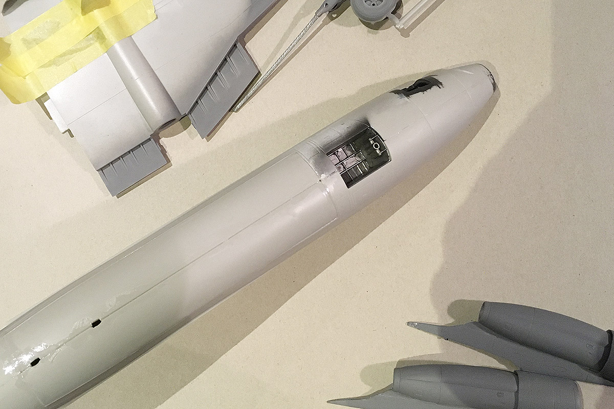

Back in the Saddle Posted April 12, 2021 Author Posted April 12, 2021 This build has been a bit quiet recently, due to lack of time, but I have made a little progress. The fuselage has been filled, ready for sanding: It may need another filling session - I'll see how it looks once I've sanded it back. I also have most of the other components ready for priming: Subject to weather, I hope to get some more work done later in the week! 10

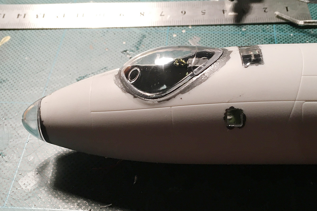

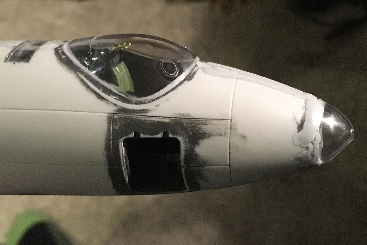

Back in the Saddle Posted April 17, 2021 Author Posted April 17, 2021 The story of my weekend (so far) has been filling, priming and sanding! The fuselage is now looking reasonable, but I felt the transparencies could be blended in better: I'm hoping a final sanding session and prime tomorrow will see this job done. The wings however need much more work, especially around the exhaust sections... 6
Back in the Saddle Posted April 19, 2021 Author Posted April 19, 2021 Work on the transparencies has continued and I think I'm on top of that job now. I just need to re-mask them before a final blast of primer, as the sandpaper has worn the protective cover away... Work on the wings is ongoing. I sanded out the worst of the blemishes and they are also ready for primer: I can see a couple of areas that need work, but it's slowly getting better! 7
