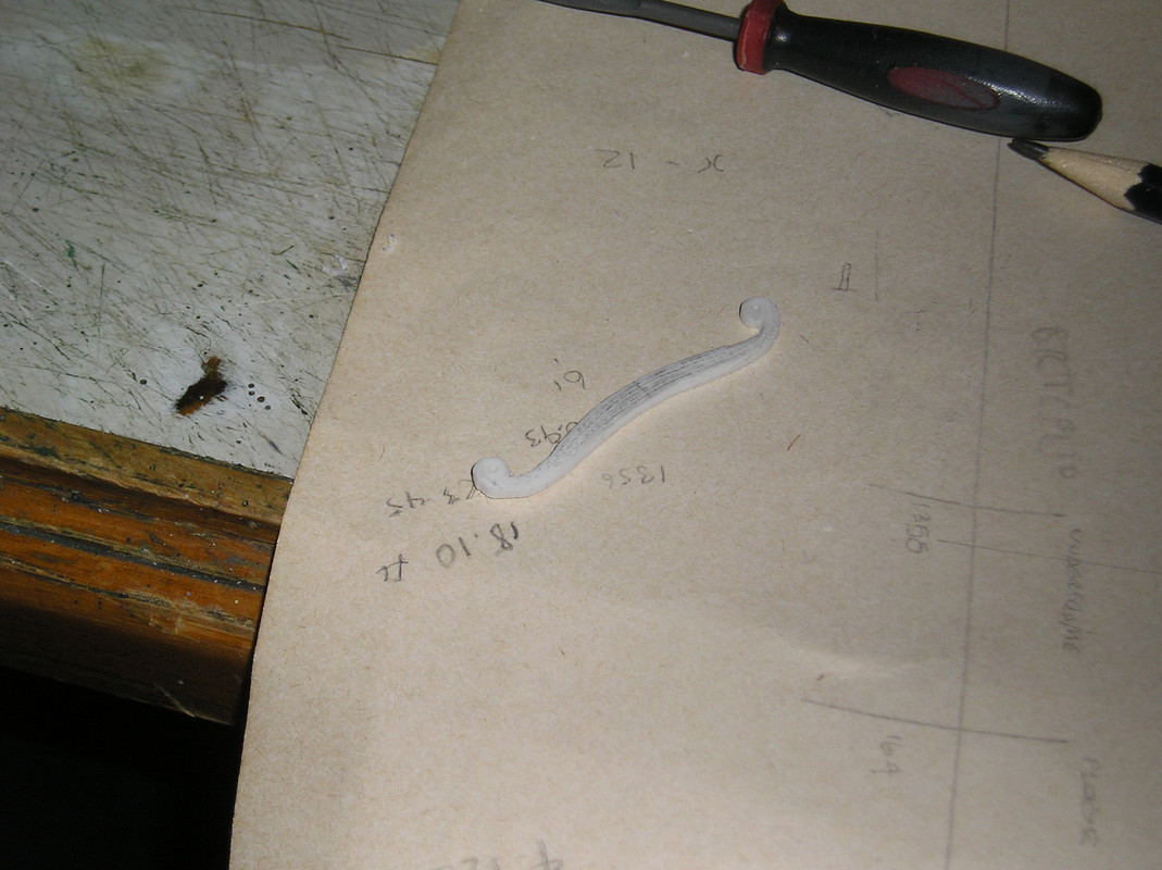

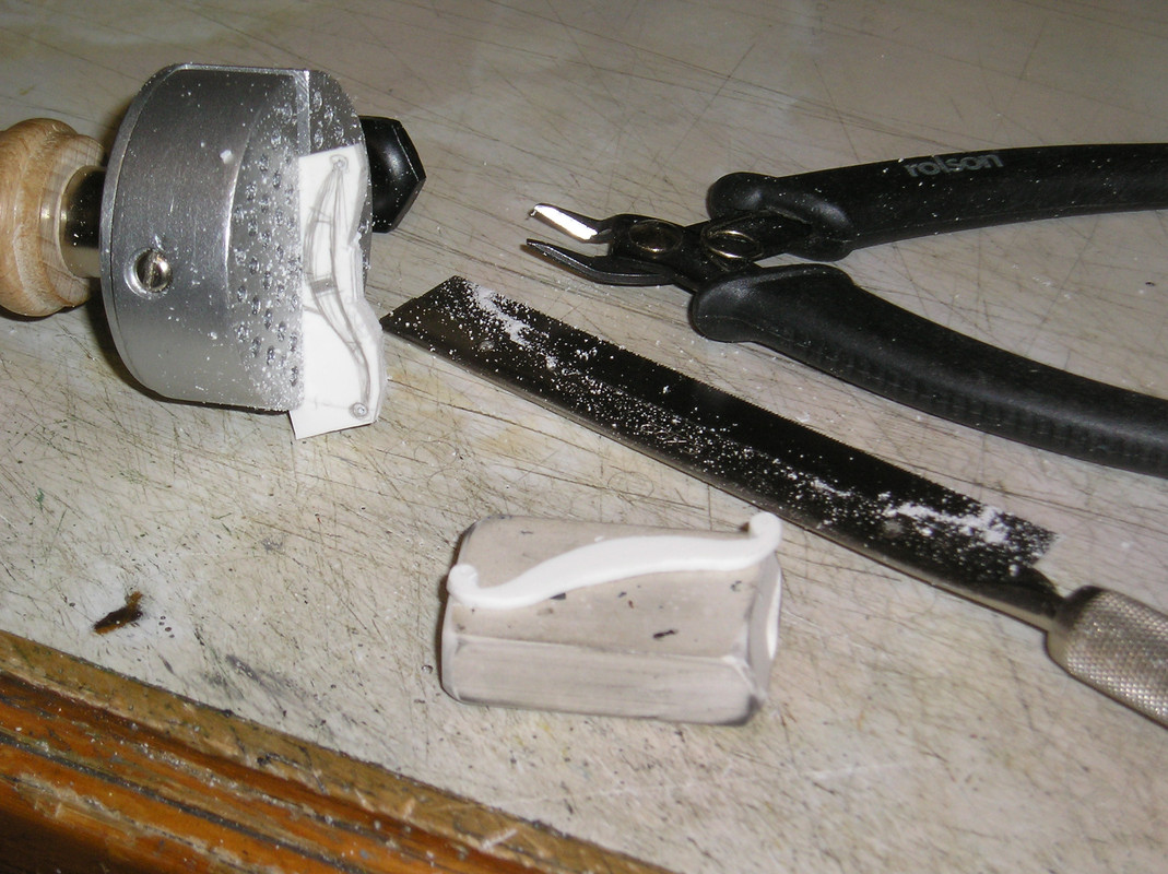

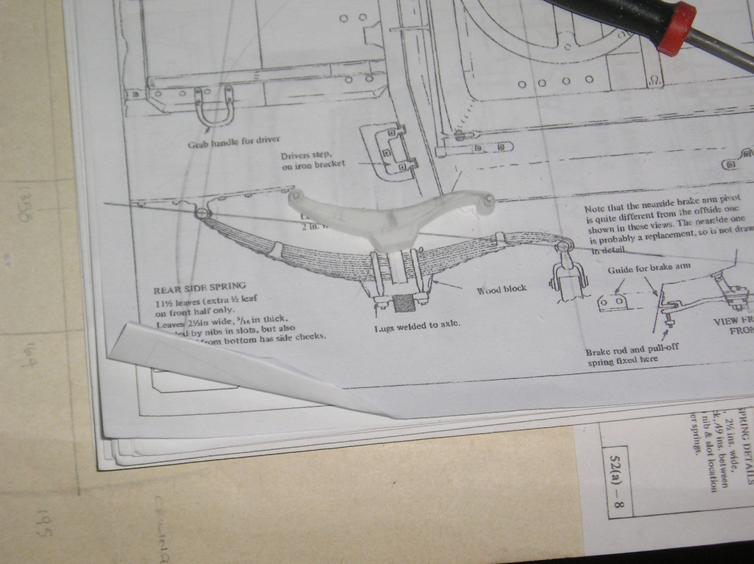

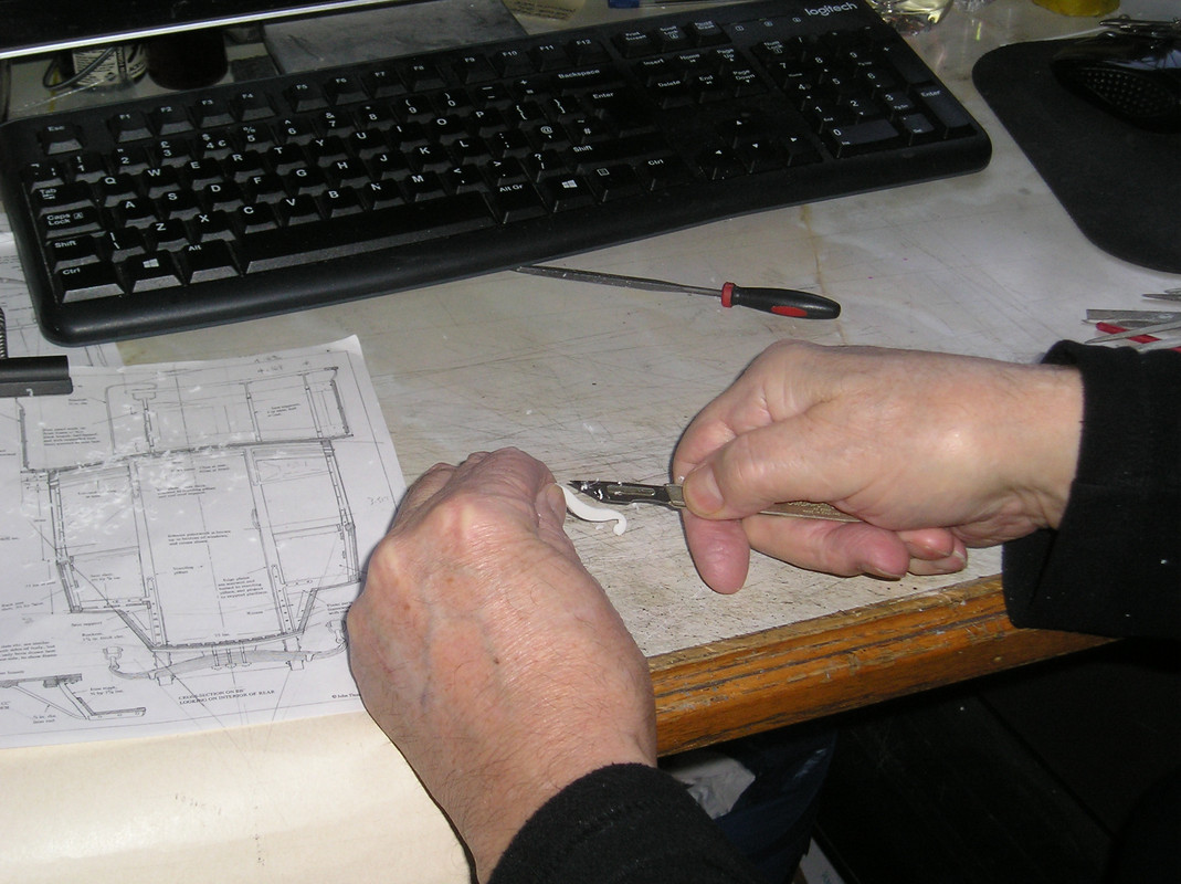

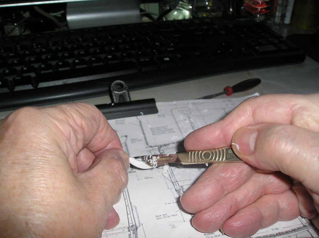

perdu Posted December 14, 2020 Author Share Posted December 14, 2020 It's 'spring time, all the pretty ring time, sweet lovers love the spring.' Hey nonny no! Oh pardon me I feel a bit lightheaded after my visit to the hairdresser's emporium of light headedness. Did you know they don't even offer it back when they hack it away? Shocking innit. Anyway spring time, no blooming nonny nos round here I can tell you. The first, back spring is almost there and the next pair will be excavated from the sheet together, try a little symmetry huh The pivot holes are held together by a pair of Evergreen pegs, which I am trying rather than waste any Slater's red rod on it. The plan is to cut out the spring and the block they sit on across the axle ends at the same time since they are dimensionally the same in scale thickness. We'll see. Tomorrow after I sleep on this light head of hair... 13 Link to comment Share on other sites More sharing options...

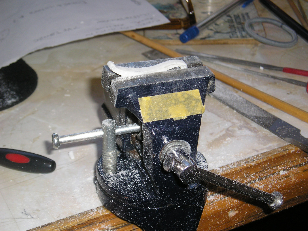

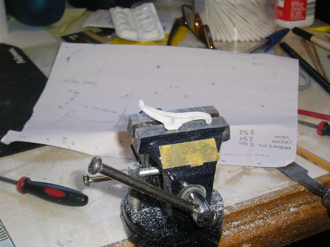

perdu Posted December 15, 2020 Author Share Posted December 15, 2020 Just to prove that hand held is fine but proper clamping is essential, Bench The Vise is in situ with a monumental task ahead. It is as if we have had an early snowfall around the vise, do not even look at the floor below it. I am getting there but it is still a vast distance between this and the finished items, I am beginning to regret making the wooden mount blocks at the same time as the springs, too late now to worry. Still A little further to go now but this is the bulk of the 'damage done' I did an overhead that didn't take very well look But you can see the pair of springs is slimmer than it looked in the 'flashy shot'. Now then, where is that little dustpan? 15 Link to comment Share on other sites More sharing options...

perdu Posted December 15, 2020 Author Share Posted December 15, 2020 Thank you G, we do our feeble best. Moving slowly on it is time to refine the cut out spring blocks The flat of a blade runs across the square edges of the moustache shape to thin it down to the more refined shape we need This Is much less 'there' than this, trust me. This is yesterdays imagery. I am going to TRY to scribe eleven leaves into the sides of this 'tache shape, if I can't so what? I own a very fine pencil. 11 Link to comment Share on other sites More sharing options...

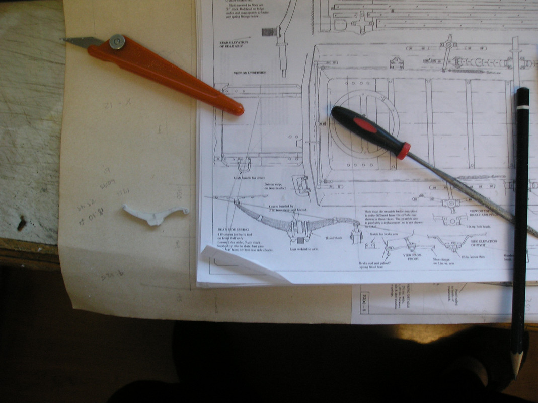

perdu Posted December 15, 2020 Author Share Posted December 15, 2020 I dont think I will be trying any harder than this for the separate spring simulation Sand it smooth and walk away's the order of the day. ciao, it is time for b.. er Netflix 12 Link to comment Share on other sites More sharing options...

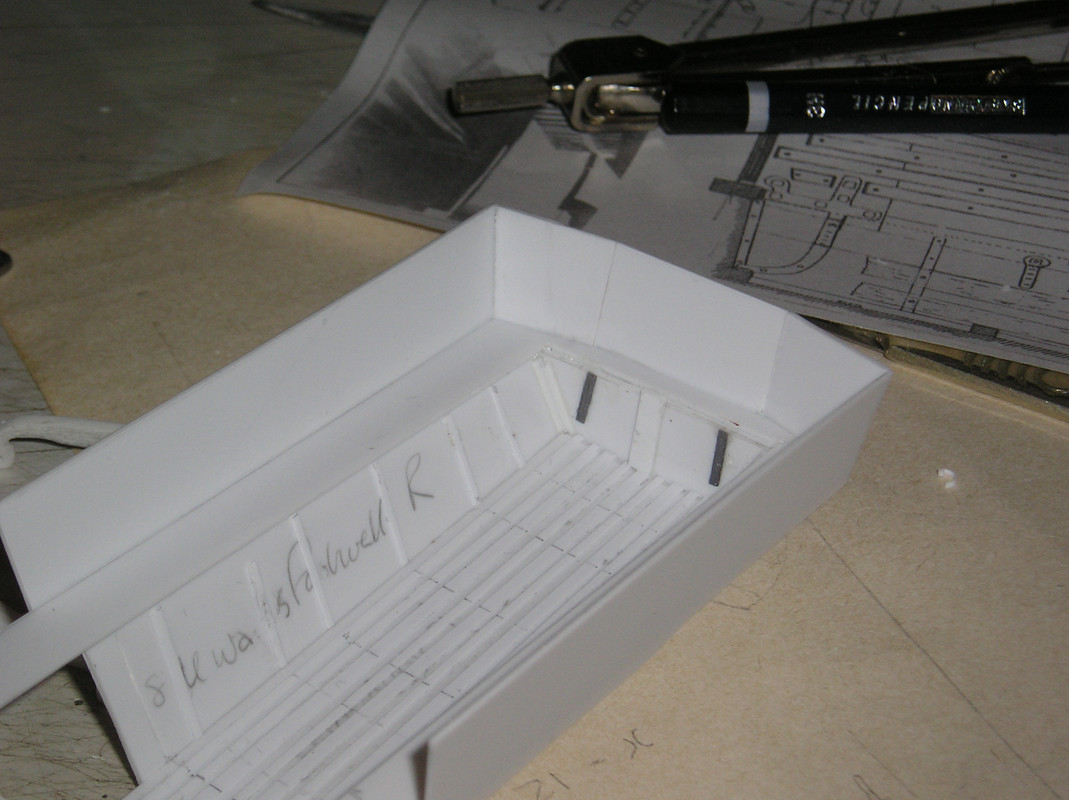

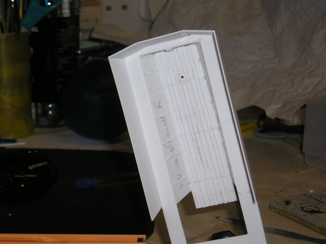

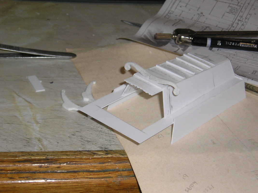

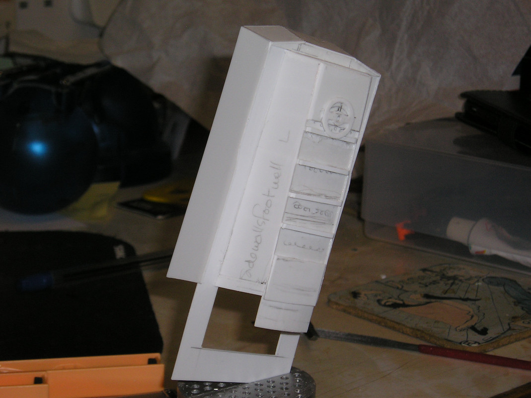

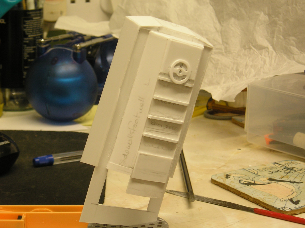

perdu Posted December 16, 2020 Author Share Posted December 16, 2020 Oh I think it would quite suit the dark Mediterranean mien Giogio. But no worries, I myself, me, have been known to facialise my chin and lip on mere whims. Today I will be mostly scruffy unshaven, but not actually decorative chin styled, old man white stubble doesn't look at all dramatic. Anyway, in my customary early morn modelling session today this happened. Central sloping fascia panel installed and the internal bracing added to the front footwell. Underneath (Feel free to imagine I uttered that imitating the moronic voice of the 'presenter' on Gogglebox...) Underneath... Other things stirred. Cross frame braces added now and the 'tache was tested for size in its eventual location. With the understructure installed I can get on, upstairs (figuratively, 'taint time for the upper deck yet) Looks as if we are going to have us a buzz. 12 Link to comment Share on other sites More sharing options...

perdu Posted December 16, 2020 Author Share Posted December 16, 2020 Cheers Now for the ironworks for drawing the bus through the cobbled streets, the brackets for mounting the fifth wheel go inside the floor, courtesy of my three mm chisel Hmm not very clear but Giorgio can see how versatile the hand held vise is, take off the handle and it sits quietly on the bench Lets get in closer This cruciform bracket carries the loads through the floor structure for this I doubt if the sidewall join will be seen after filling and painting Front springs to do next 15 Link to comment Share on other sites More sharing options...
