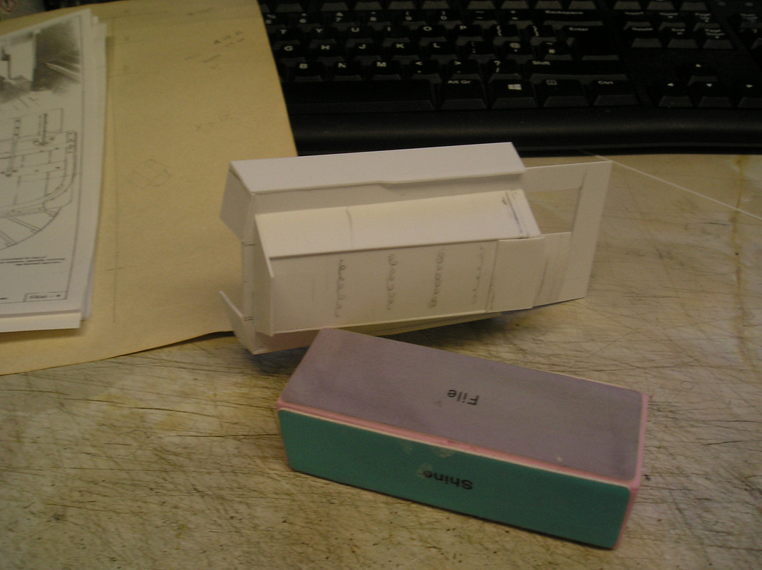

perdu Posted December 11, 2020 Author Posted December 11, 2020 I have to add the internal iron works now and I had best do that before I get any higher up with the side works There will be an angle iron on the front corner, about three scale inches and six thinner straps along the wall/floor junction with a complex and very strong outer piece that would be forged in one piece for the bus body rear where the platform will be added. We will have that to enjoy later with internal wooden braces and side walls. For this morning this can be allowed to quietly sit and ponder the ways of Tamiya green top thin adhesive. And I have to visit the paint shop and look in online shops for some of Mr Preiser's 1900 crew and passengers Or buy more modern ones and play dressing up, maybe I should get them to my sister. She really did love dressing up dolly - and I never did. 11

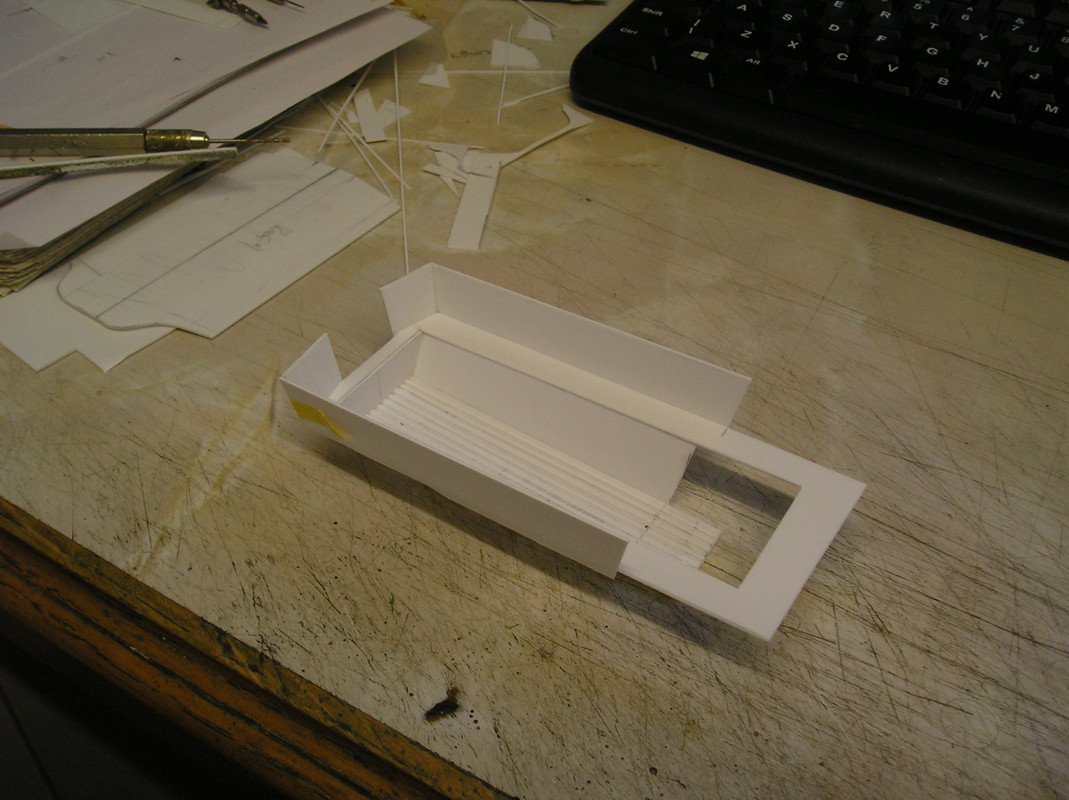

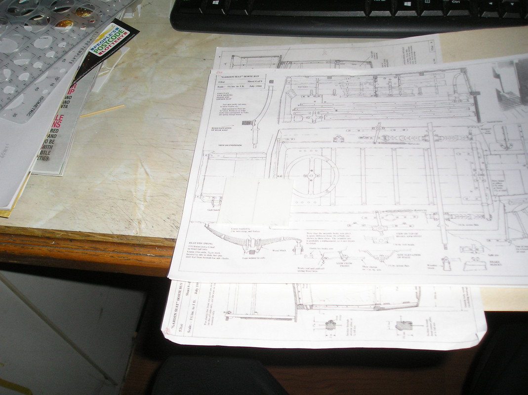

perdu Posted December 11, 2020 Author Posted December 11, 2020 Now I have plans to hand roughly it's quite simple to cut one piece out (with corresponding opposite sides) and glue them in. The real fun runs along with the stairs and running gear. I might just be mad, she has mentioned the possibility at times over the years. 🤔. 😆😆😆😆 6

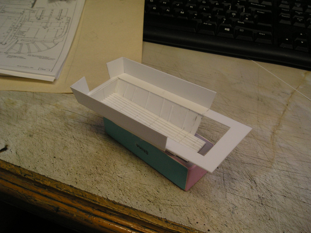

perdu Posted December 11, 2020 Author Posted December 11, 2020 Slowing down with the body I think it is time I turned my attention to the running gear This is in a reasonable place to wait for a while I think. Yes some of the internal braces (wrought iron braces) are shorter than the others, one which you can see the mark for on the back end (Right side of pic) actually comes round the cabin and climbs the back wall Since there aint-a-no back wall it can wait too. The wide plank across the rear underside will be where the rear spring will mount when it is all set. Now where did I leave that spring drawing? 9

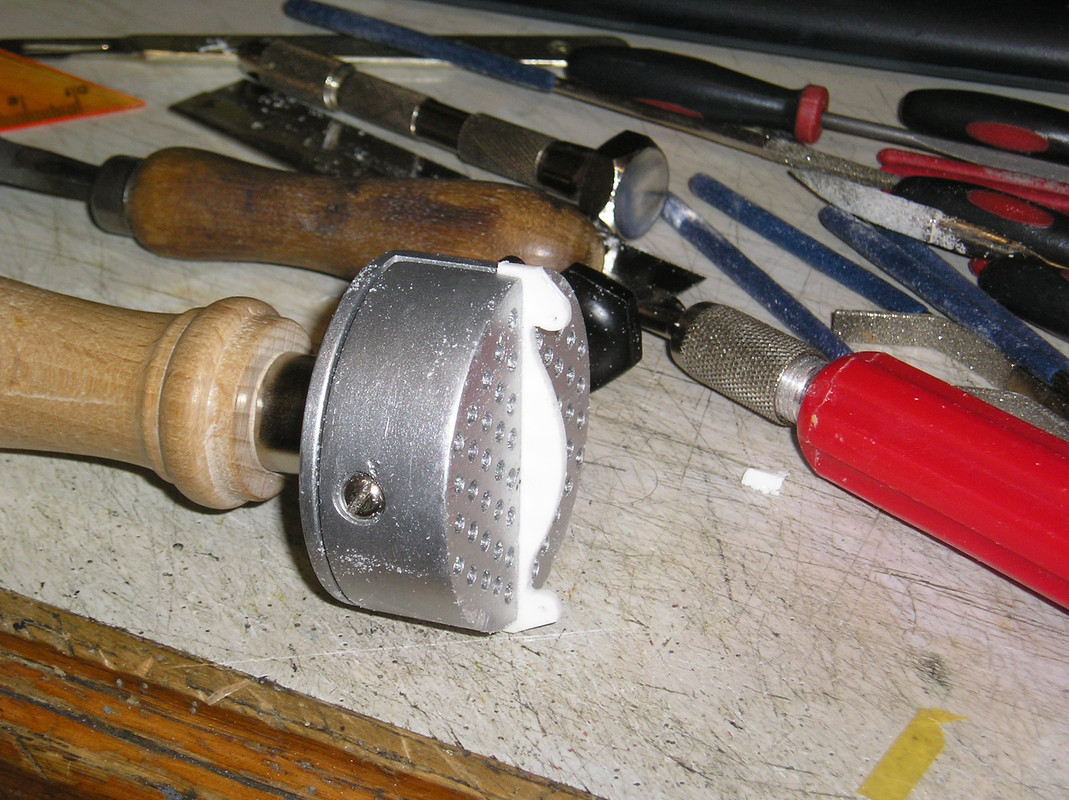

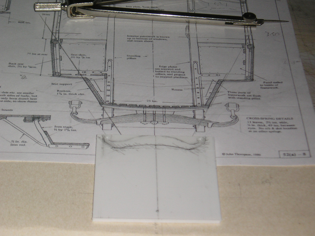

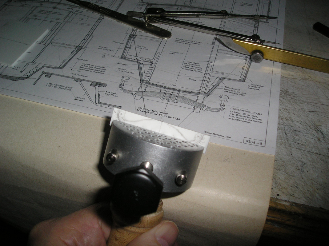

perdu Posted December 13, 2020 Author Posted December 13, 2020 So far Steve this is a combination of panic and fear. I have been wondering how I was going to make eleven or so leaves follow a pattern more suited to handlebar moustachios than an arc shaped spring as on my Hansom cab. And last night Uncle Logic jumped onto my shoulders, "Oi pill..., Airfitamyaosima don't put individual leaves into assorted contorted shapes do they? They make springs as a solid doobery, you should" So I am giving it a go. The spring eyes are predrilled to give me a datum, now to carve it out of very thick plackycard. The HendieHandyHolder clamp has a job to do now whilst I file and carve shapes out of the block. How I lived without it beats me And this different (to me) method of springing has further candidates. Apart from showing the sheer scope of the Model Wheelwrights plans this flashwashed image shows the second element of the rear suspension I am working on now, more HendieHandyHolder work to come... 12

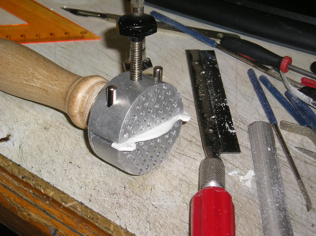

giemme Posted December 13, 2020 Posted December 13, 2020 2 hours ago, perdu said: The HendieHandyHolder clamp Alright, alright, what is that, please? It looks useful, dunnit? Ciao
perdu Posted December 13, 2020 Author Posted December 13, 2020 2 hours ago, giemme said: Alright, alright, what is that, please? It looks useful, dunnit? Ciao One of these https://www.ebay.co.uk/ipp/400788851952?transactionId=894044458027&_trksid=p2047675.l48352 Very useful for holding all manner of things and miracles in action This listing has ended but others are available 1
giemme Posted December 14, 2020 Posted December 14, 2020 16 hours ago, perdu said: One of these https://www.ebay.co.uk/ipp/400788851952?transactionId=894044458027&_trksid=p2047675.l48352 Very useful for holding all manner of things and miracles in action This listing has ended but others are available Thanks Bill, but... I don't have an e-bay account and it wouldn't let me see anything if I don't register (and I don't want to). Could you please just tell me the name of the thing? Many thanks in advance Ciao
perdu Posted December 14, 2020 Author Posted December 14, 2020 Hiya Giorgio the important part reads: Universal Work Holder 50mm Jaw Capacity Craft Tool Clamp Vice Engraver Peg TE196 abtools_uk (460102) details: Brand AB Tools Manufacturer AB_Tools Package Weight (g)210 8 Removable Pins that modifies to suit any shape work. Package Width (cm)4 Handle can be removed and head can be locked in a bench vice. Package Height (cm)3 Functions: Used for repairing and engraving Jewellery. Package Depth (cm)4 Use: Jewellers, Hobbyists, Beaders and Wire Artist. Material: Wood (Handle) Aluminium (Vice) Stainless Steel (Pins) I find it very versatile to grip odd shapes with. On Amazon: Silverline+380077+Universal+Work-Holding+Clamp+21mm+Jaw+Capacity This might help you. 3
perdu Posted December 14, 2020 Author Posted December 14, 2020 Mine has allowed me to begin removing non-leaf spring artefacts from the thick plasticard. I find I dont use the 'awkward shape' pins on many jobs but the small, ubercontrollable hand vise part is brilliant. Time to turn it for the outer/inner curve section of the moustachio. But first this morning trauma. My first haircut of the Christmas season approaches. My last one was in mid-summer, will I be too cold? These questions must be asked... 5 2
