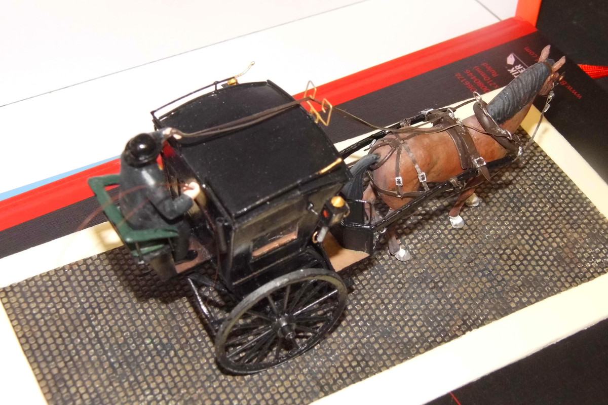

Some of you may remember me eventually turning out the Hansom Cab a couple of years ago, a long and protracted road but I am happy we got there in the end.

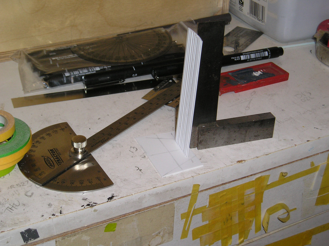

I shan't be making wheels with fellies and the like, in this scale I am going to stick with my  own tried and tested method of protractoring away any plasticard that isn't a wheel rim.
And using these  as wheel hubs.

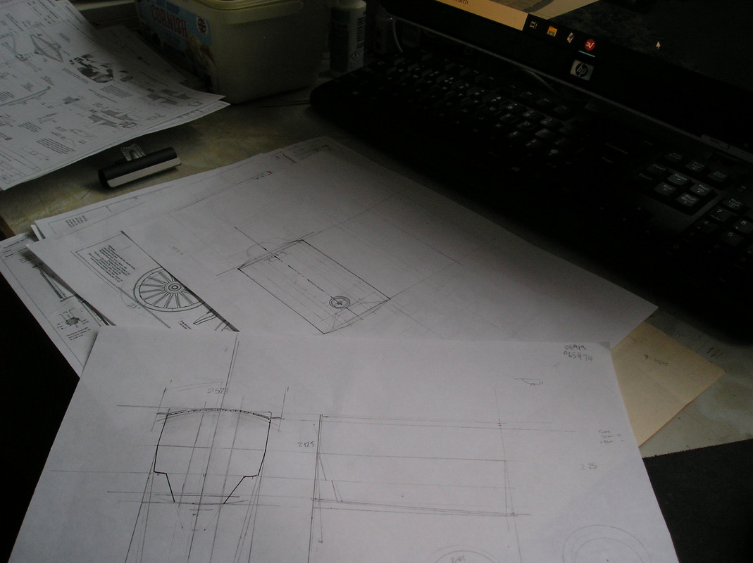

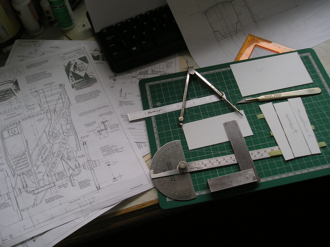

Anyway, this is the plan

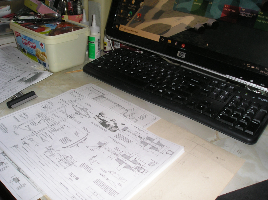

Co-incidentally these are the plans
The Model Wheelwrights kindly supplied me copies of their plans of the London Omnibus by John Thompson which have given me immense amounts of useable data and sizing clues (the plans had some scale info but were reduced from the original before I got them and I have had to resize and scale them as I go along, this is going to slow me down.

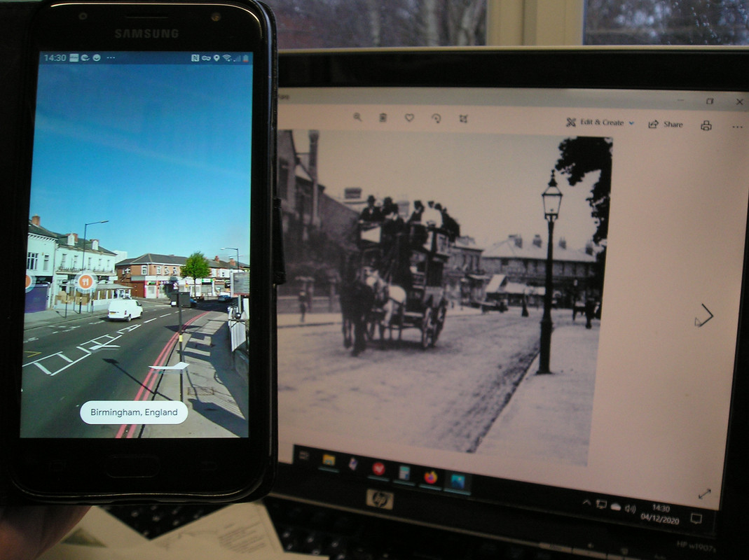

(I was a little scathing about town planners destroying the Victorian infrastructure in Birmingham, but Manzoni did not get it all)
Here is a Victorian bus in Sparkbrook with the same road now courtesy of Google Maps

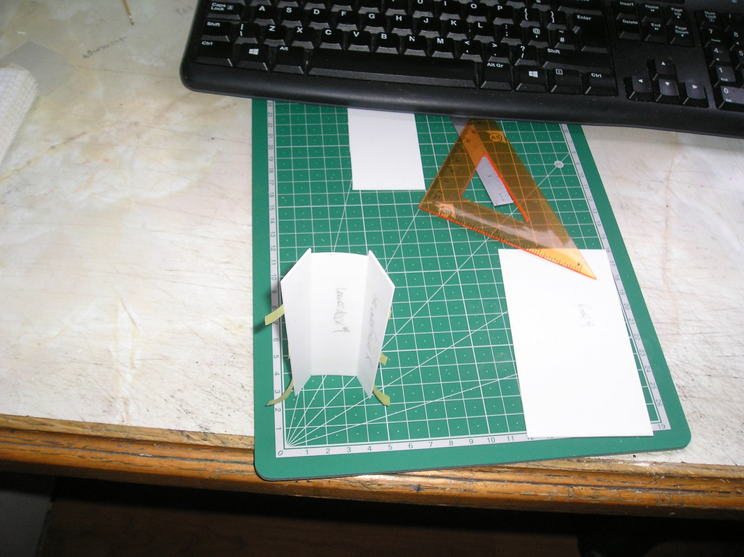

And a shot of the planning underway
Work has begun on the lower deck foot well.

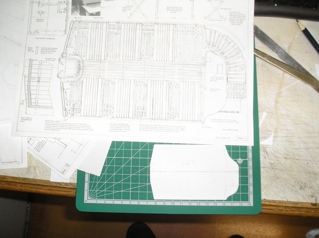

The original bits I cut out yesterday have had a little attention but as I say expect zero speed on screen
This is the lower deck floor which sits between the wheels and permits us to "move along the bus please" and sit on the upholstered benches that run the length of the body, side by side seating was only for the brave beggars atop the contraption.
The lowest floor is curved to allow water to run out at the back and down the centre of the floor

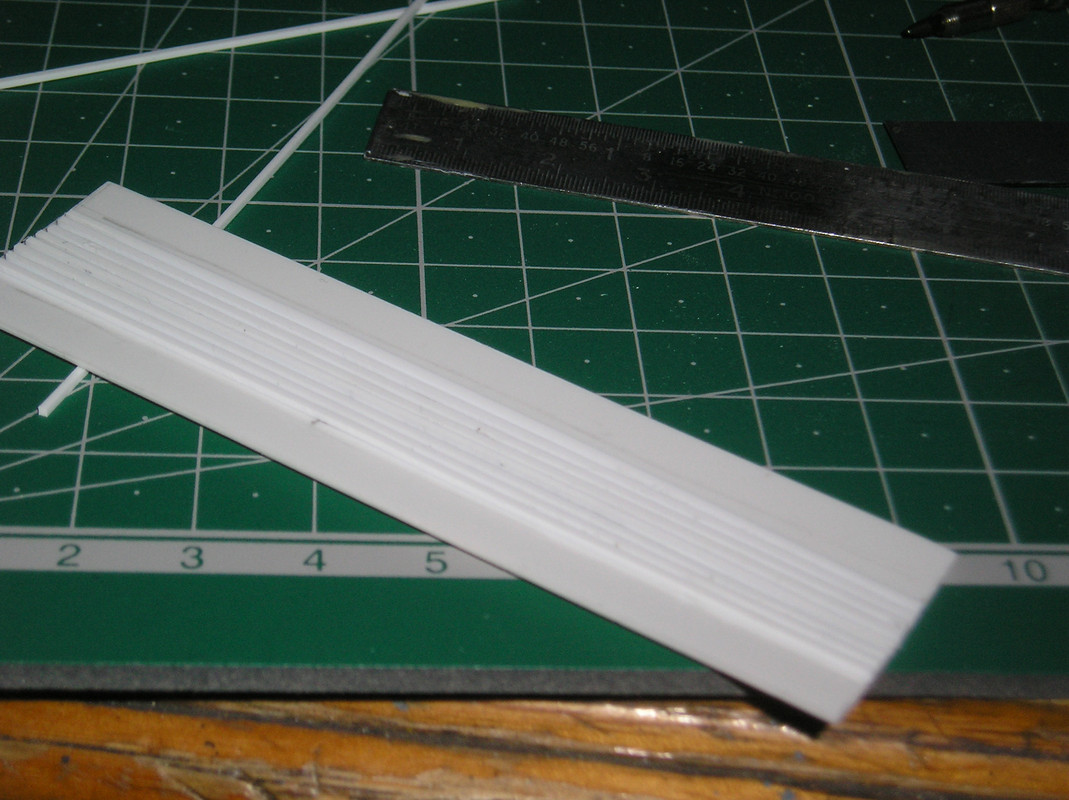

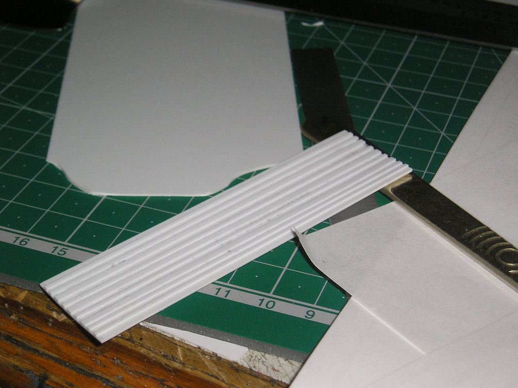

There will be treadstrips along the length of the floor, this was an early experiment.P1010215.jpg
Now abandoned whilst I get back to the Evergreen store for wider 0.020" strips, 0.040" if they stock them  or I am going to have to cut a lot of strips myself
Anybody got a guillotine for plasticard? (Which might be an idea for Christmas, I can see a need for lots of strips coming over the hill...)

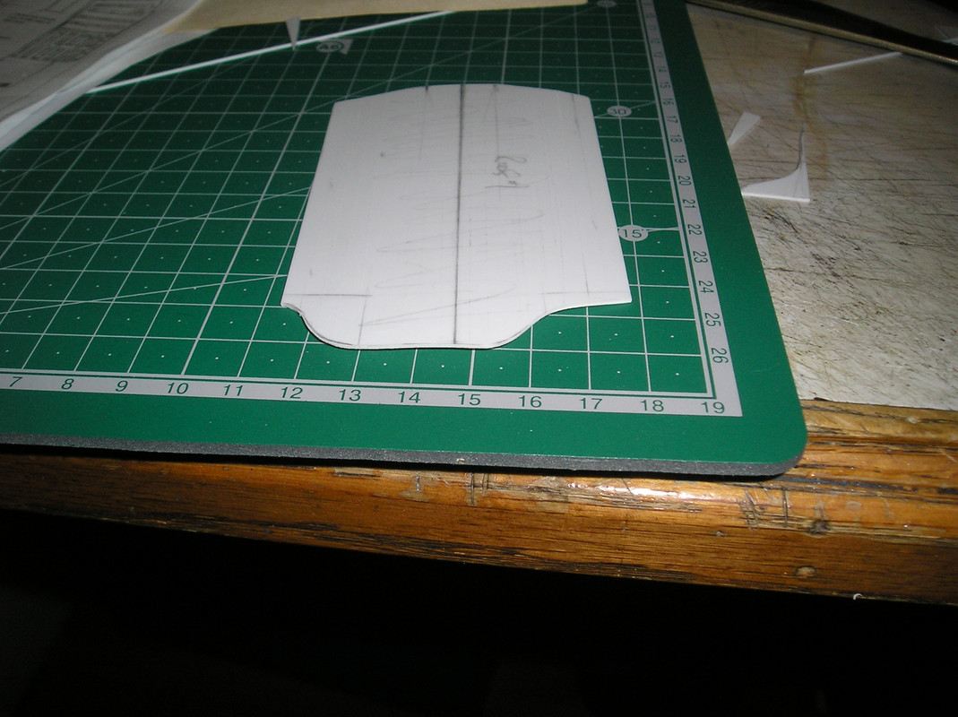

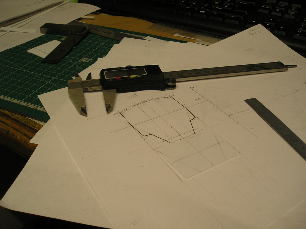

This is a lesson to me not to take my measuring for granted, I think it is too short since I trimmed the roof blank I prepared yesterday today.
Beggarit!
Proportionally I think I should not have taken off the 7/16th in I trimmed off this afternoon
Oh well I do now have a template to work to...
Practise making the roof/floor curved to suit.

Today I got the strips I wanted, now on the floor.
Then it was time to organise the front wall to add it to.
The floor is sloping down from the front to the rear step and the angle gets set now when it is glued to the main panel.
