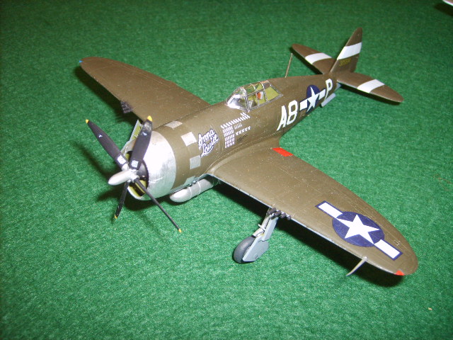

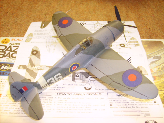

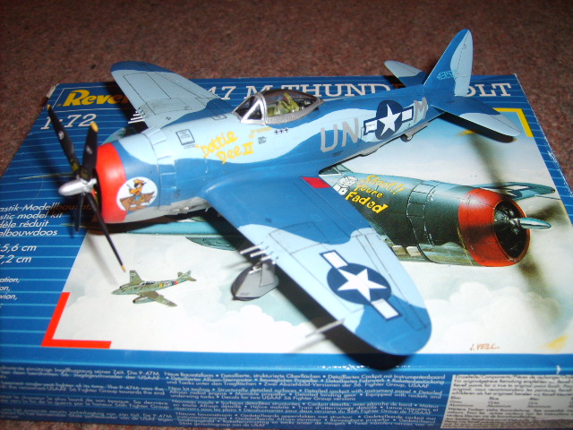

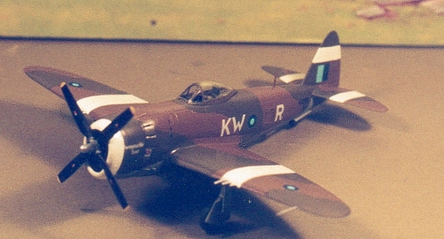

theplasticsurgeon Posted October 13, 2020 Share Posted October 13, 2020 Just so you know what they look like - here are the Academy P-47s: Hasegawa And Revell 2 Link to comment Share on other sites More sharing options...
