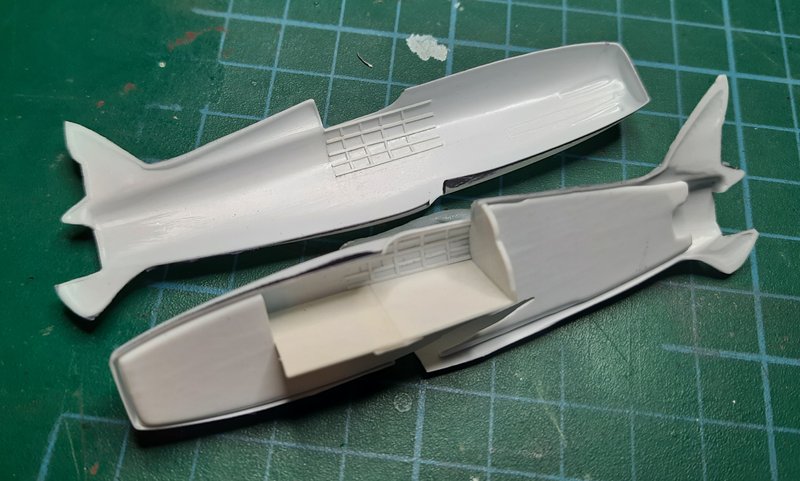

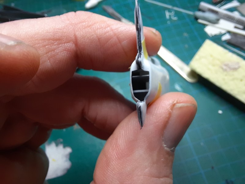

Courageous Posted October 9, 2020 Author Share Posted October 9, 2020 Cockpit- Take Two This 'ere pic show the central former that's supposed to run down the spine of the model, ok. The cut-out is the cockpit section and the Mk 1 cockpit was born and boxed in accordingly. Unfortunately, the raised section in the middle of the cockpit is in fact the seat, making my cockpit floor about 3.5mm too high. This was confirmed when I tried to place a scale seat/ pilot and found that the pilot's head was sticking outside ! Here is the Mk 2 cockpit, lowered by 3.5mm. Additional stringers and frames were added, and for added strength I added a firewall between the cockpit and engine. Thought it would be nice to give him a headrest too. Now I was happy, additional plastic was added around the perimeter to aid gluing. Made a seat, an i/p, rudder pedals, quadrants for the throttle and undercarriage up/down and control stick. Here's a view of the radiator exhaust with its odd arrangement. The shape is a little pants at the bottom but I'm hoping that I'll sort that when the halves are joined together. I now encountered the same problem as @Moa had when he put the halves together and offered up the spinner... more trouble to deal with . So, seeing that this is a virgin kit and not a started one as in Moa's case, either the spinner is too big or the fuselage is wrong, my money is on the fuselage, either way, it needs sorting. Stuart 12 1 Link to comment Share on other sites More sharing options...

bigbadbadge Posted October 9, 2020 Share Posted October 9, 2020 Great work so far Stuart, lucky to find out about the cockpit floor before it was too late, mind you you could have said trumpeter designed it !!! I am sure that this is going to be a stunner when complete fella after the lovely Saro and Bugattis. Chris Link to comment Share on other sites More sharing options...

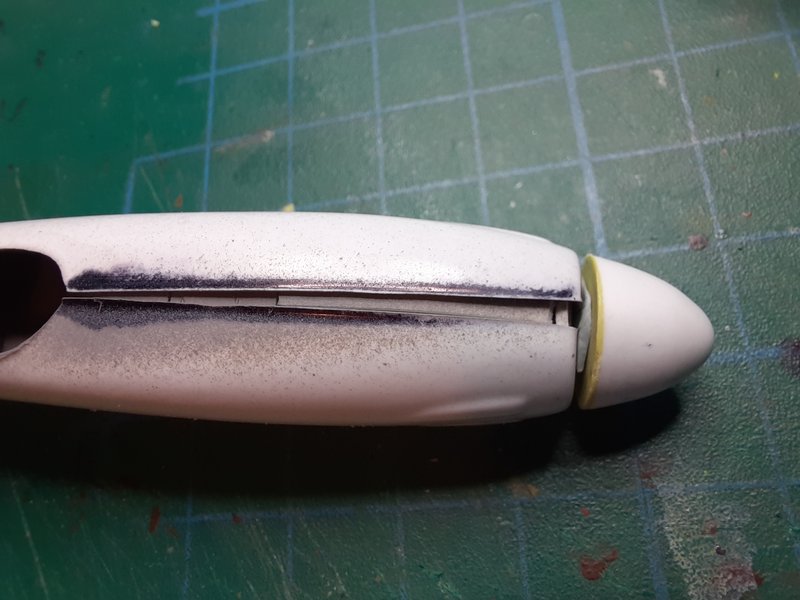

Terry1954 Posted October 9, 2020 Share Posted October 9, 2020 44 minutes ago, Courageous said: either the spinner is too big or the fuselage is wrong, my money is on the fuselage, I'd tend to agree looking at the picture, although if you shortened the spinner at some point it would meet the diameter of the fuselage I guess. I guess there are no plans to check? Champion work at any rate! Terry 1 Link to comment Share on other sites More sharing options...
Courageous Posted October 9, 2020 Author Share Posted October 9, 2020 1 hour ago, Moa said: You are doing a fantastic job there. And you will surely solve the issues. Your work is meticulous and effective. Thanks, much appreciated, I just hope I can live up to such praise. 1 hour ago, bigbadbadge said: I am sure that this is going to be a stunner when complete fella Cheers Chris, early days yet but having fun along with a little frustration. 1 hour ago, Bengalensis said: Looking very nice, good work. I'm sure you will find a solution to the nose as well. Thanks Jörgen, I could copy Moa's solution... 1 hour ago, Terry1954 said: Champion work at any rate! Cheers Terry. I have taken a look at your suggestion, 'shortened the spinner at some point it would meet the diameter of the fuselage' but this method would produce a 'chin' that doesn't exist. The drawings I have, show that the spinner is correct, so I reckon I will be using Moa's method to correct this issue. Stuart 4 Link to comment Share on other sites More sharing options...
rossm Posted October 10, 2020 Share Posted October 10, 2020 14 hours ago, Courageous said: Cockpit- Take Two This 'ere pic show the central former that's supposed to run down the spine of the model, ok. The cut-out is the cockpit section and the Mk 1 cockpit was born and boxed in accordingly. Unfortunately, the raised section in the middle of the cockpit is in fact the seat, making my cockpit floor about 3.5mm too high. This was confirmed when I tried to place a scale seat/ pilot and found that the pilot's head was sticking outside ! Stuart That gives me an even better idea of what to do with the former in my Mew Gull than your first post about it 1 Link to comment Share on other sites More sharing options...

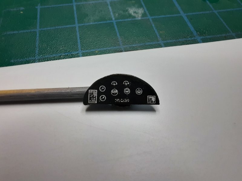

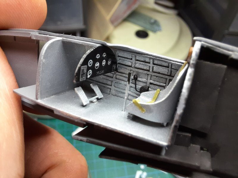

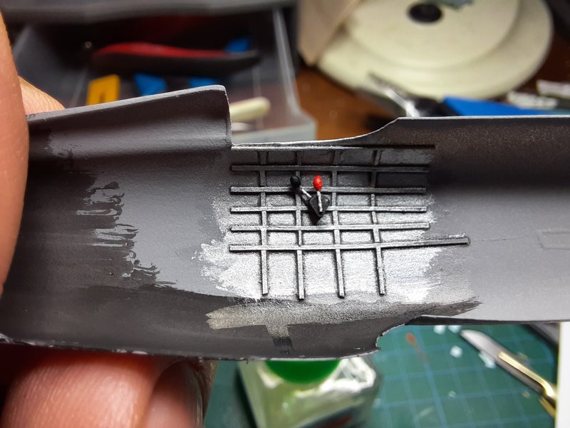

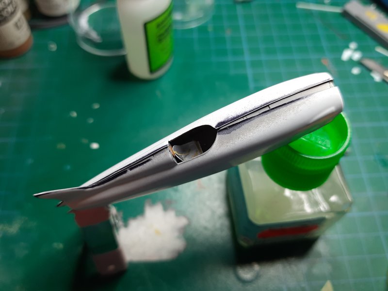

Courageous Posted October 14, 2020 Author Share Posted October 14, 2020 Too many things grabbing my time... From left to right; seat with belts, rudder peddles, undercarriage hand-pump, throttle quadrant and control column. An i/p with a few dials and placards. Starboard side of cockpit with bits fitted. Ports side with throttle quadrant fitted. The start of gluing halves together. Stuart 11 Link to comment Share on other sites More sharing options...
fjaweijfopi4j48 Posted October 14, 2020 Share Posted October 14, 2020 Beautiful work, Stuart! You are properly dressing that thing up! 1 Link to comment Share on other sites More sharing options...
