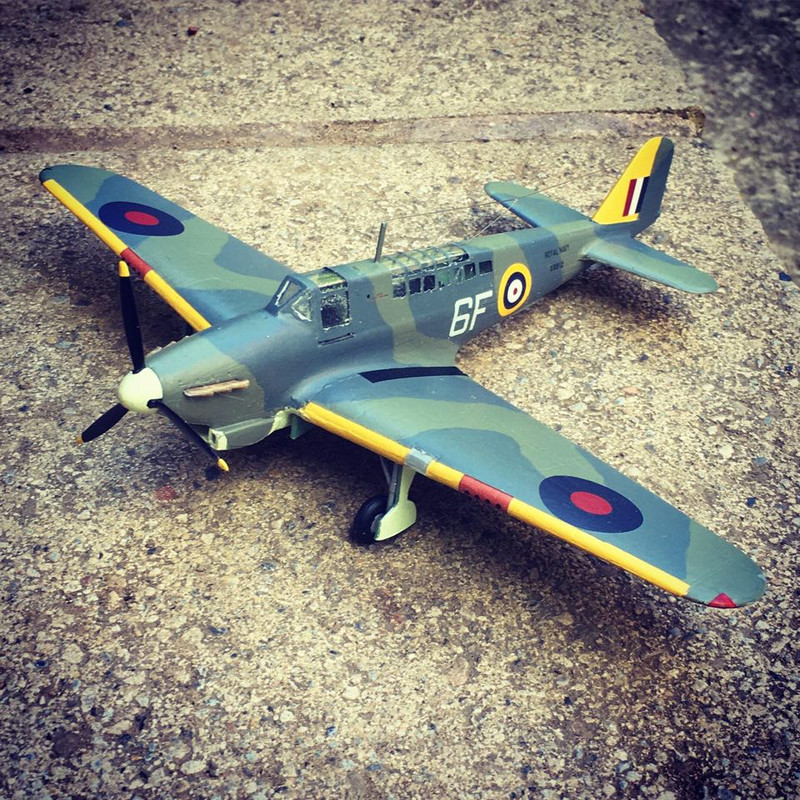

Grey Beema Posted September 6, 2020 Share Posted September 6, 2020 6 hours ago, TonyOD said: Crikey. Thanks all for this very detailed and interesting information. I've been eyeing up those Arma kits for a while, they weren't around when I was modelling 10 years back. I was hoping to do something from the stash but I have a surprising paucity of MTO stuff in there. there's a Special Hobby Fulmar with "spaghetti" leading edges that I don't like the look of and I have a/m decals for various seafires but that too would mean acquiring another kit. No harm in that, I hear you say! Is it the ‘Sand and Spaghetti’ on the Fulmar you have a problem with or the Fulmar? You can do a Fulmar without ‘Sand & Spaghetti’, an early MkI, a Pedestal MkII in TSS or even a TSS ‘Torch’ Fulmar with US Stars.. My 806 NAS Fulmar HMS Illustrious, Mediterranean, Nov-40. 3 Link to comment Share on other sites More sharing options...
TonyOD Posted September 6, 2020 Author Share Posted September 6, 2020 (edited) Thanks for all the advice - I've bottled the Mk XII for now, though I'm sure i'll come back to it. For the MTO group build I'm doing something that was actually hiding in plain sight in the stash, a Grumman Martlet of 800 NAS which I had assumed had nothing to do with the Med as it has D-Day invasion stripes. Not the case, it was on board HMS Emperor which took part in Operation Dragoon but ditched in the sea off Spain. Much appreciated though, what a wealth of information there is on BM. 22 minutes ago, Grey Beema said: You can do a Fulmar without ‘Sand & Spaghetti’, an early MkI, a Pedestal MkII in TSS or even a TSS ‘Torch’ Fulmar with US Stars.. Definitely on my radar, and yours looks fantastic ... I did the Revell Fulmar in a Pedestal scheme when I first got back into it during lockdown but feel I could do a much better job of it now. Edited September 6, 2020 by TonyOD 2 Link to comment Share on other sites More sharing options...
