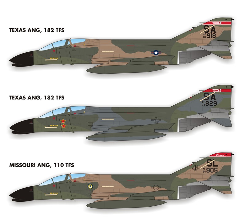

Here is my entry for the GB. The ZM F-4C:
I intend to build it as Robin Old's mount, 64-0829. However, not in its most common guise from the War, rather how it was finished before retiring to the USAF Museum:
Photo.php?16834
Using the Caracal Decal sheet:
From looking at the kit, I'm going to swap the seats out for a resin set and use the ZM etch, manufactured by Eduard for the cockpit.

welcome along Greg and I'm sooo jealous!!!
I've been drooling over these models for a while now but am holding out (and hoping) for the F-4E release......I may end up buying quite a few of them!
Am really interested in seeing how this model builds up as I've heard so many good things.
I like the choice for the scheme as well and glad someone is doing a Vietnam Vet. scheme.
Well good luck with the build, I'm sure there'll be lots of interest in this one!
I have not done a Phantom since a couple of Hasegawa's back at the turn of the century,I need to try one of these,will follow yours either interest.
Super choice! I'm currently building the "S" version by ZM and i'm having a lot of fun despite some filling is required.
Enjoy it!
Just digging into the web for images and I’ve found some better images. It was also in the Florida ANG in the wraparound SEA scheme. Anyway, the airframes in the Euro One scheme is not pristine, bare metal around the intakes and on the tank noses. The paint is also weathered and stained, so this should be interesting to replicate
