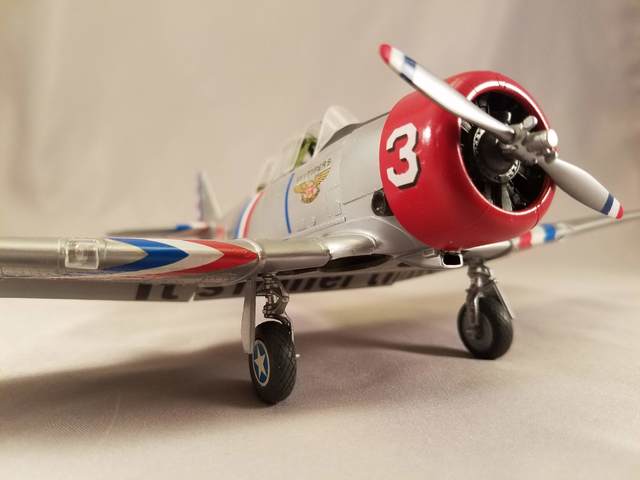

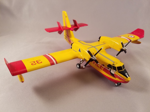

dnl42 Posted August 5, 2020 Posted August 5, 2020 On 8/4/2020 at 10:25 PM, luftmodels said: hank you for your reply. I would assume everything above primer coat. Am I correct? Very often I get sandpaper like surface when I do first thin coats. Then I spray more and get even rougher sandpaper. I guess I hold my brush too far. Definitely more than 2 inches. How many in total coats do you do including first mist? You're probably too far if you're getting sandpaper surfaces.Β Β This is how I paint.Β Β Prepare the surface so it's as smooth as possible prior to painting. Polishing pads help here. Make sure there are no foreign substances on the model. I always wipe the model and all parts with 91% Isopropyl Alcohol (IPA) before painting. NEVER use hardware store lacquer (cellulose) thinner on plastic.Β Thin the paint with the manuf's thinner unless an alternate has been verifiedΒ toΒ workΒ as well. For my preferred Mr Color, I use Mr Color Leveling Thinner (MLT). I use MLT for Colourcoat paints too, as I know it works well. Thin to the consistency of 1% milk. I thin only the paint I'll need for the specific session. I don't put thinned paint back in the jar/tin. Before adding paint to the airbrush cup, put 3 to 5 drops of paint thinner, NOT HW store lacquer (cellulose) thinner, into the airbrush cup. StartΒ with just an airflow to ensure there's no fluid leakage past the needle. Then slightly pull back on the trigger so just a little fluid (thinner) is atomized. Make sure this starts smoothly and shows good atomization. Then go to full flow, again looking for good atomization. If any of this doesn't work, fix the problem with the airbrush and repeat until this step works. When this is done, you've ensured any fluid residue in the airbrush is fully compatible with your paint. Resin and metal must be primed. Multiple surfaces, for example plastic and metal,Β should be primed.Β I always prime everything. I brushΒ Mr Metal Primer on all metal surfaces and thenΒ thinned Mr Surfacer 1200 (thinned as above) over everything (including the already primed metal surfaces). Set the full-flow air pressure to 15 PSI (1 atm). This means air (but not paint) is flowing through the airbrush. Static air pressure will be higher. Spray at 0.25 in to 1.75 in (5 to 45 mm). ThisΒ can be a little tricky to manage, but is veryΒ important to avoid those sandpaper-like surfaces. The most important part is to not get too far away, so the paint doesn't dry before it hits the model surface. The paint should hit the surface slightly wet. Use a grazing light to see this. If the paint isn't wet when it hits the surface, you're going to get an orange peel, sandpaper, or worse. Use thin coats to build coverage. White and yellow can require many thin coats to get full coverage. As I use lacquers, which dry very quickly, I can get full coverage in a single session. If I have multiple small parts I'll apply a thin coat to each part in turn until I've built full coverage on all parts. On a full model, I'll do the same with different parts of the model. I'm pretty sure this can be done this with Tamiya too. If spraying a gloss color, only apply a final "wet" coat after full coverage. This is especially important for white and yellow. Wait until the paint is fully dry before masking. For enamels, wait until the paint has cured (several days, until off-gassing can no longer be smelled). With Mr Color, I canΒ mask in 30m to an hour if I'm trying to hurry.Β I primarily use Tamiya masking tape because of its good adhesion and low tack. I will also mask with Frisket film when I need a more complicated mask. Microscale Industries Micro Mask works well for solvent paints. I always de-tack masking tape by laying it on the palm of my clean hand before applying to the model. HereΒ are examples ofΒ gloss coats. No rub-downΒ was needed along the way.Β Β Β HTH --Β dnl 6 4 1
